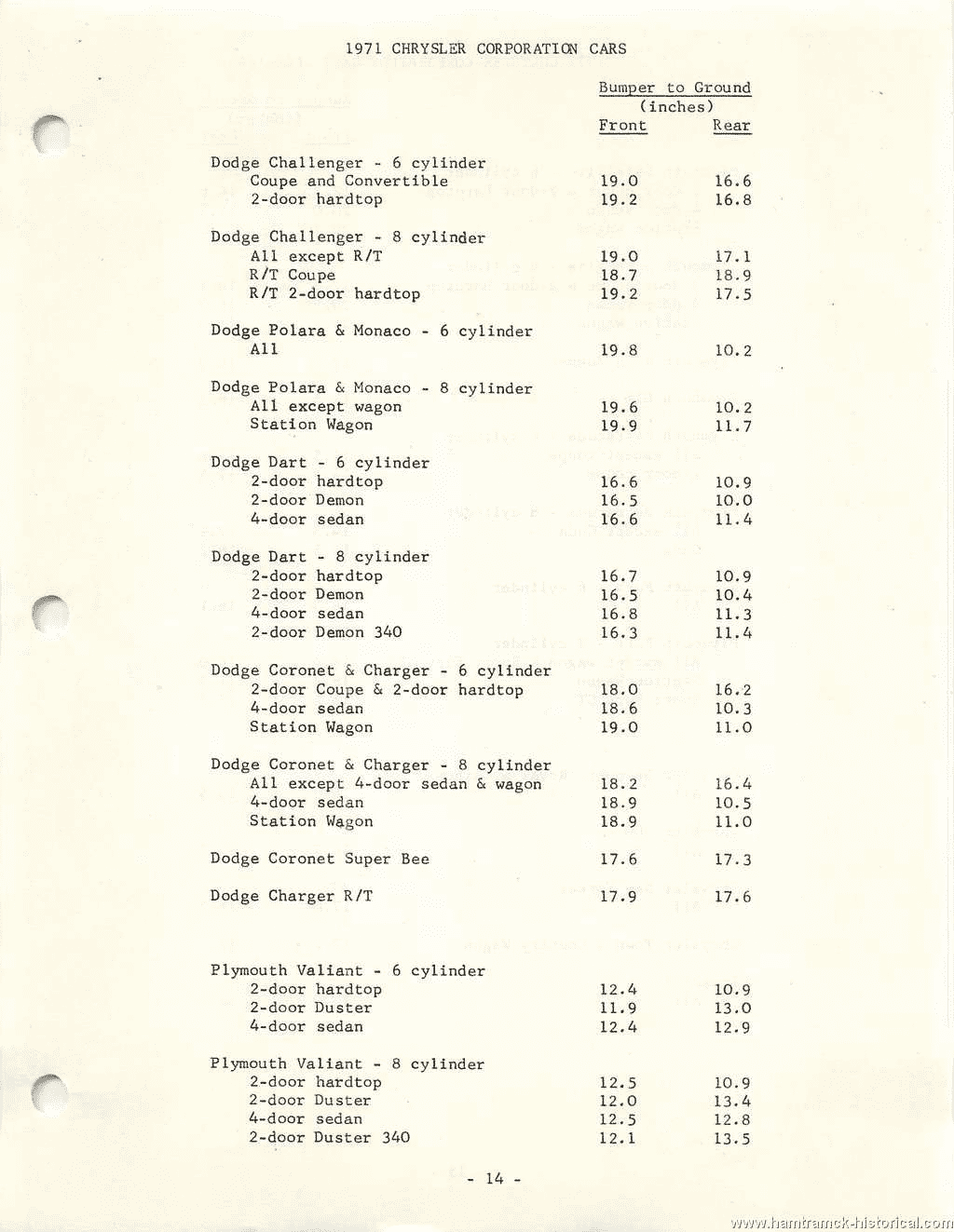

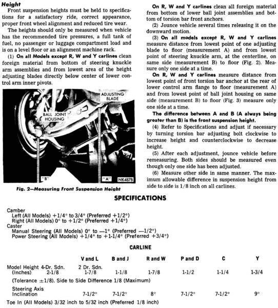

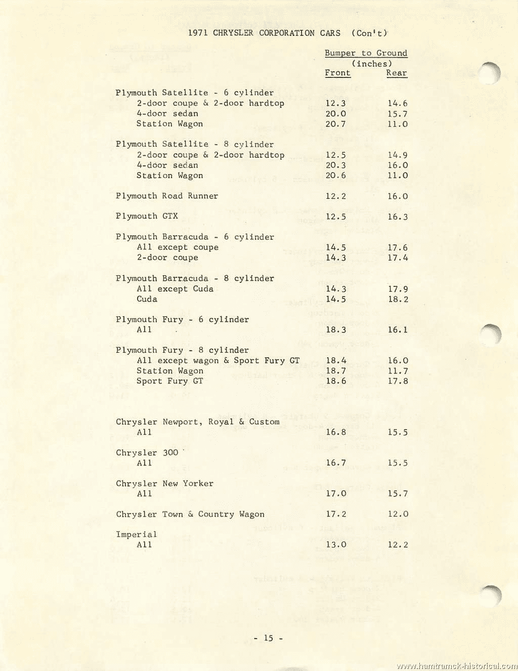

Challenger RTA
Oct 28, 2018
3,791
1,992
PA Flood city
Here is some info. And have close to a full tank of gas or about 120lbs in the trunk
gran coupe john
Aug 15, 2023
548
133
Ohio
Back in 87 was the last alignment. Can't believe I found this document. Hope it is readable. I sure will give them the information you sent. Thanks !!!
