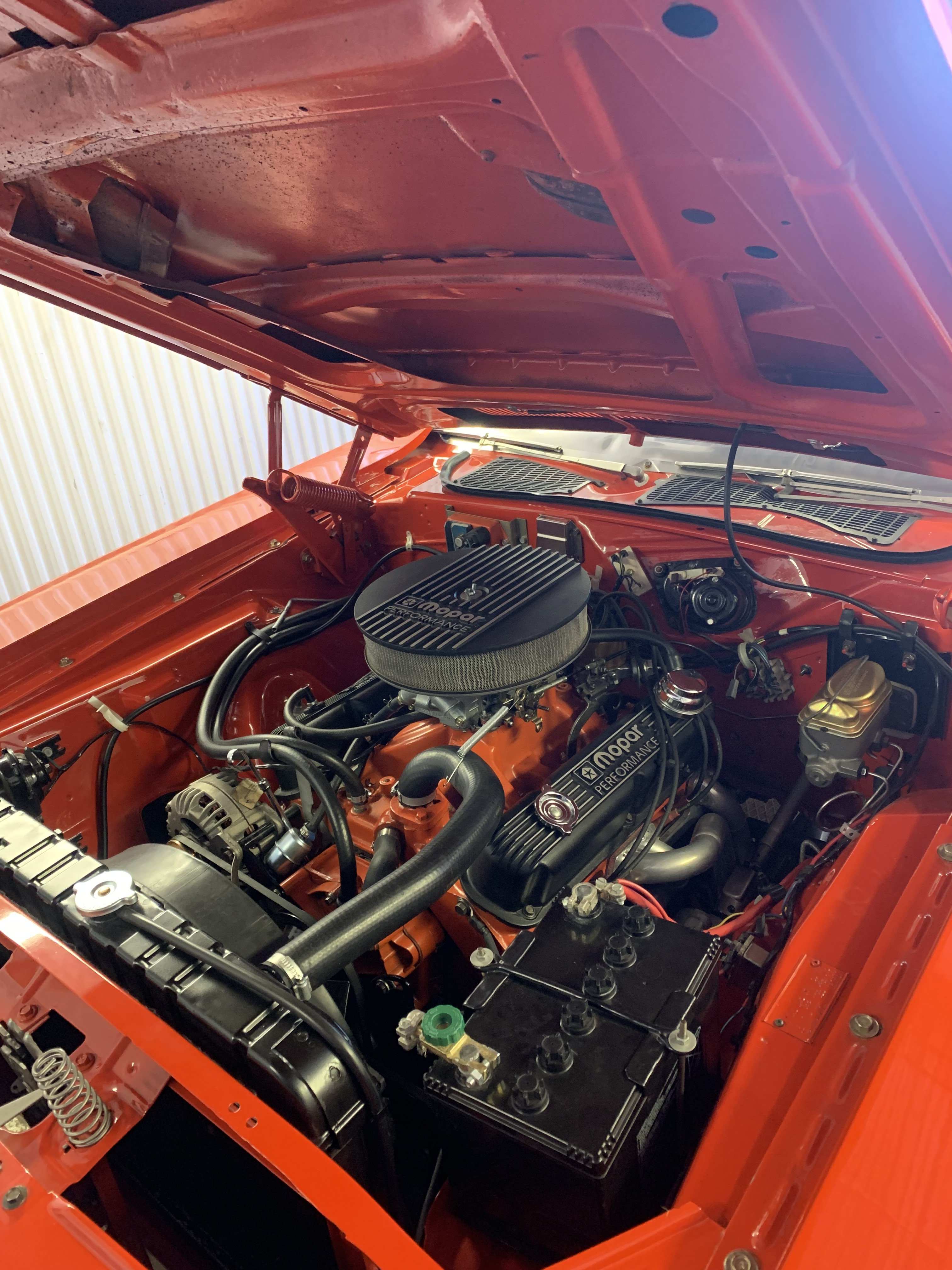

Recently bought a -71 challenger with a 340.
Specs are
340” drilled 0.30
Eagle rods
Keith black pistons
Edelbrock torker 340 intake
Edelbrock rpm heads that are matchported.
Xtreme Energy 236/242 Hydraulic Roller Cam (COMPS CAM) grind number xr286hr-10
Mopar performance distributor with plugged vacum. 18 advanced timing with 34 total.
The carb on right now is a holley street avenger 670 with vacum secondary.
its also a 4-speed car with 3.55 gear in the rear.
I cant get the car to run nice on light throttle, it just bogs and hops when trying to run in ordinary trafic. I have read alot of people having problem with this carb. Should i take it of and buy a quick brawler 650 or 750 DP? (Holley made). The problem is on the primary side and i read that you need to drill or change the metering block to get it to work good.
Hope i can get some good tips and help! Thanks.
