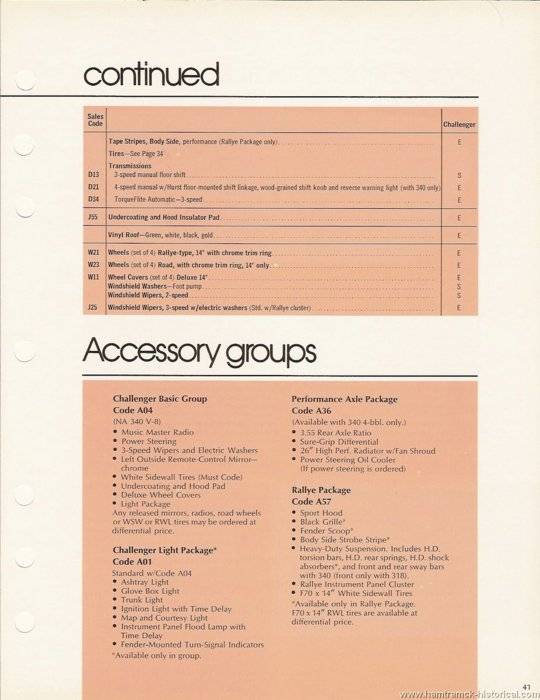

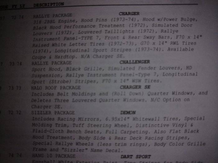

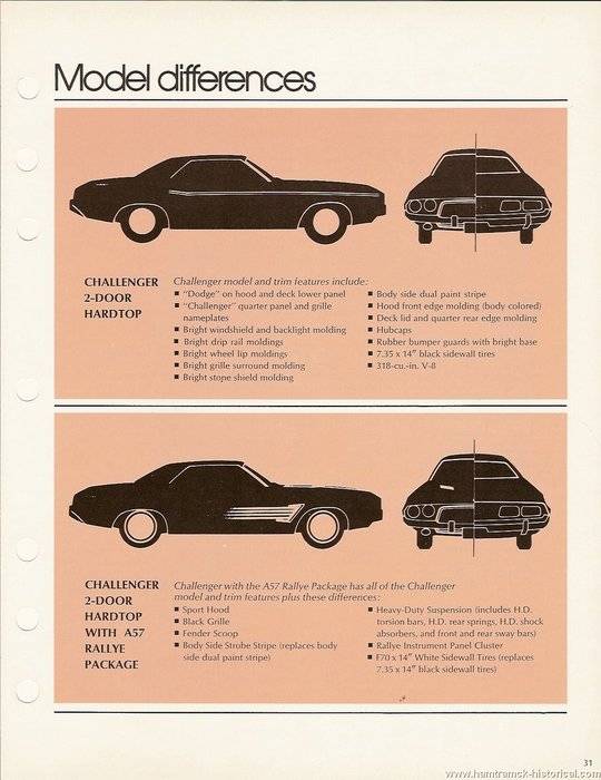

New owner of a 73 challenger 340 car that has the Rallye package.
What exactly came with the Rallye package in 1973? Was it purely cosmetic or did it have some performance upgrades?

Just the grille center. The header panel remains body color.
Old Gaylen forgot to mention front & rear sway bars. Don't assume "heavy duty suspension" includes those.
challenger6pak
Feb 27, 2011
4,070
917
In 73 front and rear sway bars were part of the 340 Rallye Package; but the 318 Rallye Package only got the front bar. Strange how things were done.
