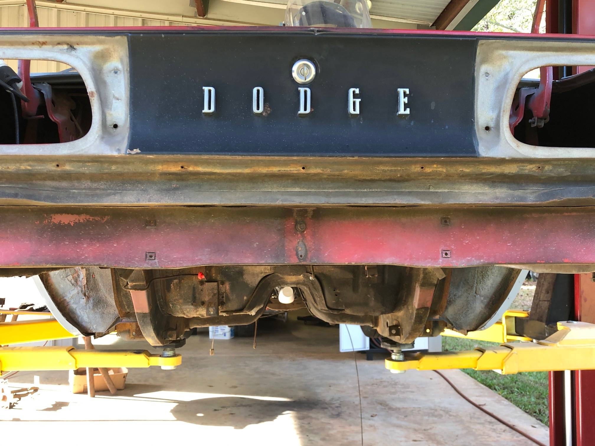

Pulled the tail lights and removed rear bumper and noticed all the holes, about 6 inches apart, and it appears I am missing a strip of some sort. I looking over the body service manual I could not find anything listed so, not sure what I am looking for.....thanks...

It is a rubber filler to fill the gap between the tail panel and the extended bumper. In 1973 the Feds mandated a 5 mph bumper, ( a requirement to limit body damage after hitting a fixed barrier @ 5mph. Intended to limit body $$$ damage at low speeds) on all cars. Different manufacturers did it in different ways to comply. Some used collapsing bumper mounts, Chrysler used extended bumpers and large bumper guards.

Thanks leo, in searching my aftermarket catalogs only thing I can find is listed as a 70-71 rear bumper filler panel, but states its metal. Don t think this is it. If it is only for a 73 model only the repop folks may not be making one. Am I going to have to find a used one....

the part for 70 that is steel will work great as long as you have the bumpers moved in flush which looks a lot better anyway so you could just use different bumper mounts with the 70 panel , probably a lot easier to find the 70 parts .

Ok, thanks CP, just may go that route, will see if I can get one in the mail coming this way....

Only available used. Post a want add a lot of guys with post 72 cars have changed to earlier bumper brackets and bumpers and probably still have the old parts.
Good luck either way.
