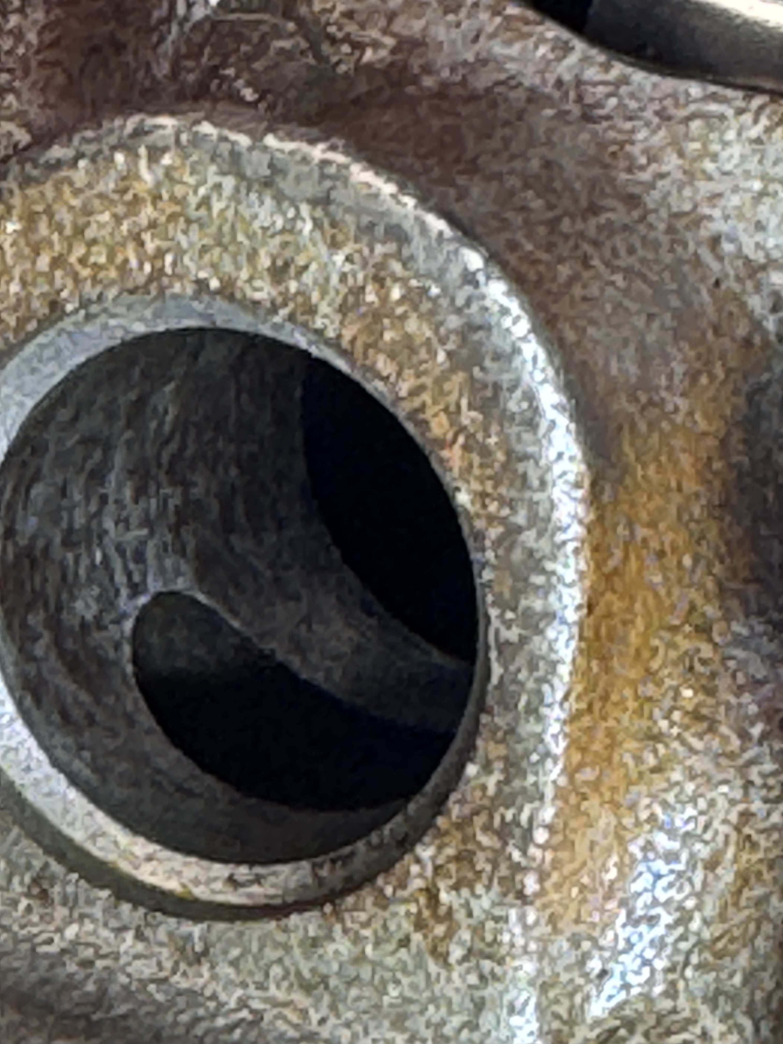

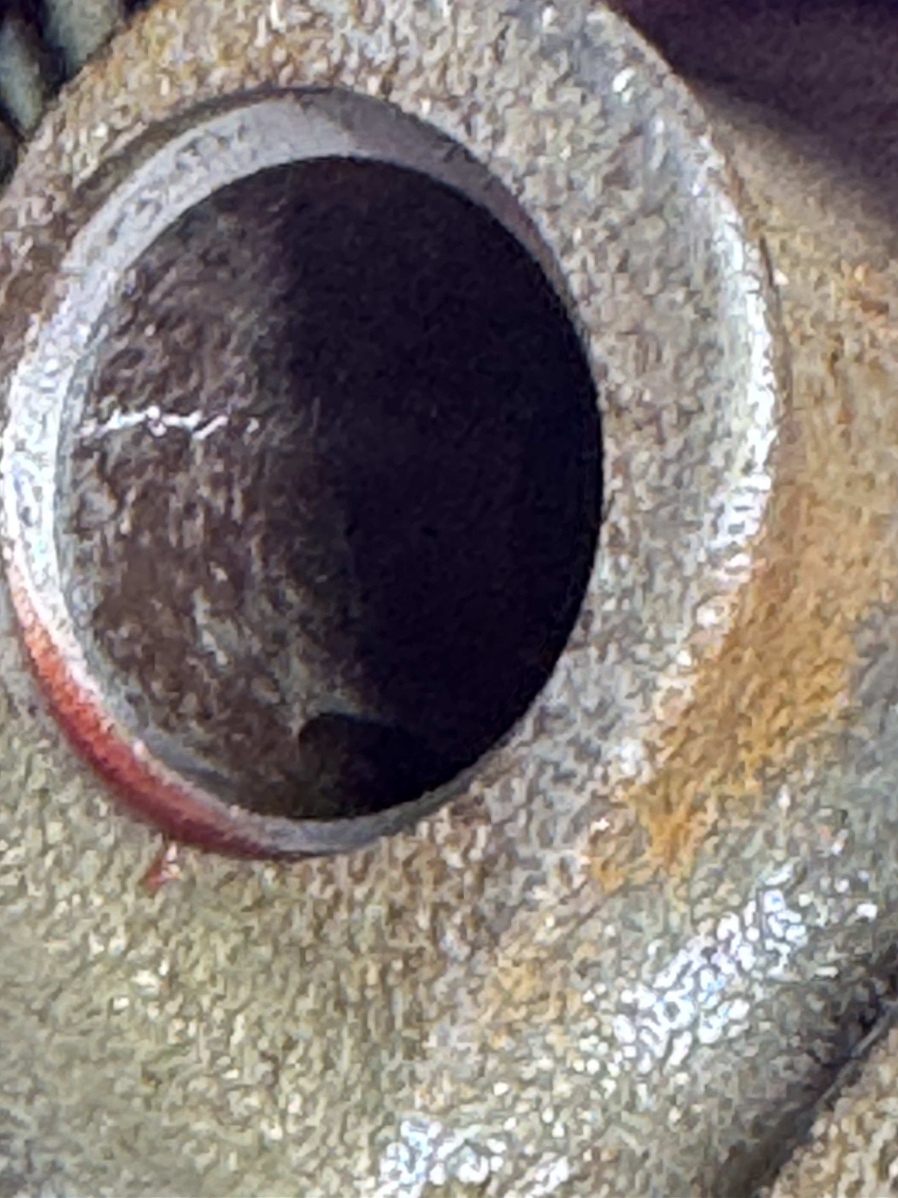

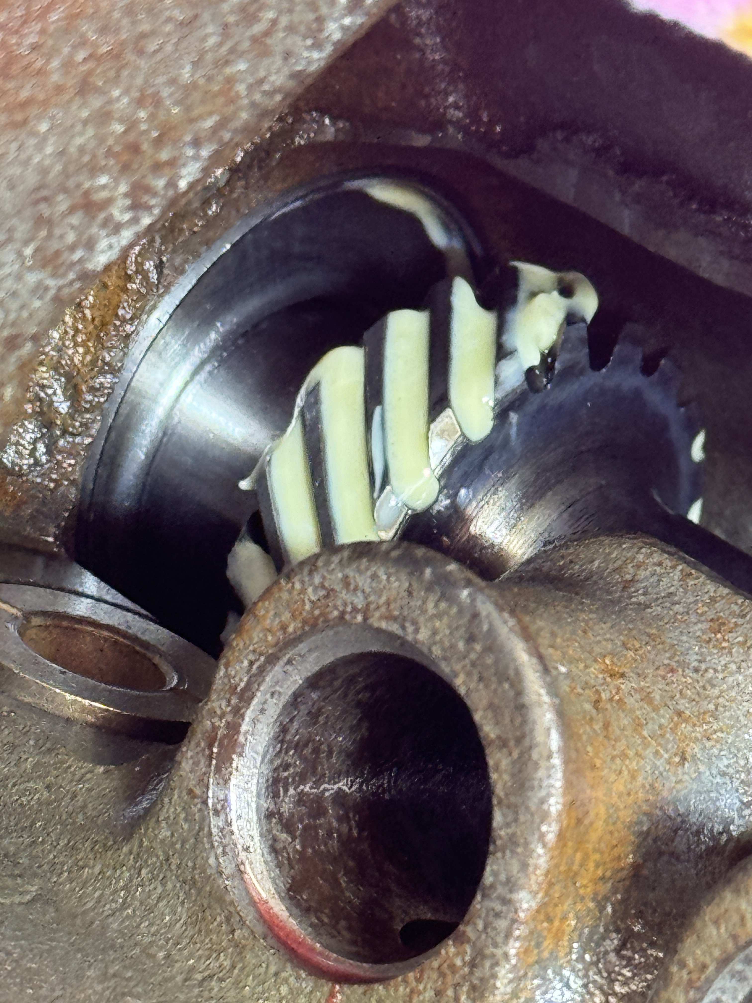

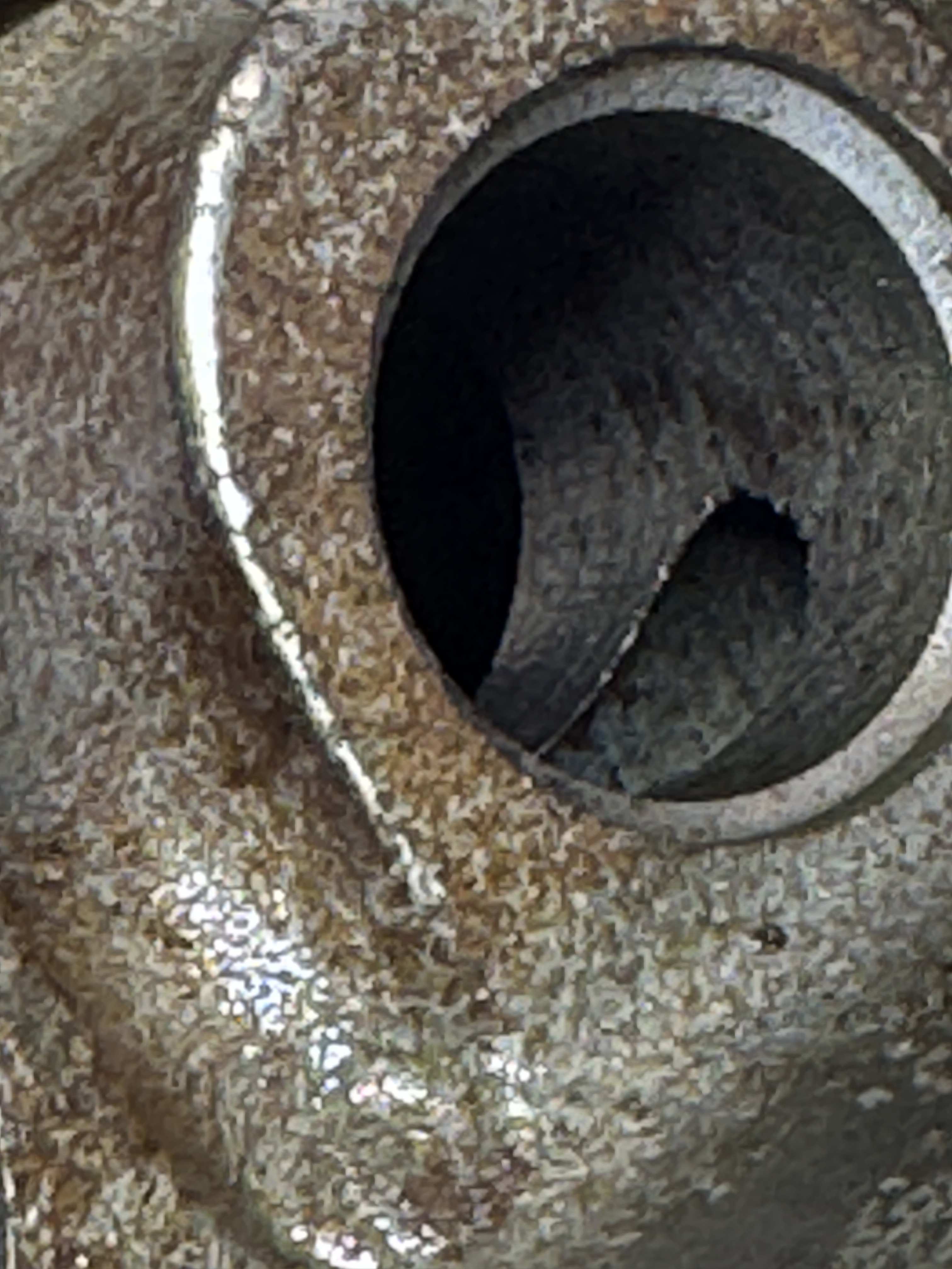

Sep 29, 2024 #2 G gtw940 Active Member Joined Jul 2, 2023 Messages 36 Reaction score 13 Location florida Howard’s roller lifters, fit is way to tight, had a hard time getting them back out. At ropes end with machine shop and mopar.

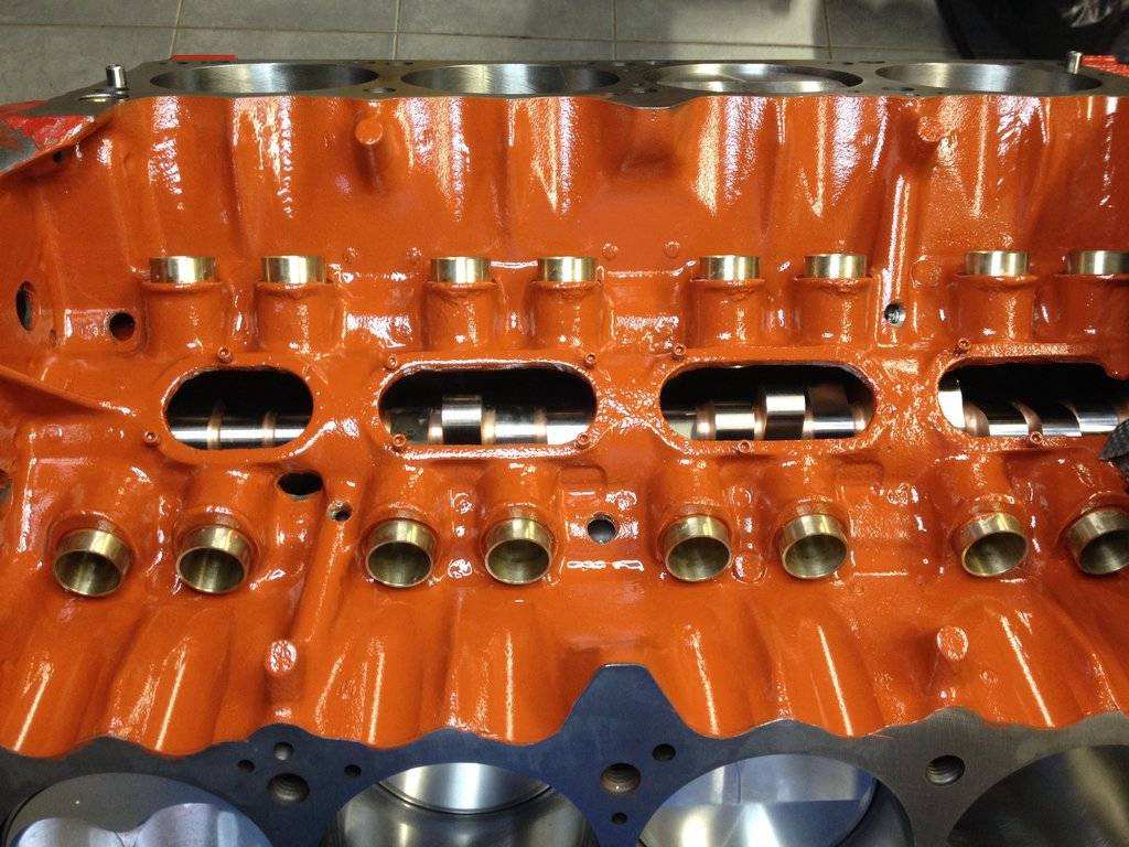

Sep 29, 2024 #3 Xcudame Well-Known Member Joined May 27, 2023 Messages 1,562 Reaction score 1,175 Location Southeast Arizona I've posted this before. If I was going to run a roller cam and lifters, I'd go the route in the photo below. When you want to go fancy, you have to pay the price. Otherwise you're compromising.
Oct 6, 2024 #4 C cudamark Member Joined Dec 12, 2009 Messages 18 Reaction score 3 Are we seeing a crack here? I wouldn't run it like that if it is.
Oct 6, 2024 #5 S Steve340 Well-Known Member Joined Sep 19, 2016 Messages 978 Reaction score 393 Location New Zealand They will need to lightly hone those lifter bores - that will probably resolve the problem. It will need to be stripped and cleaned unfortunately.
Oct 7, 2024 #6 Adam Well-Known Member Joined Dec 25, 2012 Messages 1,662 Reaction score 721 Location Washington Did you ask the machine shop to machine the lifter bores, when you dropped it off?
