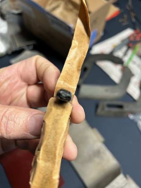

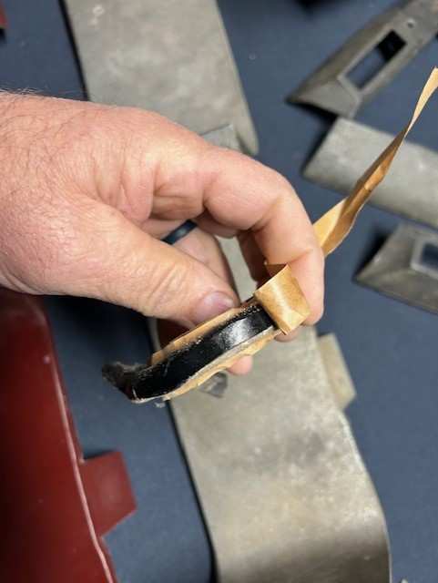

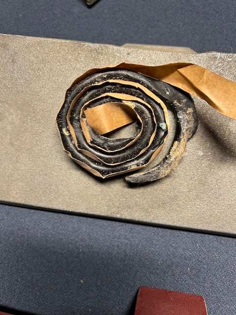

Use 5/16 butyl if you are using original glass or the same thickness. Be sure to us some Pinchweld primer for Butyl tape for best results.
5/16" butyl - flat both top/bottom ( shown in pic's )
rounded on sides.
Not round type ( for the round will smash down too thin = 1/4" )
I would mock up glass with all clips in place using dry rubber spacers tacked on - to then snap chrome window trim in place checking for fitment. Some places you may have to add a Stretched piece of 1/4" to thin it with a hair blow dryer for certain areas.
I do Not use caulk sealants due to future removal is messy/difficult. ( another story with that... )

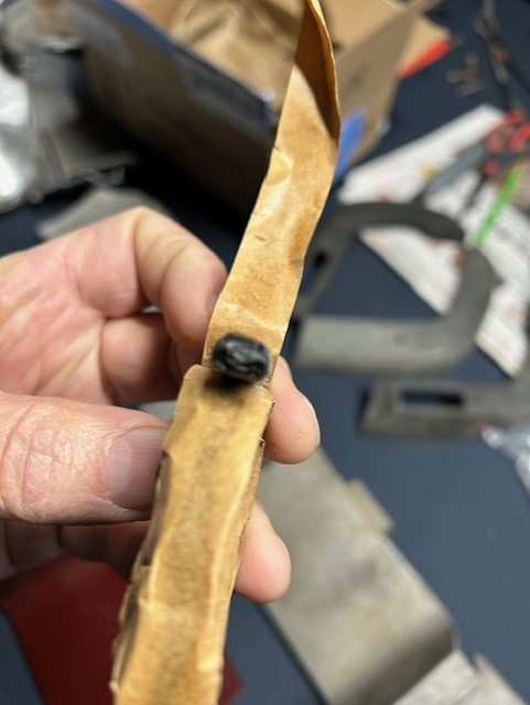

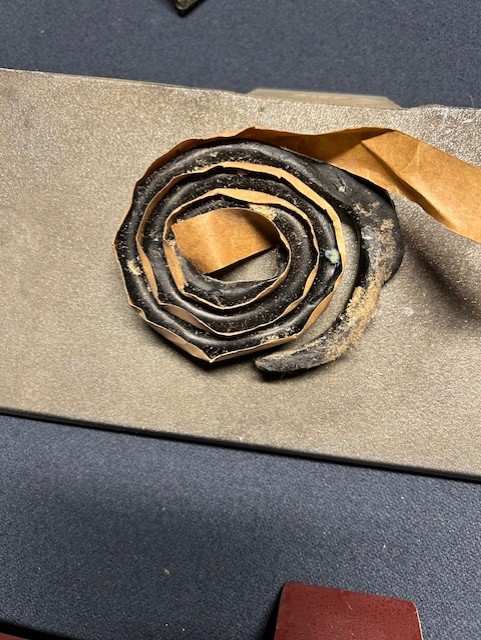

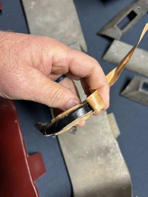

rounded on sides.
Another thing to mention is how new is the rubber. One time I ordered from an Auto parts store, they found it in the back. Was not sticky - looking at the label it was couple years old.
A new roll will be sticky to the touch.
