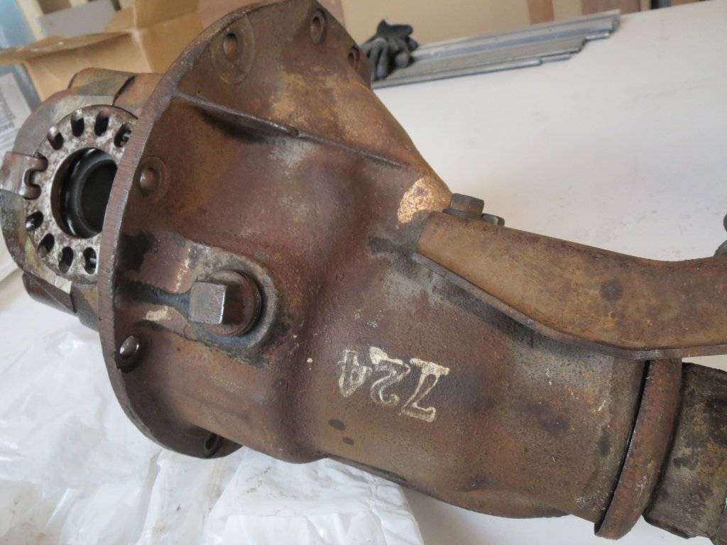

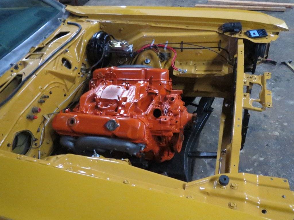

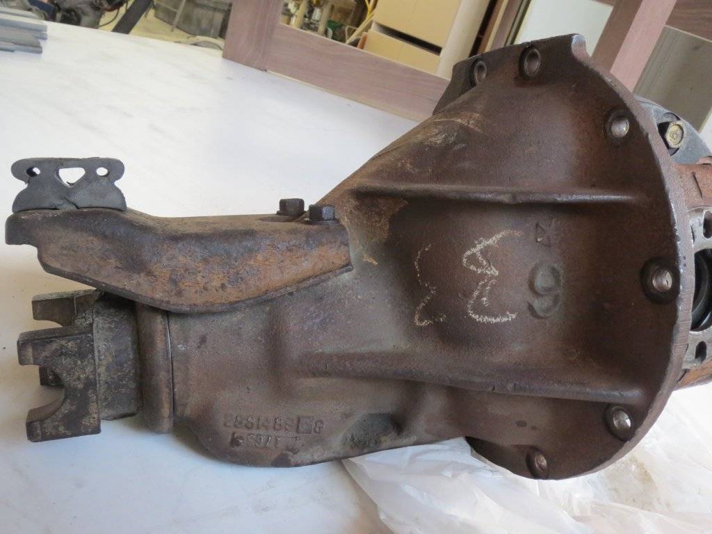

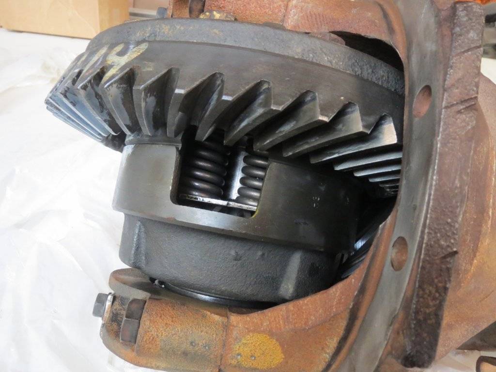

Ok so I got the Imperial back on the road for the season and its nose to the grindstone on the vert. I had to have the 3rd member rebuilt for the Imperial so I handed over this 3.23 SG I was planning on using in the vert at the same time to make sure it was tight. All the bearings and seal were replaced and with the acception of a new rubber bumper it's ready to go.

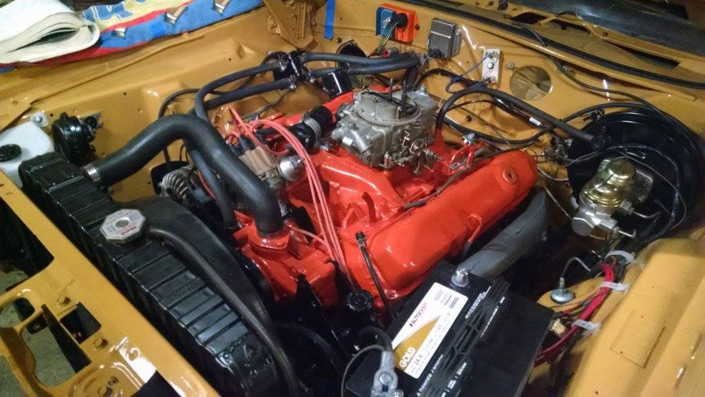

Man, that 383 looks great!
Can't wait to hear how it runs with the rebuild you did on it.

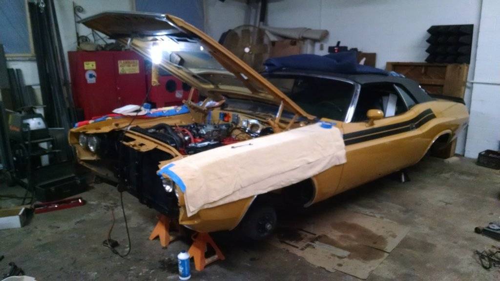

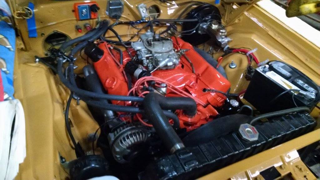

Well there's good news and bad news. It does run, it sounds great, has good oil pressure but I'm out of time to finish putting it back together and still be able to put some miles on it before the trip. We are leaving in 4 days and there's still way too much to do. I'm disappointed but I've been working both on it and client work for over 12 hours a day, 7 days a week for several weeks now so it's going to have to wait till we return. The Imperial is ready for the trip however and I'll say that it's probably a better choice anyways for a trip like this. Modernized stereo with MP3 jack, freshly rebuilt 4 piston front calipers, freshly rebuilt rear center section and an interior fit for no less than 4 executives. I drove it to Carlisle a couple of years ago and it was a pleasure then in spite of the fact that it sounded like a fleet of Huey helicopters was following me because the rear end was shot when I bought it. I will share some photos of the journey even though you guys are mainly E-body enthusiasts.

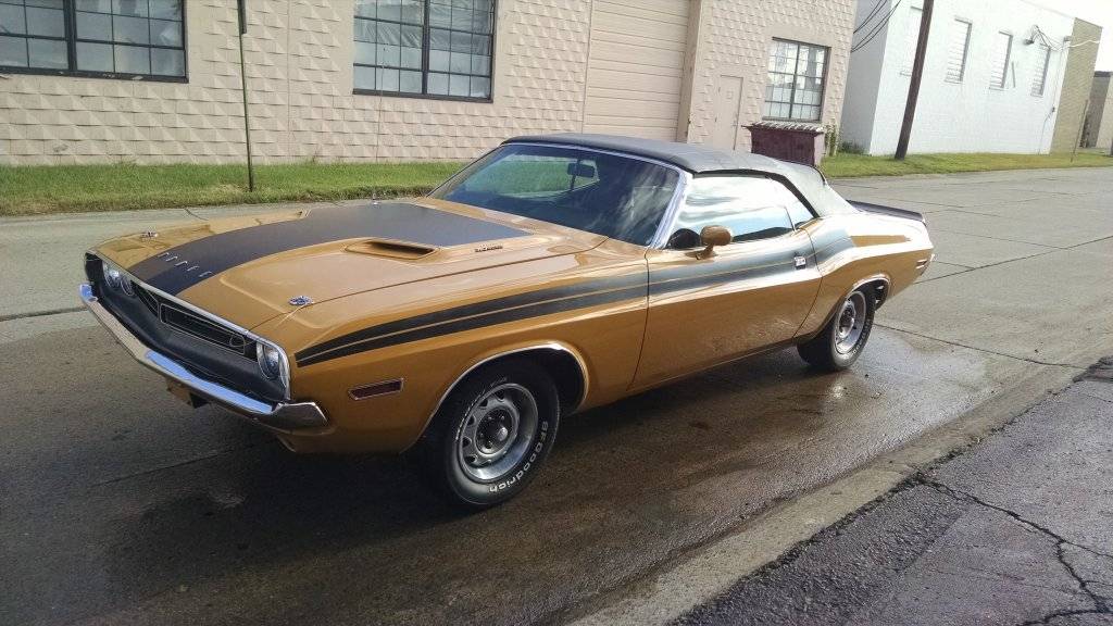

Haven't updated in a while so here goes.
I have been busy since my return from the trip but managed to get it back on the road after chasing a particularly pesky oil leak, I don't want to get into except to say it ended up being a damaged timing cover that made us think it was leaking from the oil pan.

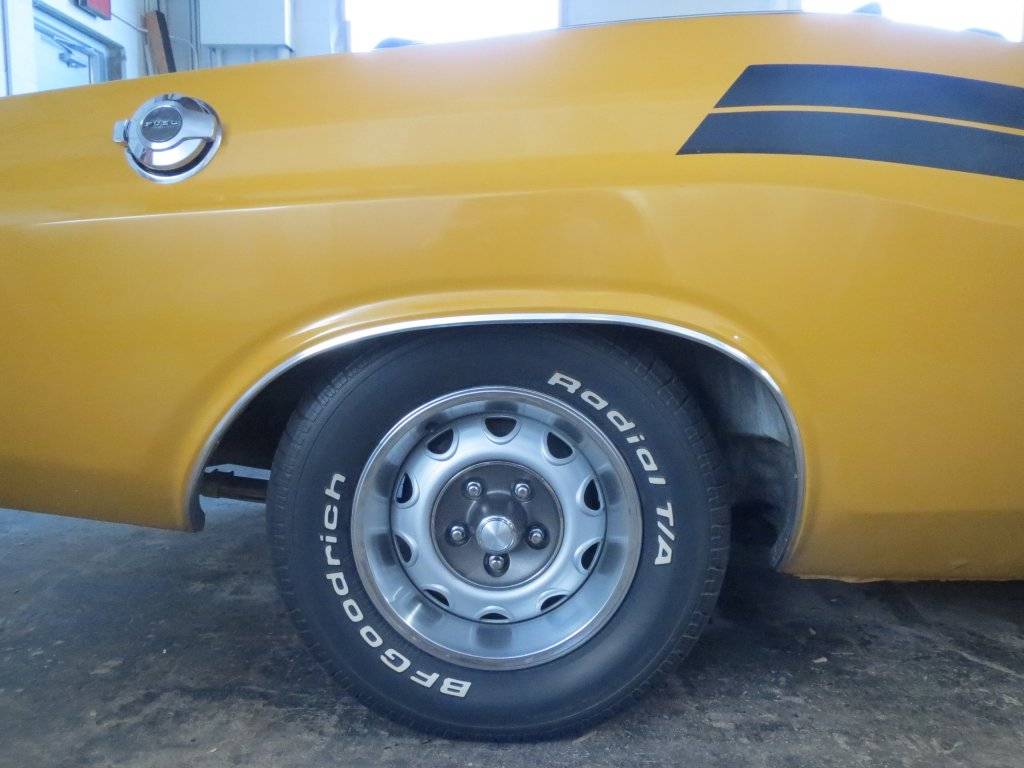

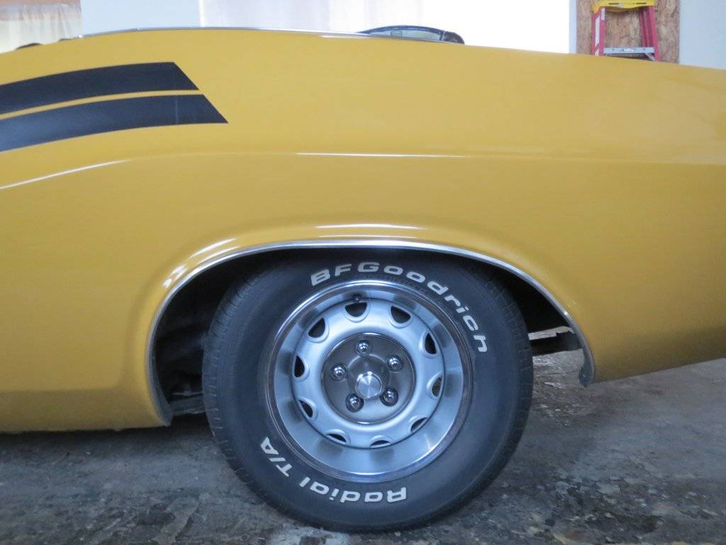

After reassembly I took it for a front end alignment and they proceeded to tell me that they did the best they could with how shot the rear springs were, one side was an inch and a half lower than the other in the back, lol!. I was aware that the rear springs needed to be addressed and actually had a pair of take-offs that were in really good shape stashed away for this car. I took them up to the local spring shop and had them checked and re-arched, painted them up and I'm installing them now along with a pair of new shocks as the old ones were also shot, maybe even the originals. Pics to follow.

I wish I would've taken a better pic of how low the rear was looking after the front was set to its factory height. Somebody must have cranked the bars down to match the saggy rump through the years.
