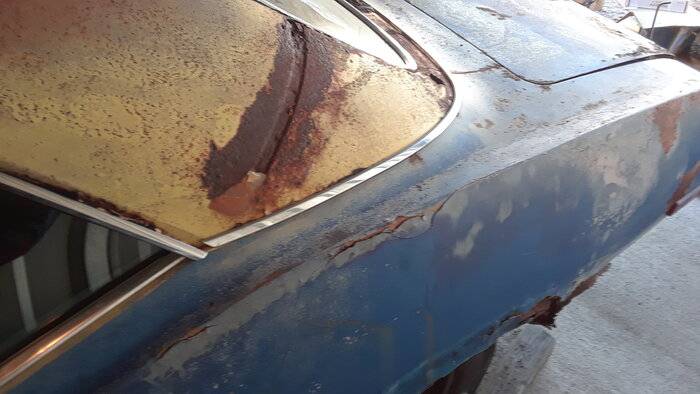

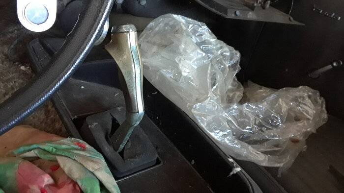

Hi Sportsfans. I'm wondering what to do with 'Shelia'?
She's a 340 Pistol Grip car. THERE'S NO FENDER TAG! I haven't looked for a build sheet.
She's been sitting outside since around '85, and the last tags are from '89.
The clock shows 16xxx.
Is she too far gone to restore? I don't have nearly enough $$ for me to tackle this project.

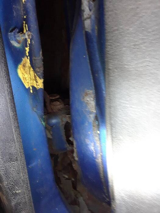

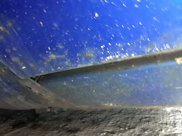

I had a guy look @ her this AM, Mark Grafton. He said that the floors and rails look pretty good.
Thanks for looking.

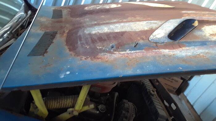

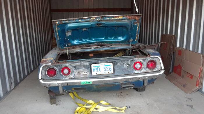

I'm surprised that the floors and rails look pretty good as it appears all the outer panels are in need of replacement. Roof, quarters, fenders, hood, dutchman's panel, doors possible rockers and a pillars. Likely with the rear quarters in such poor shape, the inner's are in just as bad of shape. The trunk is beat as well since there was obviously water getting into the trunk through holes in the dutchman and deck lid rails.
I have to say this car is pretty beat. And I don't like saying a car can't be brought back.
Not having the fender tag hurts the rebuilding of this car.
You would do yourself a huge favor by looking for a build sheet as that might be the only thing that puts this car back on the road again.
Perhaps there is a restomod guy out there looking for a car to make what he wants.
Problem is with a car in this shape it's gonna cost minimum 40K, most likely 50K to bring it back to par. Not meaning an OE restoration but a good driver quality car restoration. Then the car will only be worth 35K to 40K on the market. 2-4's just don't hold much more value than 40K at the top end. Even if they have 80K worth of money put into them.

I have bought, owned, and sold lots of ebodies. Barracudas are my speciality. All of my cars are from Texas and pretty much rust free. 70-71 sell very well. 72-74 Cuda are not as easy to sell. People want 70-71 when building clone car, too. That car must have been around salty air because it appears to be rusting from the inside out. I’m afraid it’s a parts car and would be hard to fix. I’ve seen people foolishly spend money on a car like that because it’s cheap. Then they get it apart and realize they are screwed. What is worse, someone will take a car like that and hack it together cheap with new panels and paint and sell it. The new owners buys it over the internet and gets sick when it’s delivered. The fact that it is a Cuda will have little effect on the value except for the value of the motor trans value. You’ll get some guy to give $5000 or so and he’ll regret it. Lots of people have $5000 to spend. It’s the $50,000 to fix it they don’t have.
If he had the fender tag and build sheet it would be different. The 340 and 4-speed will have some value that is why I asked if it ran. Fastmark hit it on the nose.
