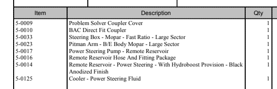

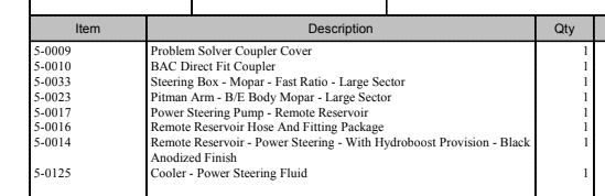

I installed the Hydratech booster you linked to along with a new power steering pump, steering gear, and related goodies below from Bergman on my 74 Challenger. Both Jim at Hydratech and Peter Bergman were great to work with and responsive to any questions I had. The installation couldn't have been much easier and the system works great.
Thanks @Bret Schneider. Good to know I'm on the right track. Curious to know why you changed the steering components. Not liking that classic Mopar vague and numb PS feel? I will be looking into a new PS pump with the dual low pressure inlets while everything is apart - might as well make one big mess while I'm at it :)

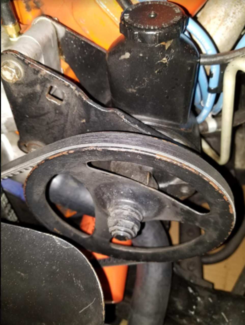

According to Jim @ Hyrdratech, and confirmed by Borgeson, there are two Saginaw pump options depending on the type of pulley your existing Saginaw pump has:
Use part #800309 - if your Saginaw pulley is nut retained with a key-way style shaft (like mine - see image).
Use part #800323 - if your pulley is the Press-on type.
I got the Borgeson PS from Summit (BRG-800309) since I had a free shipping offer!
Now waiting for parts...

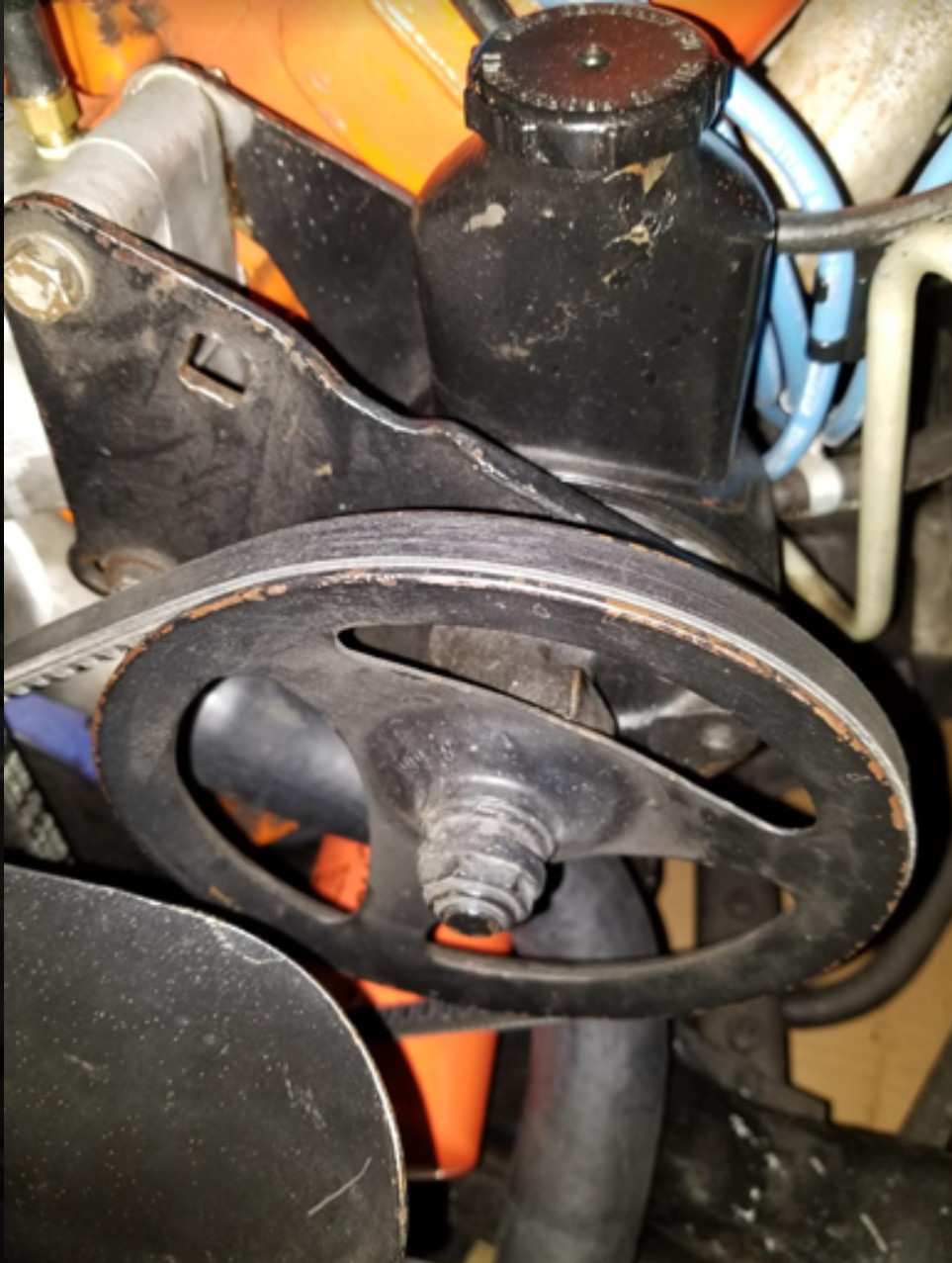

Update 3/11/24:
Ordered the Hydratech hydro-boost kit today. 30 to 90 day lead time :-(
After speaking with Jim @ Hyrdratech I also ordered a Borgeson PS pump for Hydro-Boost Brake Applications (Dual low-pressure inlets).

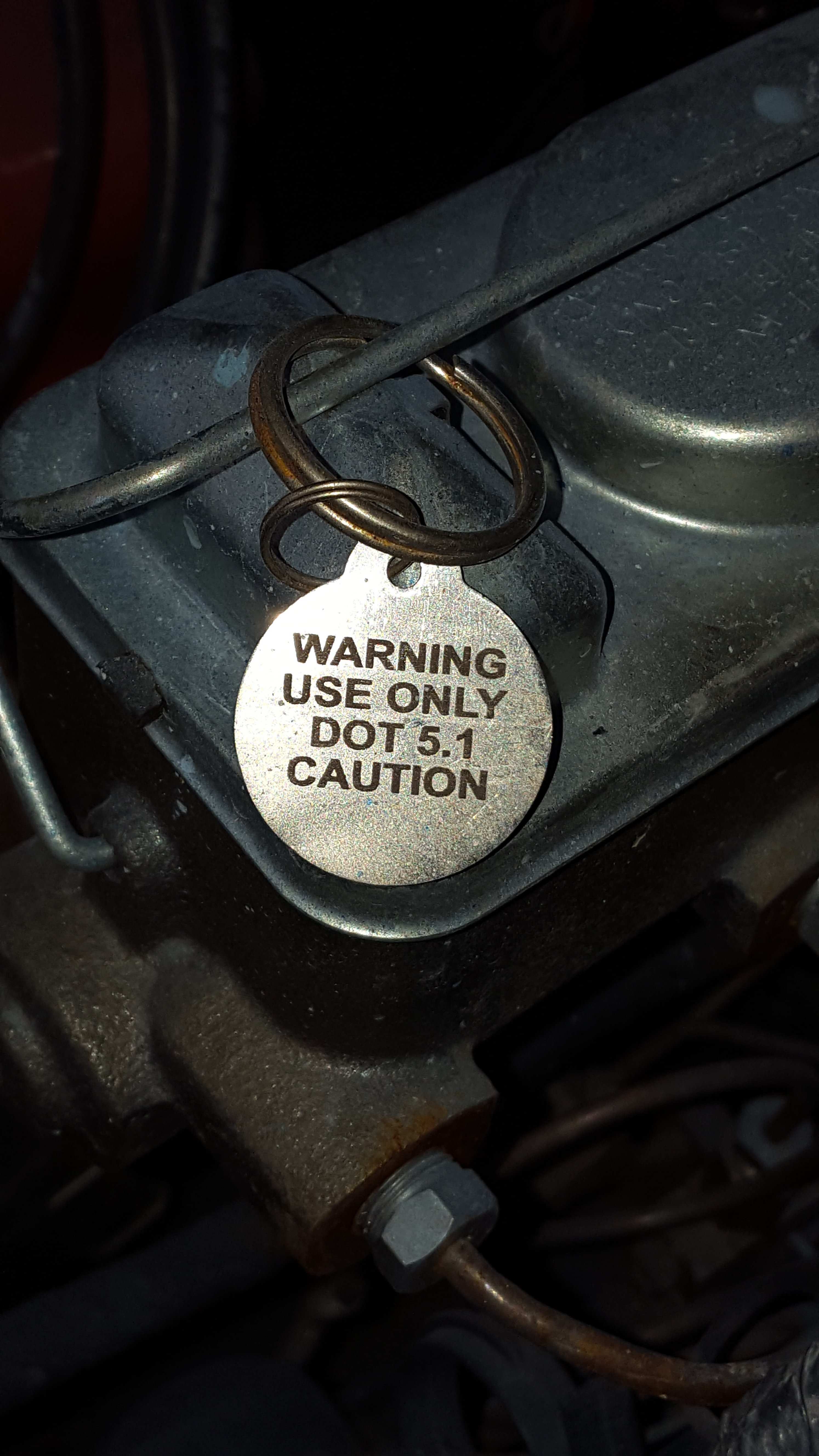

@61K T/A - what brake fluid will you use? I've heard good things about DOT-5. Thinking of using DOT-5 instead of DOT-3 since I'll basically be replacing the entire braking system. How about you?
1972 AAR Cuda
Sep 24, 2019
201
149
Washington state
The issue (I have heard) is that the DOT-5 fluid is not compatible with DOT-4 or DOT-3 fluid. I also understand the DOT-5 doesn't add anything (feel or performance improvement) over the DOT-3/4...
I do not know this from first hand experience, but something to keep in mind or for future reference.
I would be curious if you know this to be true - for my future reference, since I am looking to go the same route with a Hydra boost system in my Cuda project.
Challenger RTA
Oct 28, 2018
3,307
1,741
PA Flood city
STANDARD POWER BRAKE FLUID
Brake fluids are all technically synthetic and are not petroleum based. The Department of Transportation (DOT) class system sets standards and testing procedures only; the ingredients used are up to the manufacturer. If it meets the standards, it will qualify as “brake fluid.” Based on a combination of the properties determined by testing, glycol based brake fluids are labeled DOT 3, 4, or 5.1.
DOT 5.1 brake fluid was once a specialist brake fluid used in race cars and other high performance application. But, recently it has started to show up on the shelves of some retail and internet part sources.
DOT 5.1 is totally different than DOT 5 brake fluid. Think of 5.1 as a glycol based DOT 4 fluid that meets DOT 5 silicone-based fluid standards. The 5.1 fluids are used primarily in vehicles equipped with ABS brake systems.
Unlike glycol based DOT 3,4 and 5.1 fluids, DOT 5 silicone brake fluid will not absorb water from the atmosphere or act like a paint remover. Silicone has very high dry and wet boiling points. It is also more compressible and can absorb more air than a conventional brake fluid.
DOT 5 does have its applications. If you own an extremely rare car that has expensive or original paint, DOT 5 is the fluid for you because it will not eat away the paint if spilled. But, if you use DOT 5, you are almost required to bleed the brakes before you go for a spin. Why? DOT 5 is lighter than water. Any moisture will pool at the lowest point which is typically the calipers or wheel cylinders. Many classic cars have been lost after the owner decided to shake loose the cobwebs before bleeding the brakes.
