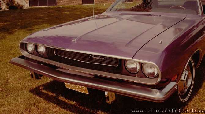

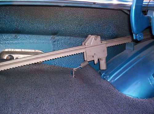

The 2nd challenger I got build date 3 71 hand the hook bumper. My opinion if it was mid or late year 71 build date it would be the slot bumper. That would all depend if they had a change date or depleted the stock.
2nd picture hook bumper jack.
I opted for the jack hook delete.
