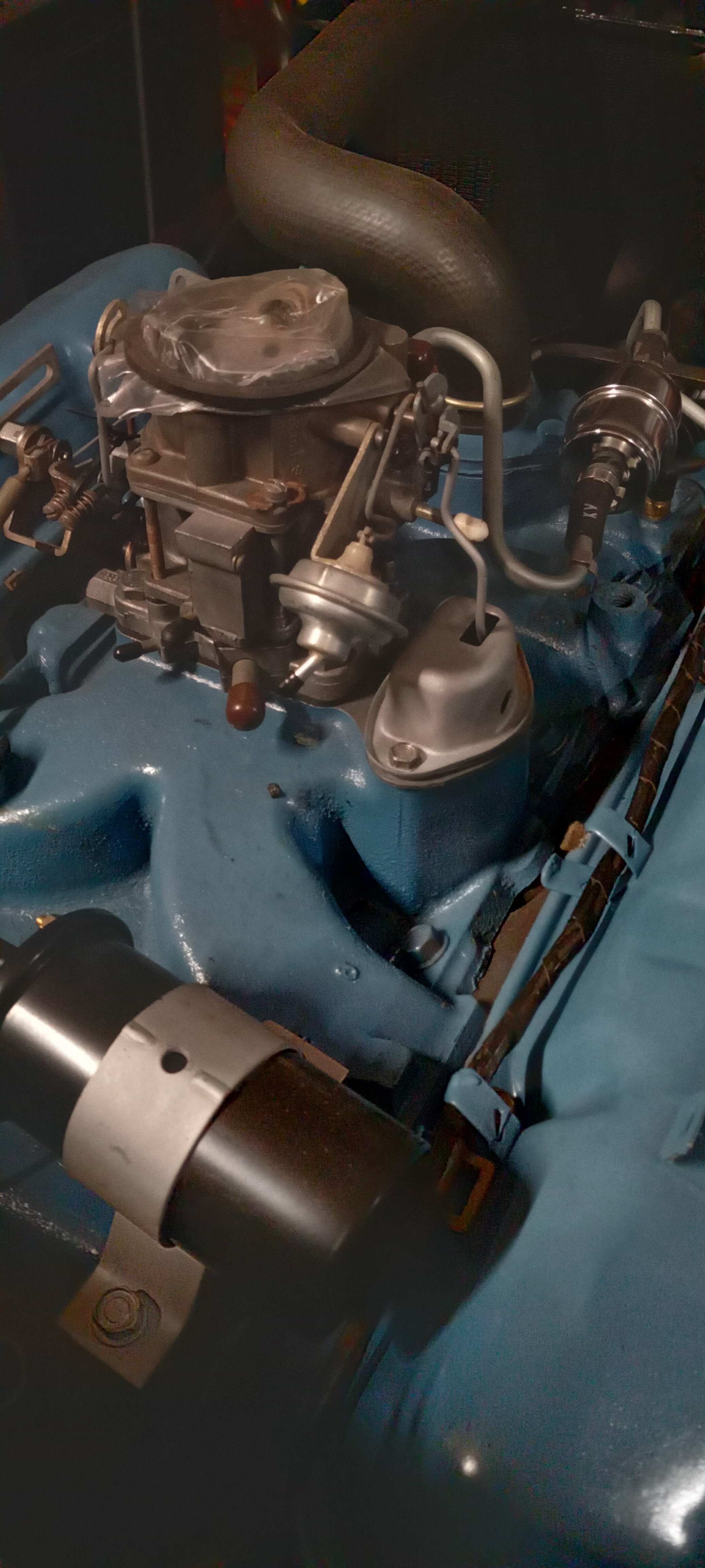

Does anyone have a picture of all the rubber hoses on a carter 2 barrel carb.

318 all original. Wanting to know where all the rubber hoses go? Got some figured out. But a visual is the best for me.

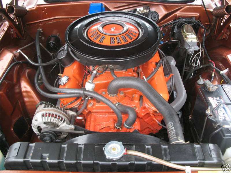

This might help. this shows the valve cover breather. I think the pvc is on the the back of the carb.

Thanks for the pic, it does help. Hoping to get one without the air breather on.

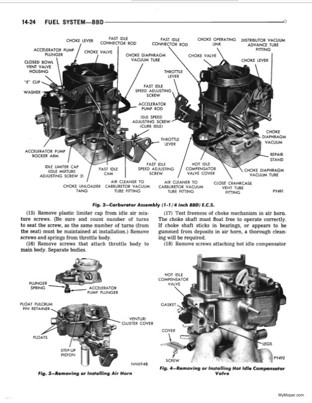

It looks like you have the BBD carb. Here's the photo for it in manual.

Got books of the carter carb. Would like a pic of a 318 engine with the breather off, that shows where all the rubber hoses go.

Look at your carb the brown plug you have on the bowl vent goes on the valve cover vent. the larger one on the valve cover vent goes to the back of the air cleaner. the vent line plugged with a blue cap also goes on the valve cover vent. what else is your concern? That would depend on the parts you have.

I had a 318 -2bbl Challenger years ago. It seems like the one brown rubber cap goes to the black breather cap on the valve cover and the other brown cap goes to PCV valve. The one black cap on back of carb goes to choke diaphragm and the other goes to distributor vacuum advance. One vacuum port goes to air cleaner. That's all I remember now. Sorry. Hopefully, someone has a good photo of what you need.

Thanks Terry, just trying to get it correctly back together. Has been 7 years. Lost the pic when torn down.
