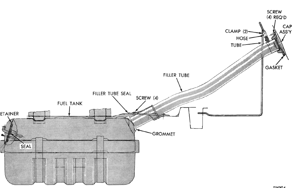

I will check this diagram out and see what I haveCheck to make sure the VENT tube has a tube on it that runs outside of the trunk compartment. It should vent down under the car to the frame rail.
A previous owner of my Challenger had removed that line at some point, for some unknown reason and I had really bad gas fumes inside the car until I finally figured out that the vent line was missing. Fumes were just vented inside the trunk from the gas fill pipe, smelled so bad that I could hardly stand to drive the car. Installed a vent tube going under the car to frame rail and problem solved.
This is for a 70 Challenger, a Cuda may be different, and then again maybe not.
