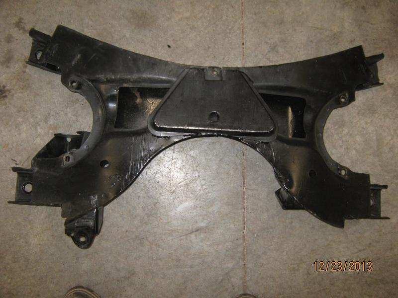

I'm pulling my 318 and installing a 440. I have the correct mounts for the swap, but recently heard I need a BB K Member. Is this true or a SB original K Member with the correct SB to BB mounts will work?

All V8 K frames are similar & will work except for the Hemi .
The 318 K frame will not have the skid plate but that can be welded on if you want it later so with the correct mounts for the 440 it will drop in .

This is correct - I swapped in a 440 into my 1972 340 Barracuda using the original K-frame. I am pretty sure I used the stock 440 brackets and motor mounts for the swap - I would say more definitely, but its been almost 30 years. I did used the stock small block K-member though.

Is mention, the only difference is when the 440 was installed, a skid plate was added. Certainly a great upgrade is to install the skid plate and run a 6 quart oil pan! Definitely a great time to swap in new bigger torsion bars too, something around 1.00" diameter is highly recommended.

Worked for me. 440 with its original mounts dropped right on the 318 K-frame with no modifications. I went with the e-body 440 torsion bars and added a sway bar.
