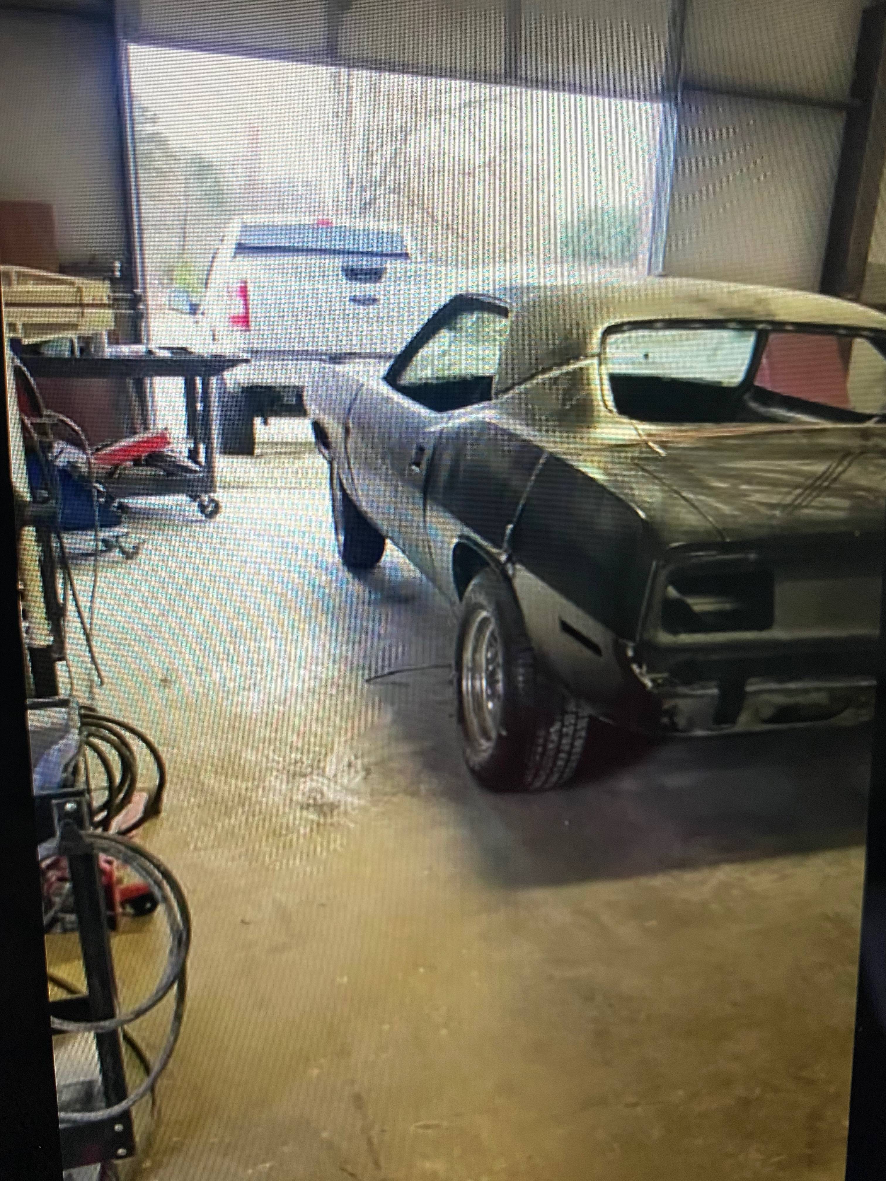

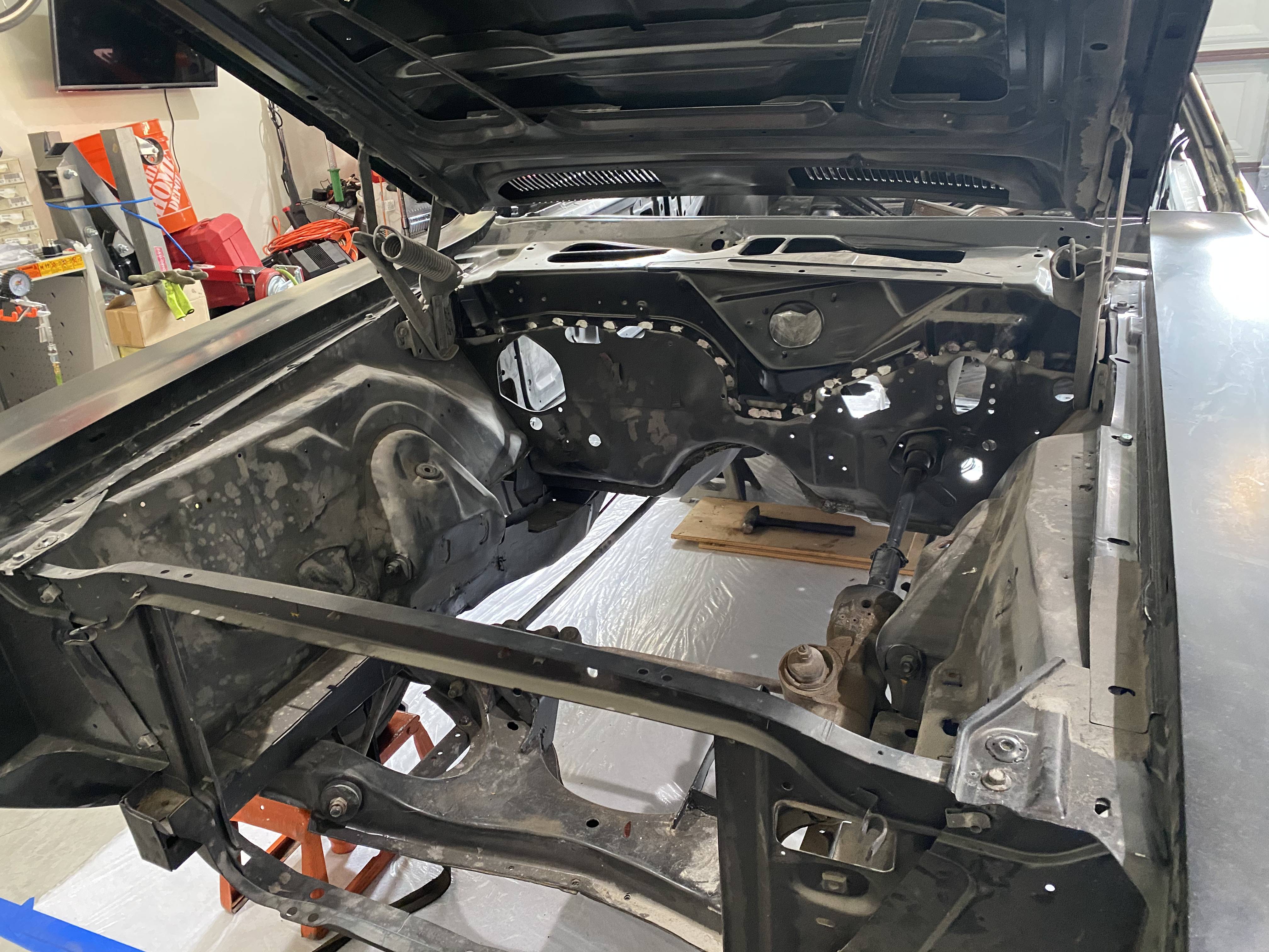

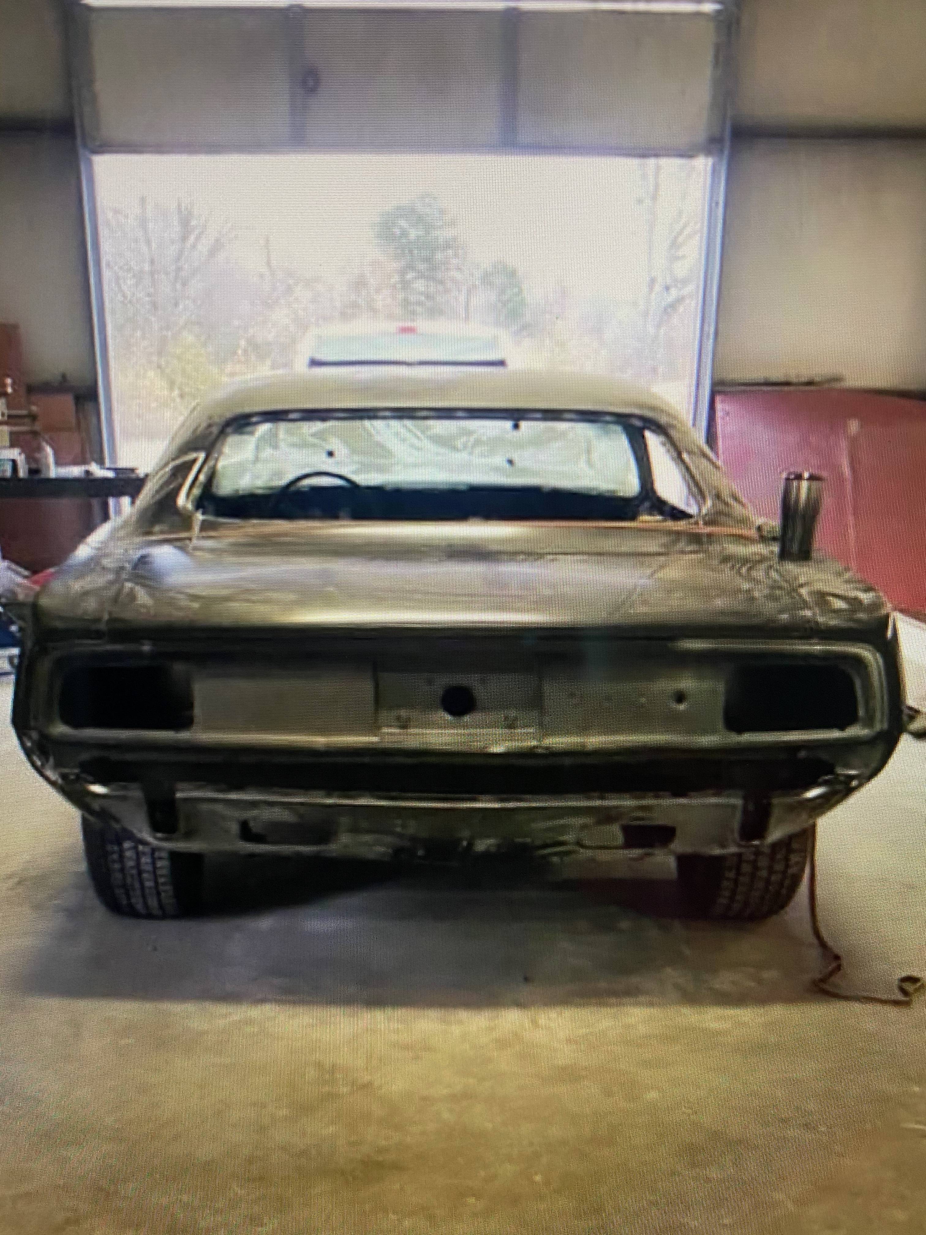

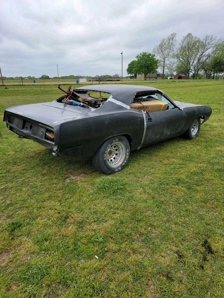

Hello folks, so this is my second restoration project I will be documenting on here. I bought a 1970 Baracuda this week from a gentleman that got over his skies in this project and I will take it from here. Pretty basic Baracuda was 318 auto, will now be a Gen III Hemi- 5 speed manual when complete.
Was FE5 but want to go to B7 Jamaican Blue with black billboards. That may change down the road but for now, thats the plan. I should get it delivered in a week or so but here is what I am starting with. All new AMD metal put in. I have one question for subject matter experts. Both the Cowl and radiator support have been replaced but the number sections were saved.
Would you folks recommend cutting the numbers out and re-welding them in to the new panels? or not?

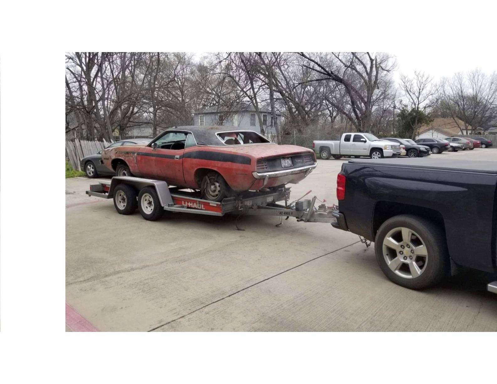

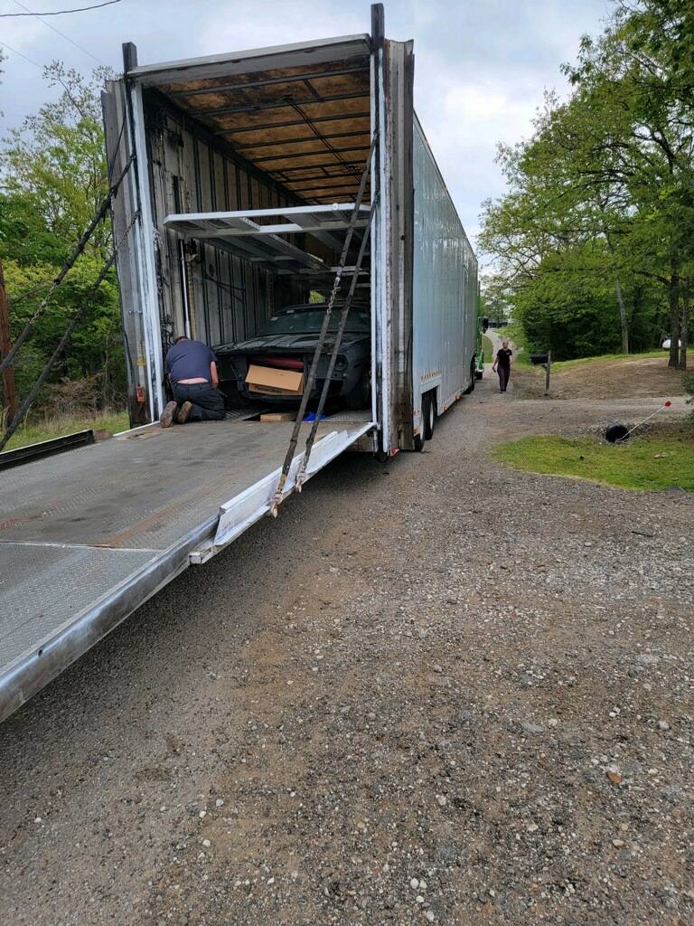

Ok She is on the way home to Cali.....Tuesday should be in my garage and then the fun begins.

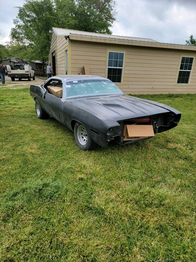

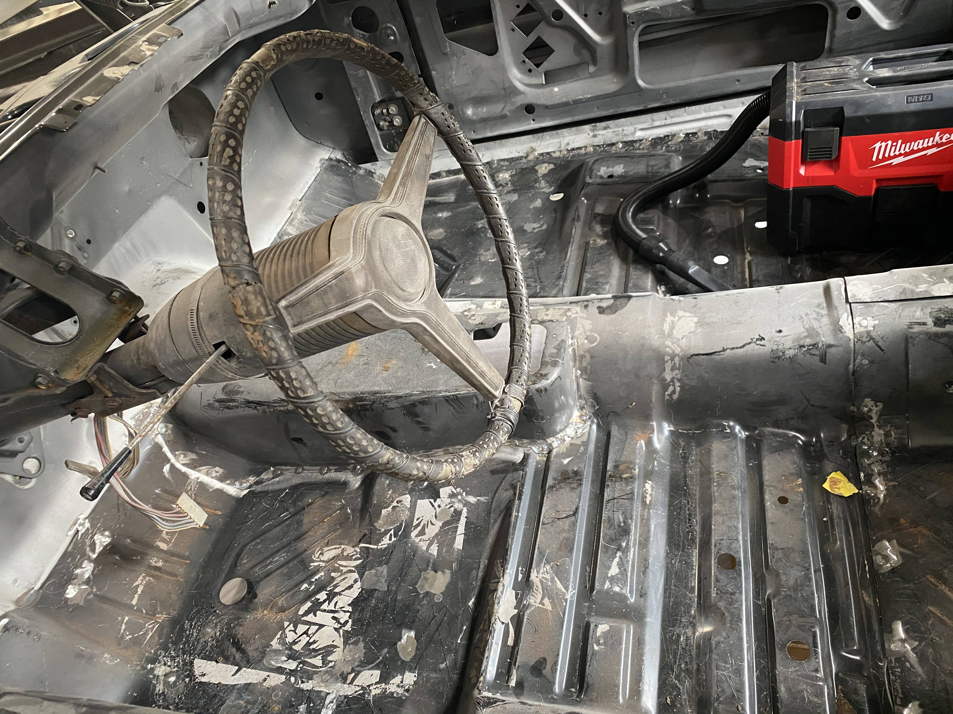

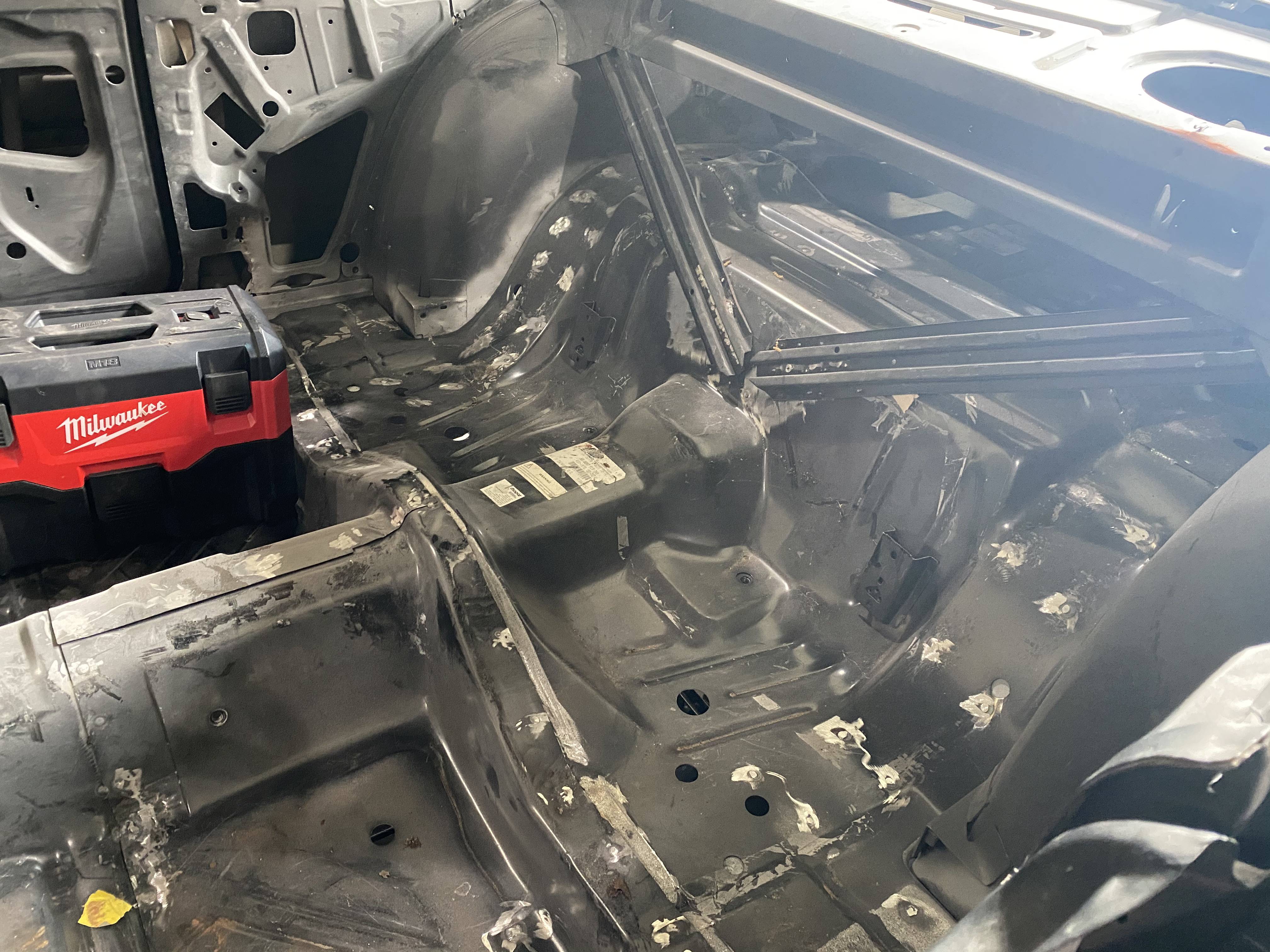

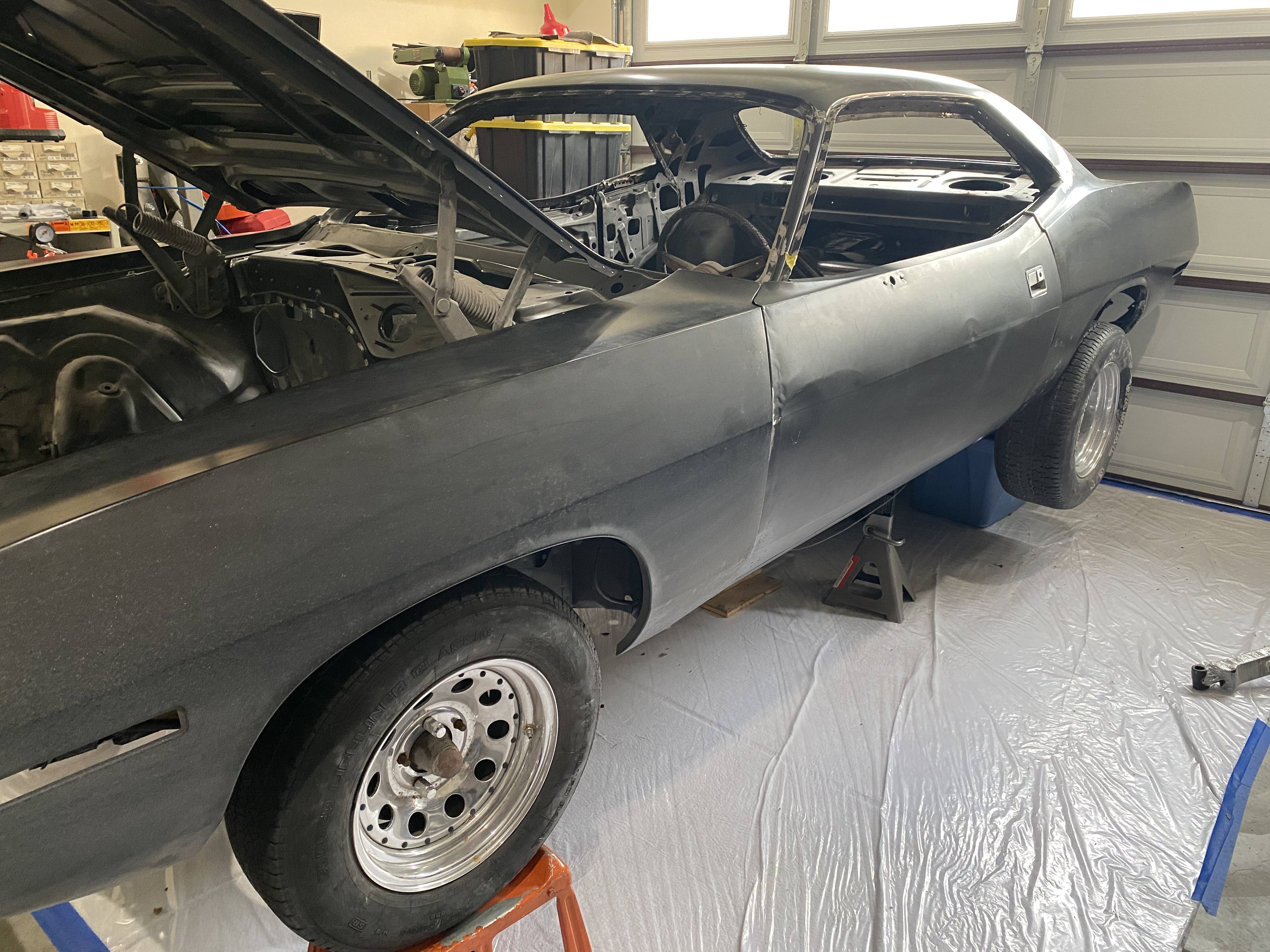

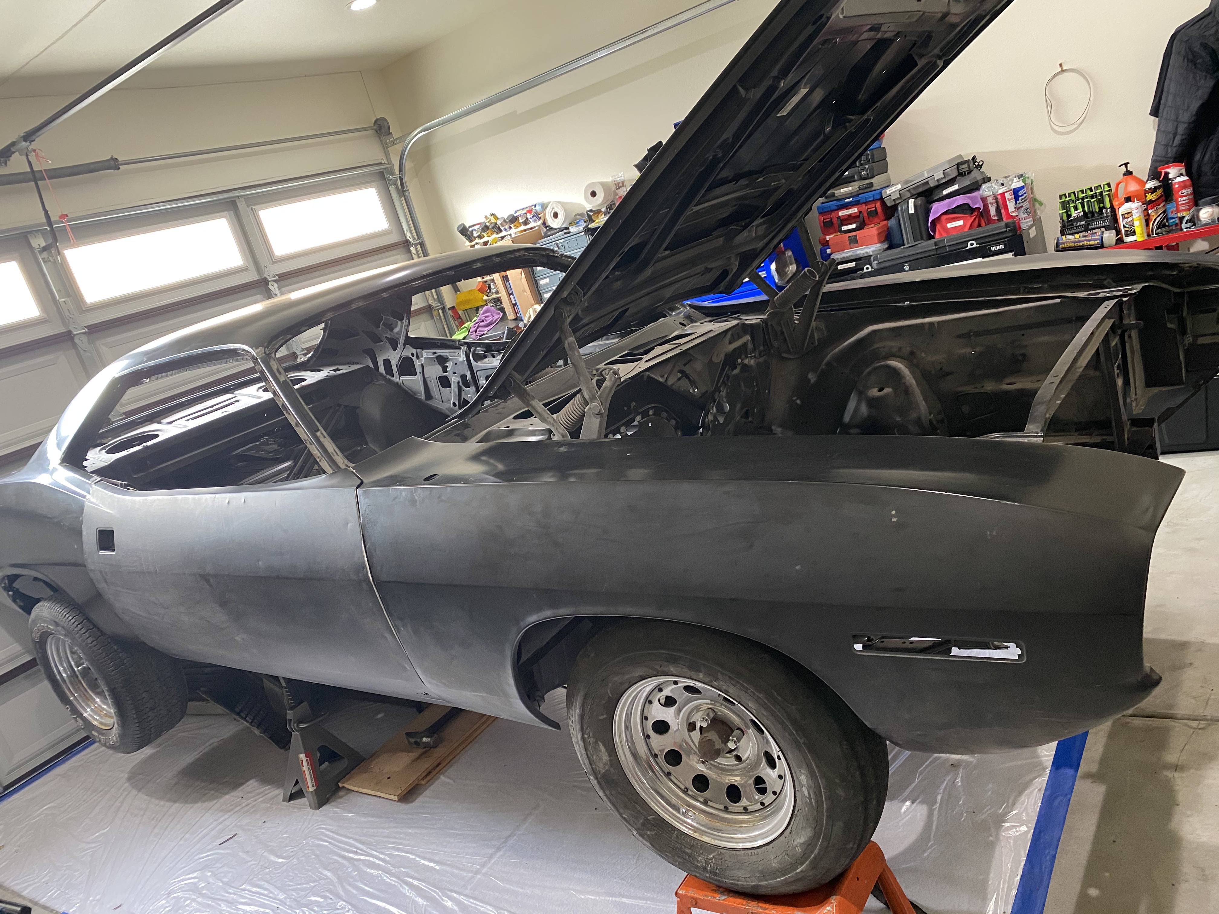

Well my new baby is safe at home in Cali.... now the hard work begins. I am going to need doors if anyone out there has a nice set?

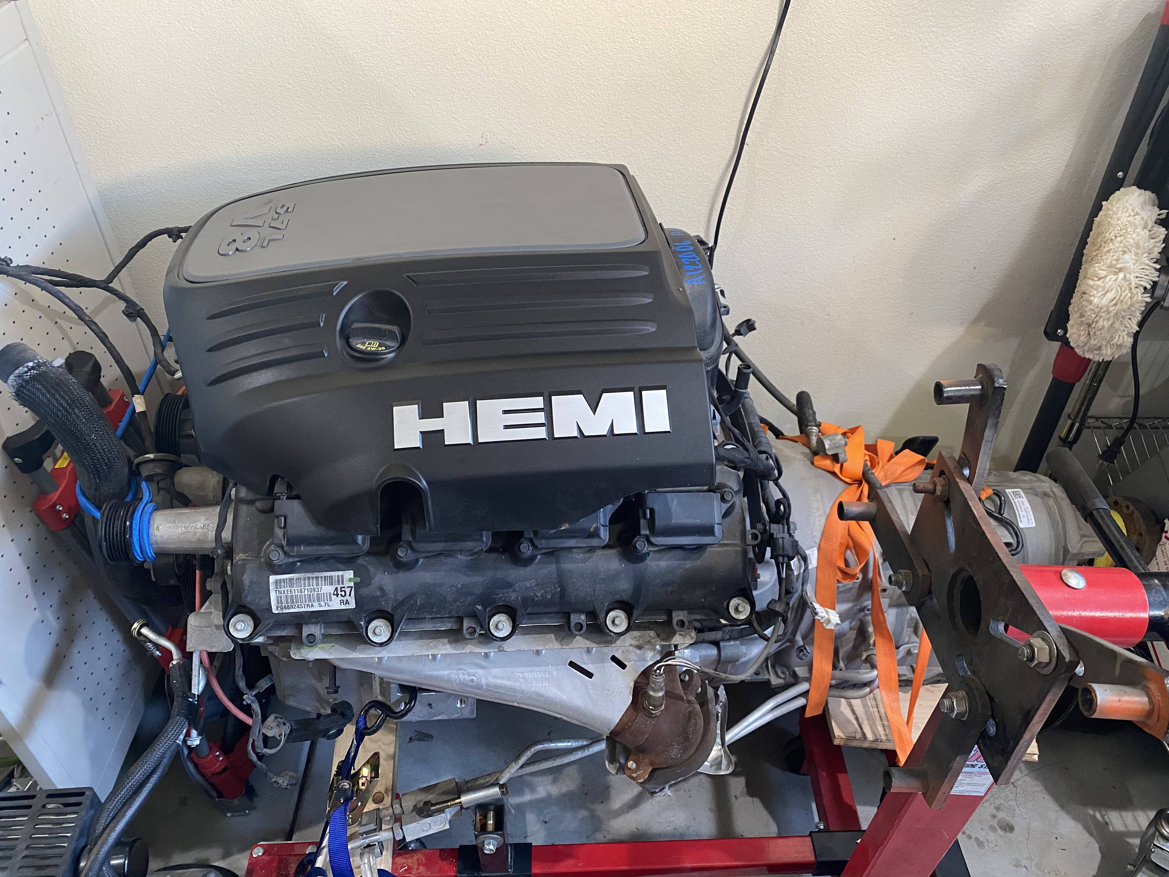

Got the Cuda's 2018 5.7 HEMI heart beat 29K miles and 5 Speed AT delivered to the house today. Can't wait to test fit it into the car before I start on the body work, metal work is moving forward.
Have to cut the Trans tunnel as previous owner just welded in a new 4 Speed tunnel...... ( hope I can save it )
i need to gather more information for suspension upgrades? Recommendations for this restomod?
I Have the original 8 3/4 diff, as I did not plan on replacing so I ask, feedback how will hold up under a 5.7 ?
