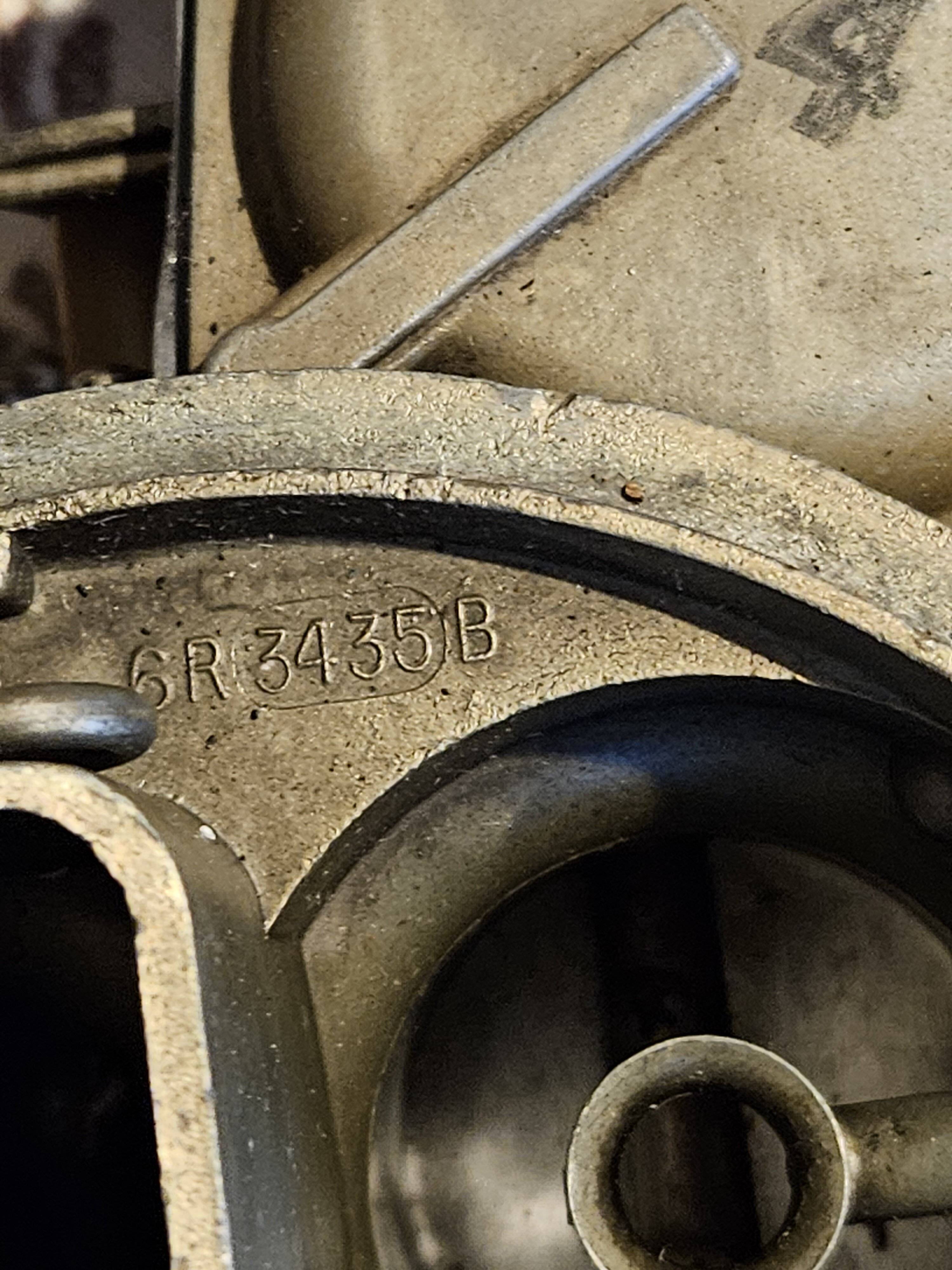

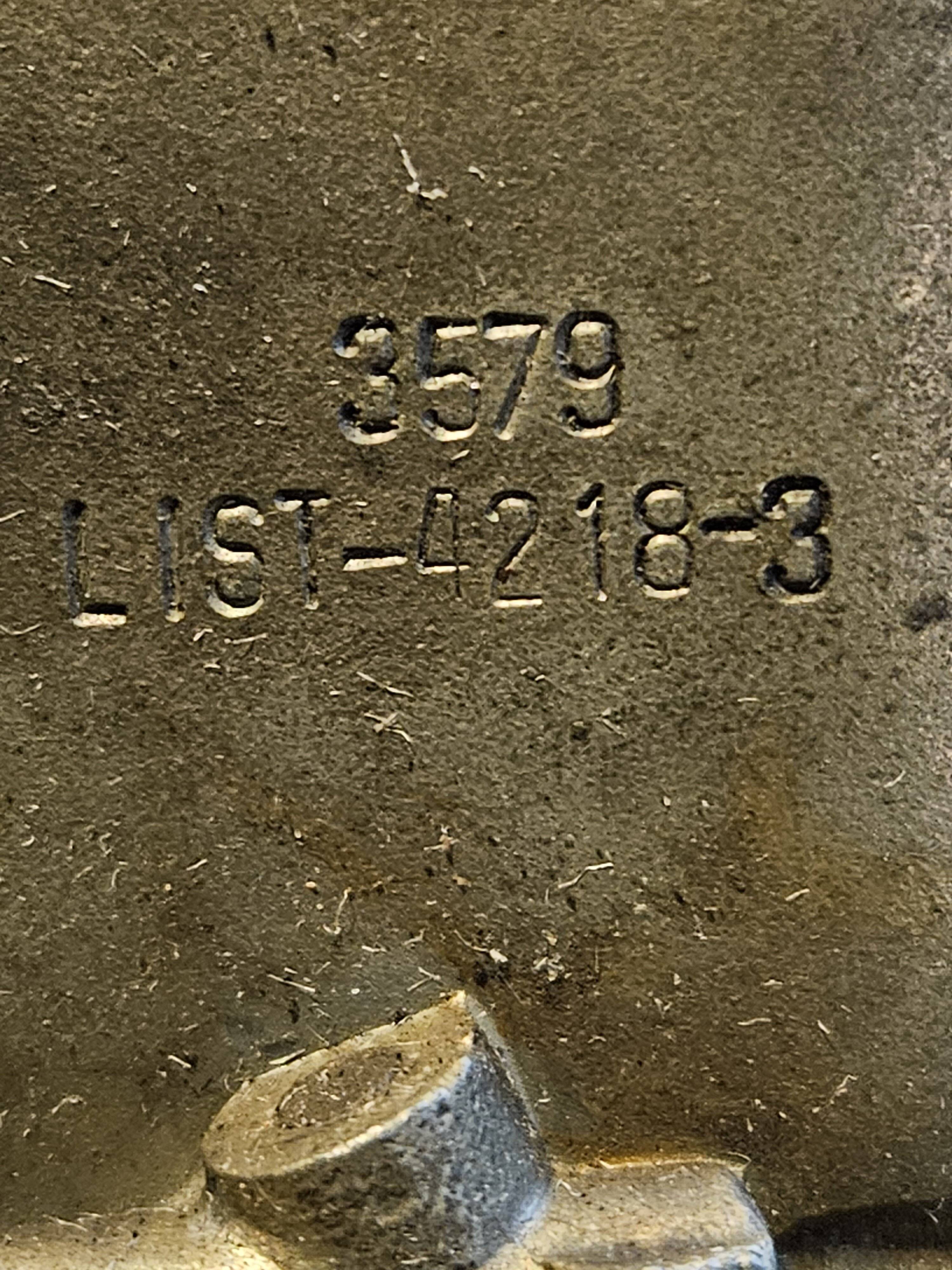

I found this carb.
Holley
3579
List 4218-3
Also has the number 6R 3435 B
What is this carb for? Can anyone decode this for me. I look at the carb identication list on here and I see similar numbers but not exact to this one I just got. Any help is much appreciated

The list on E body only that people have put up says my car should have numbers of:
Holley R4218-A and 3418 543 on the carb. All I see on the carb I just got is.....
3579
List 4218-3
And 6R3435B. Is this still the correct one?

Looks like the correct one to me. Many Holley carbs indicate their model number by the LIST-XXXX and this one clearly states its a 4218. The Chrysler part number, in the form XXXX XXX is not generally imprinted on the carbs.
