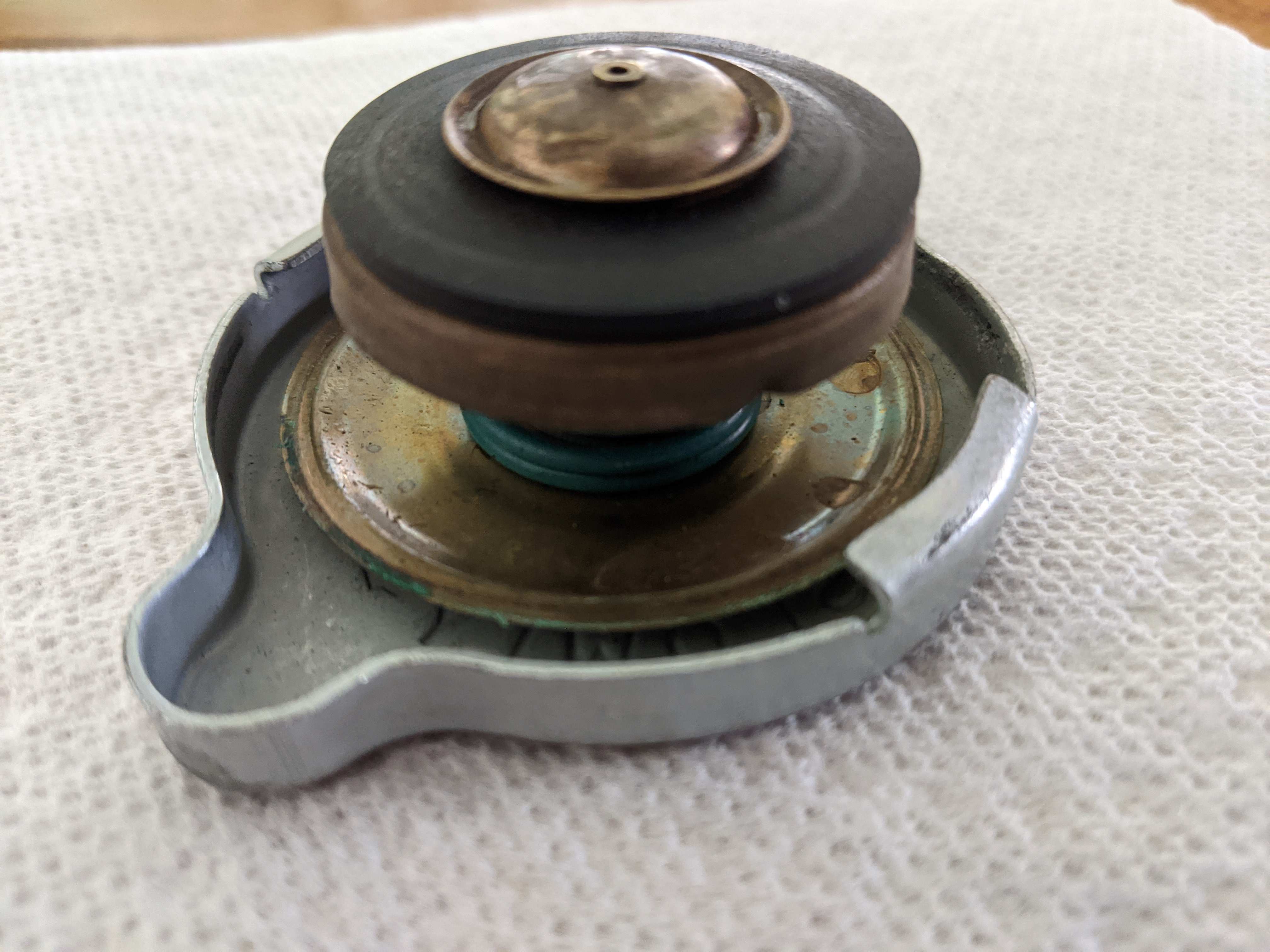

A recovery cap has a little flap valve right in the middle at the bottom of the cap were the water is.
You can pull it up with your finger nail.
A non recovery cap won't have this. The additional valve is the only difference between the two styles of cap.

Does your cap look like this? If you can pick up that center brass piece like Steve said your good to go.
