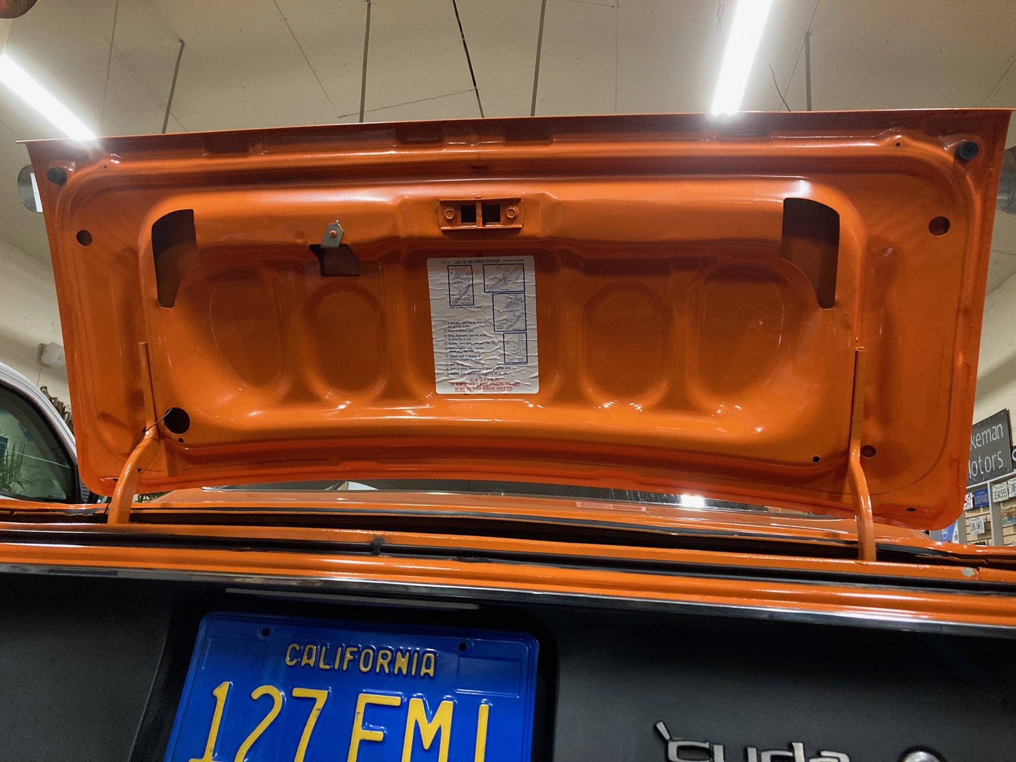

The photo is the deck I have and I believe it to be correct for a 12/69 SPD. The AAR cutouts per another response elsewhere didn't arrive until approx. Feb 1970 on all decks for the Barracuda line but correct me if I'm wrong.

Three main Barracuda/Cuda styles. Your Version 2 decklid is correct for a 12/69 SPD.
The Version 2 decklid introduction date should coincide with the GoWing spoiler introduction which is believed to be Mid-November 1969. Version 2 may have ended in February 1970 just prior to the Version 3 AAR Ducktail spoiler introduction in March 1970.

Thank you, That is exactly what I thought. I in fact do have my factory deck which I knew but was told by a friend it wasn't. Blah Blah right....On a side note, my deck was drilled for a luggage rack but was removed in the late 80's and refinished without. That is going back on very soon and I have a complete setup ready to go.

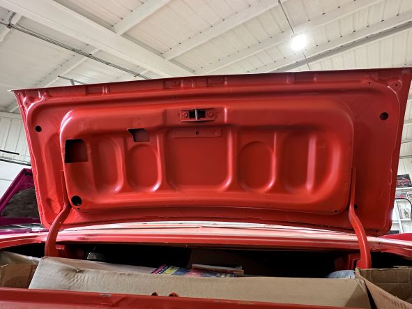

Ok, the trunk lid is one the questions I have yet to figure out on my car, and one of the reasons for joining this forum. My car came from the factory with a luggage rack, documented by the build sheet, and it was built Oct. 69 at the LA plant. It did not have a luggage rack when I bought it. At that time, I didn't care, I never planned on one. Well, fast forward to now, and I will go back with one. I actually got a decent, original luggage rack as of yesterday. I kind of like the looks of them now. Makes it "different."
After finding this thread and then going to look at mine, well, I don't know what I have?

The decklid in your photo is drilled for a luggage rack only. Mine in the first photo is drilled for a rack and the spoiler. Mine was built in Dec 69. I know it probably doesn't offer any more insight but the factory did a lot of things that didn't make sense at times. Since yours was built in Oct 69, that's fair to say you have the correct decklid there consistent with how Mopar stamped them prior to Nov 69 with the introduction of the go-wing spoiler

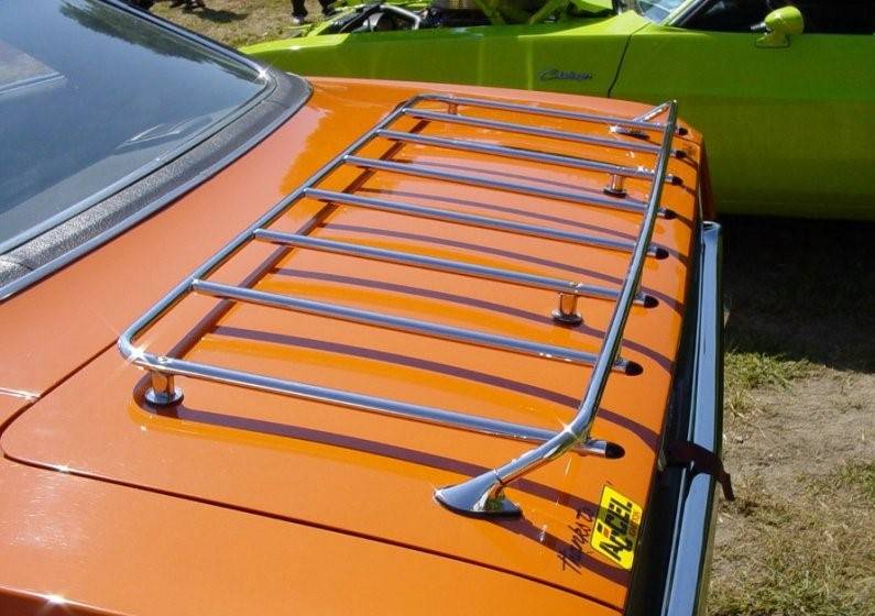

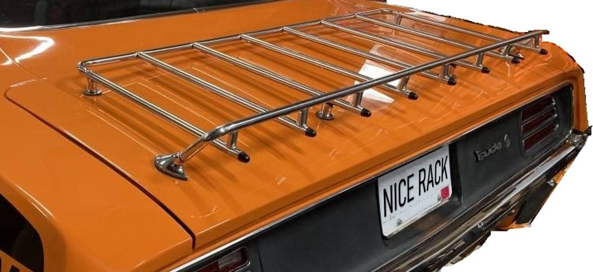

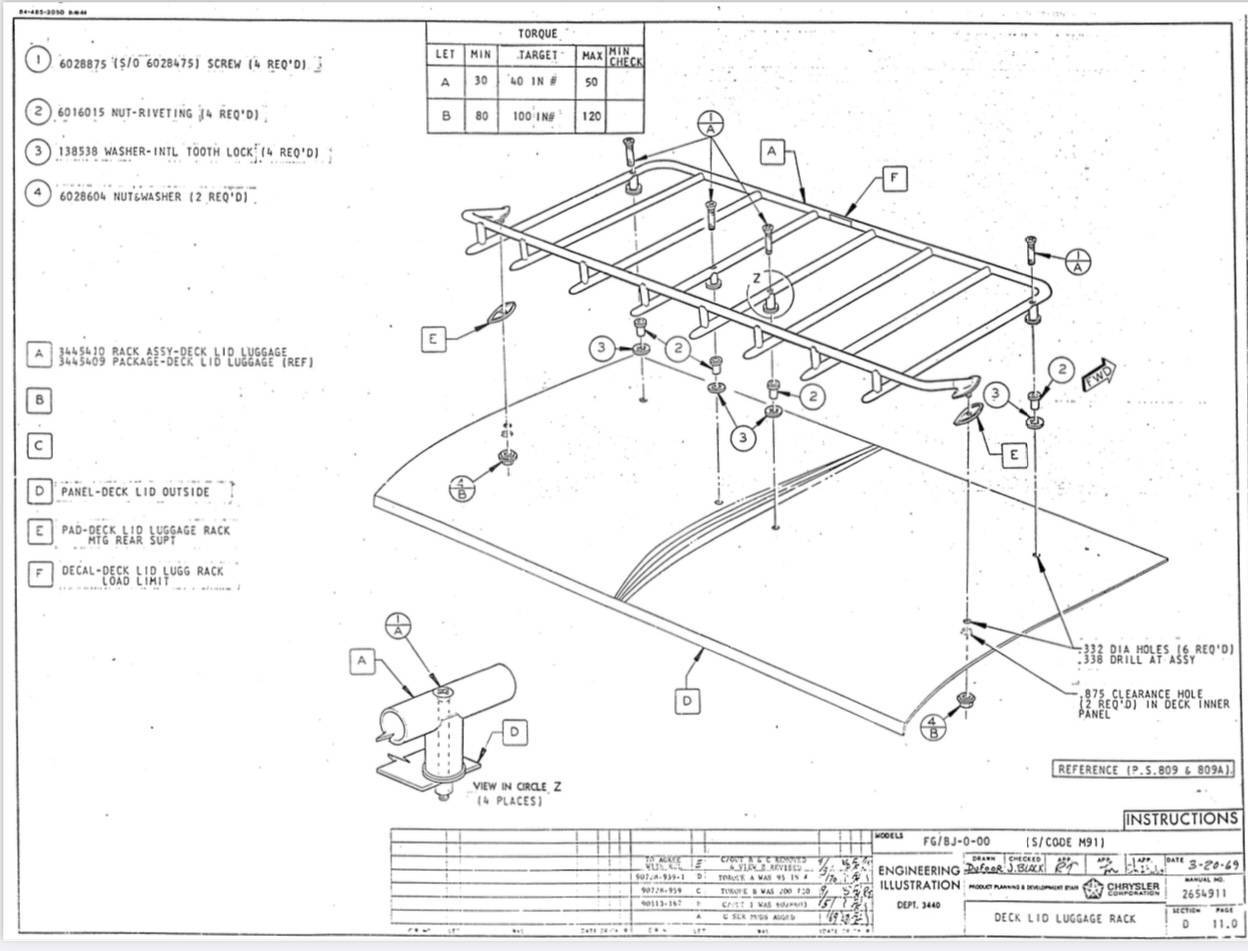

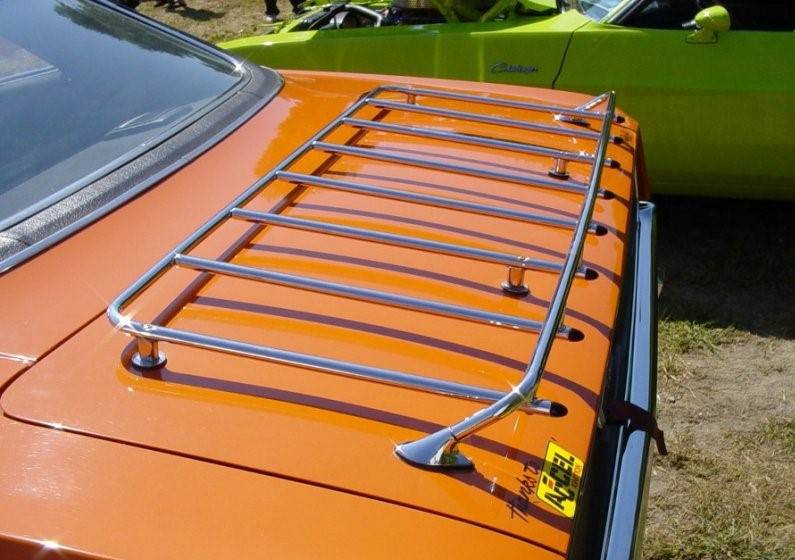

Here are pictures of two different Cuda's with a luggage rack and the factory diagram with obvious mounting location errors for the center two holddown posts.

ok, thanks. And, yeah, interesting mounting diagram, for sure. Many seem to hate the looks, but, mine came with one, so it's going to have one again.

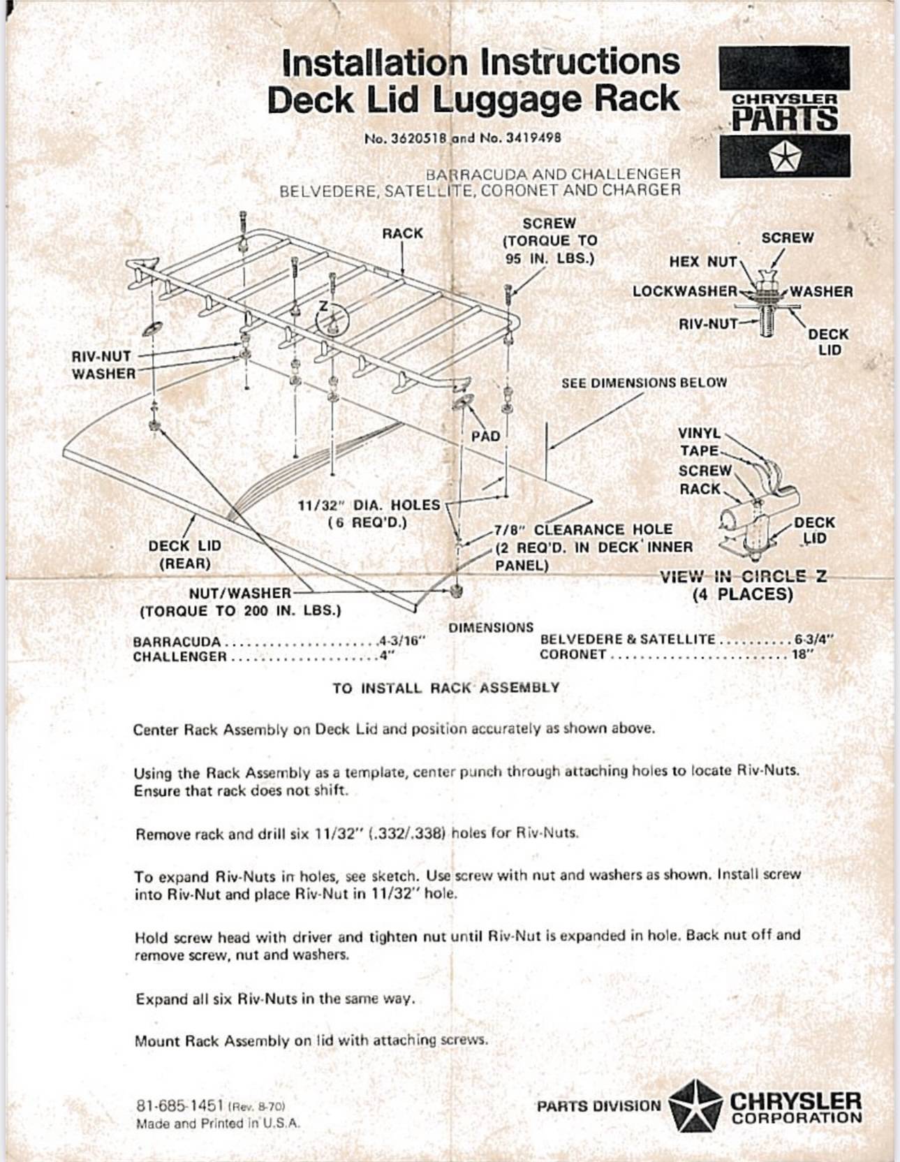

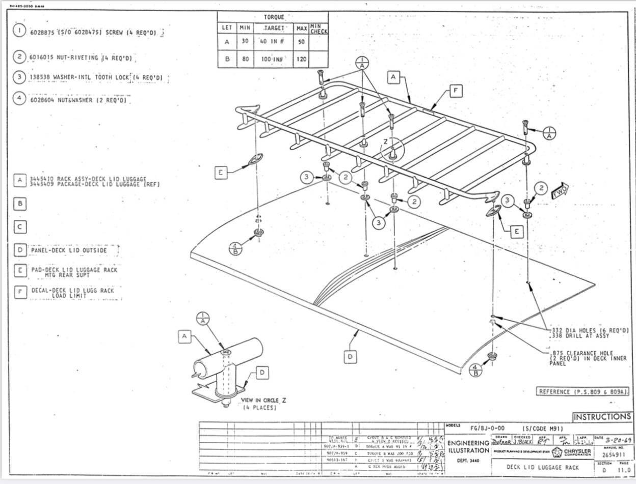

And these installation instructions may help as well. Just use your rack as the template to drill.
NOTE: These instructions have the same drawing errors for the "center" set of support posts as the engineering diagram.

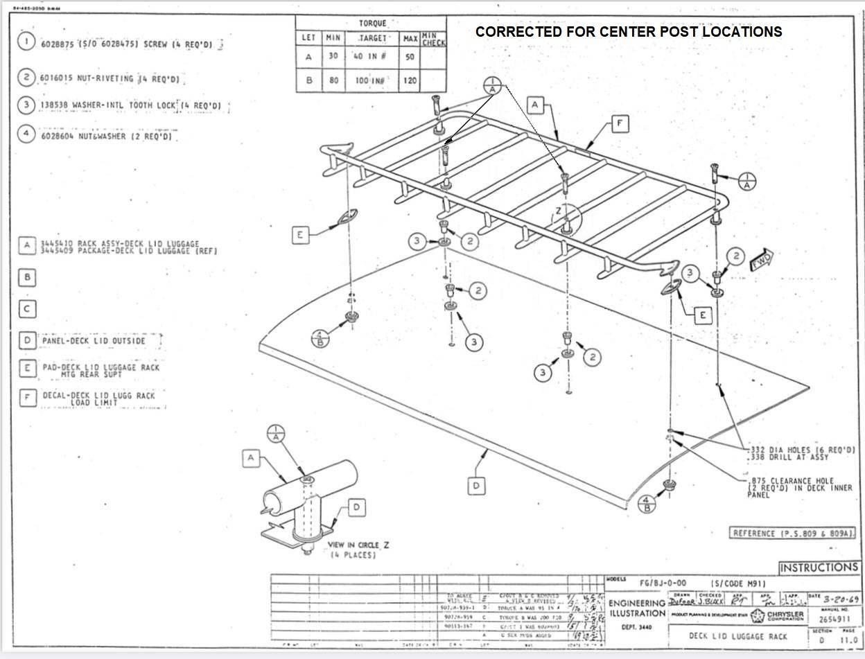

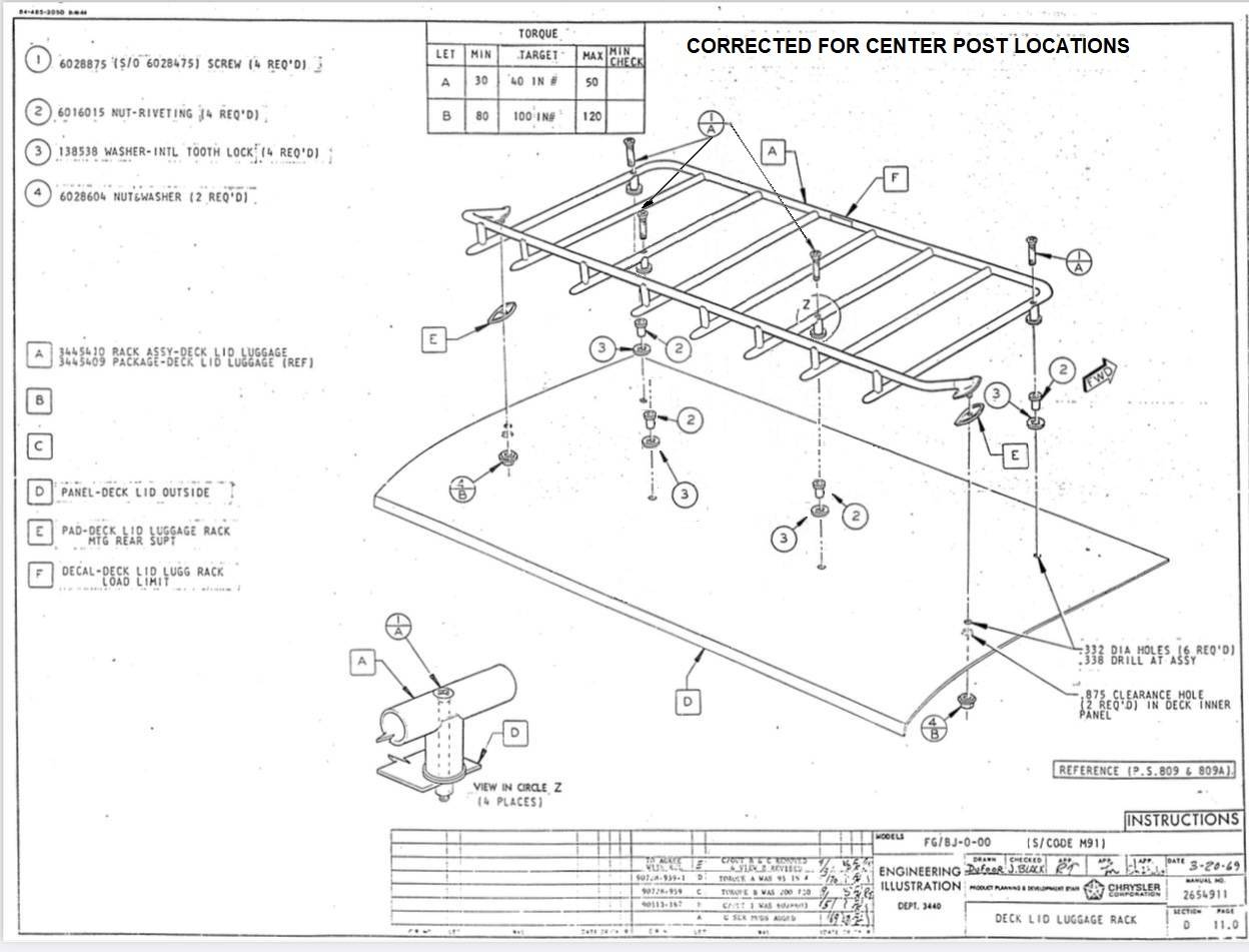

I corrected the engineering diagram to put the "center" support posts at the correct locations.
View attachment 103515 View attachment 103517

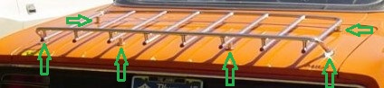

That's my Cuda on the left there with the rack just sitting on the decklid for a mockup and photo-op. I'm just leery on how to install these riv-nuts in the hardware kit that came with it. I wish someone would post an instructional video of a Cuda/Challenger/Charger luggage rack from scratch. Man, that would help greatly and I would feel confident on doing it correctly because once you drill there's no going back.
I would comsider lining up the rearmost supports that go directly over the factory decklid punched holes to verify they line up. To confirm, measure the distance between those posts as well. Then measure the center-to-center of the holes under the decklid. They should match. If so, you can safely drill those holes from the topside.
Before drilling you want to transfer your measurements to the area after putting down several rows of wide masking tape. Start drilling with a series of smaller bits working up to the correct size for the RivNut. Harbor Freight sells a kit with the RivNut tool and several sizes of RivNuts. I am not sure if the kit has your required size. The tool is much like a normal rivet gun tool.
Lay down more masking tape in the areas for the other posts. Test the rack for alignment at the two holes you just drilled. The tape will protect your paint at each post location while lining it up. Secure the two nuts on the post studs. Double-check everything is square and spaced evenly.
Now you can use the post machine screw holes in the rack to mark all of the remaining locations to drill.
A small scribe may work or a very small centerpunch. I would be super cautious about using a center punch as you only need a small mark to know where to drill.
You would be wise to use a long drill bit and drill through the rack holes for each post and secure them as you move from one to the next. This will ensure everything stays aligned.
I have not attached a luggage rack before but it looks to be a similar process I used to add and align a set of twin hood scoops on a 71 Dodge Demon to turn it into a Demon 340.
Anyone else have ideas or tips on how to install the luggage rack properly?

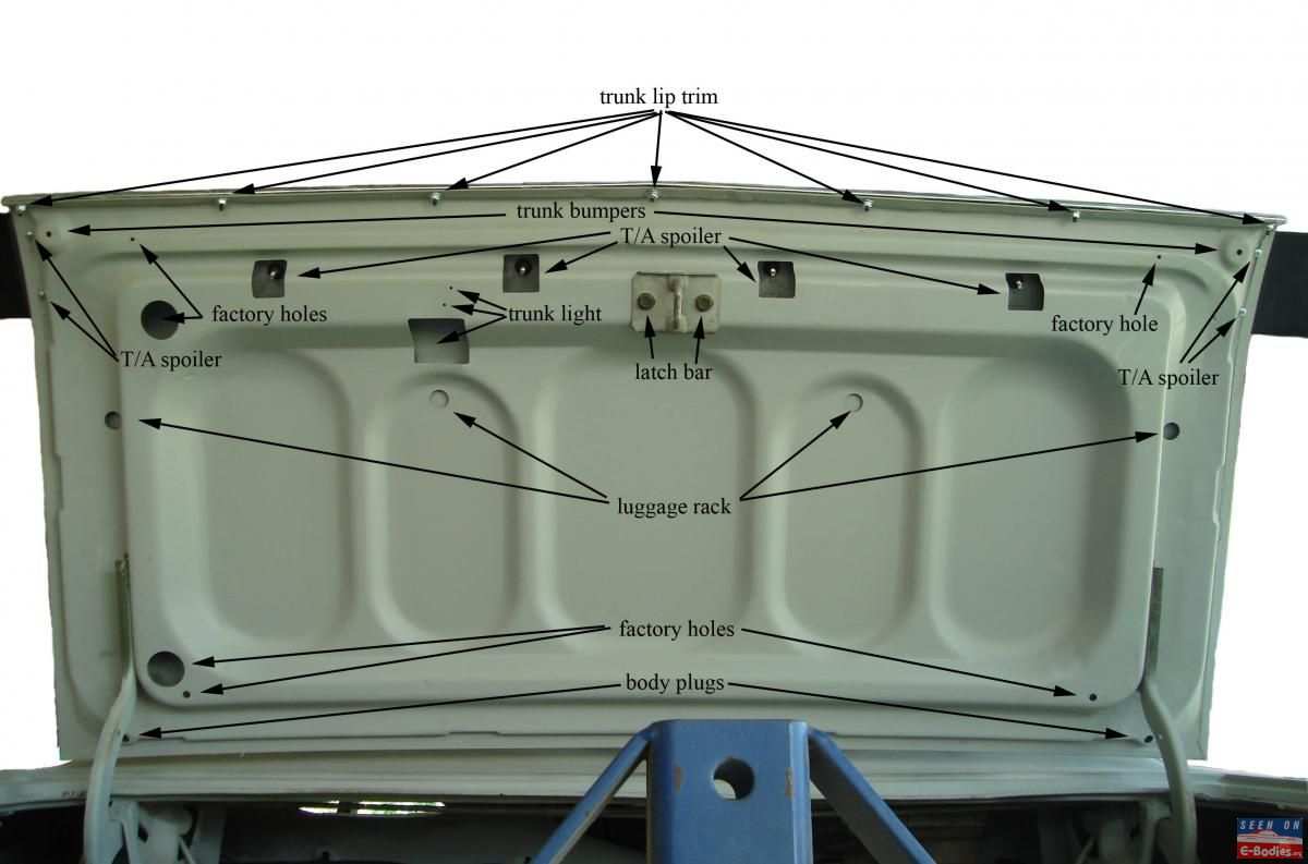

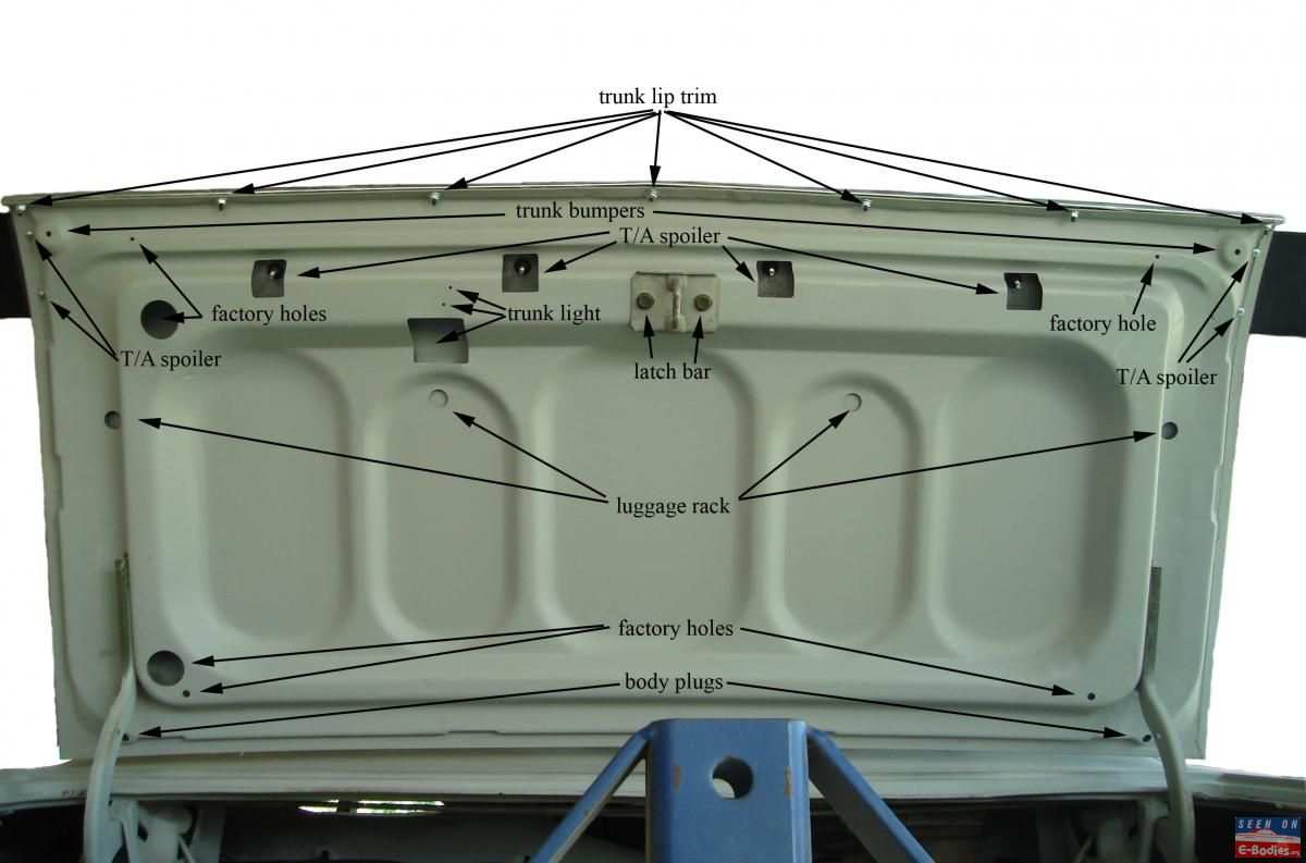

Can you show where the factory pre-drilled holes are on the back of a decklid. I have to mount one on a car that did not come with one. Thanks!
