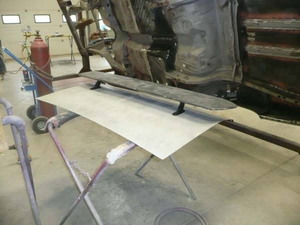

I found a new NOS trunklid that did not have the rear wing cutouts. We cut all the extra holes duplicating my old lid. Then drilled the 4 top holes and test fitted the wing.

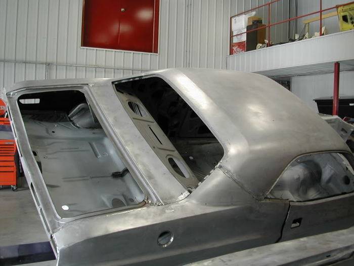

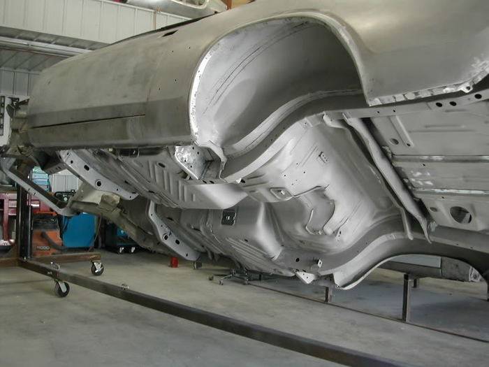

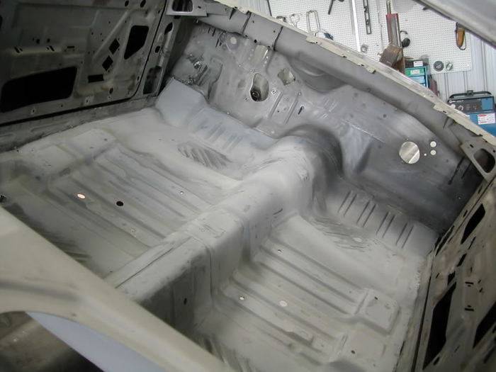

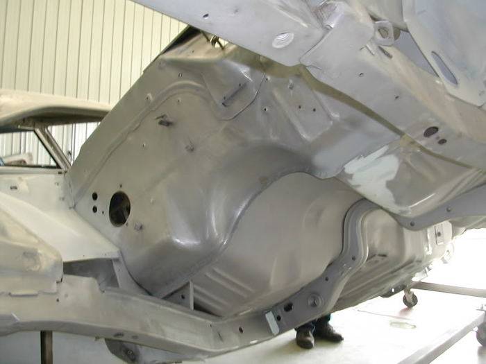

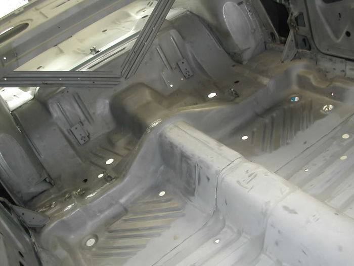

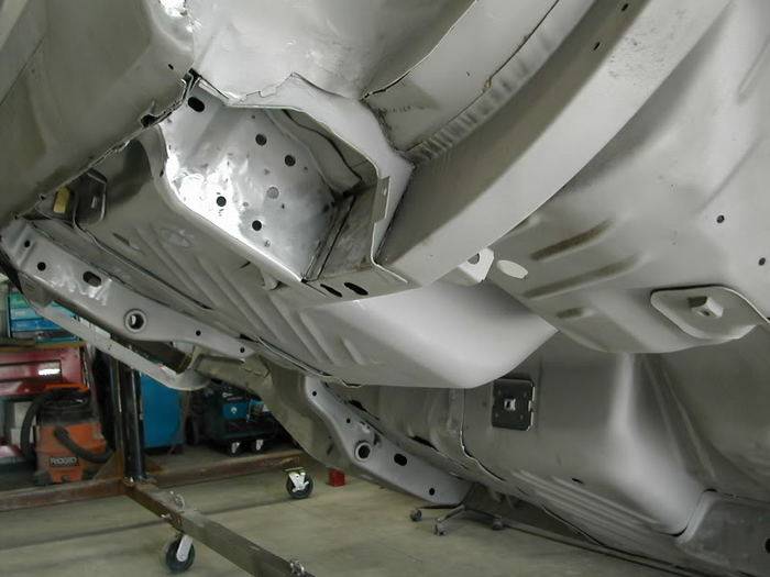

Here's some update pixs, all replacement body parts are installed. Had to replace the rear spring front hanger brackets. Goodmark just started reproducing them.

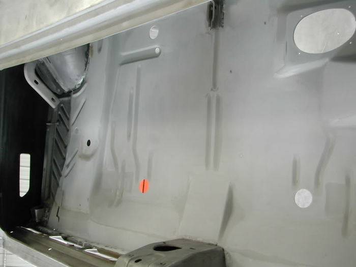

Trunk compartment ready to be prepped for paint
Prepping under carriage
Interior ready to be painted.
Hopefully by November we have it painted ready for assembly

Nice ride! I like the first pics of it coming apart. Amazing to me how many people forget that everything can come out through the bottom. Just a few quick questions. Who was the source for most body parts? How did they fit? Looking at AMD for the necessary pieces on mine and I've heard good and bad.
440six
85
4
I used Goodmark fenders, Quarters, floor and trunk pans, fender skirts, frame rails and hood. I got the door skins from AMD. The bodyman was doing another challenger as well. They used all AMD parts and said they fit alot better.

Thanks for the feedback. Didn't want to hijack the thread, just curious. This is some nice work going into your car. Love seeing it come together. Thanks for sharing with us.

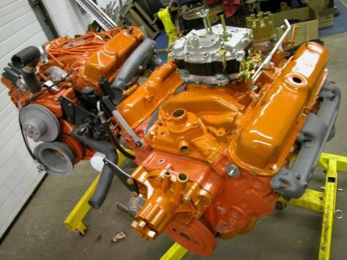

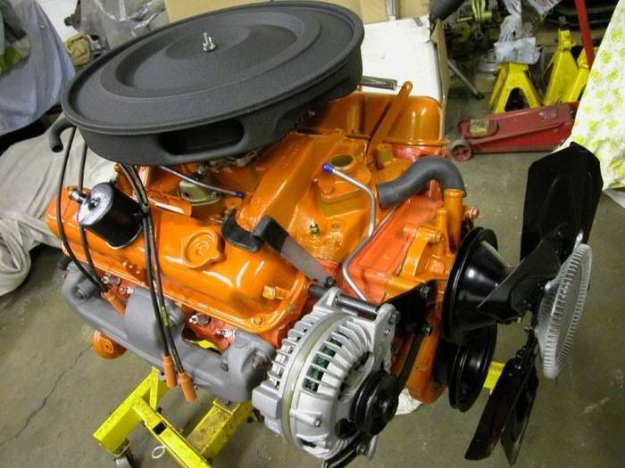

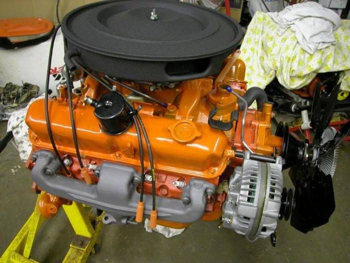

Working on the motor, getting it pieced together. Making sure we have everything.

And I was told a Factory 340 4BBL intake would be hard to find....Looks like you have two.....

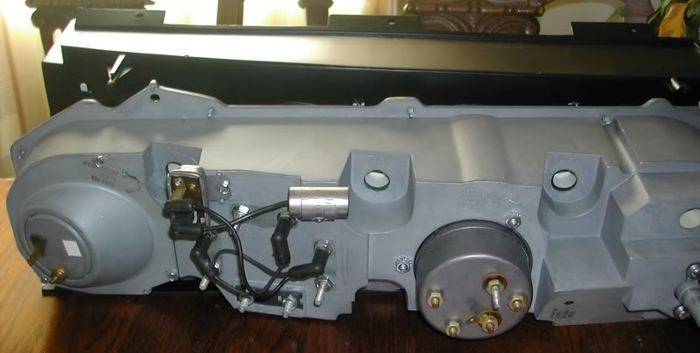

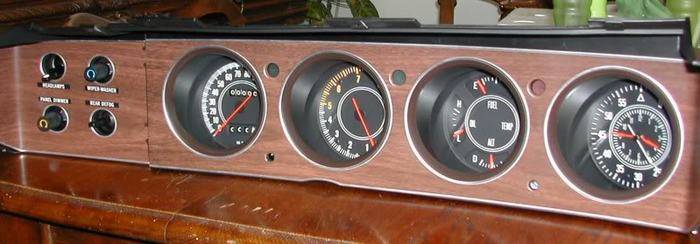

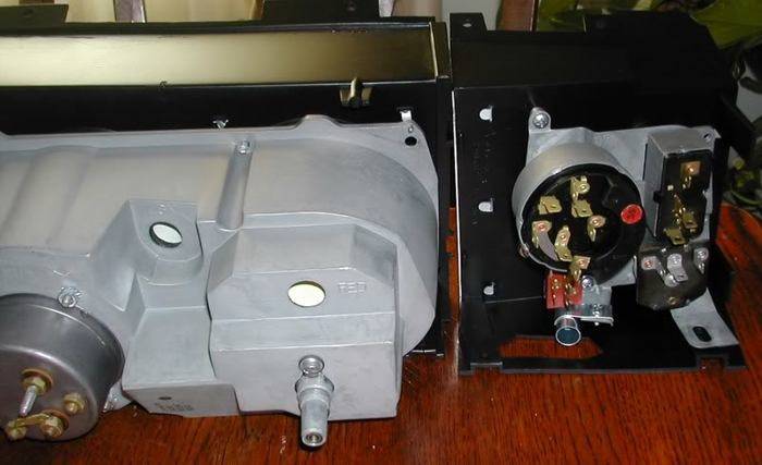

Well things are starting to come together, the ralley instrument cluster arrived back from been restored and looks great, Jules work is unbelievable.
CoronetRTguy
Dec 1, 2009
133
VA
Wow great looking car love the seats. Who did the work on the cluster that is an awesome job.

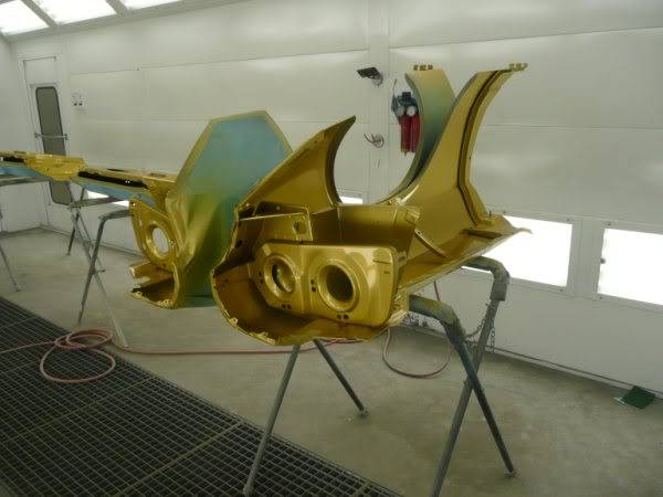

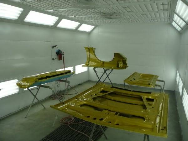

Paint GY8
Well the body work is finally finished and paint is going on
