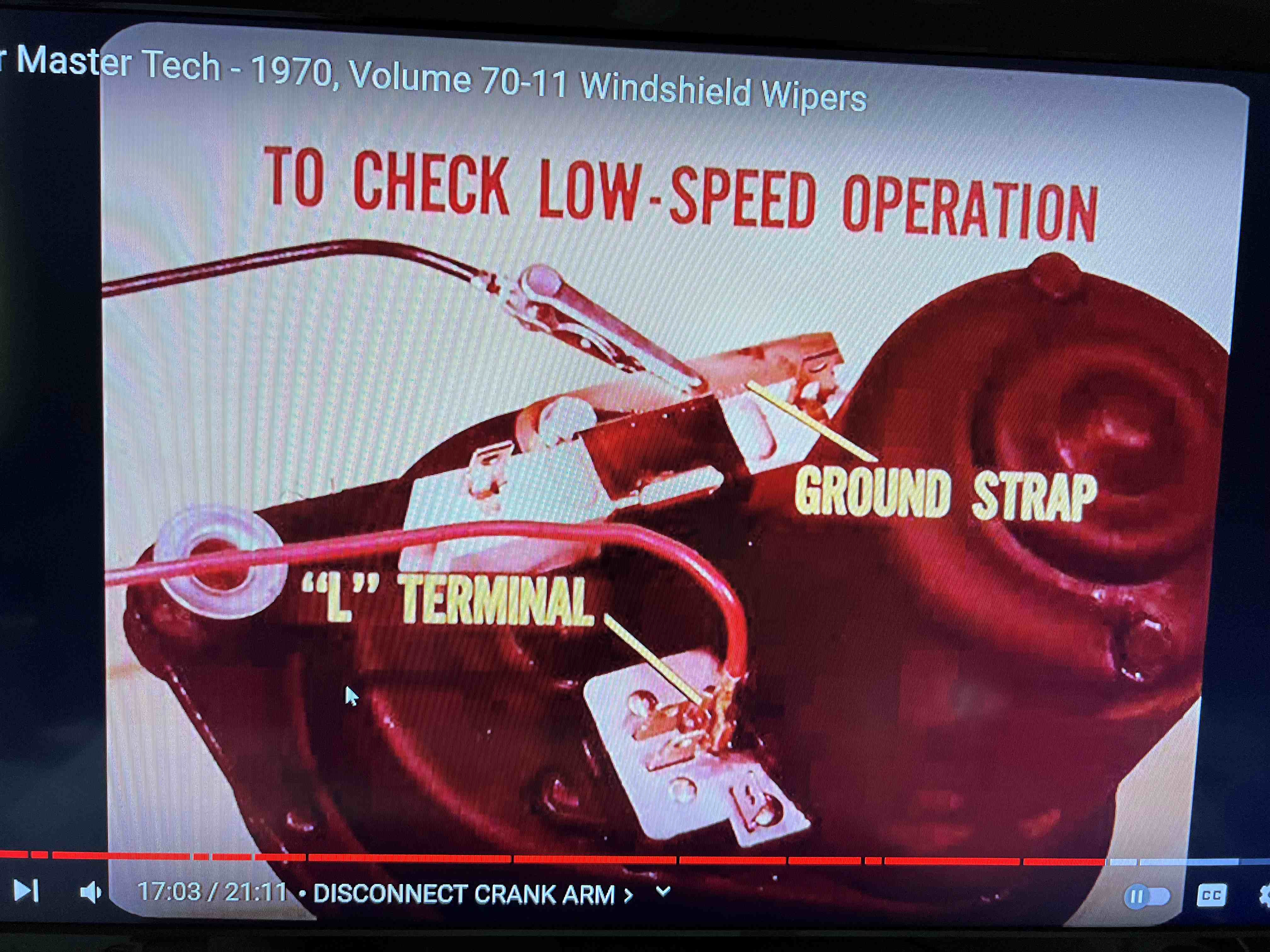

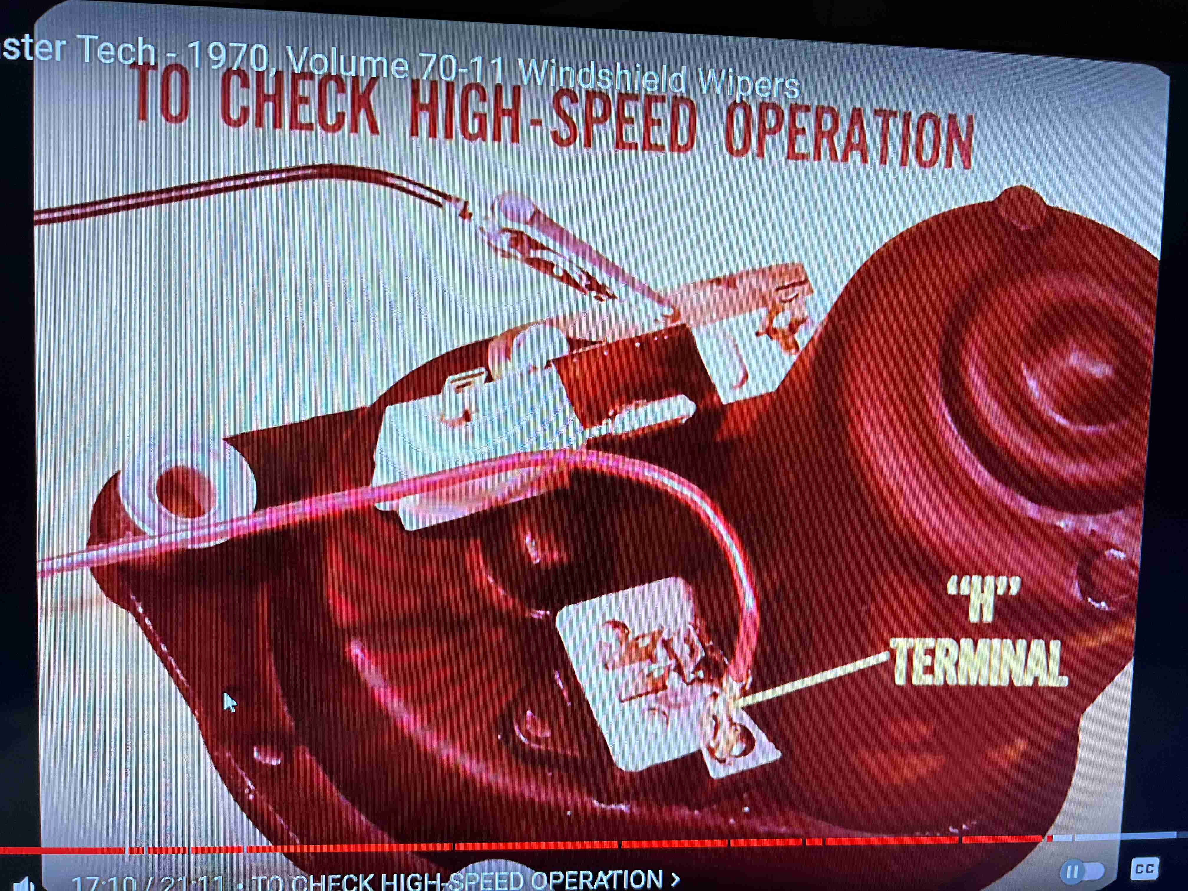

I had read some information on wiper motors and looks like my old one was dead. I checked the terminals from the battery shown on some posts.
also noted if not grounded it will not work if issues were found there. I did ground from the battery to the ground strap on the wiper motor but still did work.
I bought a new wiper motor online from "A1 Premium" but installing that one it didn't work? I retested the wires from the switch low and high speed the the test light shows they are getting power. any Ideas what could be the problem? Thanks for the help.

Check the grounding strap on the wiper motor for ground. scuff it. Both ends and the threads for the stud.

Yes I did check the linage. I moved it by hand to make sure it was not stuck. It a new motor but I will scuff both ends who knows?
thanks for the feed back.

After I re-cleaned the contacts (the inside contacts of the wires that contact to the motor) the wiper motor worked.
Thank you all for the suggestions.
