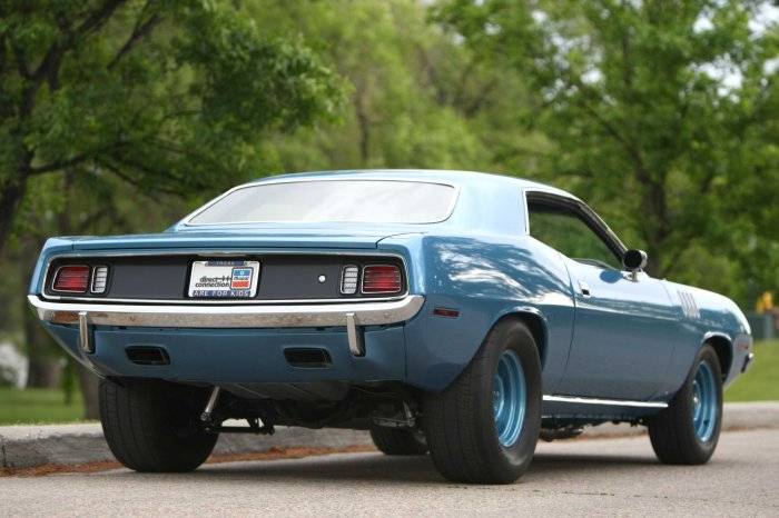

Dr. Diff kit, no mini tub, 295/65-15 drag radial (30" tall).
IMO, 3" relocation is a waste of time if not mini tubbed since wheel well size will control tire size not spring placement.
Do lots of measuring.

Beautiful 71! So.....I am not cutting the tubs, therefore you recommend the Dr.Diff 1'' relocation kit and I plan on using my diff (E body 8 3/4) and 15X10 with 6.25 BS. 325/55/15 drag radials (like a 295 50 15 but 28'' tall).....If I understand your reply the Dr.Diff kit will get the MOST in the stock tubs without going to a 3'' kit? Thank you so much for yo
ur reply!

Dr. Diff kit will move the springs in about 1". You will likely need to narrow the e-body diff to fit those wheels. Do lots of mock-ups and measuring.
