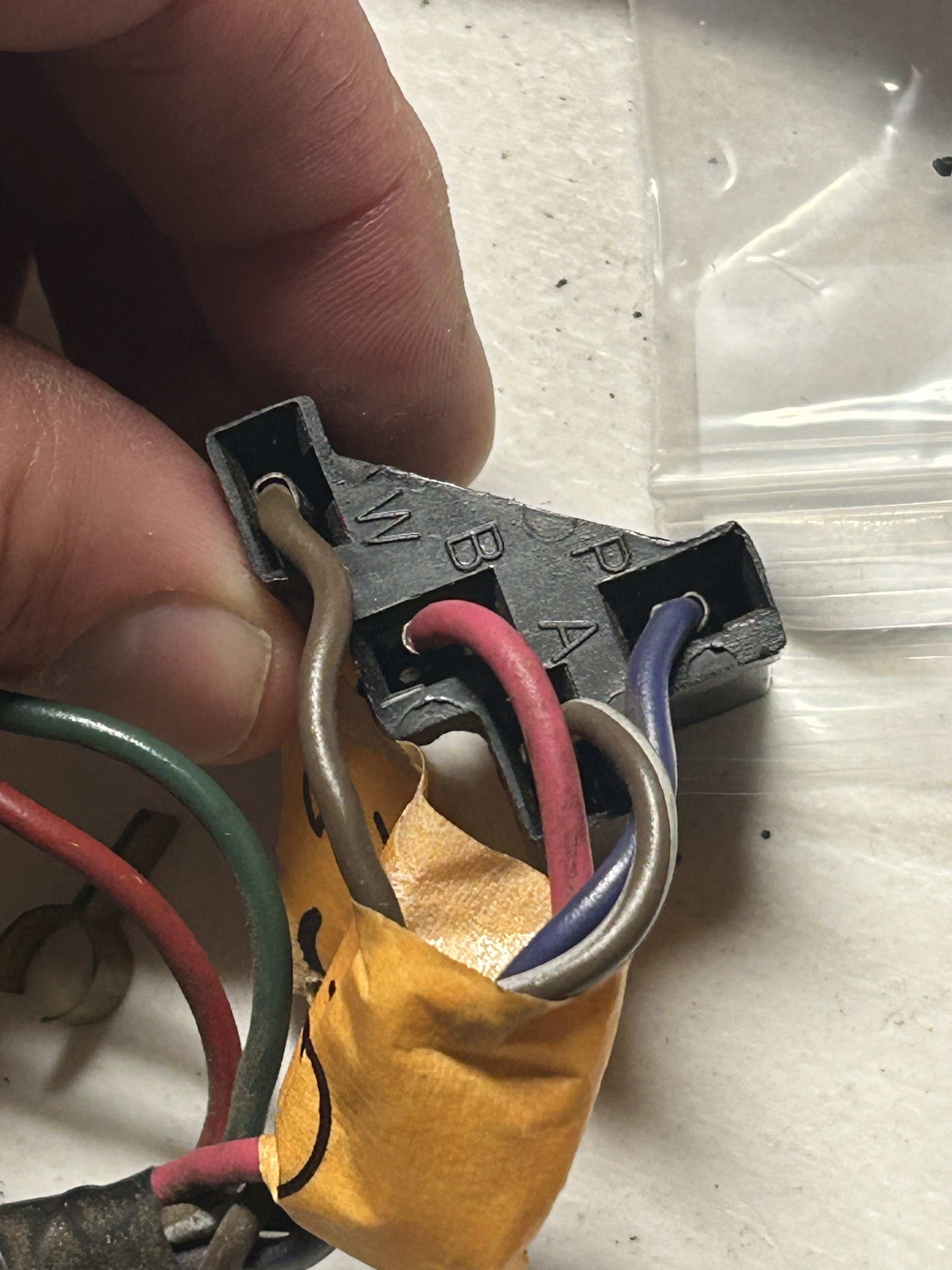

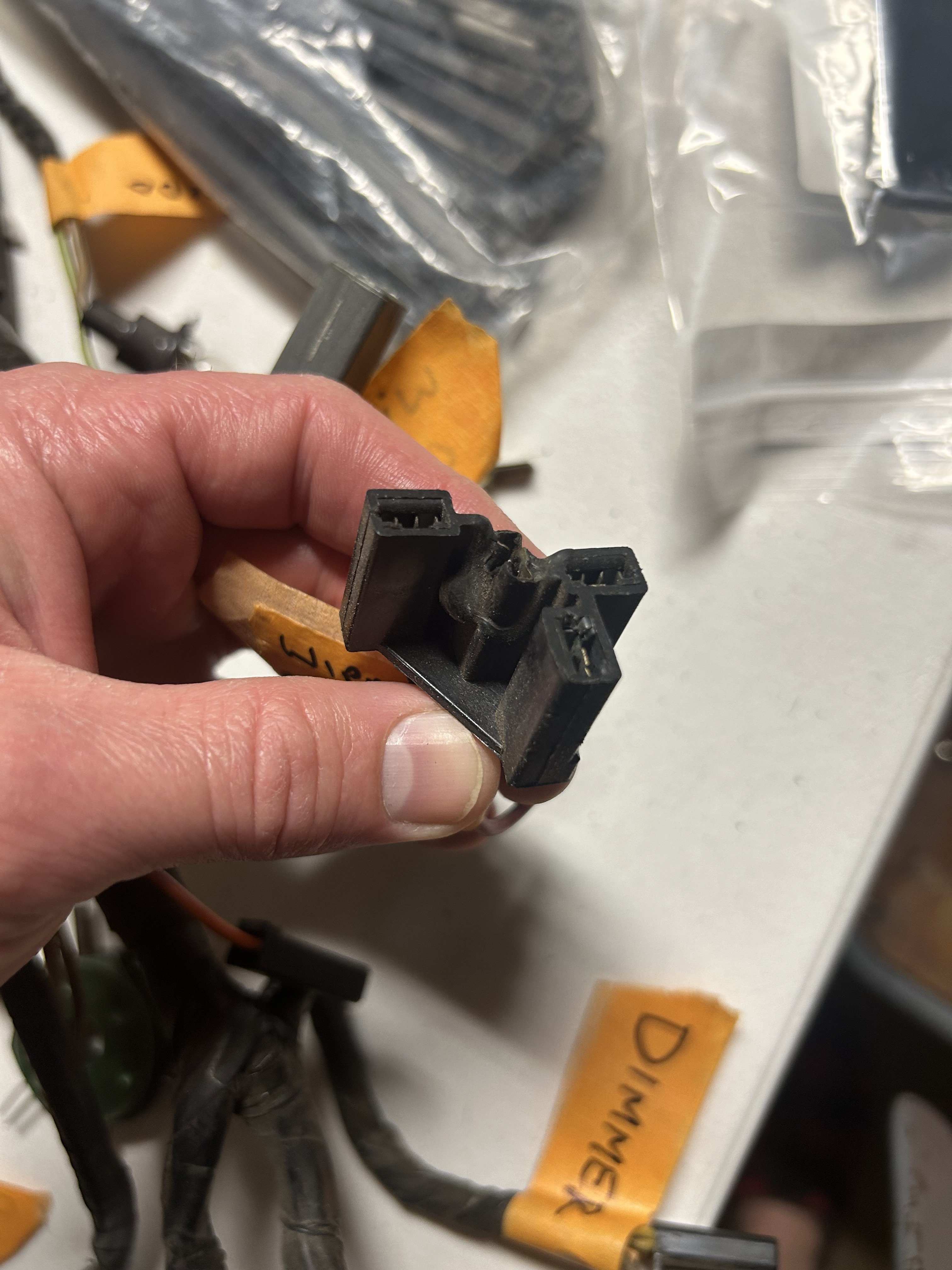

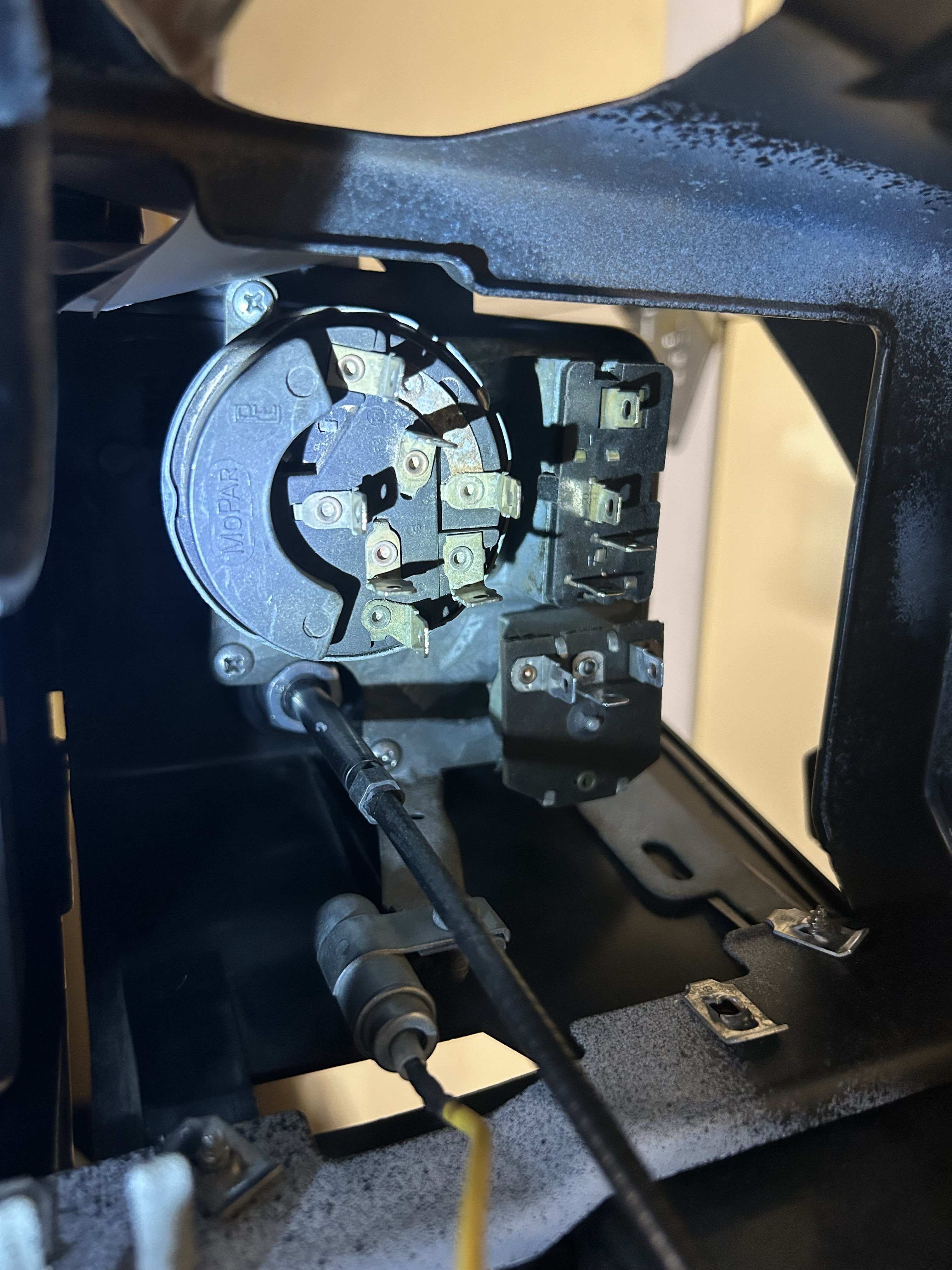

Hi,
I’m looking for a replacement connector for the 3 speed wiper controller in the dash. It’s the bottom connector with four female connectors. I can’t seem to find one online that looks like this connector. Anyone know where I can source it?

You will most likely need to buy a second hand wiring loom to get that plug.
That was my fear. I’m not concerned about it being factory so I might go with a “custom” solution and remove the melted section and create a new single connector for that one post. If anyone has one laying around, please let me know. I’d far prefer to put the correct connector on it.

Harnesses for 2 speed switches (standard dash) would have the exact same connector. Those might be easier and less expensive to find and buy.

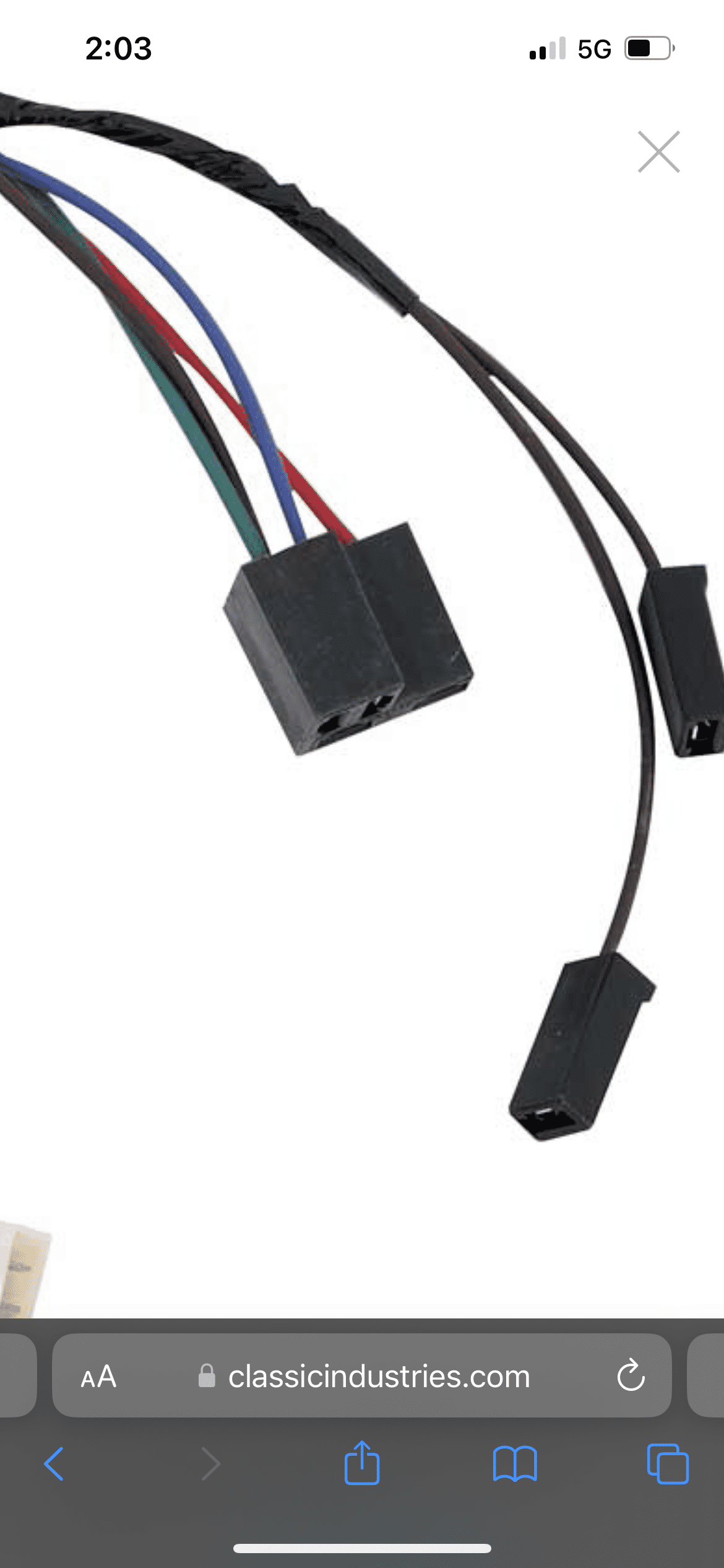

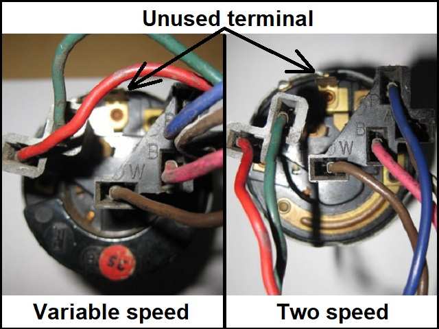

Here's another picture I like to post whenever there's a wiper switch/connector topic.

Here's another picture I like to post whenever there's wiper switch/connector topic.
I noted that unused terminal when I disassembled it. I see the 2 speed connector is a different configuration that looks more like this. So it will work huh? Thanks! If anyone has one like my existing, let me know, I’d still prefer that route.
Oh wait, I think I read your response wrong. Doesn’t look like that pic I posted will work… I still need the same type connector. I jumped to a conclusion that the connector I just posted would connect to the unused post. Monday reading comprehension issues…

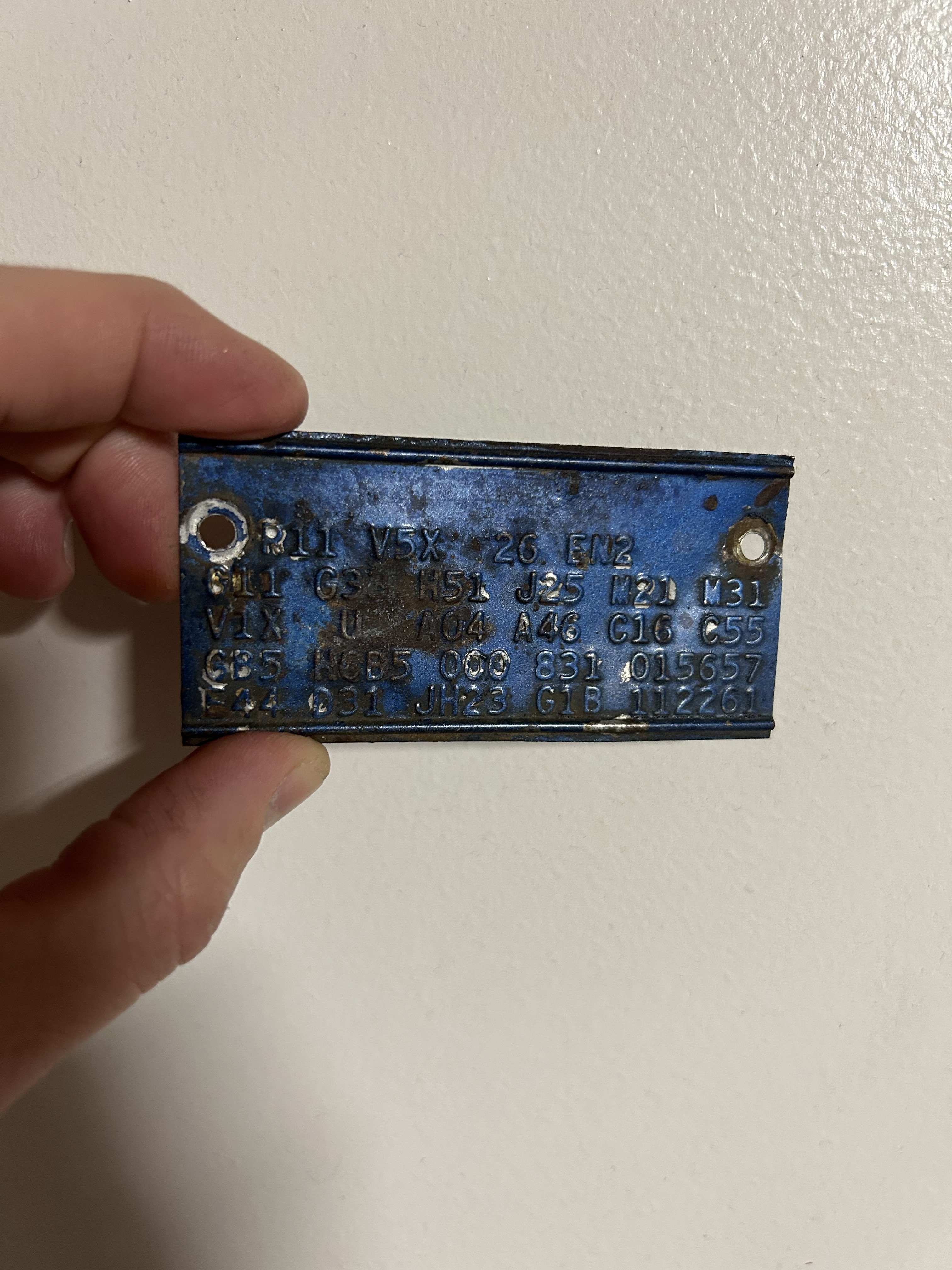

Good question. Standard dashes typically came with the 2 speed wiper setup. I have a document that says variable speed (‘70 & ‘71) is option J25, and standard equipment w/shaker, rallye cluster, 440/6 & Hemi. I also heard of people doing the wiper swap themselves and keeping the standard dash.
The document is: Bulletin No. FB-DD

From what I know the J25 option was available no matter if the car was base or R/T same as A01 the light group.
It seems Chrysler was fairly flexible about adding or deleting some options.
As stated in post #12 J25 became standard if you ordered an R/T or a shaker hood etc.
Well good thing I happen to carry my fender tag with me! Digitally anyway.
J25!

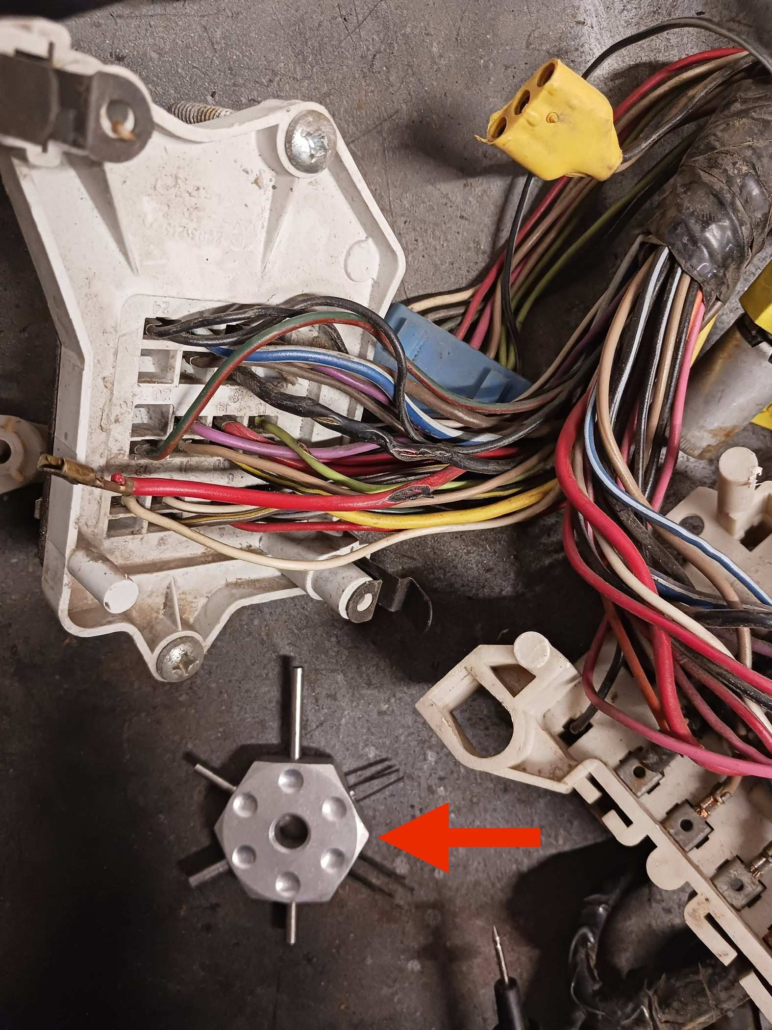

I know you know where the retaining tab is on the spade connectors but this may help others reading this thread. Glad to see that your "Wanted" post worked and terrywalker came through for you.

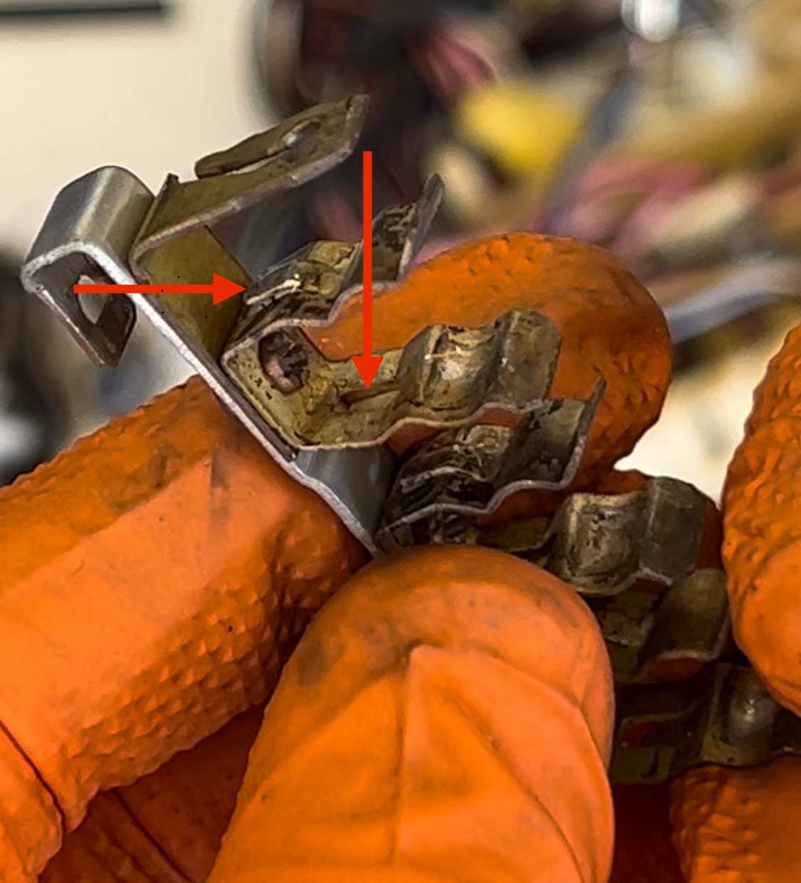

Yup! The fuse box has similar release tabs on the outside of each fuse holder. Some of them are singles, some are 3 fuse holders on one bus bar with a male spade connector attached. I didn’t get a good picture but here is one with two arrows pointing to the fuse holder release tabs on each side. I have the same six sided tool that Terry has, which is useful(Terry’s pic is attached with an arrow to the tool). However the fuse holders took multiple small screwdrivers to release. I ended up gently bending each release tab as far into the fuse holder as possible to release the 3 that are connected to the same bus bar. You also need to bend the male spade release tab to pop the bus bar out of the fuse block.
