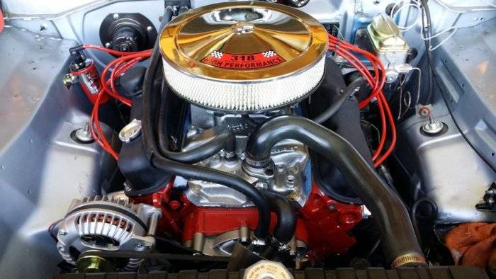

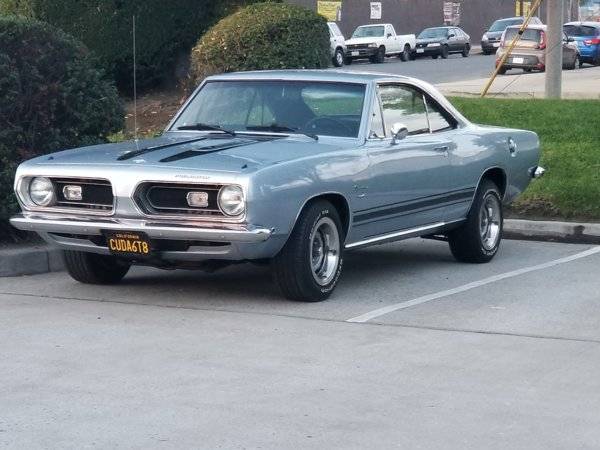

I have a built 318 in my 68 Cuda....runs very strong!

Wow that is one slick cuda!!!
Nicely done.
What kind of a build did you do on the 318?

Thank you!
Stock bore and bottom end
Hughes Whiplash cam
Home ported the heads (Opened the heck out of them...now it can breath a little)
Dough's D453 Headers
Edelbrock 750 carb
Electronic ignition
It's probably a smooth 300HP....runs great!

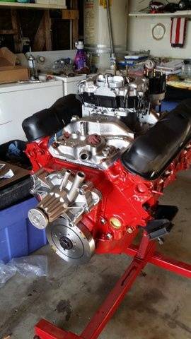

The 318 was tore down and cleaned up, everything looked good. New cam bearings and summit 6901 cam and high volume oil pump and new pickup. Cleaned the stock heads up and lapped the valves. Got a performer intake and might put the holley 750 back on or go edlebrock 600. Gunna throw headers on it to. Are jegs brand headers any good for the e body? Either those or Doug’s.

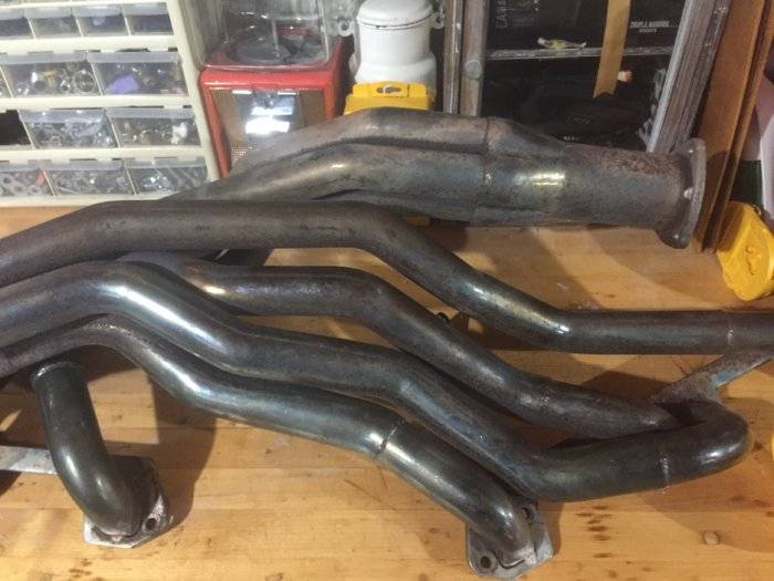

Did you get the raw steel or ceramic coated? I’m guessing the raw steel looks like **** after a little while. Does that ceramic rattle can high heat paint hold up?

Raw for the first set on my 340. Pic below. Mind you they are 12yrs old
The 392 hemi I went with ceramic coated and heat shield.

Virtually all small block headers go under the steering , bad , they get hammeder flat , TTI , Dougs , & Hooker 5115 are the only ones they stay above the center link , all others are bad design
