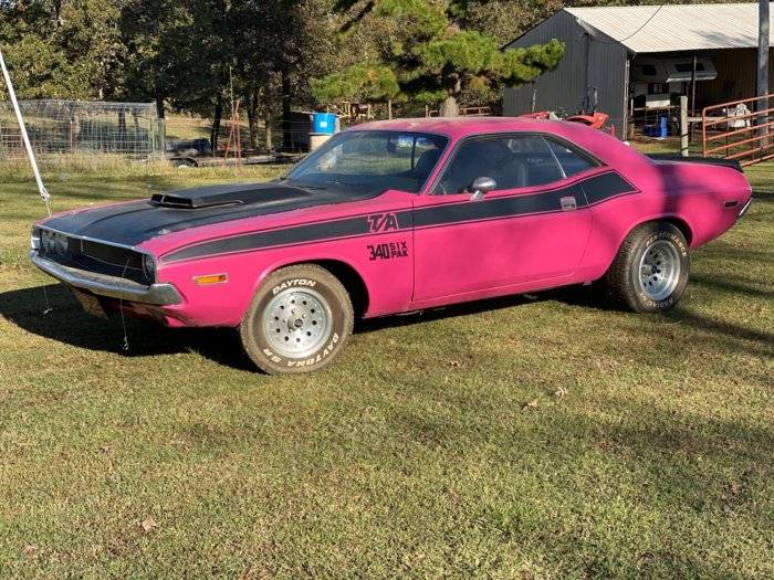

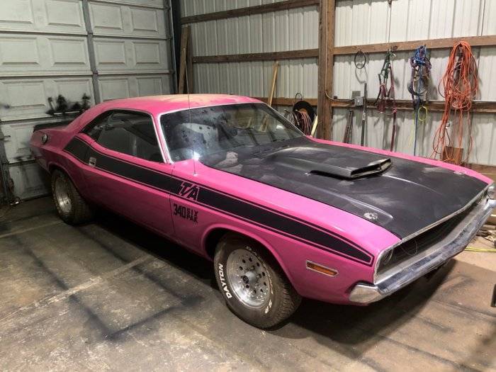

I think this is my first response on this forum but I had to chime in to agree with a lot of the above. My 318 Barracuda came with an 8 3/4 but it was an open diff. Good chance yours is too. As for the engine I think the 340 is the best small block Chrysler ever made. Wish I could afford one. If that car is a true T/A then it probably had a 6 pack at some point. Get that back on there! The guys I know with 6 packs are having WAY to much fun! Lastly I also think the 904 is a great transmission. I toyed with the idea of swapping to a 727 a while back on recommendation from friends. Wow what a lot of hassle. My local transmission shop swapped out my planetary gears for the steel ones for an extra 75 bucks on the price of the rebuild. No problems whatsoever. Enjoy the car man. She's a beauty!!

You said it yourself, in original post, "not a drag car - by any means - - ". My first suggestion is to take some time (like a month - not a year) to weigh all your options (pros and cons). Since this is not a numbers car, it does not need to be a T/A clone/tribute - unless done perfectly. And, that will not only cost a lot to do but, you still end up with a G as fifth digit on your fender and dash plates. If and when you decide to sell the car, this will mean more than a little to prospective collectors. So, having said this, (if it was my car), I would either restore the body and interior to stock - - or - - turn it into an R/T. At the very least, all you would need would be some body emblems or the special side stripes.
