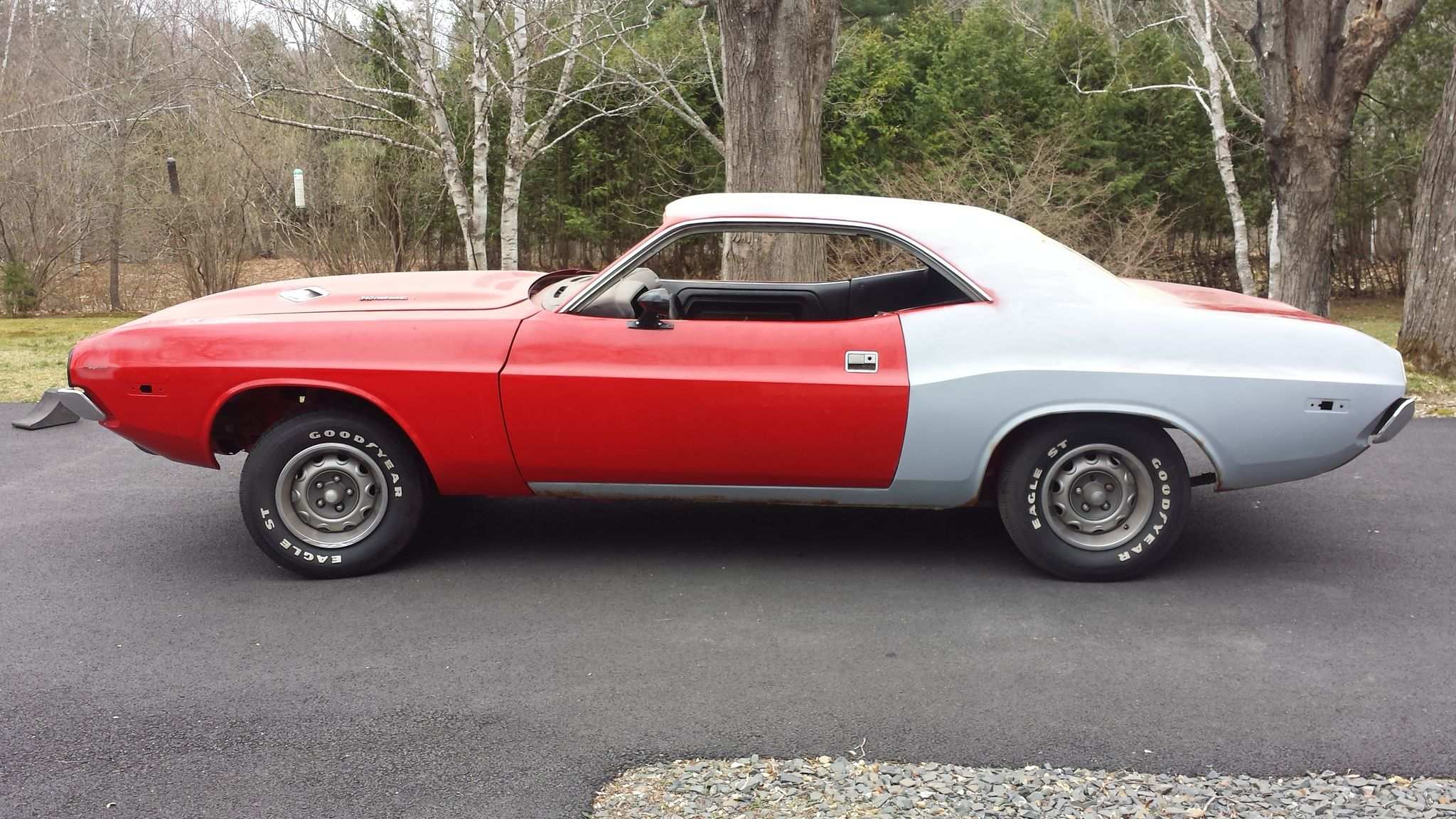

looking for advice on building a 340 engine. I'' restoring a 73 340 rally challenger. The 340 is a 68 block with X heads. I would like 300-325 HP. Looking for suggestions from carb to oil pan. Not a budget build, just want good quality build.
