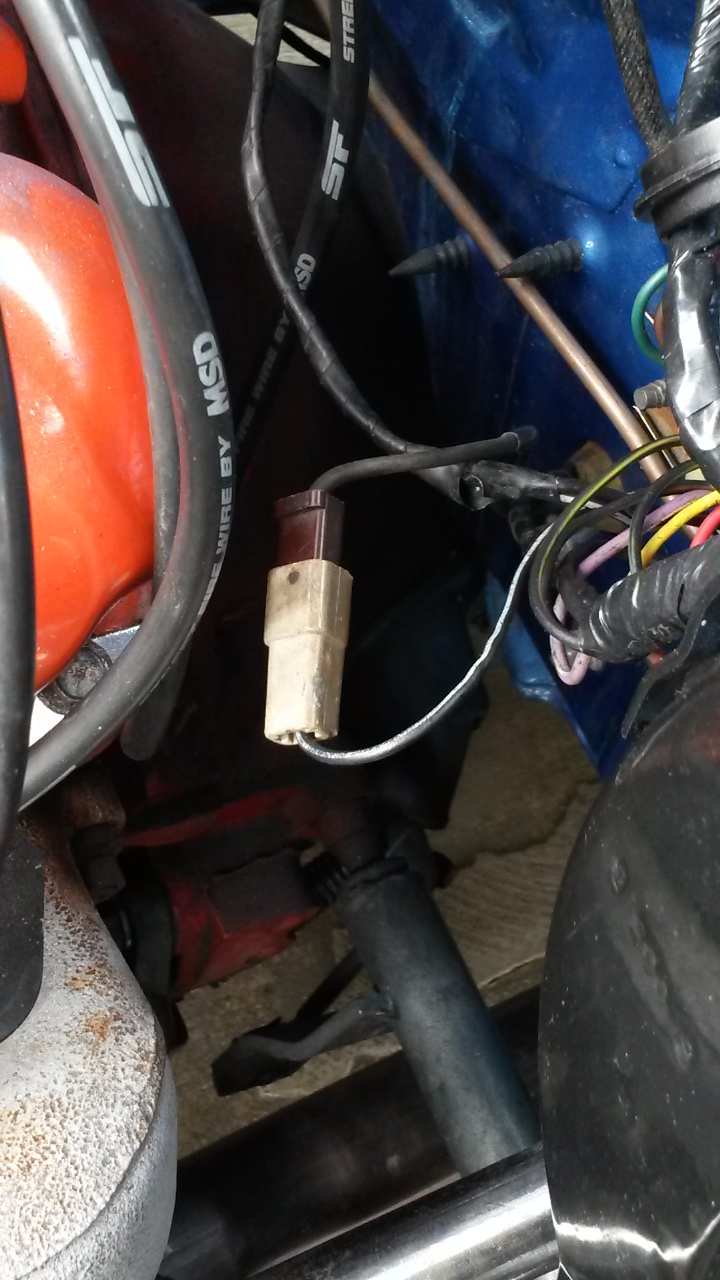

Bottom left 4sd reverse light plug. thought I had a picture of it. I could be wrong. I'm thinking that's it.
Just happen to have an other one.
mrmopar340
Dec 10, 2023
402
251
Shawsville Virginia
Thanks. I actually looking for the one that screws into the transmission. I just looked and my wires and you wires are the same coming out of the firewall. At least I know I got that much right so far. I have continuity in the wires.

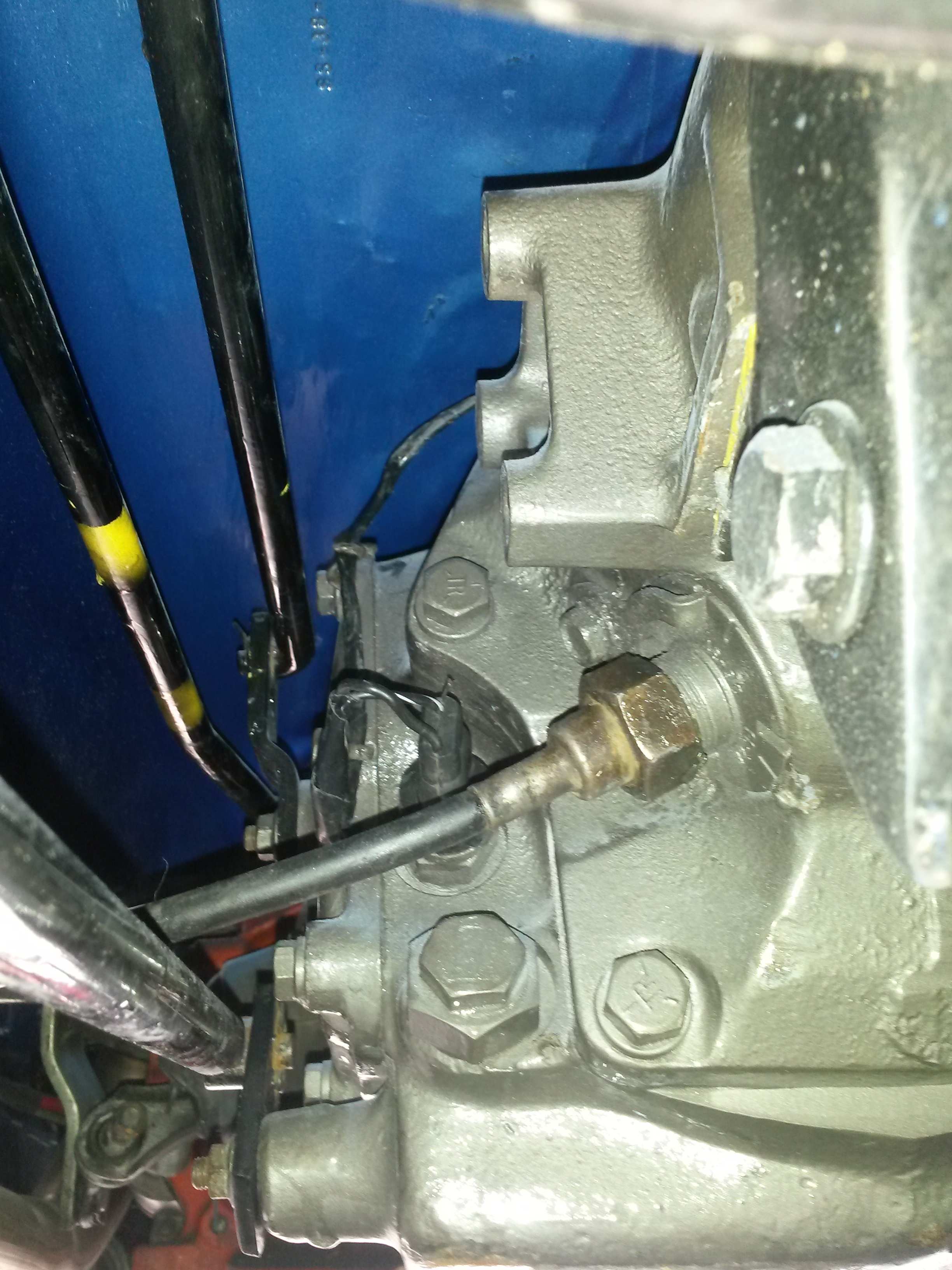

I think I have a picture of maybe what I'm looking for. I think this is my problem part.
Steve340
Sep 19, 2016
982
395
New Zealand
I believe the picture you have posted is of an automatic trans switch. The 4 speed is completely different.
Jamie at Mega Parts has them # 212-BU102M
They use a thin sealing gasket. Brewers.
