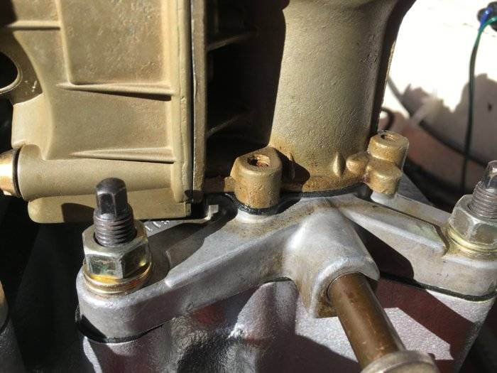

i have not disconnected the outboards but the base gaskets between carb and throttle body are wet until it warms up...see attached. Do I have to remove them completely and blank off the openings to disconnect them? Or just disconnect the fuel lines and linkage?
