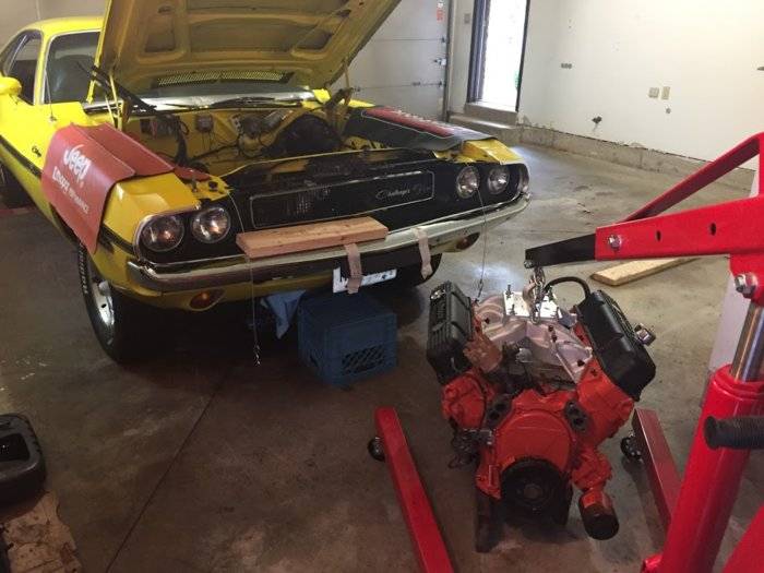

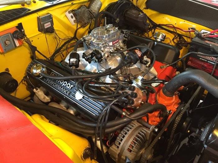

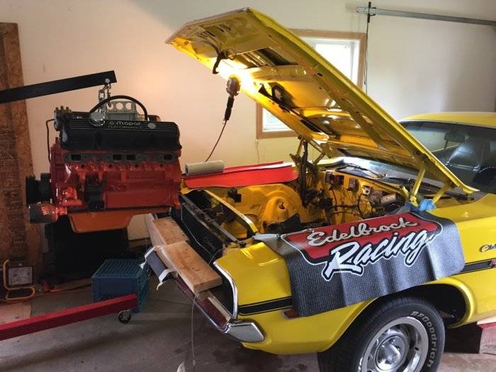

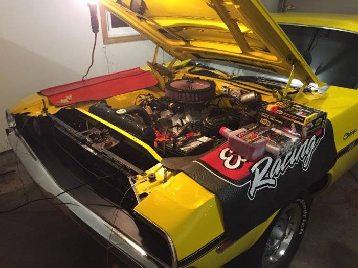

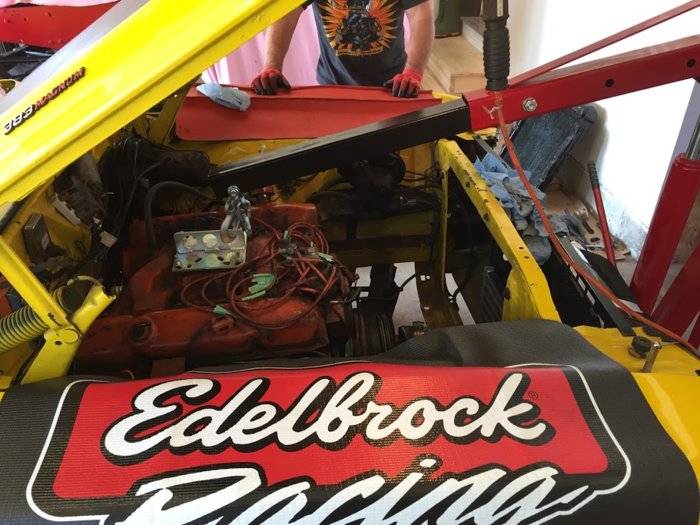

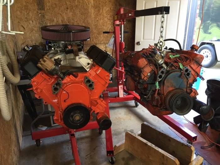

Here are some pics of the 440 Installed.
