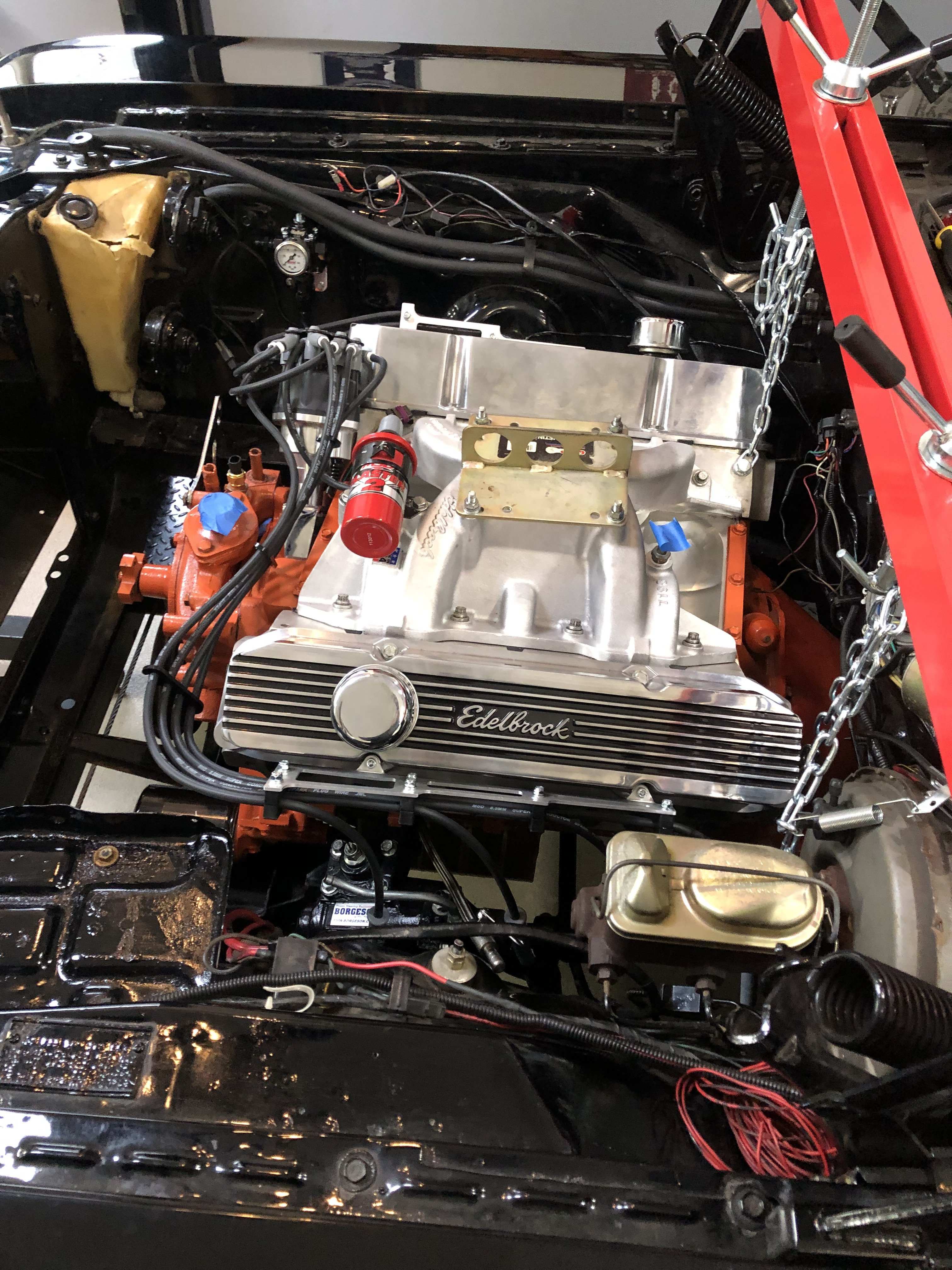

Putting together a 512 motor with 440 source kit. The kit came with Edelbrock RPM intake. I will be putting this in a 1970 Challenger. I didn't think of hood clearance when ordering the kit. I am now worried with the raised manifold, I am going to have clearance issues with the hood now. I would like to use the original air cleaner off the car if possible. Does anyone have any insight on this? Someone out there has done this before.

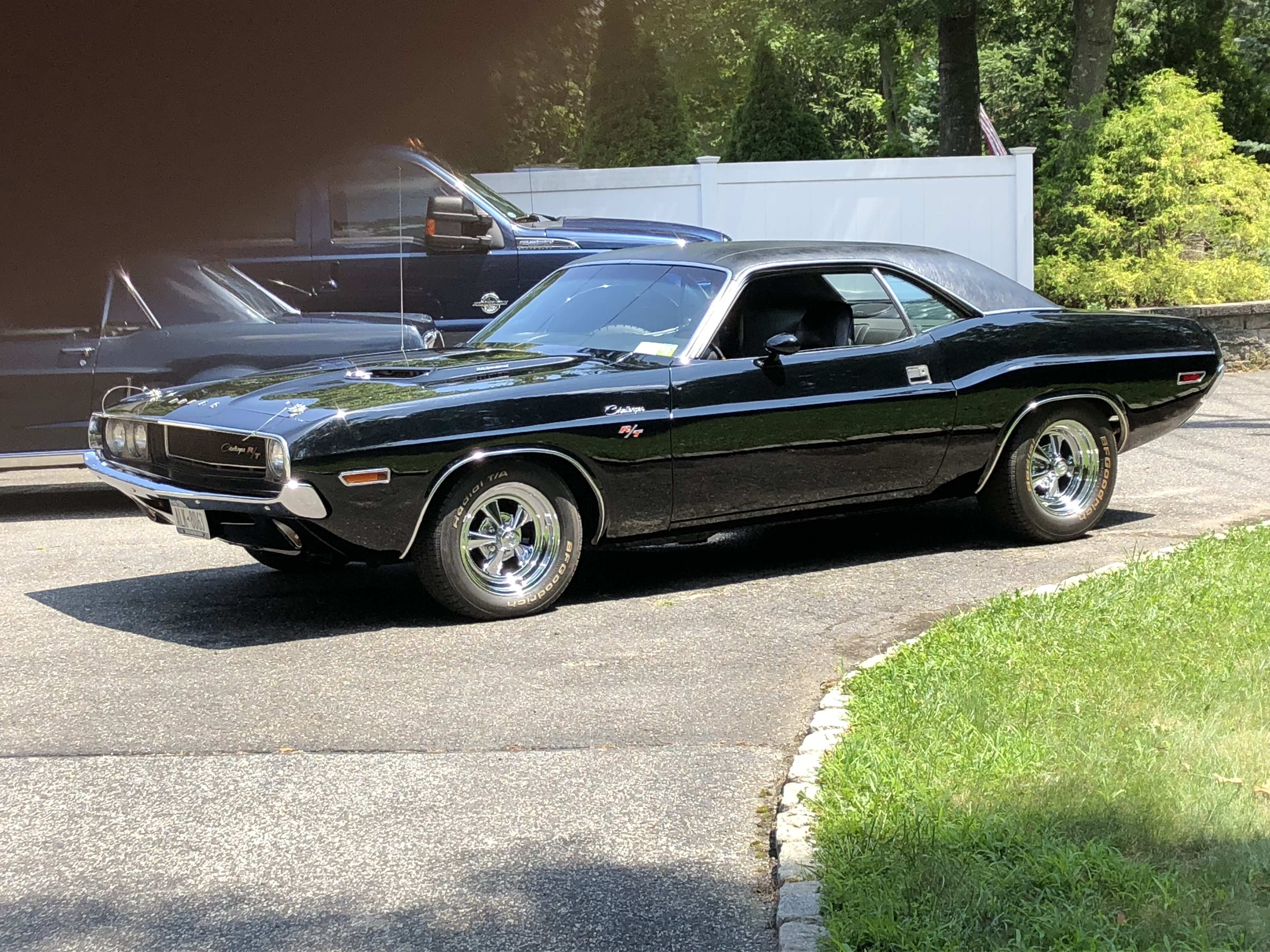

I have a rally hood and it clears. No spacer on air cleaner

I guess I lean on it one too many times.Original bottle, pretty dry rot.Finally removed it, new one not high on the priority list.

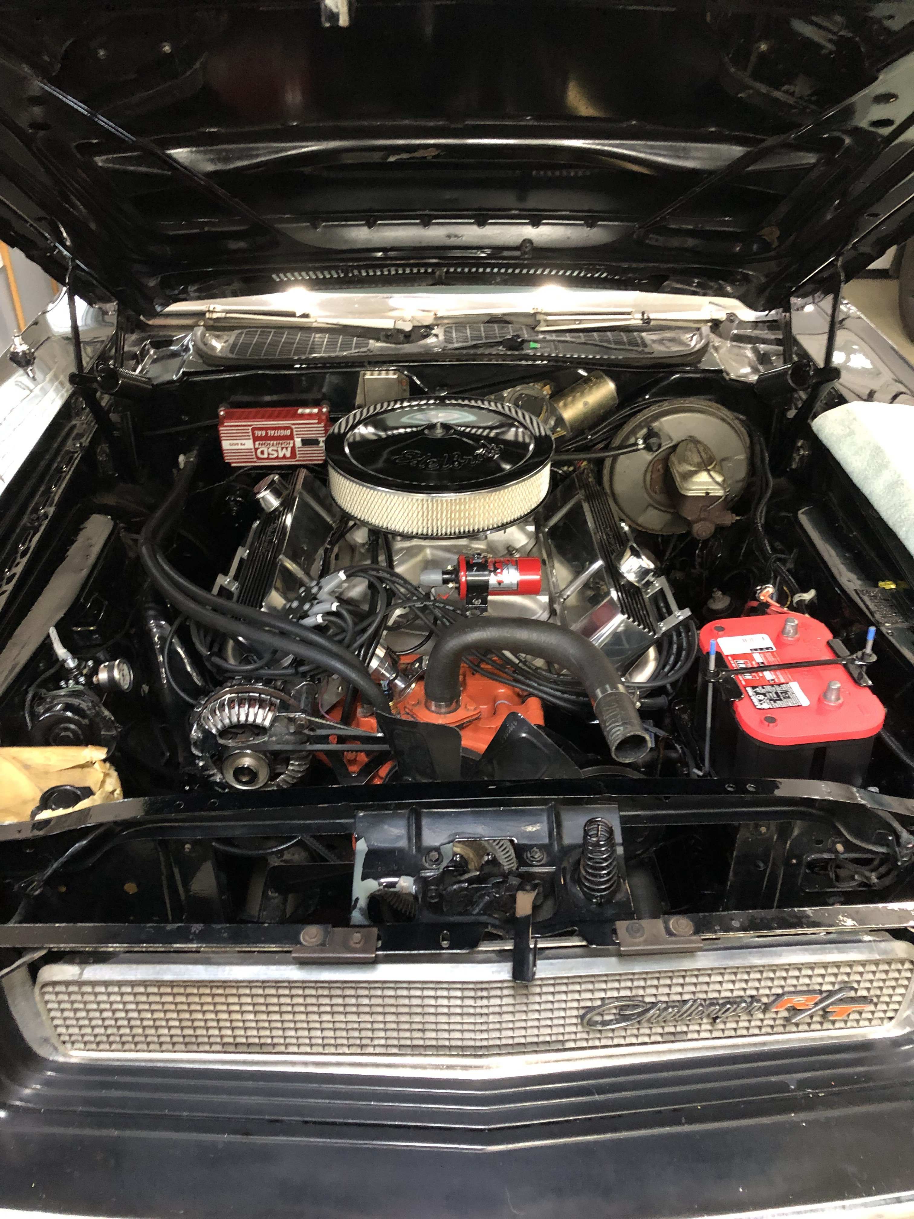

Beautiful car, for sure. I too have the Edelbrock air cleaner like you have. To ensure I had clearance I replaced the 3" element that came with it with a 2" K&N element to gain an inch. I currently have the Performer intake and will go to the RPM some day. Am running the Edelbrock VRS carb which is about 1/2" taller than the AVS2 I was using.

I'm sorry, it is a 440 based 512. My engine builder brought it to my attention that the edelbrock RPM was 1 3/4" taller then the stock manifold. We are wanting to run the factory dual snorkle air cleaner for the factory look. As someone stated, the rally rood is a few inches taller, so I am hoping that will give me enough clearance. If not, a aftermarket one will work. Thanks for the info fellas!

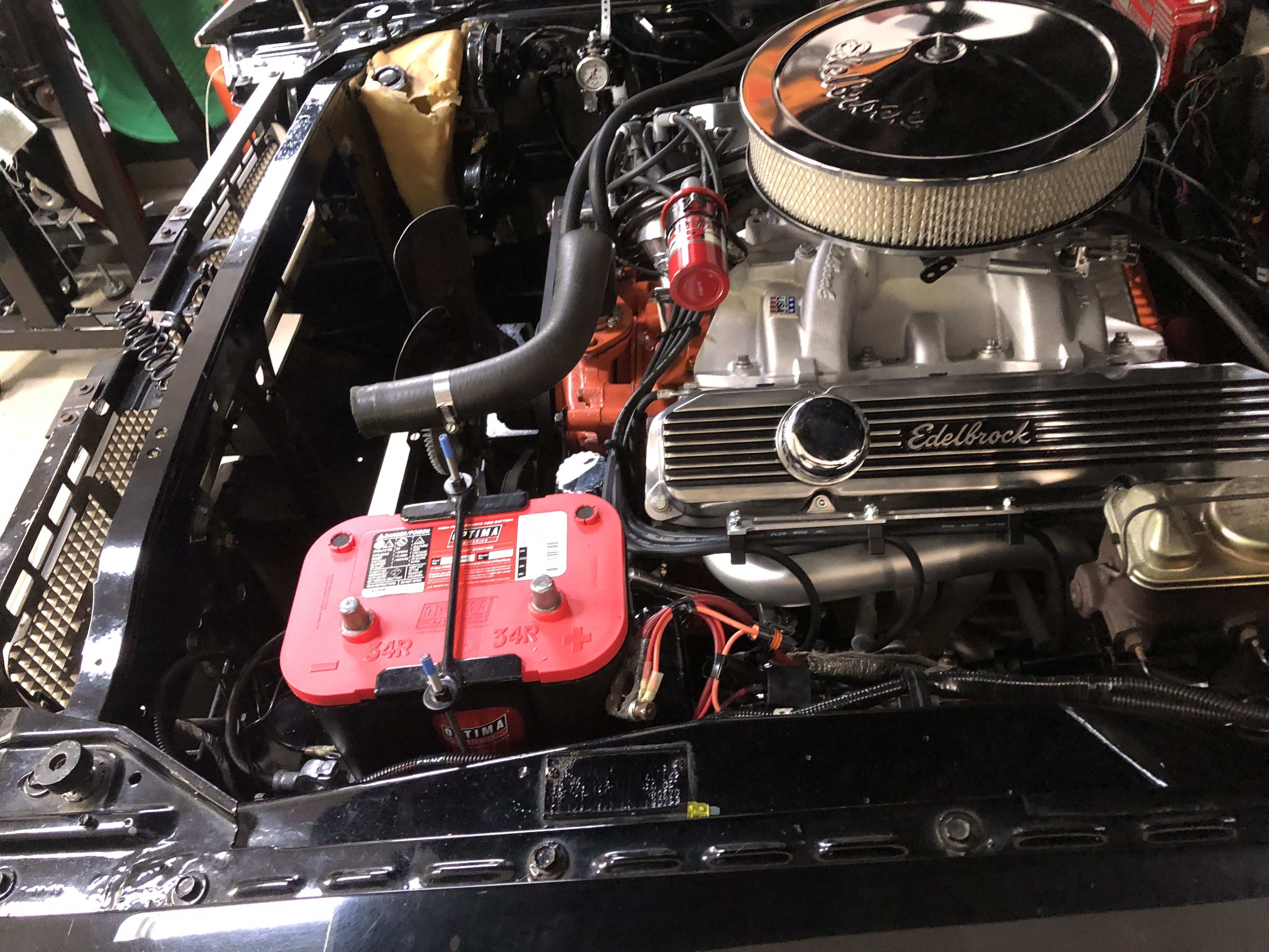

I did use an Edelbrock CH4B. It does fit with a flat hood but it’s super close. Thats also a 440 source 512.
