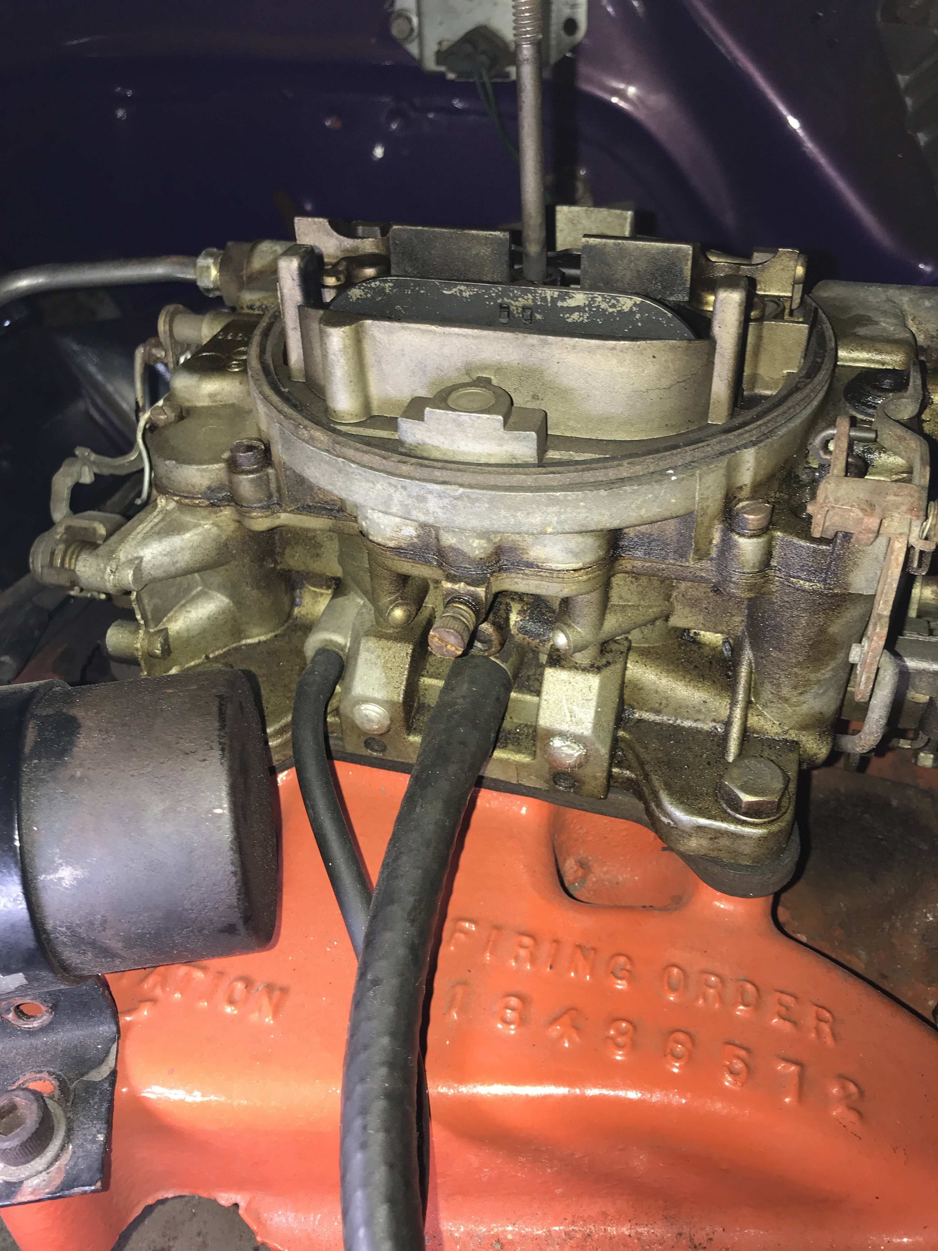

I found a Carter 4429S on my new - old Cuda, Should be a 4737S ... The 4429 shows to be for a 68-69 440 so should be OK, as I mentioned earlier the car has a slight low speed surge which the factory manual address's at the start of the 4737 repair section as the low speed idle needles are out of balance. I ordered a set of new needles for a 4737 ( yea, cart before the horse ) and need to lookup if the same needle size, should be but?
My issue is, the factory needles seem to be in a recessed hole in the base, and seem to be STUCK, they wont budge. am I working wit the correct needles ( I'm really not a Carb guy ). The factory repair manual says to pop off the plastic caps to get to the needles, are these the caps above the two "holes" or are the plastic caps just missing.
