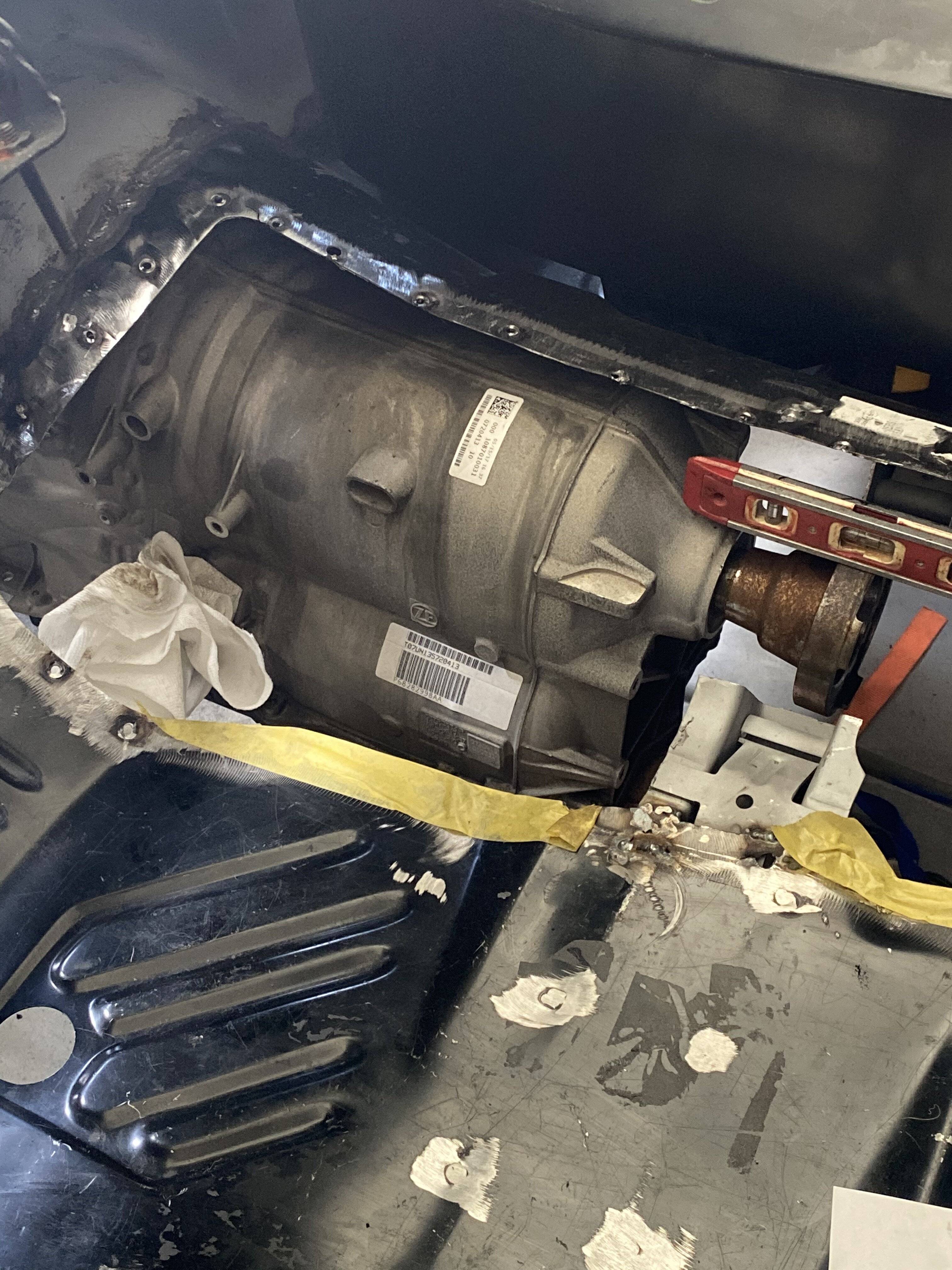

I am using the HP-70 8 speed auto from a 2017 charger. The 8 speed with 3.23 gears will pull about 1900-RPM on the freeway at 70MPH. HotwireAuto has the complete hookup for that trans and the 5.7 Hemi

Her is what I had to cut on the HP-70. You will notice i removed the 4 speed tunnel, but have since put one back just in case i want to convert it down the road to manual.

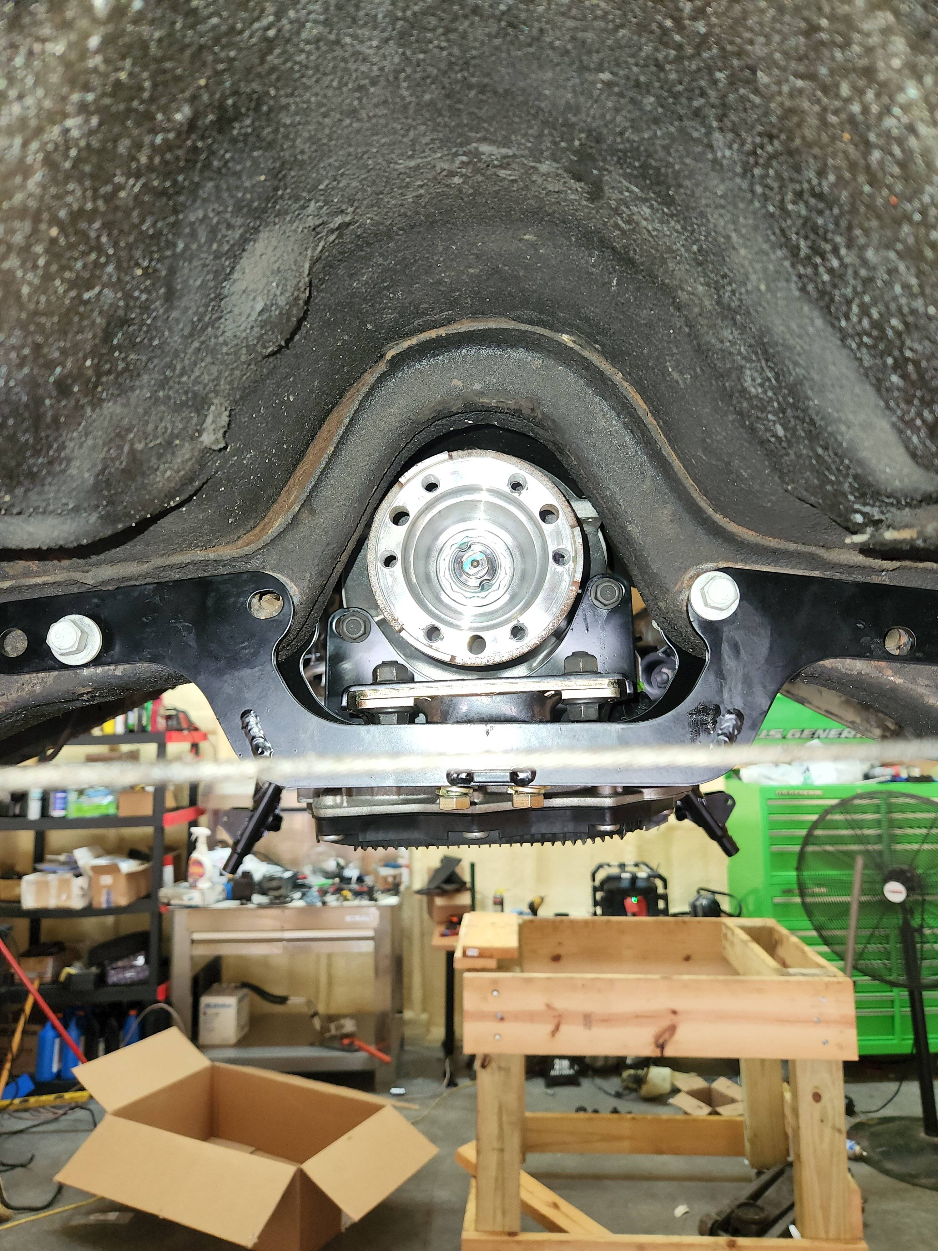

Damn I didn't have to cut anything on hp70 with the holley swap kit. Cut a few tabs off trans and light massaged the tunnel.

Only thing you have to Be careful with is the driveshaft U joint adapter may rub bracing At the top. I had to cut some of my crossmember bracing out on mine
Yeah it's close but I think it will be ok. Guess I'll find out when she's up and running..
