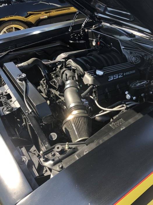

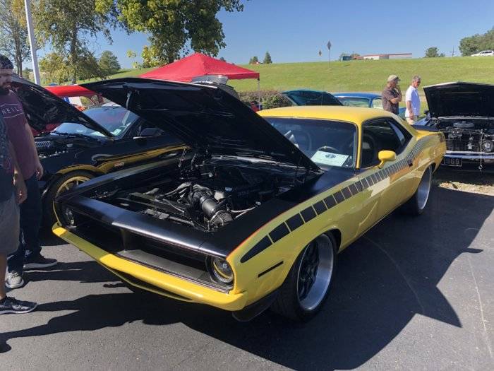

Look for my post on the 6.4 392 I've installed into my 73 Cuda. All done and like this thread I have lots of advice as well. I bought all new items and had to do little modifications to the car. The car has not been beat on yet as im at the 1,000 mile break in point. Soon I'll be able to open her up.

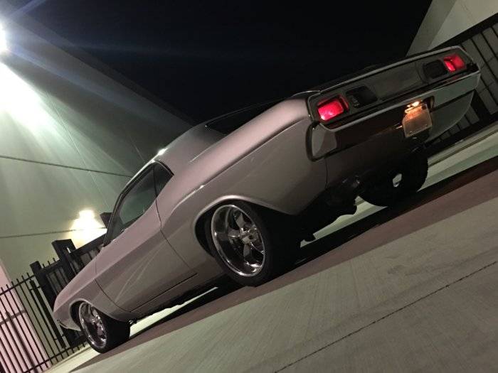

I just have to start out by saying how much I like the approach you took with your car. Can you post a shot of the rear. I'm curious with the subdued look what you did with the exhaust. I've been contemplating this swap as well, so I appreciate the advice you've provided so far. At the moment I'm putting in the MSD atomic fuel injection in as my 340 is pretty stout.
HP,
Wow. That looks really clean! I'm a huge fan. Your car is as close to what I would want to build as possible and looks extremely well executed. thanks for sharing the photos. Hope to see it in person some time.
Thank You ! I only regret not running a taller tire or slightly bigger rim , it sits low and the trans pan is super close to the ground. I will figure it out though . If you in southern cali for sure we can meet up and you can check it out
