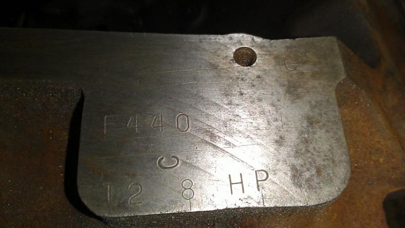

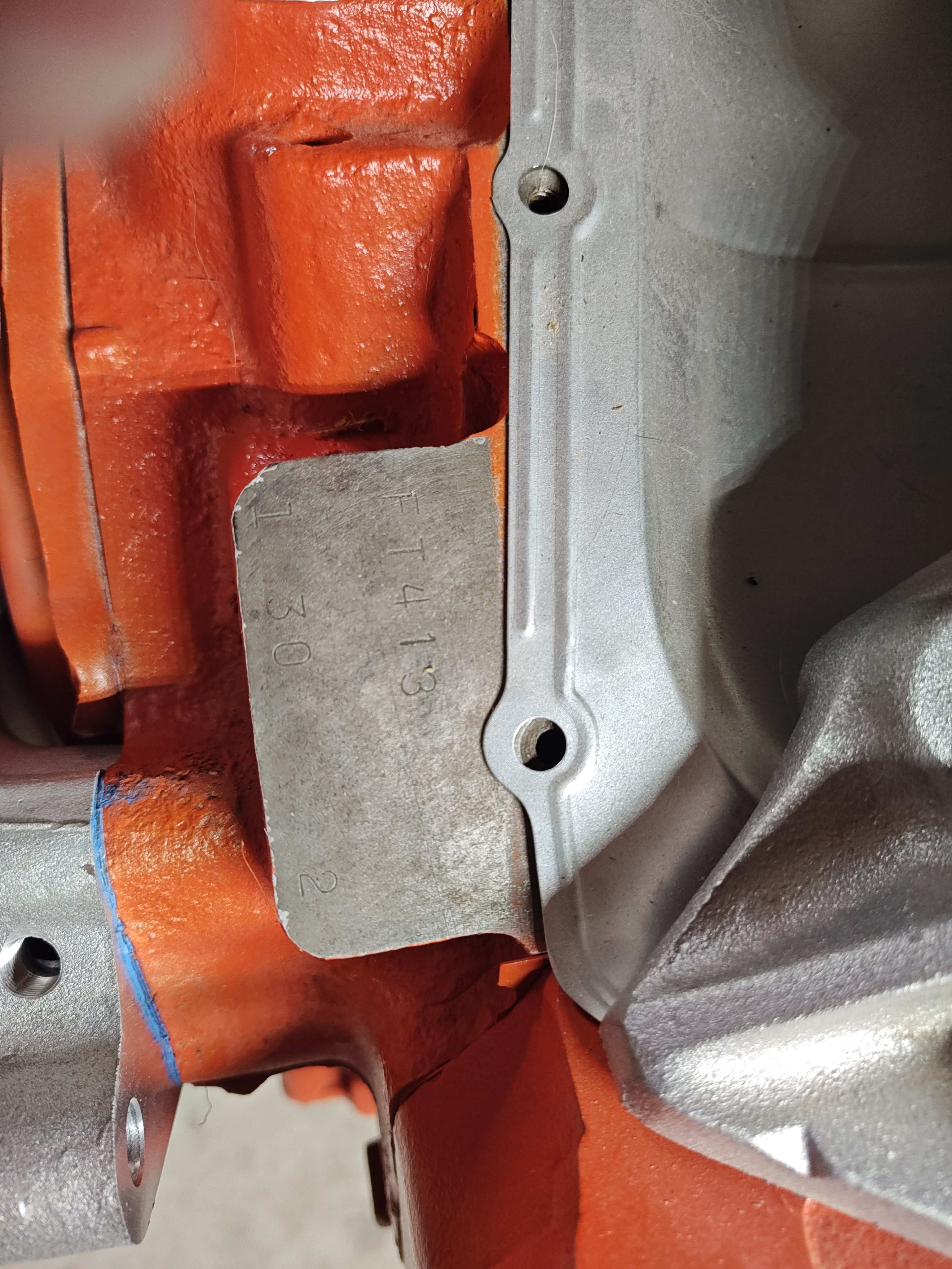

By the way, 69 casting dates are normal as they started making 1970 model parts in the Fall of 1969. The pad on the front of the block should have "F440" stamped on it. See my 70 413 motor pad for reference.

The F440 engine pad for an HP block. Date of 12 8 is December 8, 1969.

Has the date on your block been changed? The number 1 in 413 is a different font to the 1 in the date.

I assure you that the 70 413 I have came home a 70 motor home from the factory. Goes to show you that the factory used different "fonts". I sure they knew it was a "70" just not sure of the actual build date.
