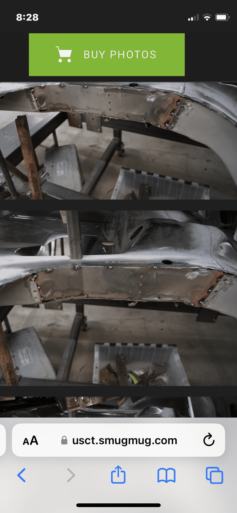

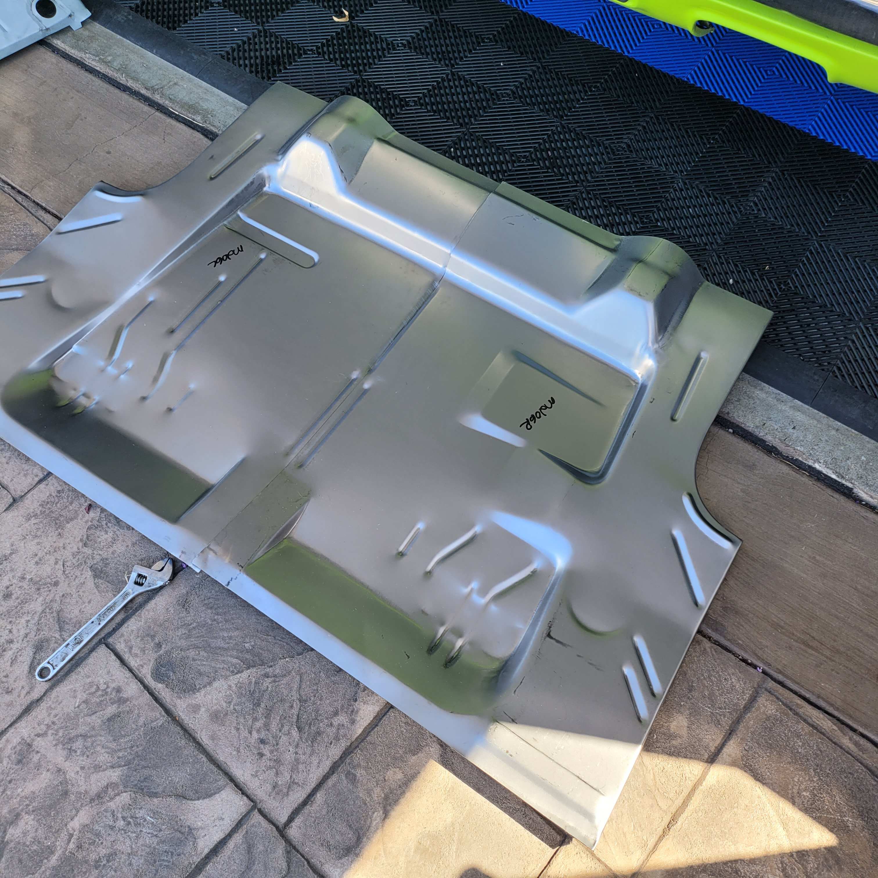

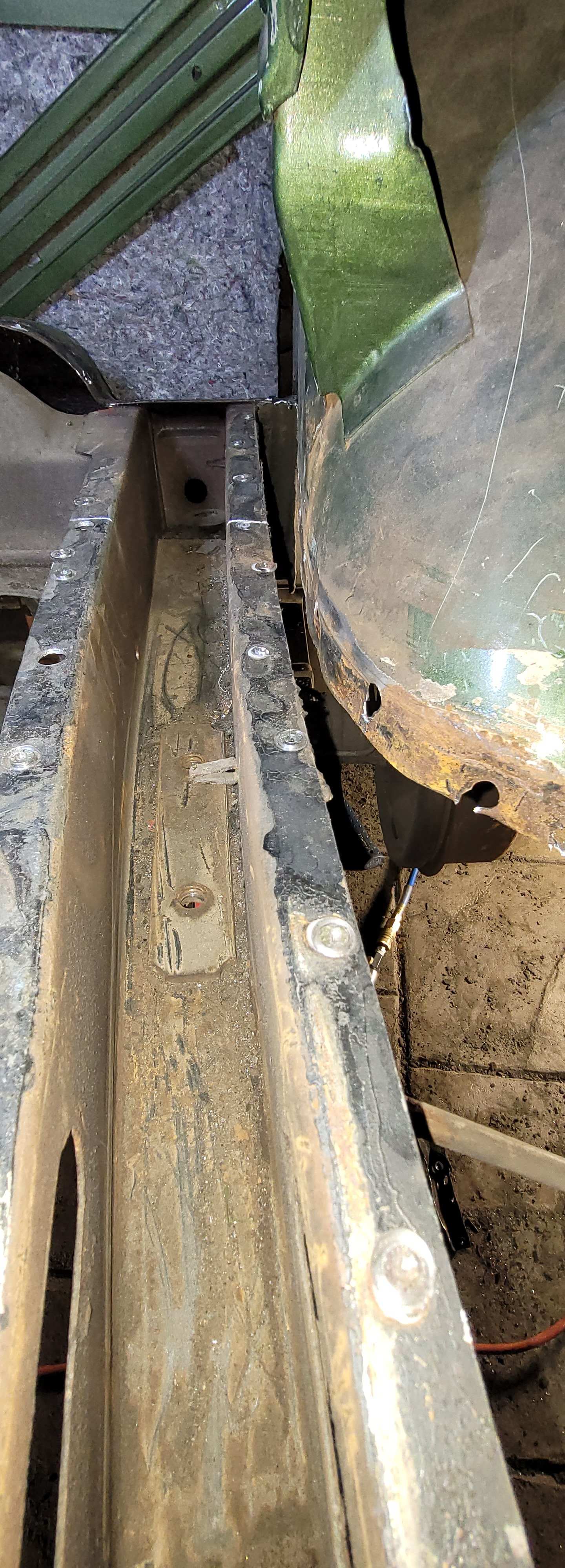

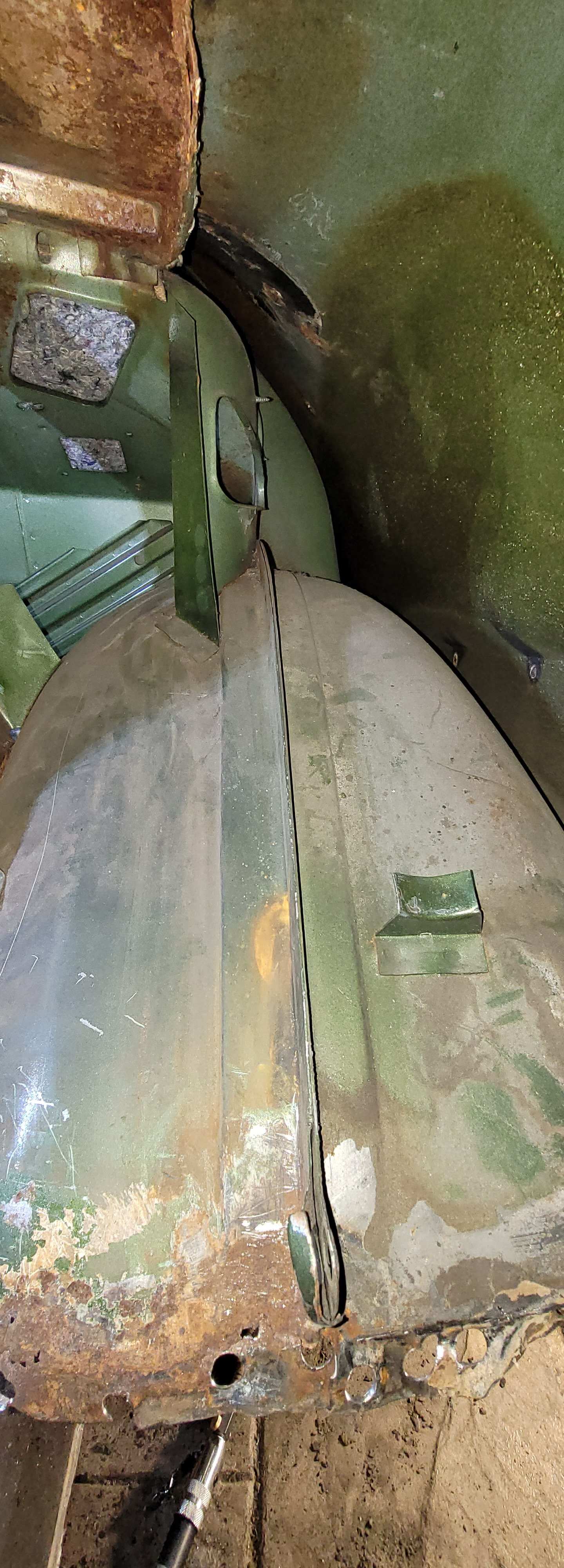

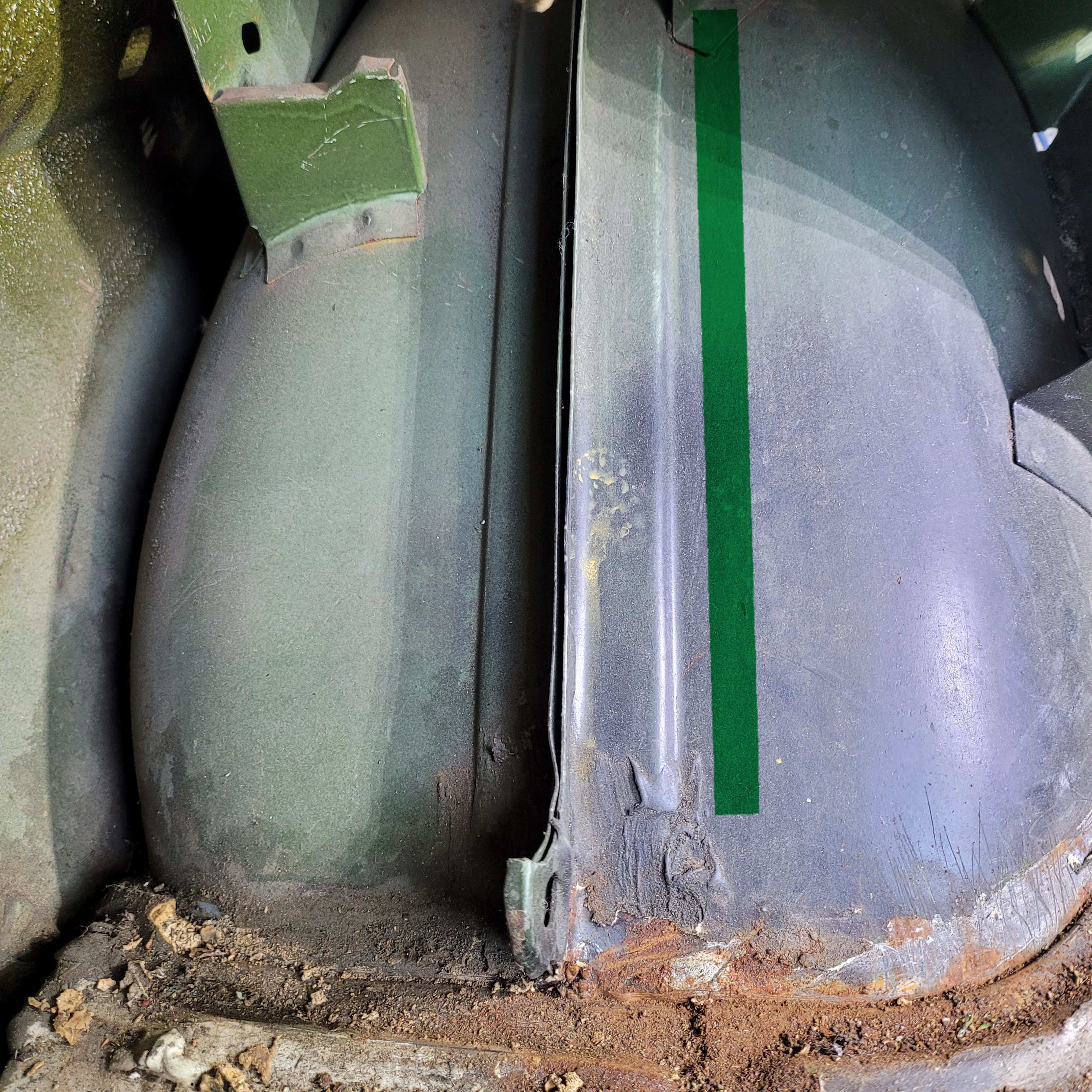

Hey all, I'm going to start replacing my trunk pan this weekend and was planning to mini tub at the same time. I opted for the two piece pan kit as shipping was unbelievable for a 1 piece. They wanted $380 just for freight. I figured an extra weld was worth the savings. For some reason my tubs look like they were widened but I'm not positive. I feel like the raised area in the middle of the tubs would be smooth not raised. Can you tell me if these look stock to you.
As far as the mini tub goes I've read a few different ways to do this. Any suggestions on this? I was looking at the US car tool kit but they sure want a lot of money for some sheetmetal. I was thinking about cutting the tub moving it over to frame and welding. Then just add a strip of metal, weld it up and seam seal it. Green line is where i plan to cut and weld in the strip of sheetmetal. Let me know your thoughts.

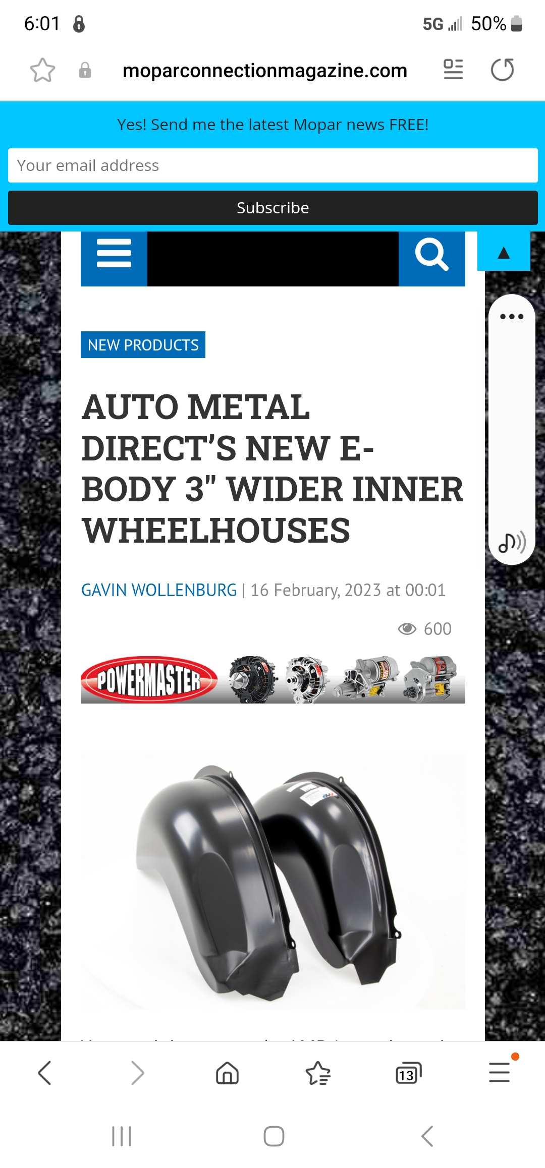

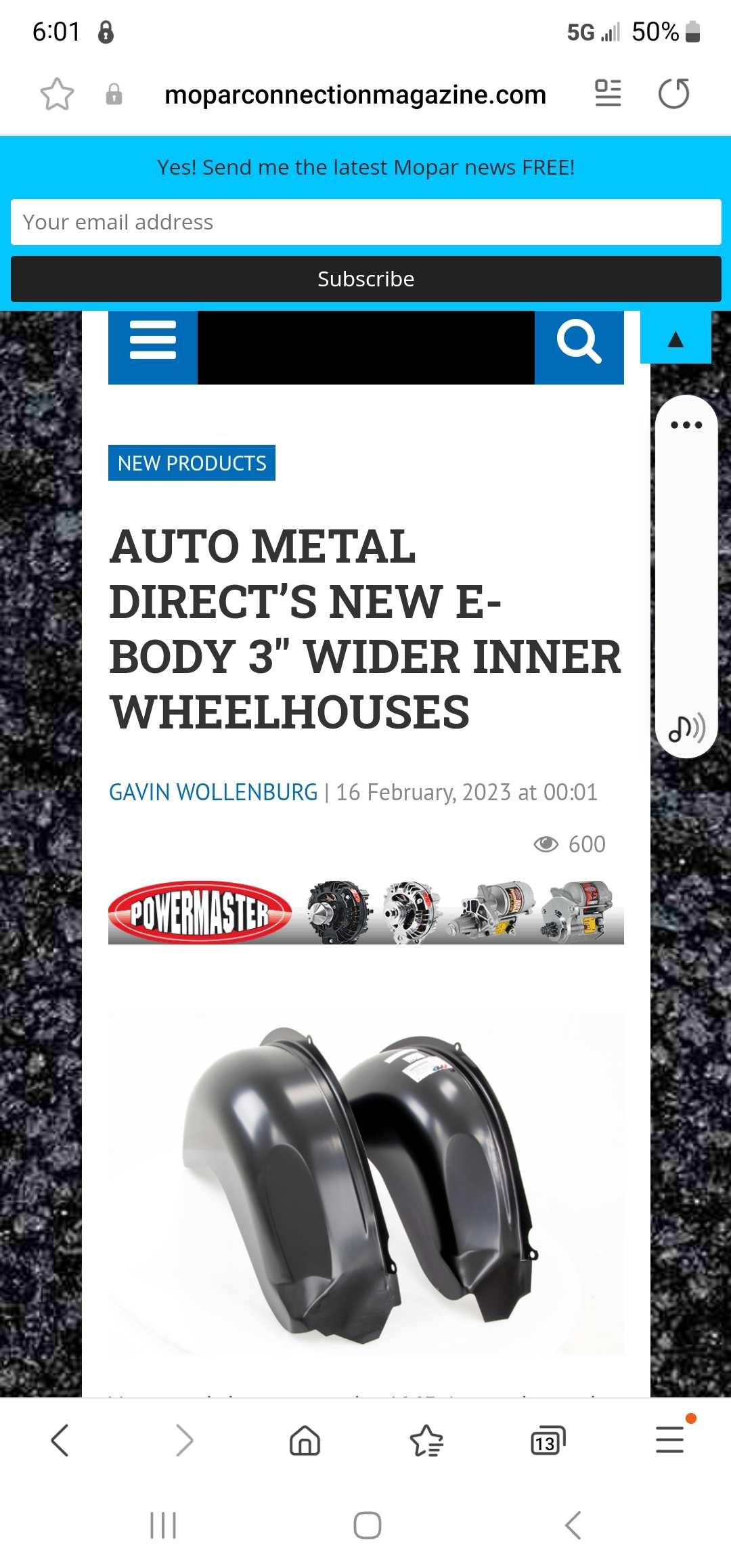

Those are stock. You can widen them the way you stated. AMD sells three inch wider inner wheel tubs. Might be less work.
Chryco Psycho
4,476
2,127
Panama
I have done what you plan many times , cutting the tub moving it over to the frame & filling the gap , not hard to do .

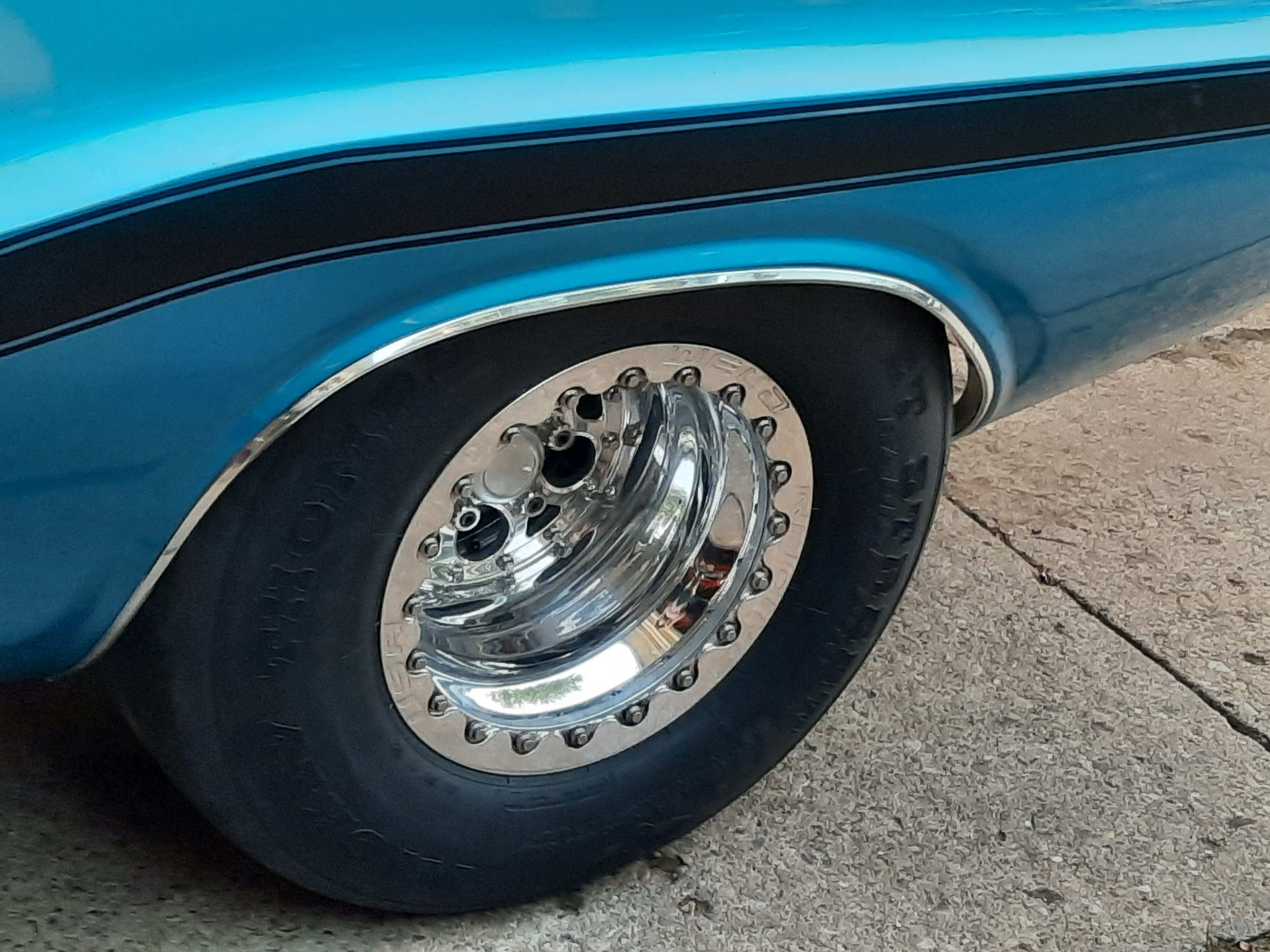

Mine is mini tubbed moved to the frame rails with Caltracs and split mono leafs. I run 15x12 wheels with 315/15/60 Drag Radials or 29.5"×10.5W slicks.

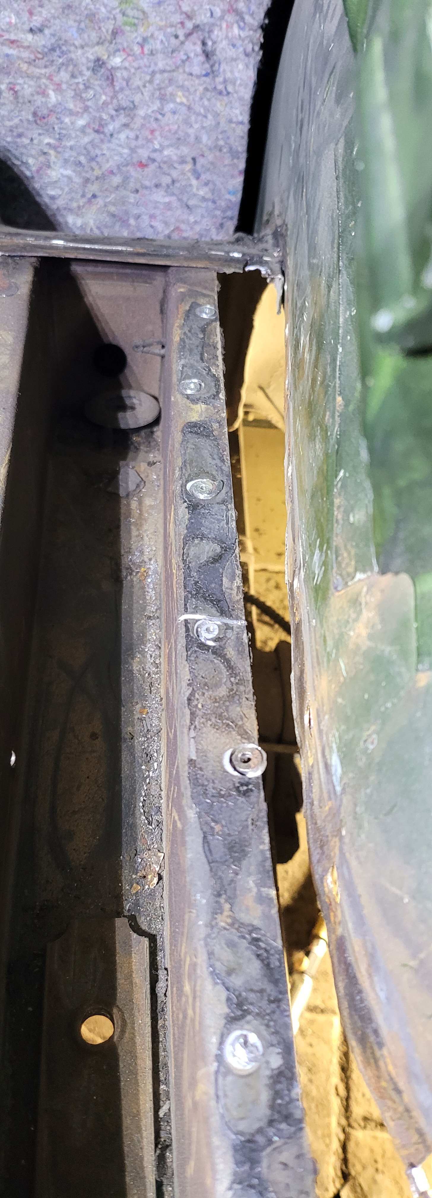

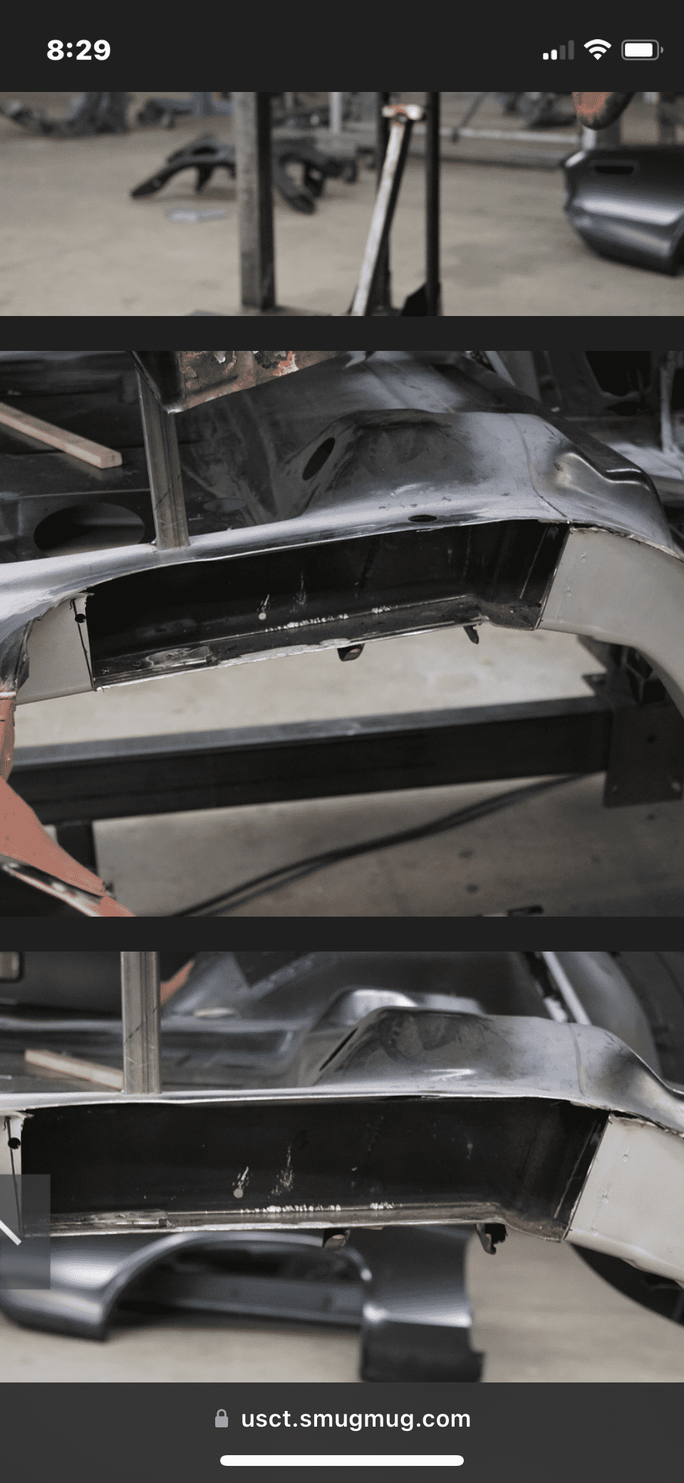

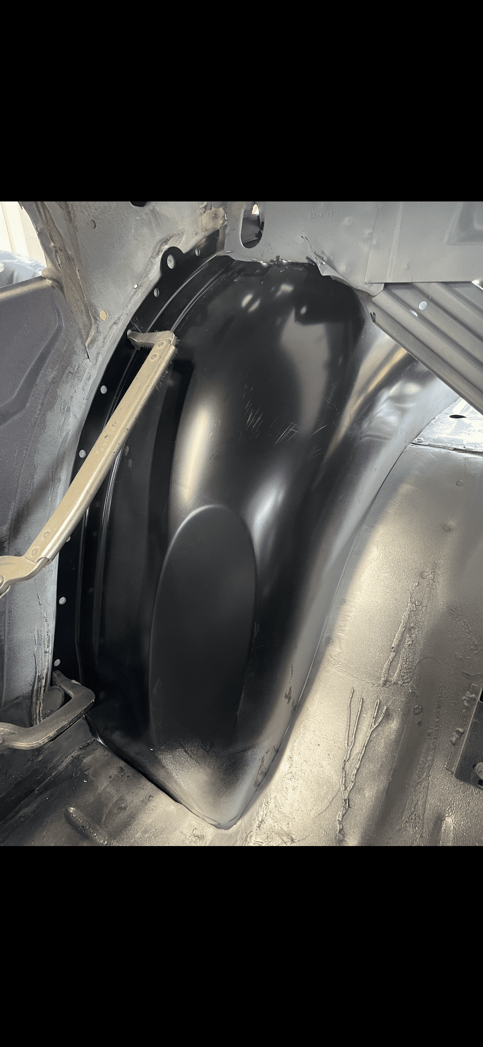

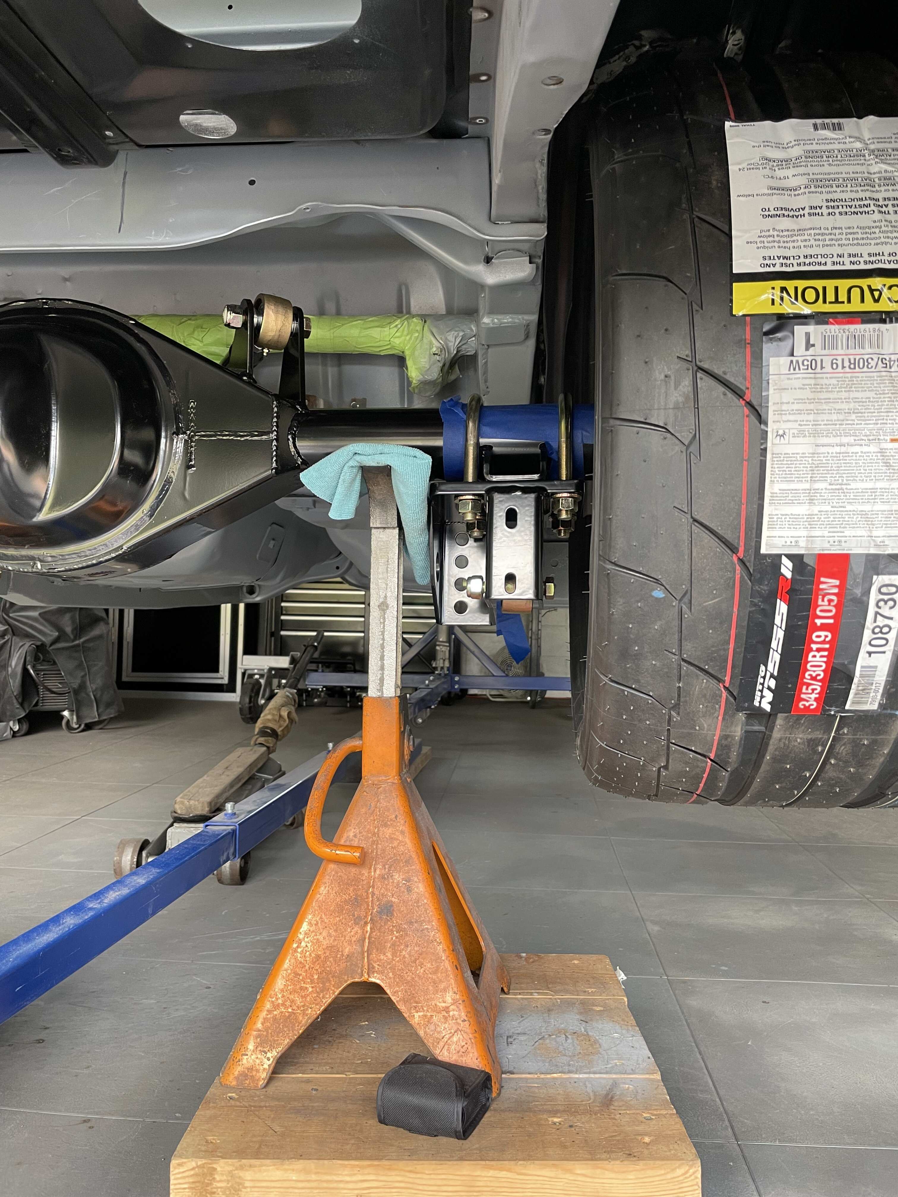

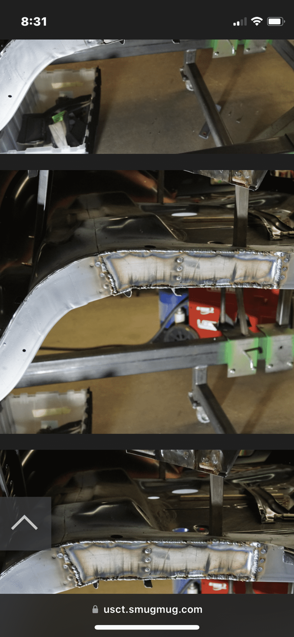

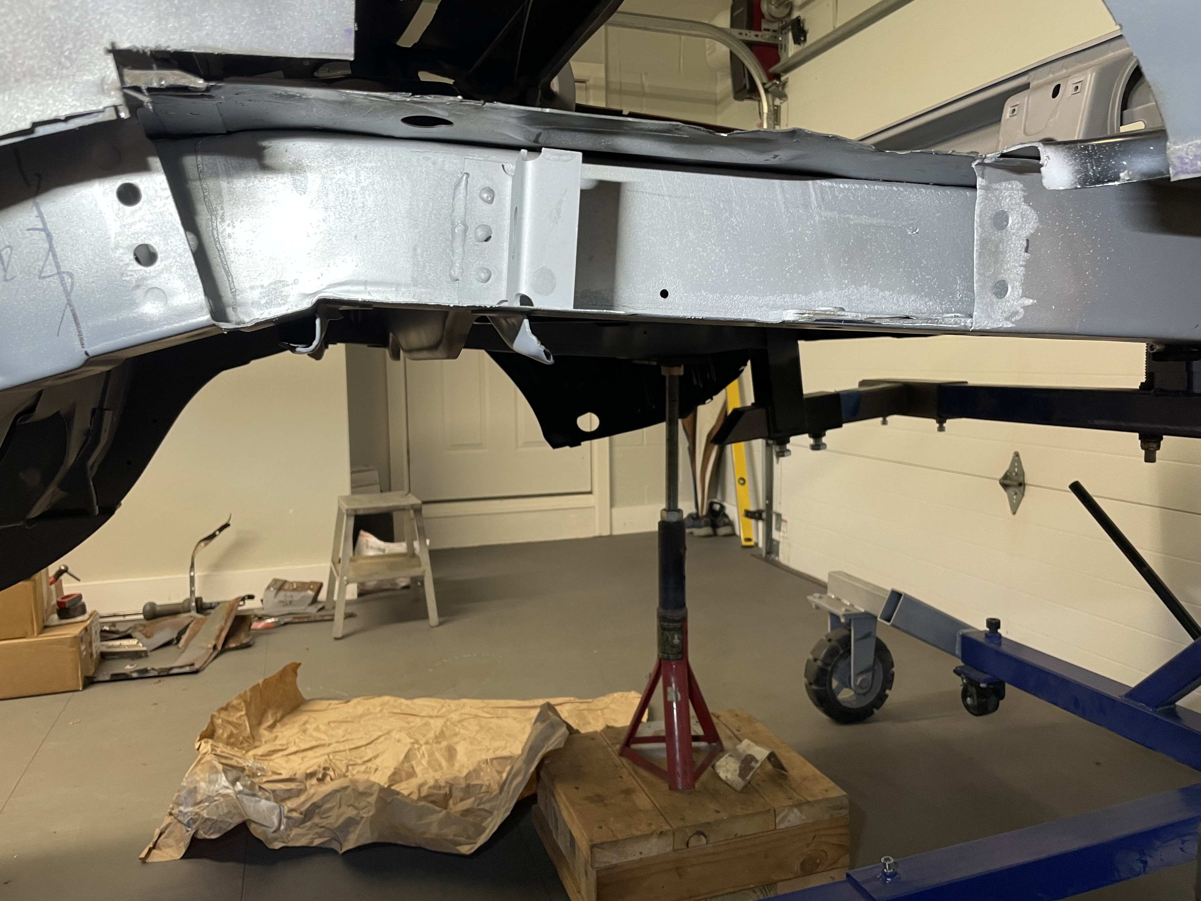

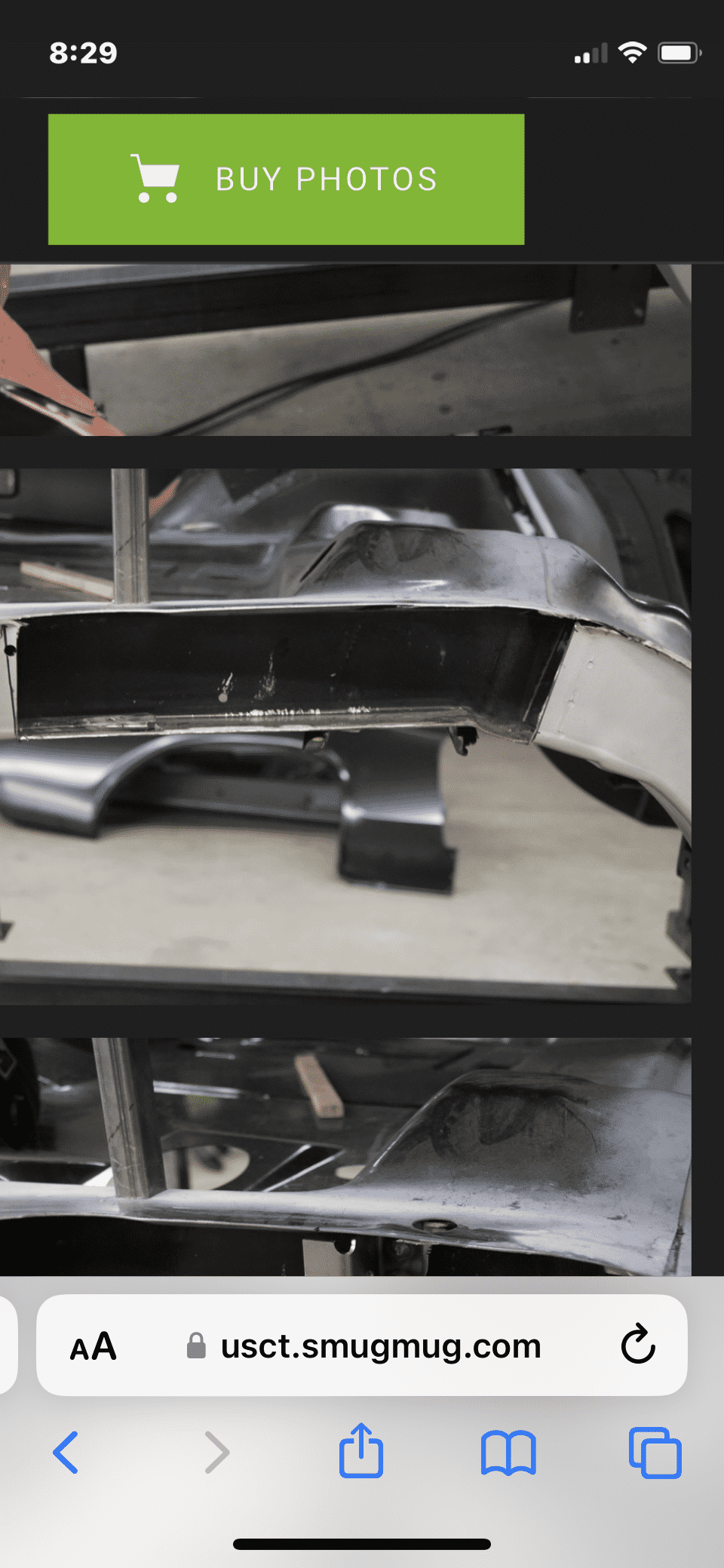

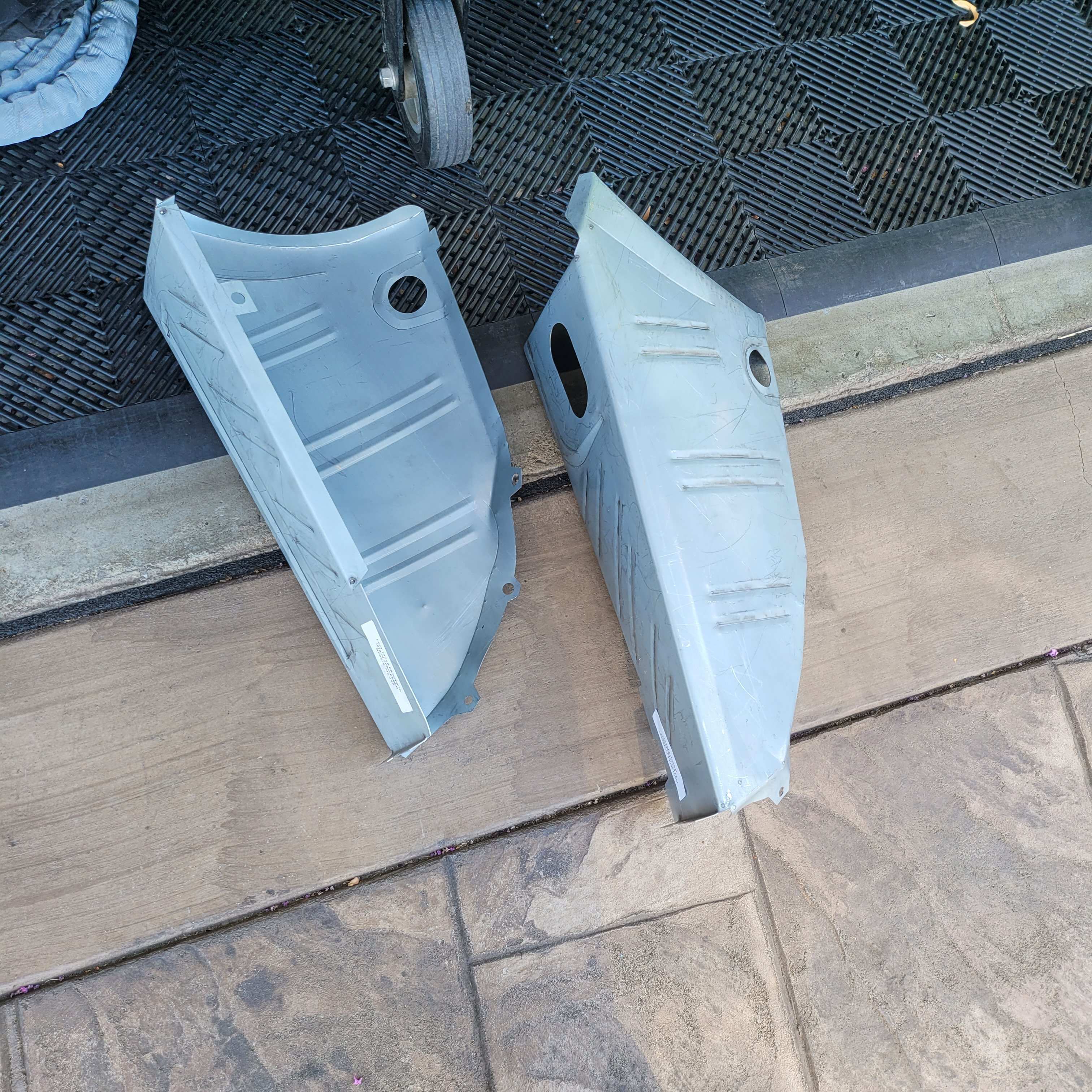

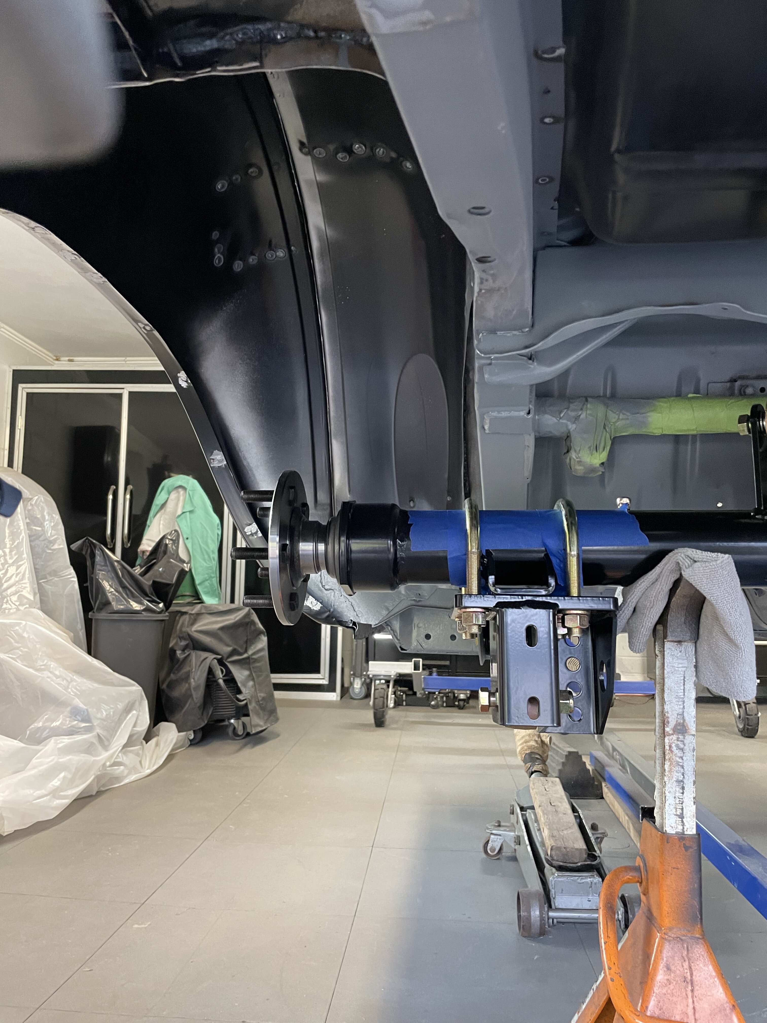

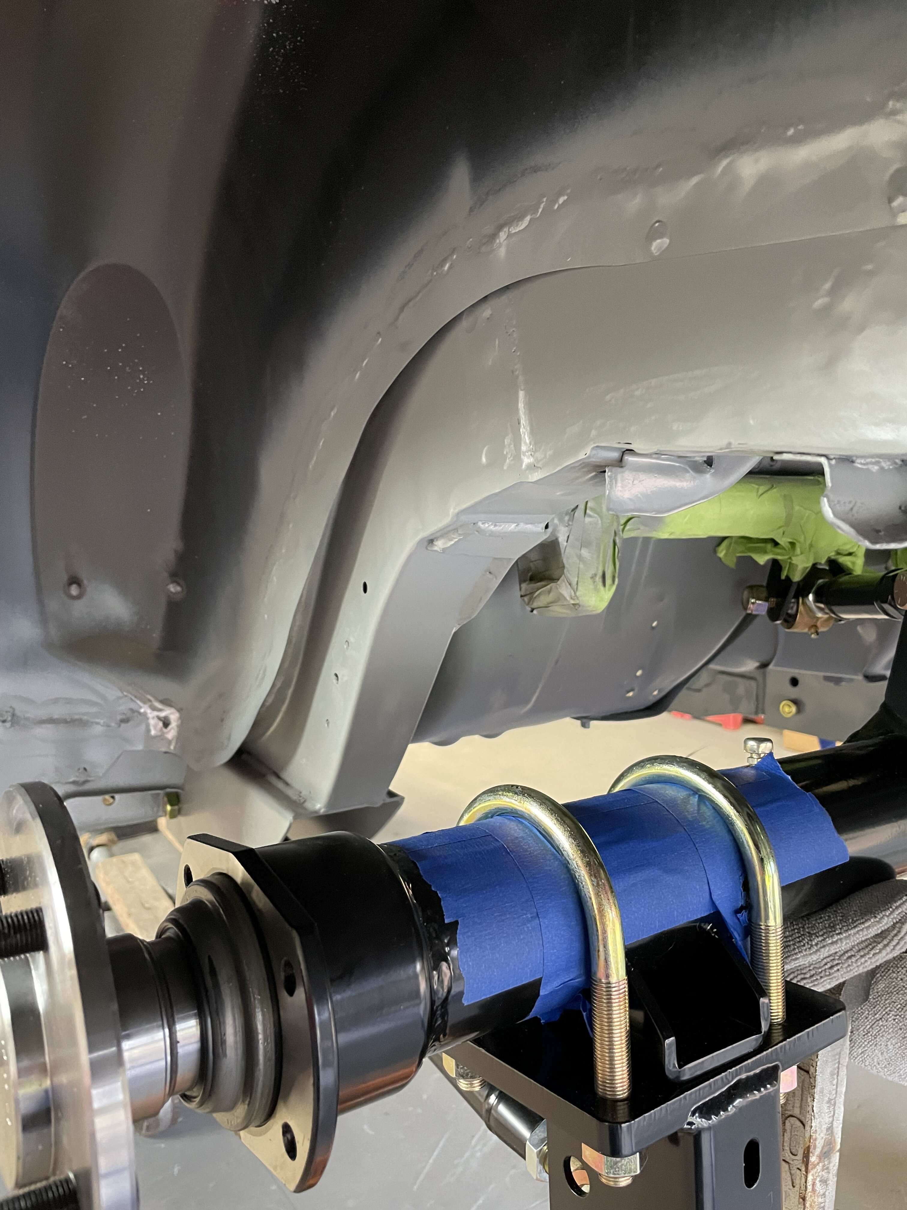

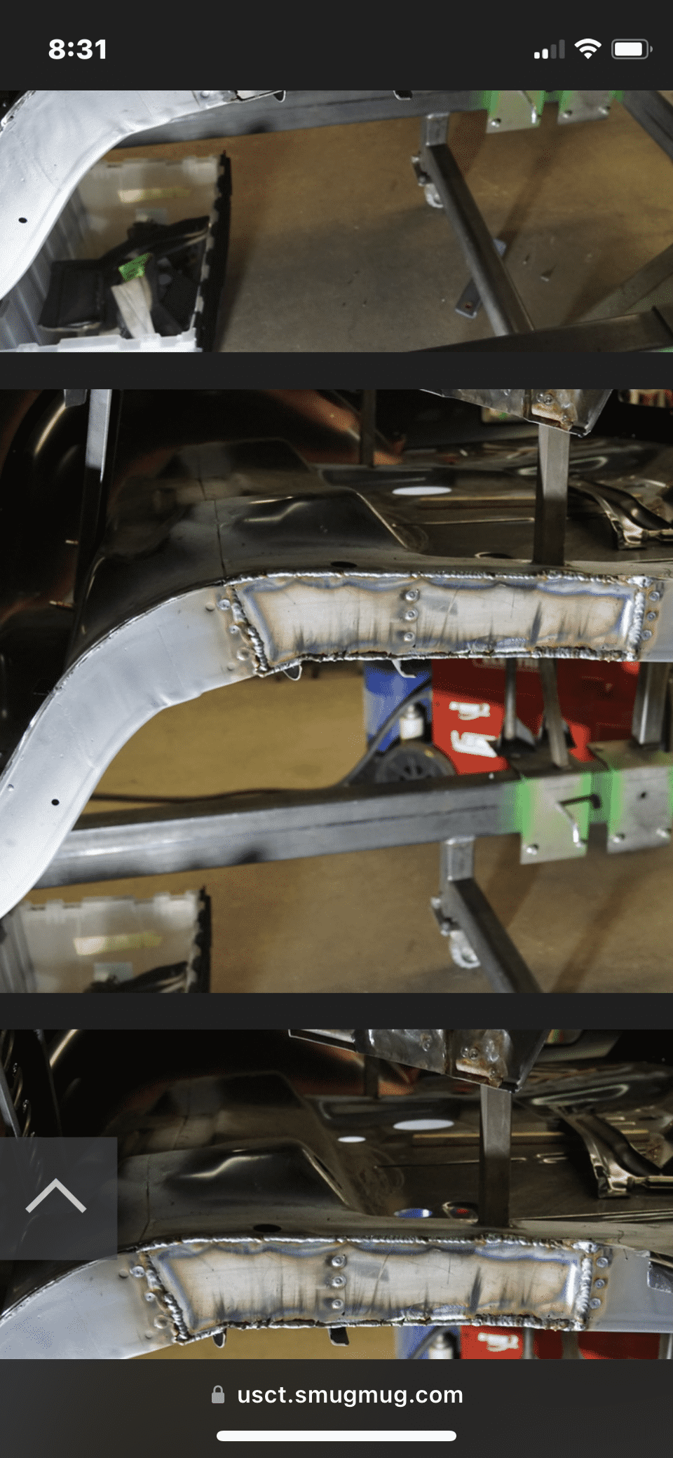

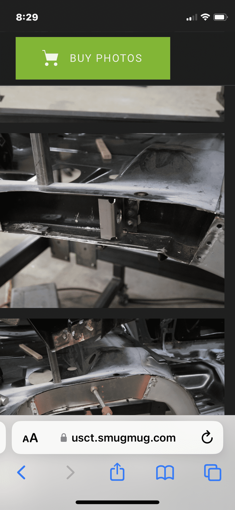

I just finished installing mini tubes in my Challenger.
I used AMD inner and outer wheel wells . You have to remove the flange on the outer part of the frame rails so that the wheel well can lay flat on the vertical surface of the frame rail. I also notched the frame in approximately 1-1/4” for the last third of the wheel well other wise the wheel wells will not fit.

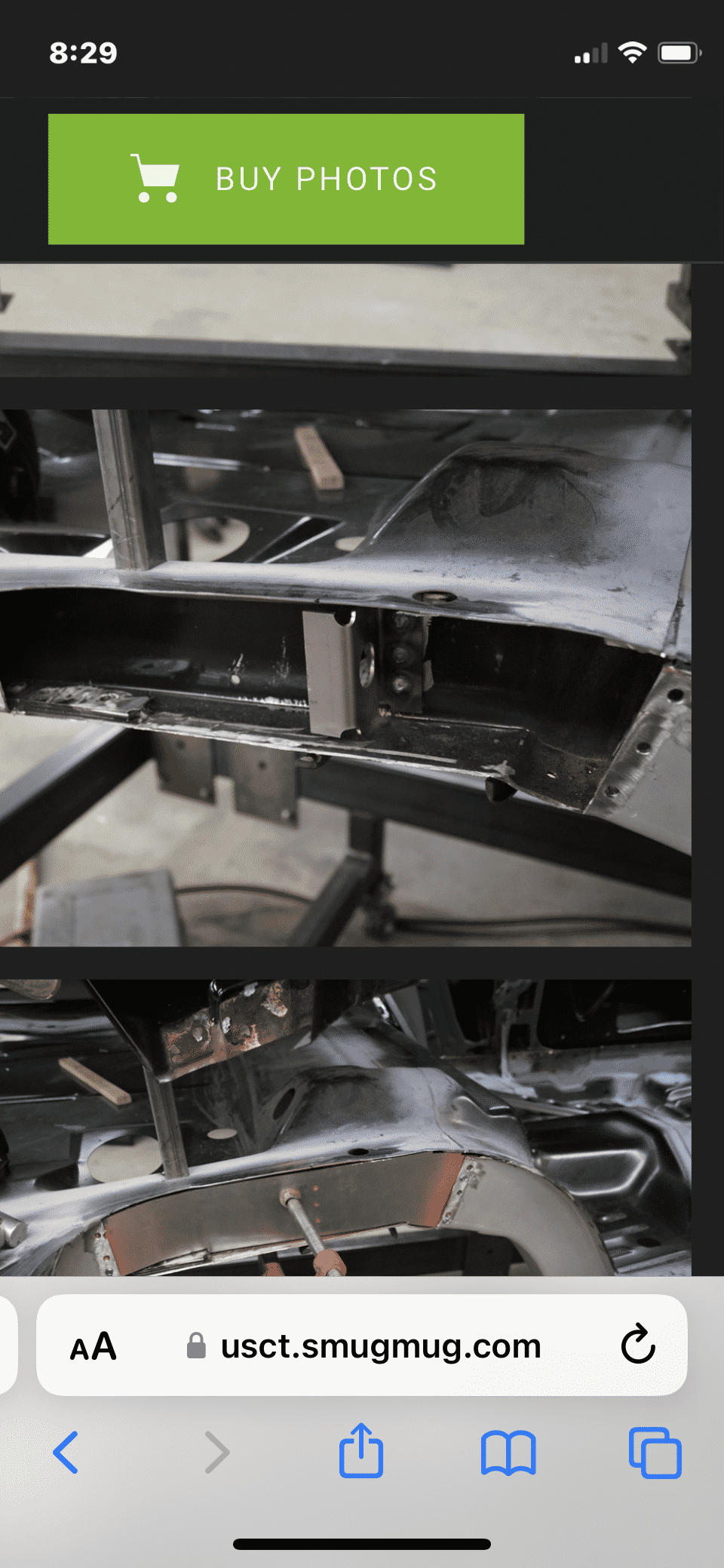

Uscar tool sell that kit.
1moretoy
Sep 12, 2023
77
31
Bay Area

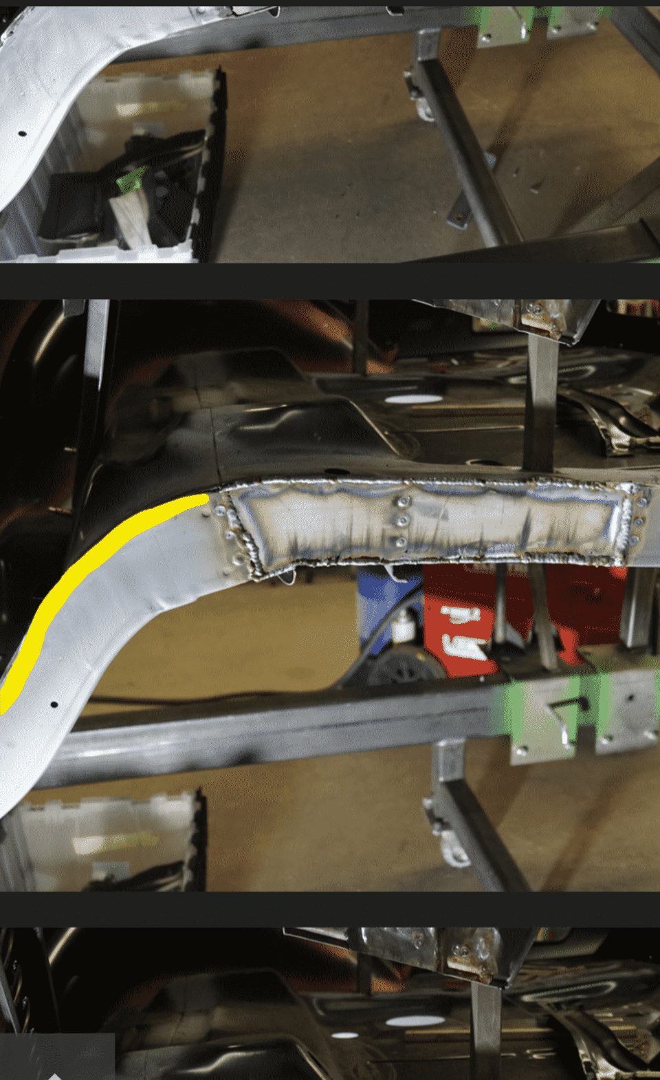

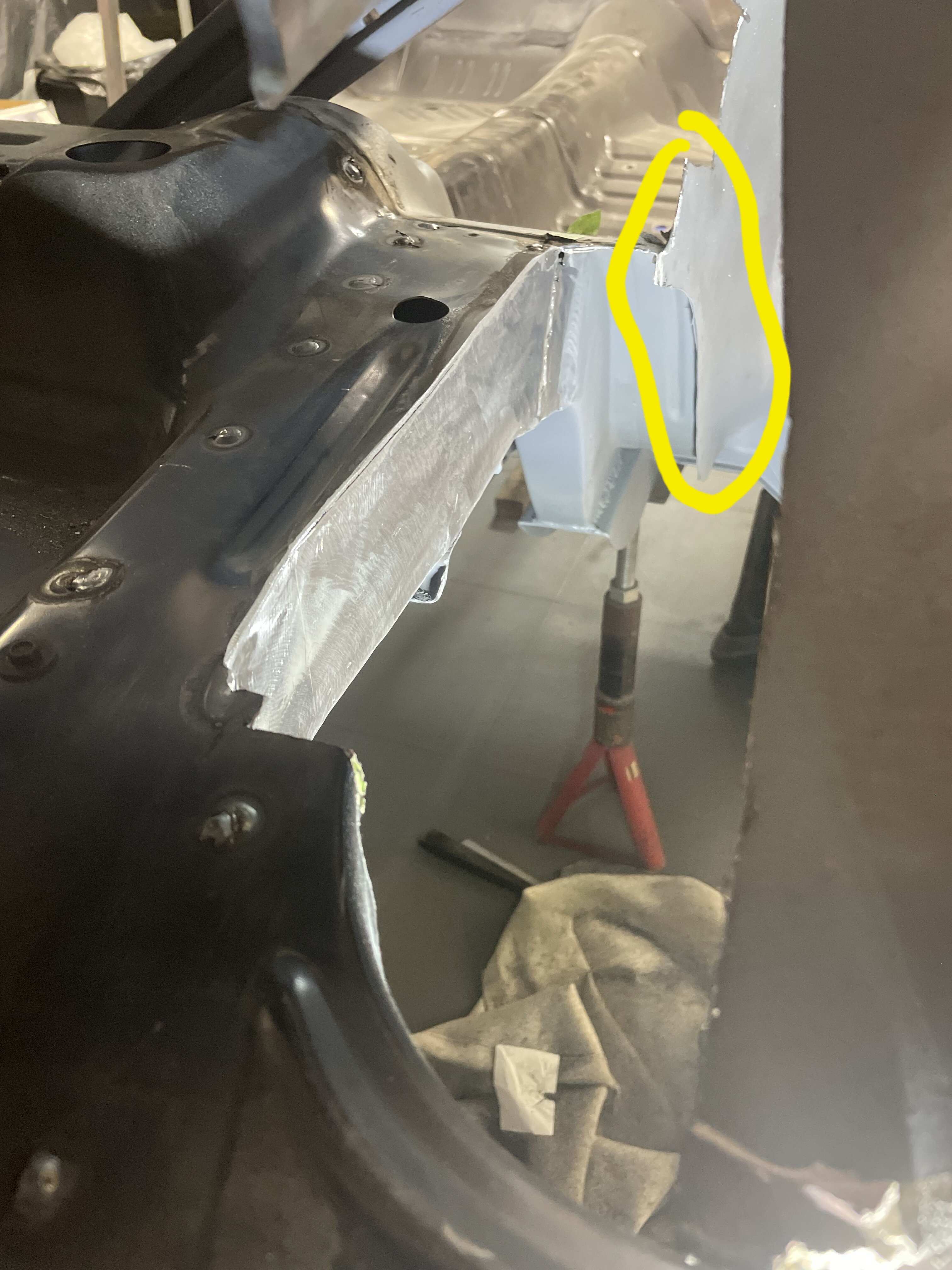

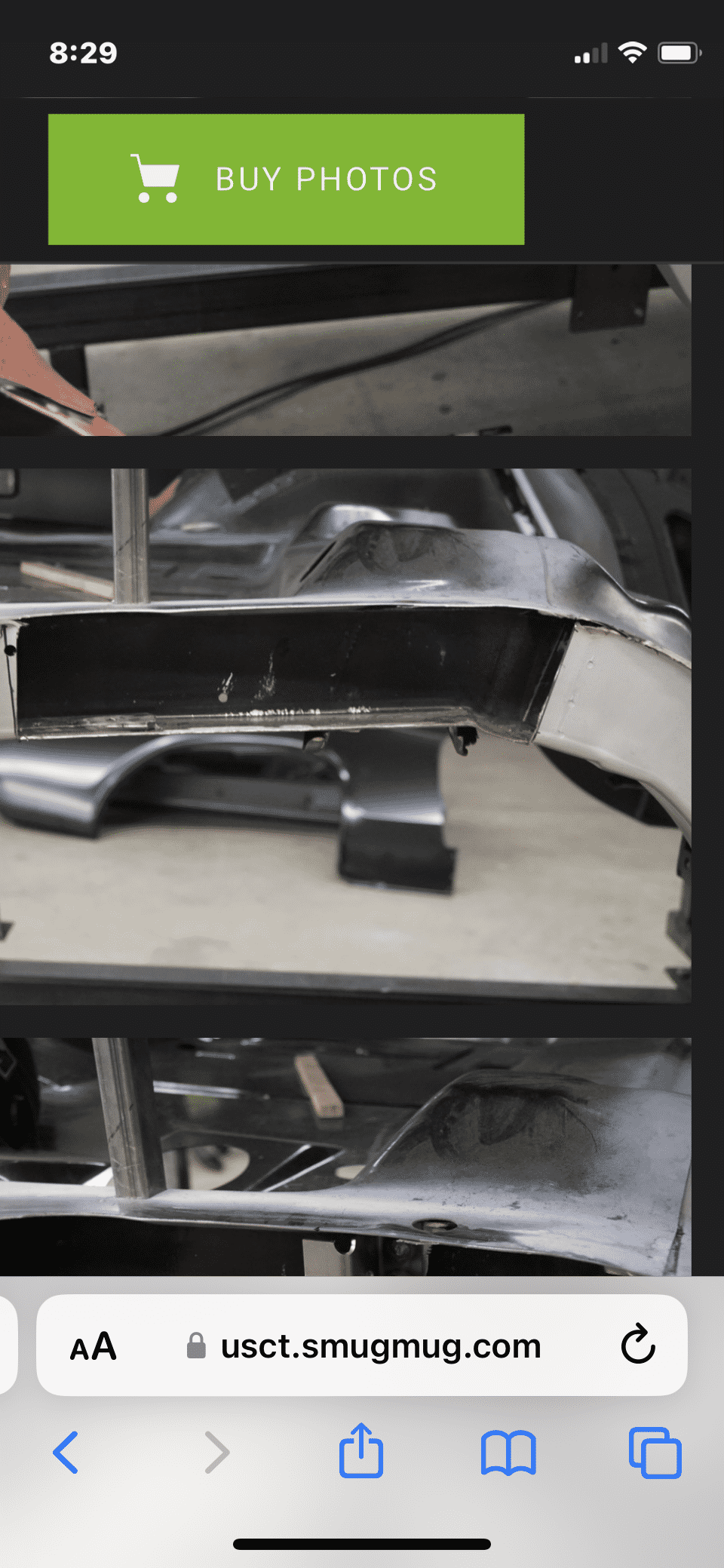

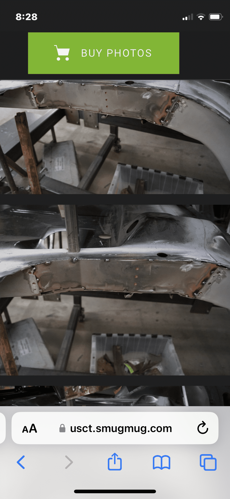

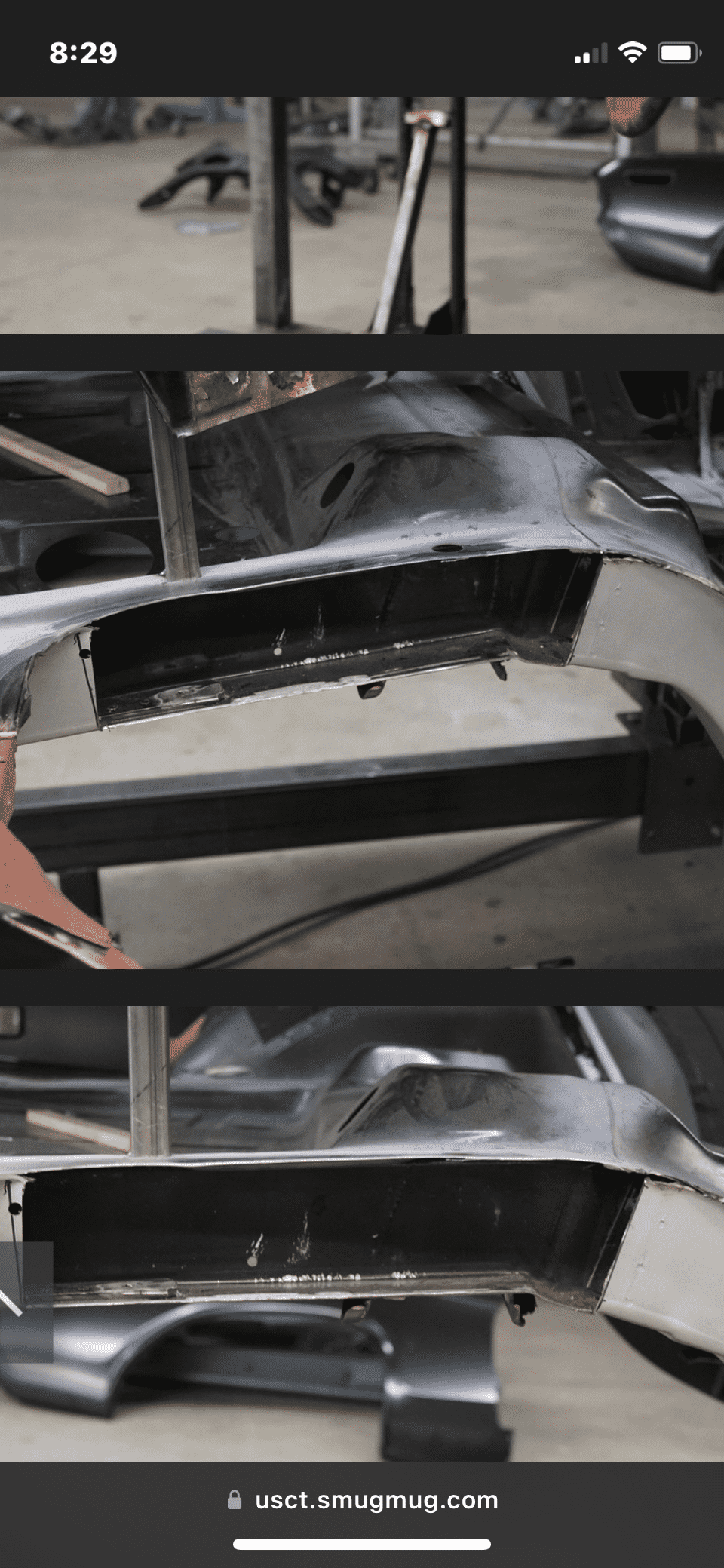

Thank you for the great reference photos. Is the pan flush with the frame all the way down the to the end of the tub. Essentially where I have the yellow line? I have to cut the frame flange and pan flush with the frame rail all the way as well?
Pistolgrip496
Jul 30, 2018
33
13

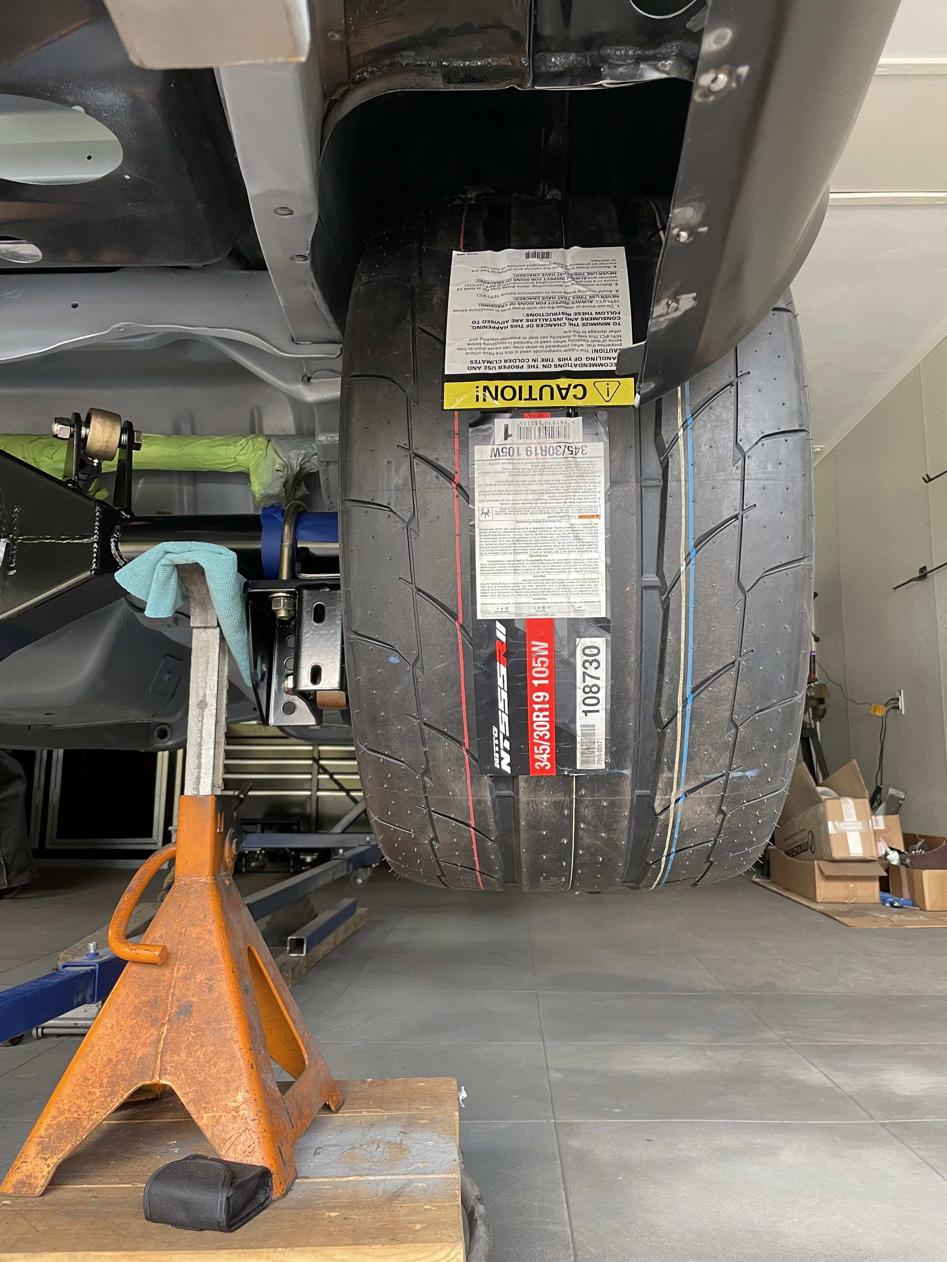

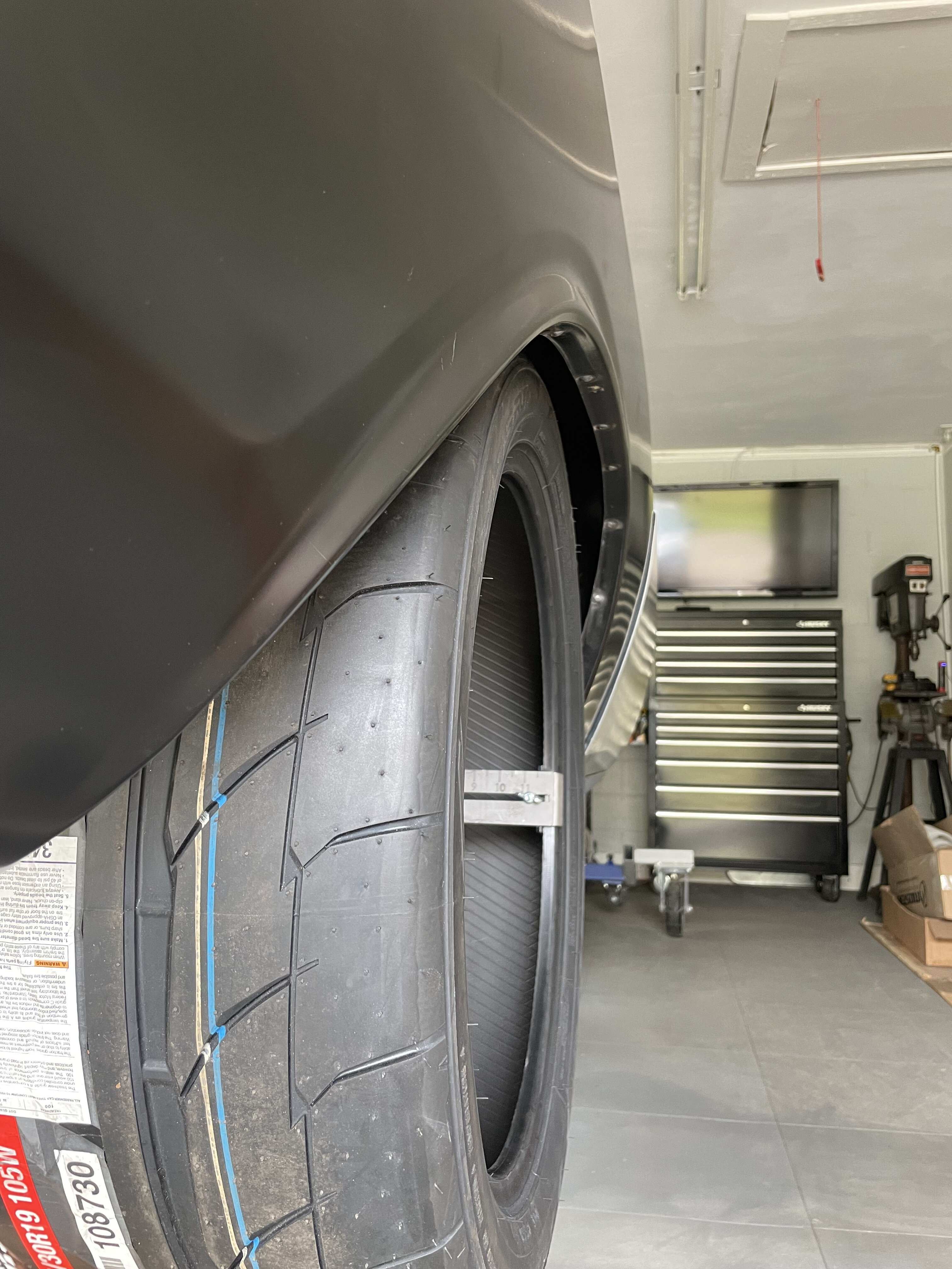

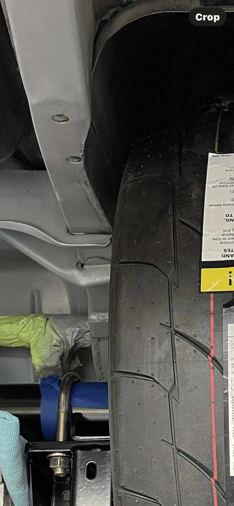

No only have to notch the last 12 inches behind the axle nothing in front of the axle
I can fit 345/35-19 tires with 1 inch clearance both sides
Pistolgrip496
Jul 30, 2018
33
13
It’s hard to tell from the pictures if you look at the bottom of the frame rail there a two bolt holes that a factory bracket bolts to I believe it was used to secure the car doing shipping from the factory that’s where the notch ends you need the frame rail to parallel the inner tub

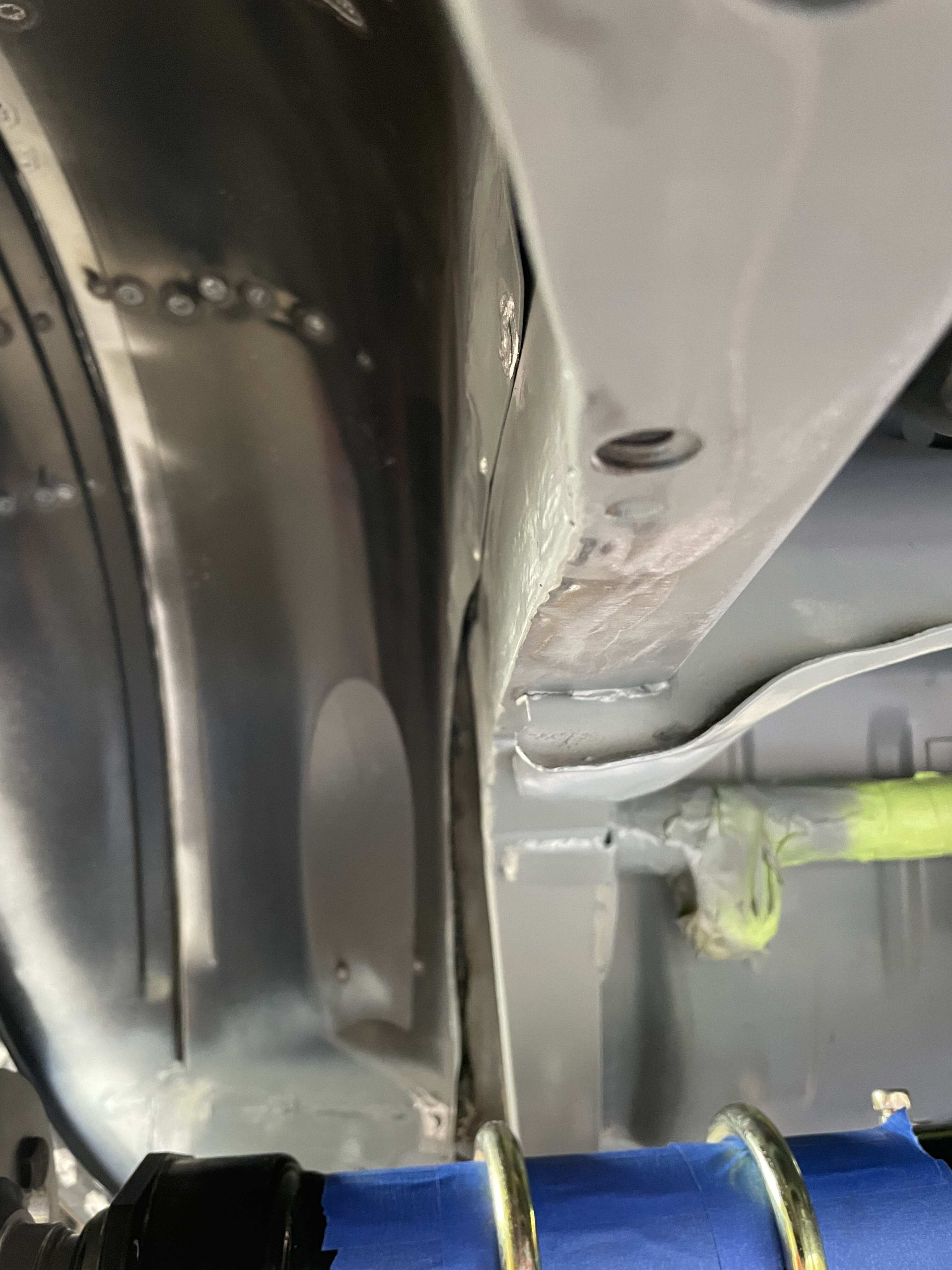

Pistolgrip496's photos are pretty much how I did mine as well.

Any photos on how you finished this part? I really appreciate the help guys!!!
