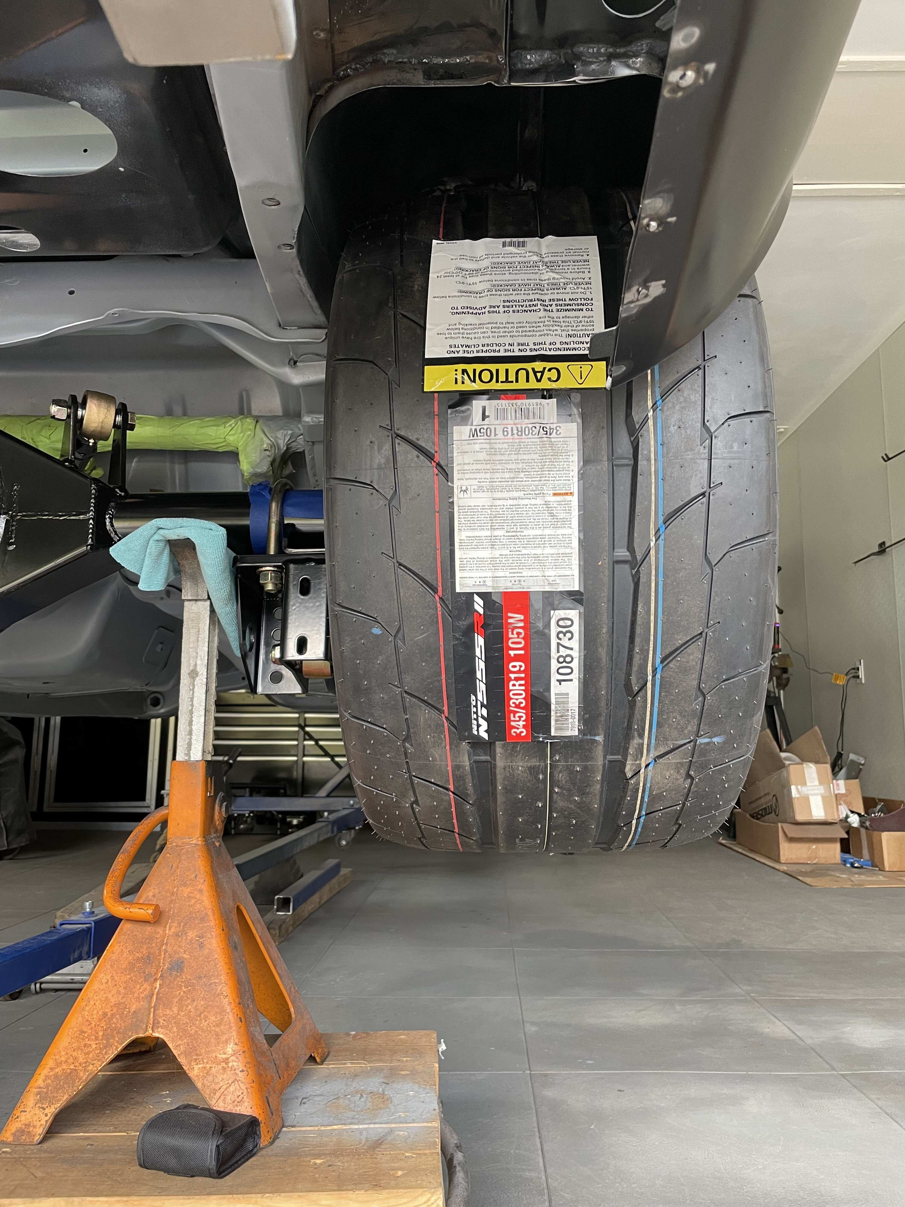

That is the exact tire I'm looking to run. Thanks for all of the pictures and help.

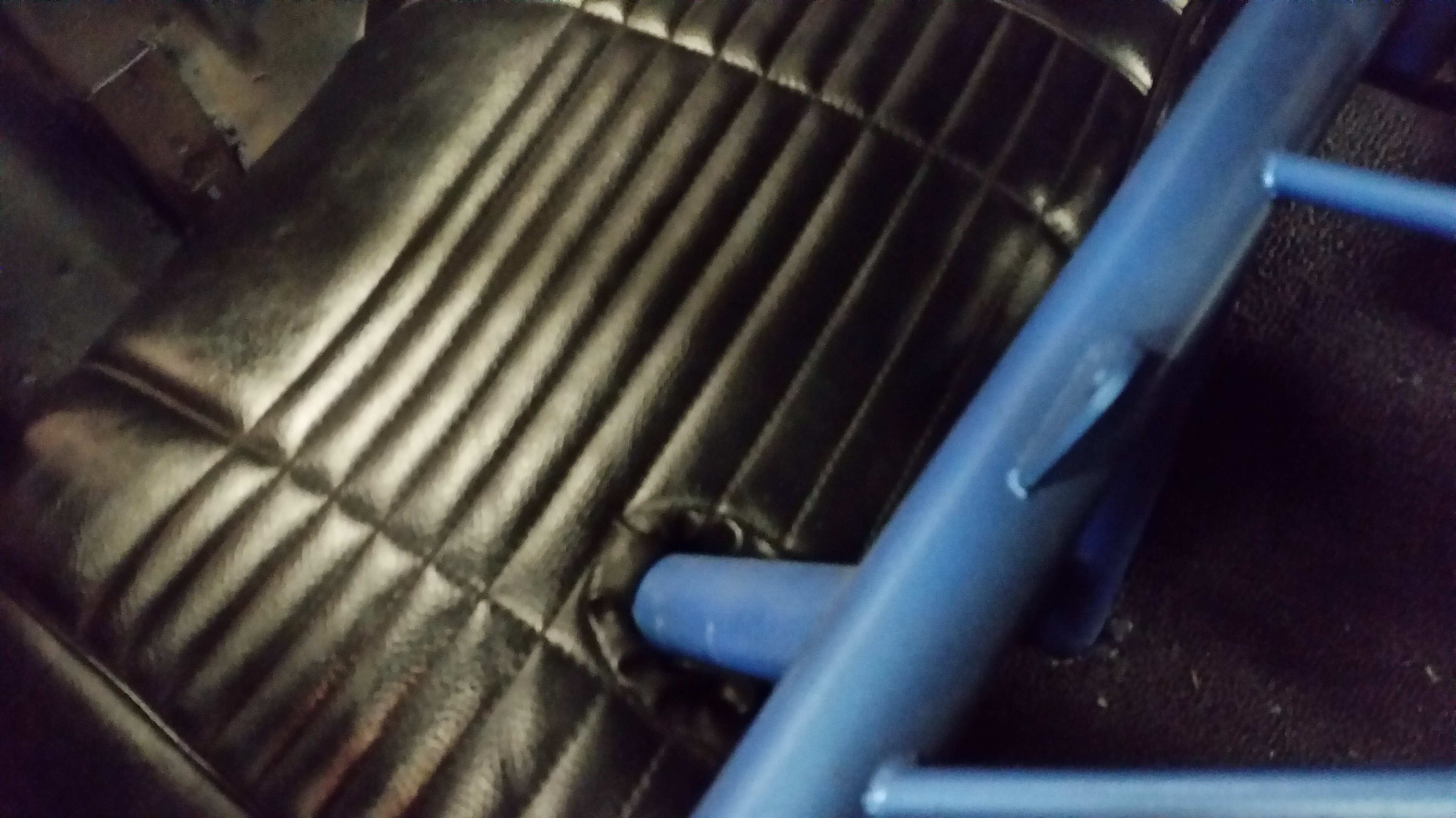

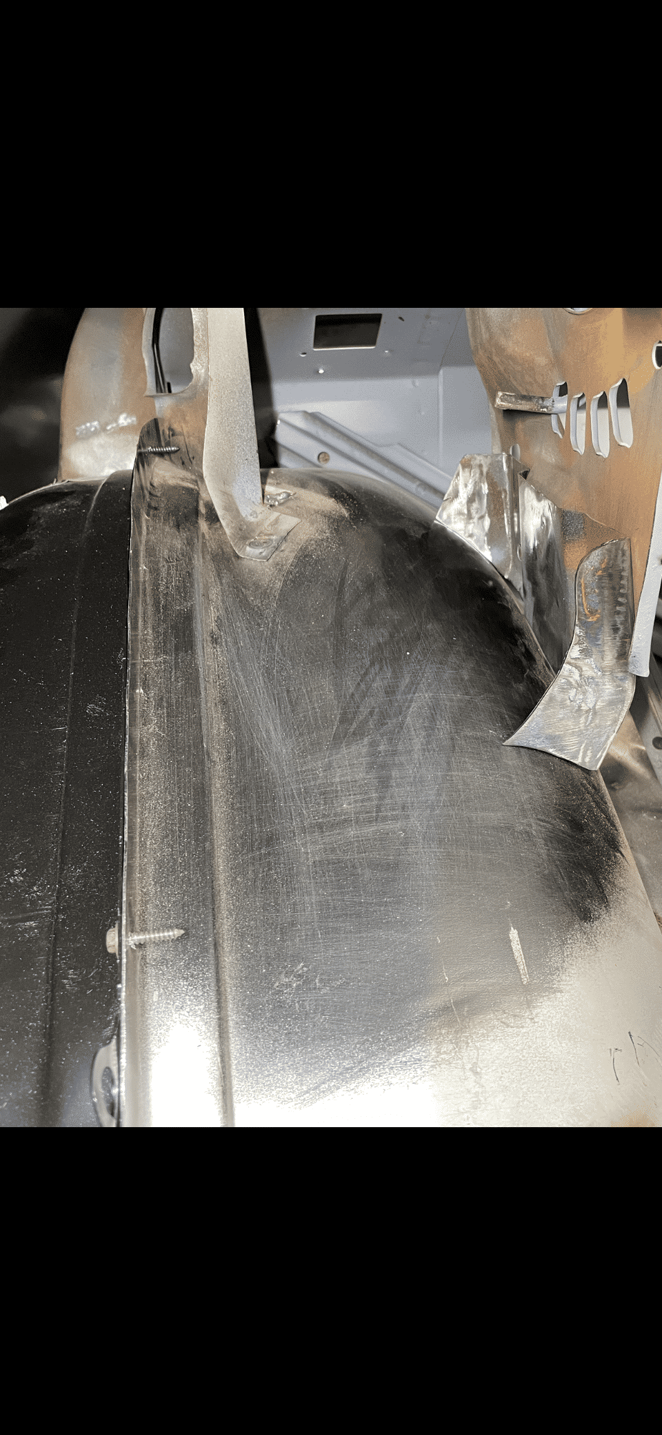

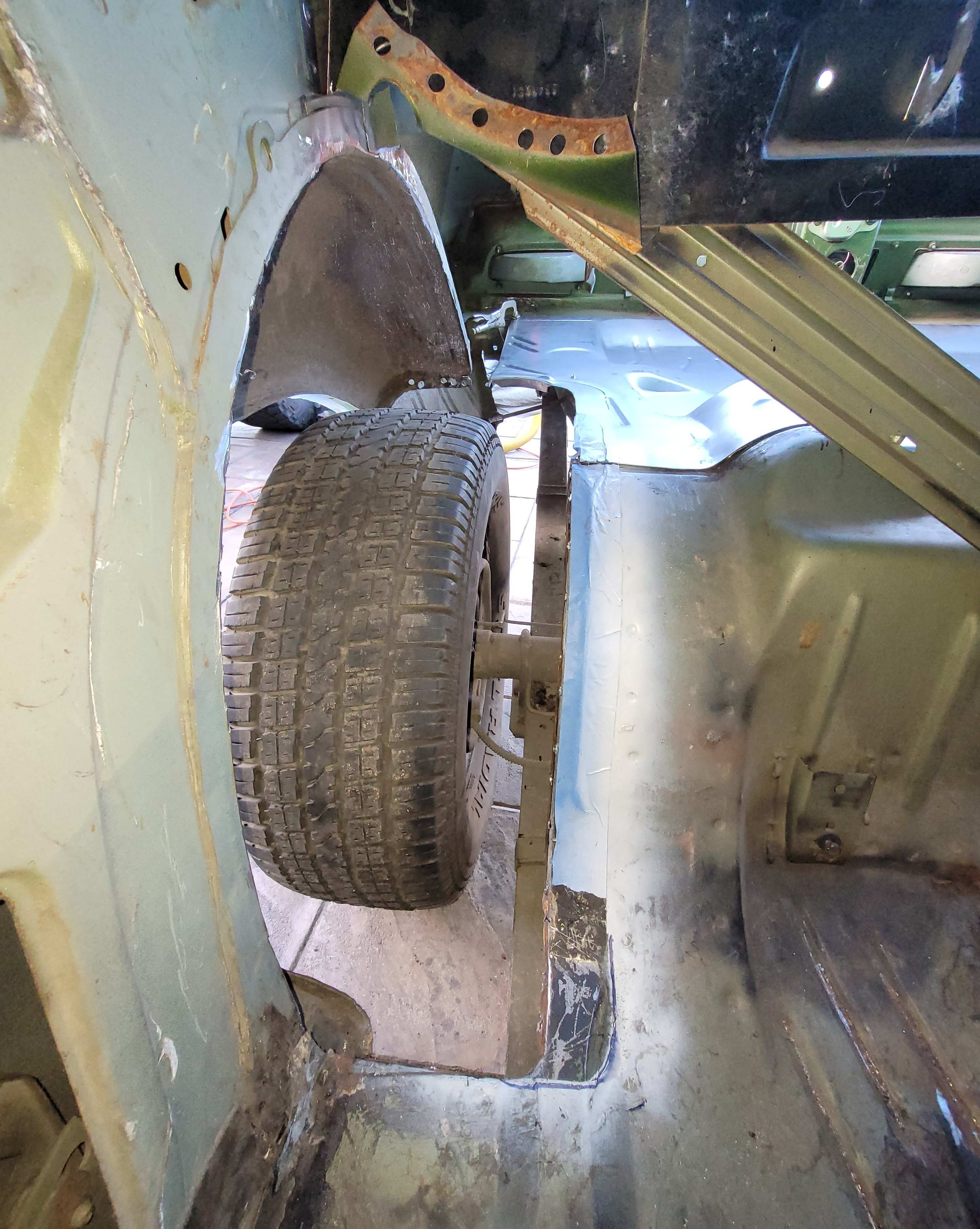

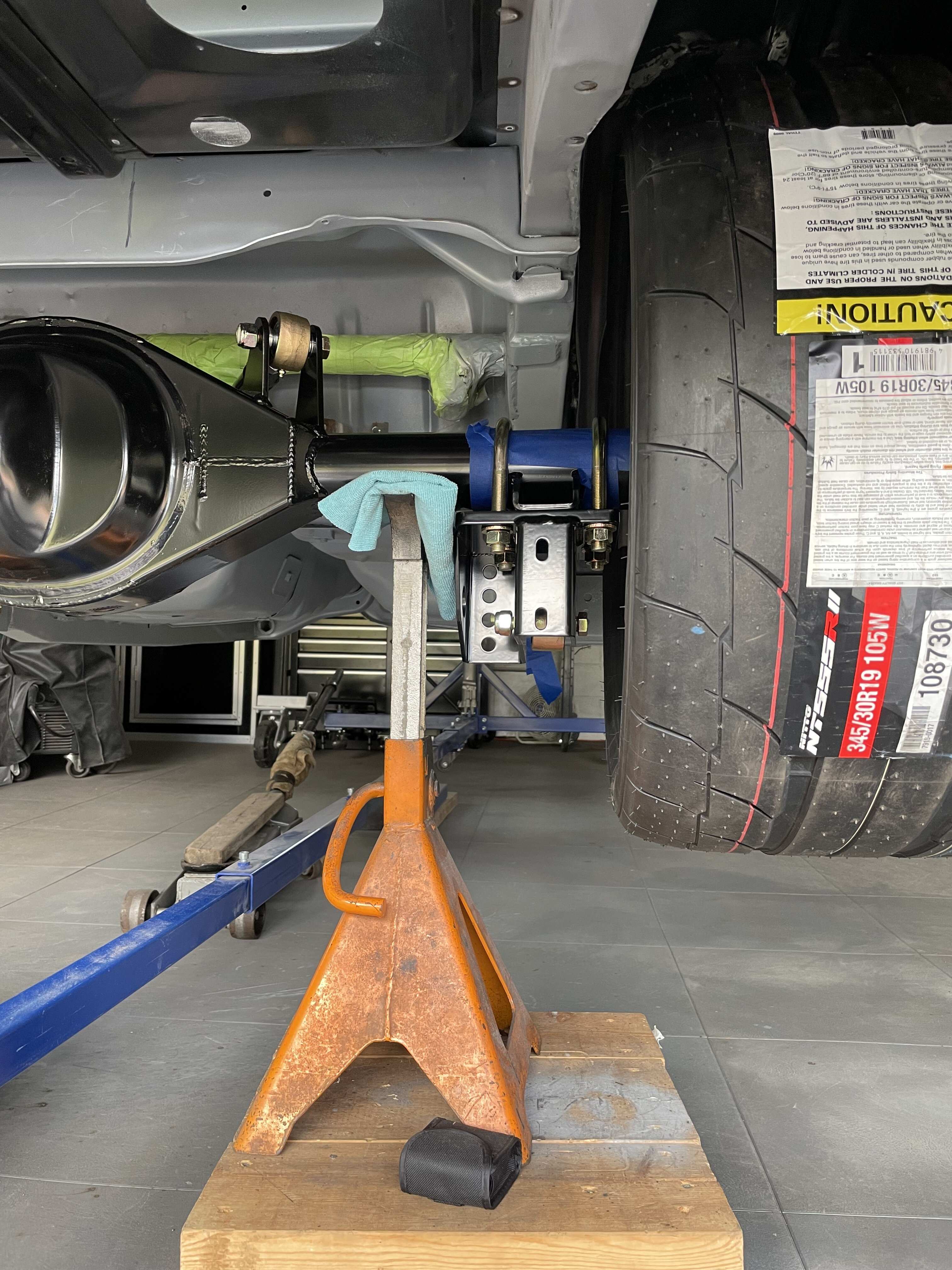

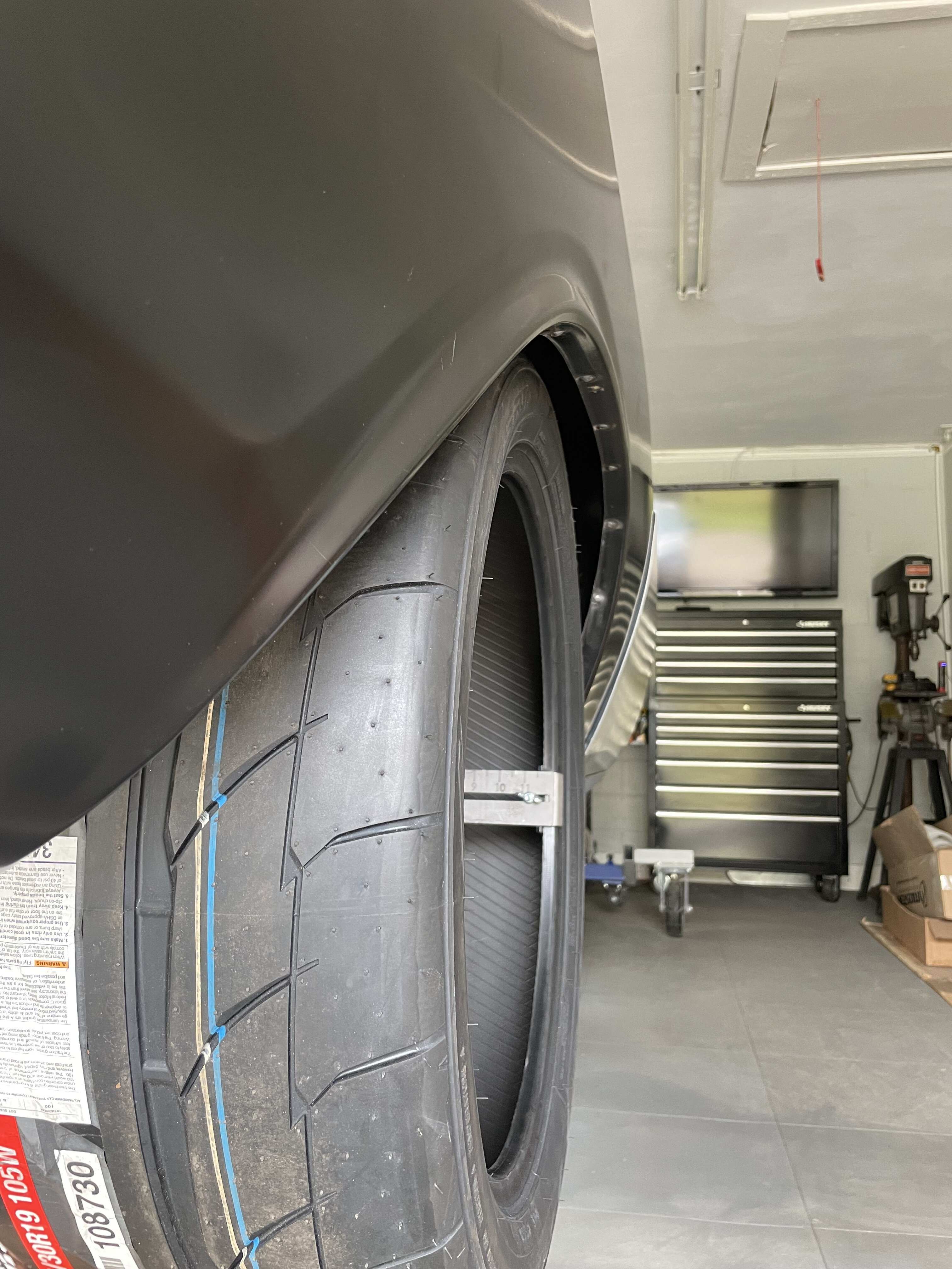

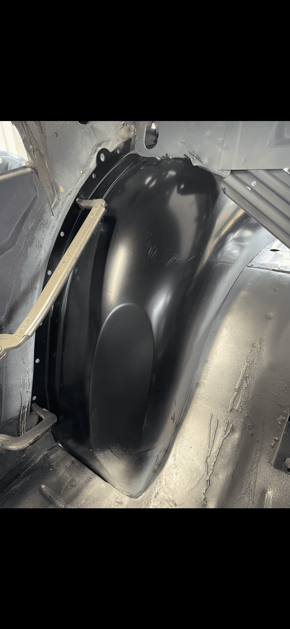

Yes, I narrowed my seat and re-wrapped the cover and notched my interior panels around the mini tubs. About the best pictures I have of rear.

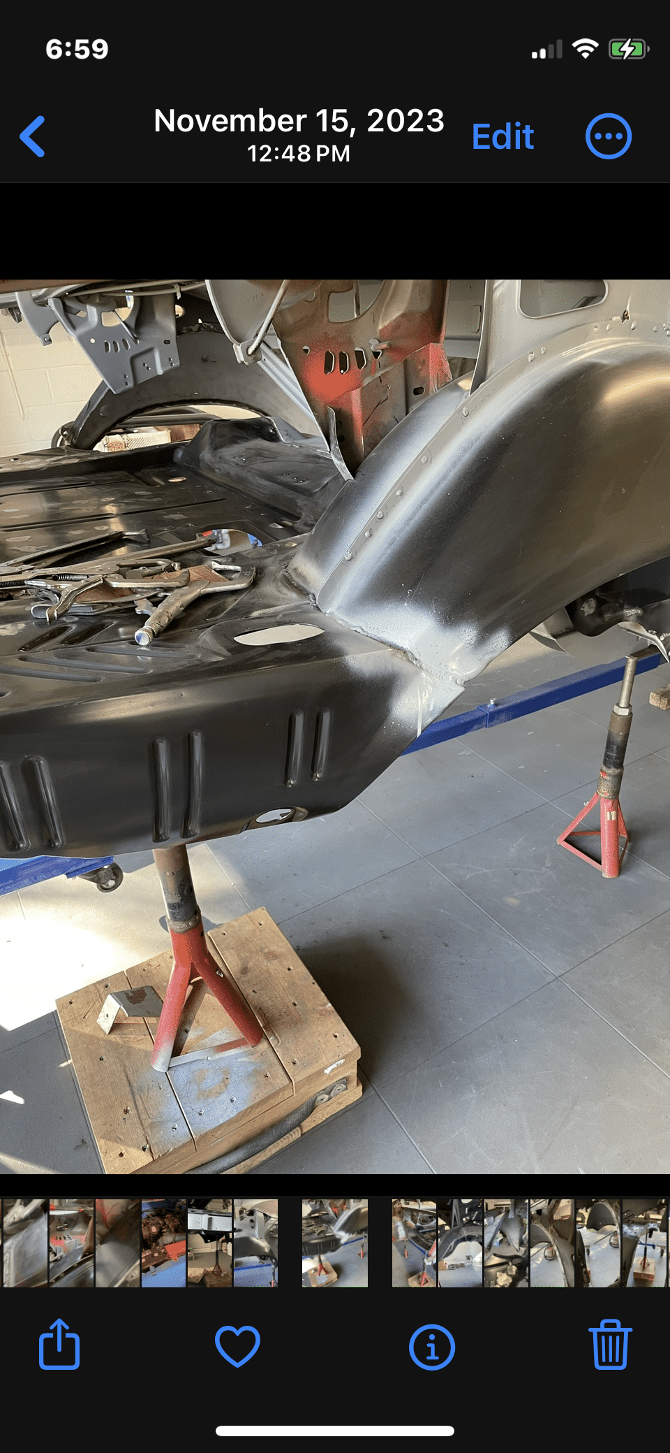

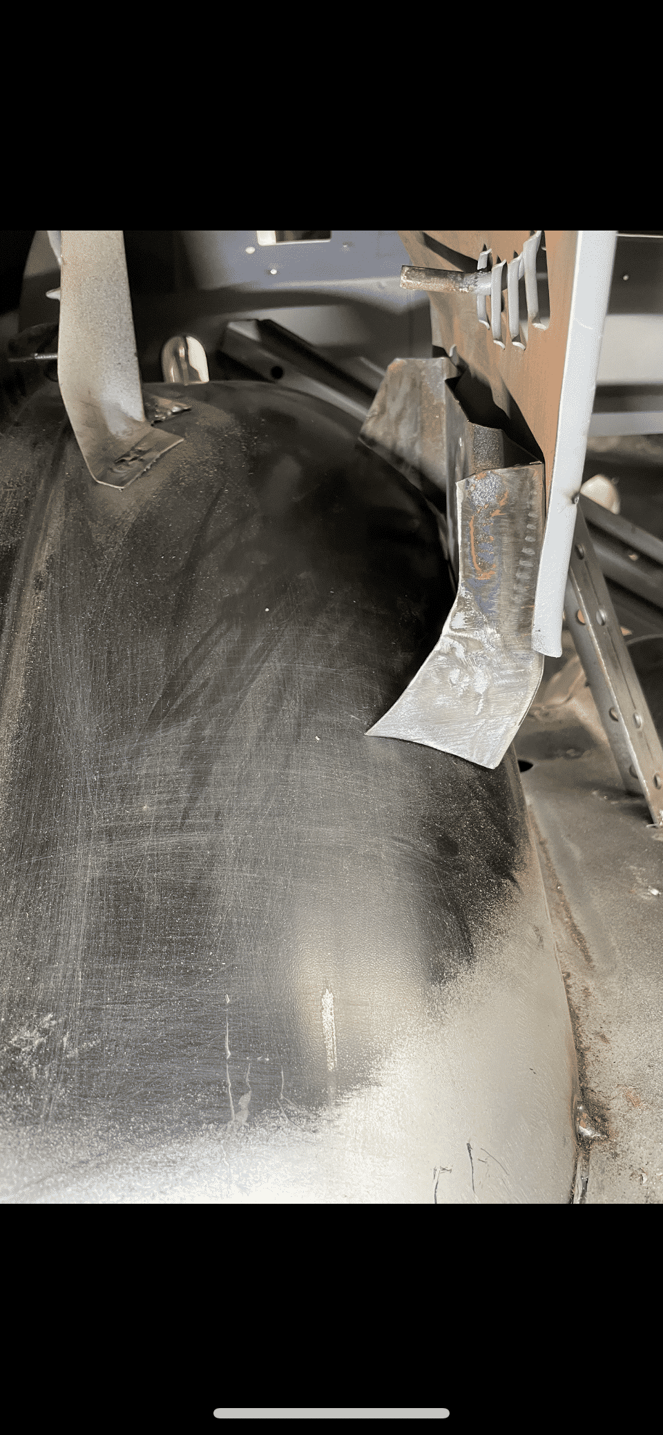

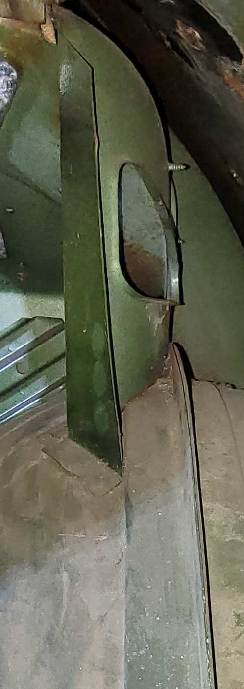

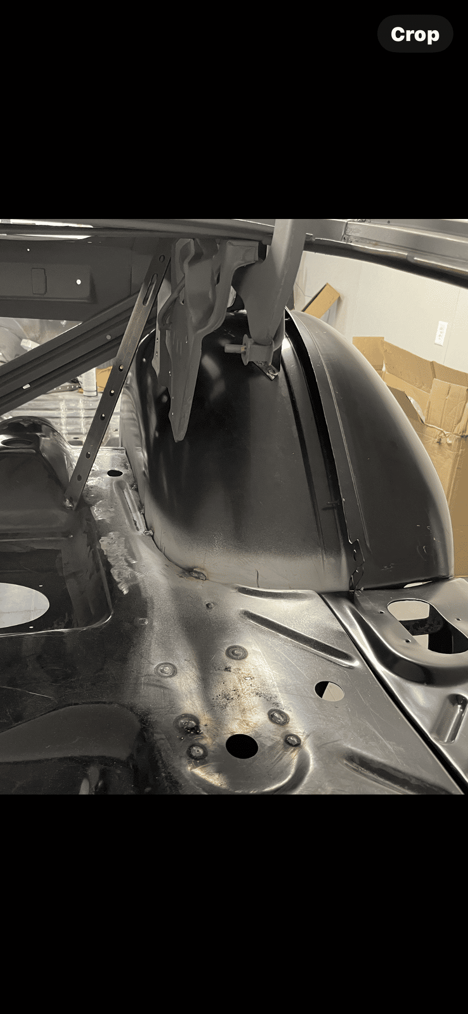

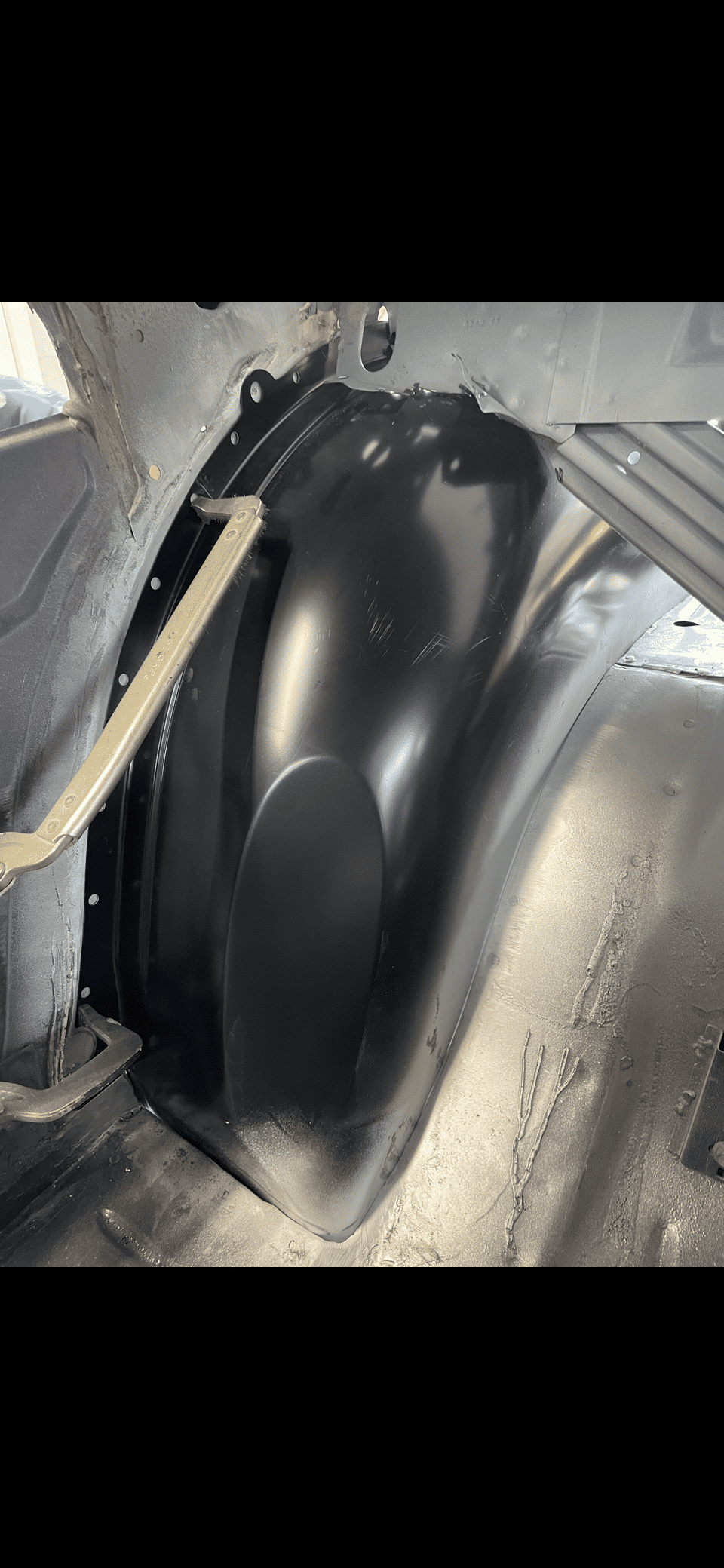

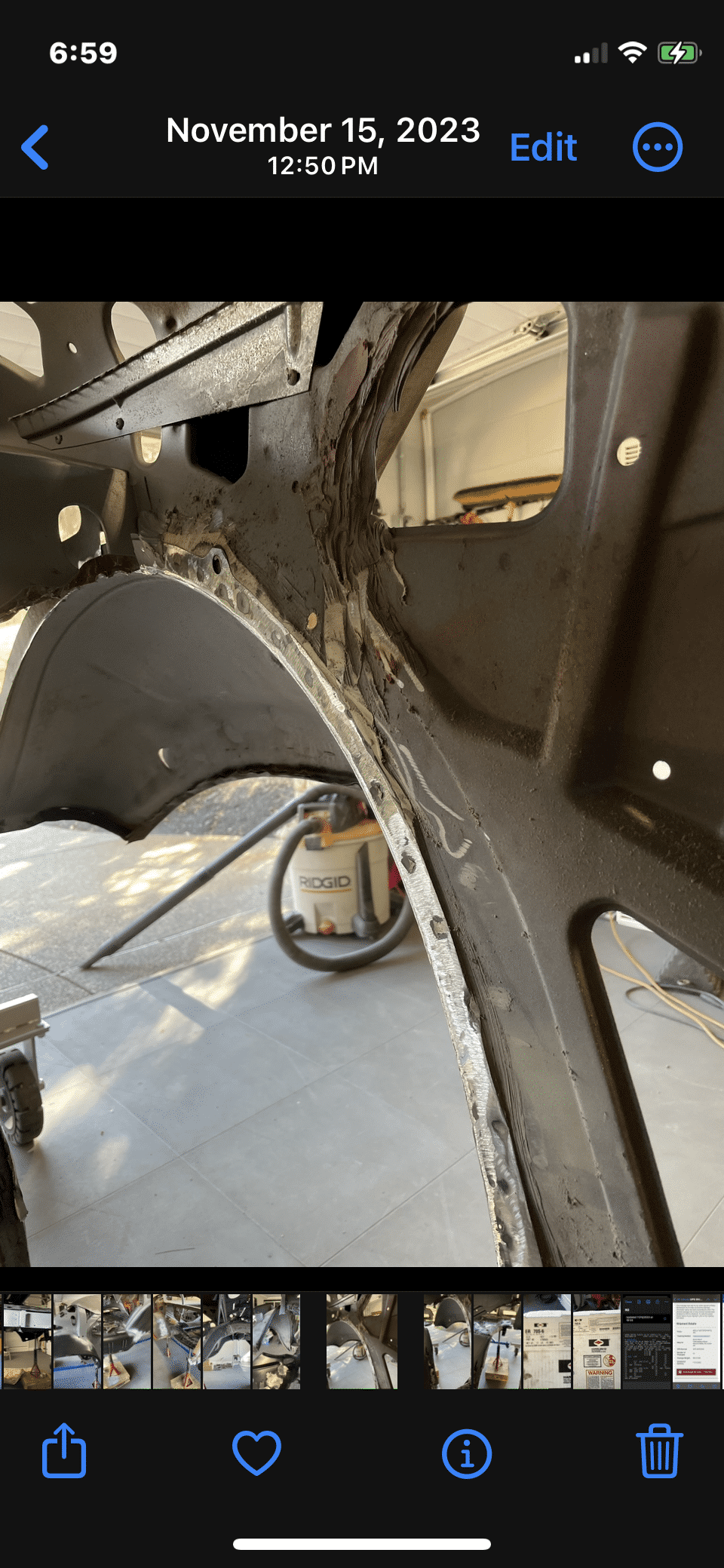

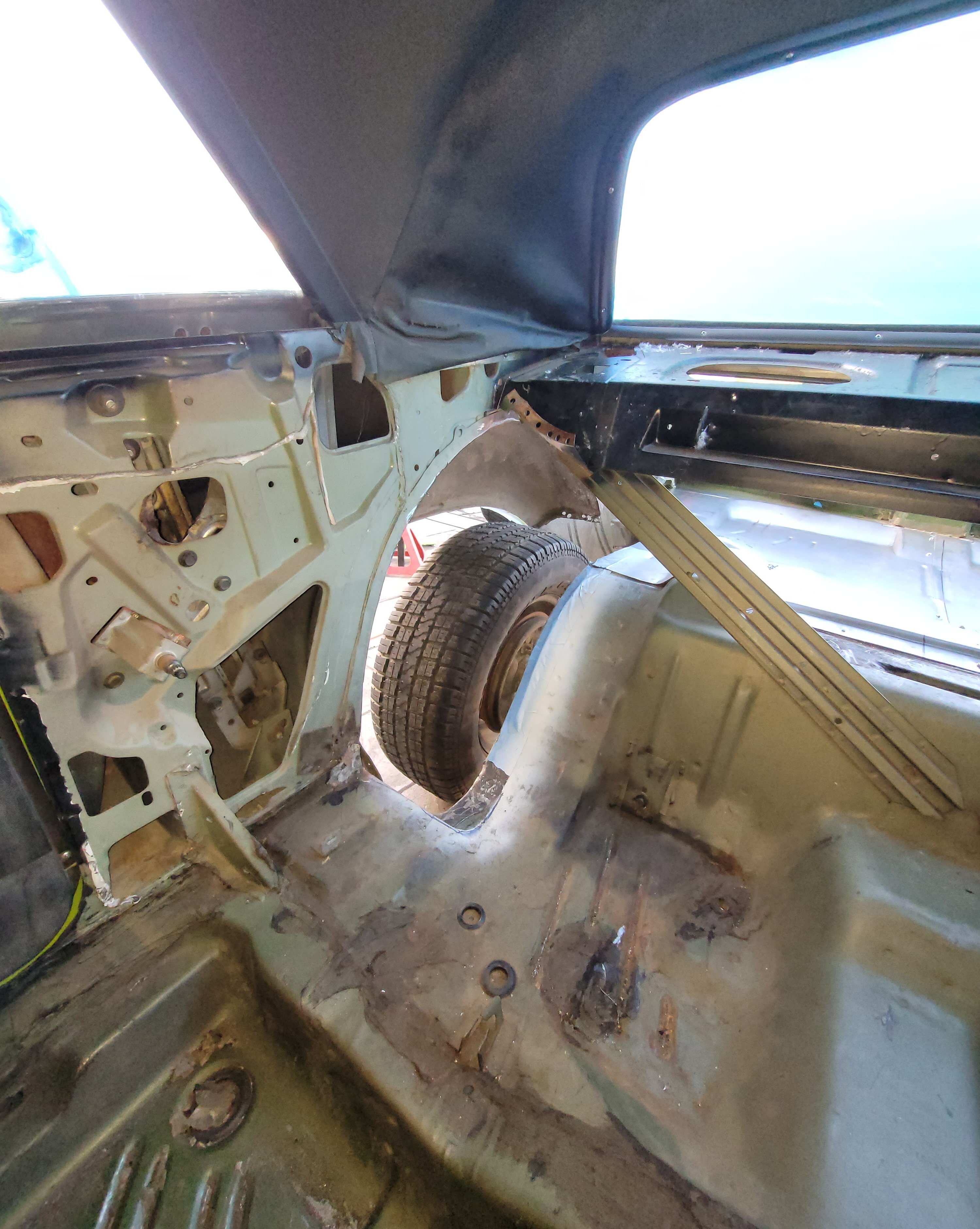

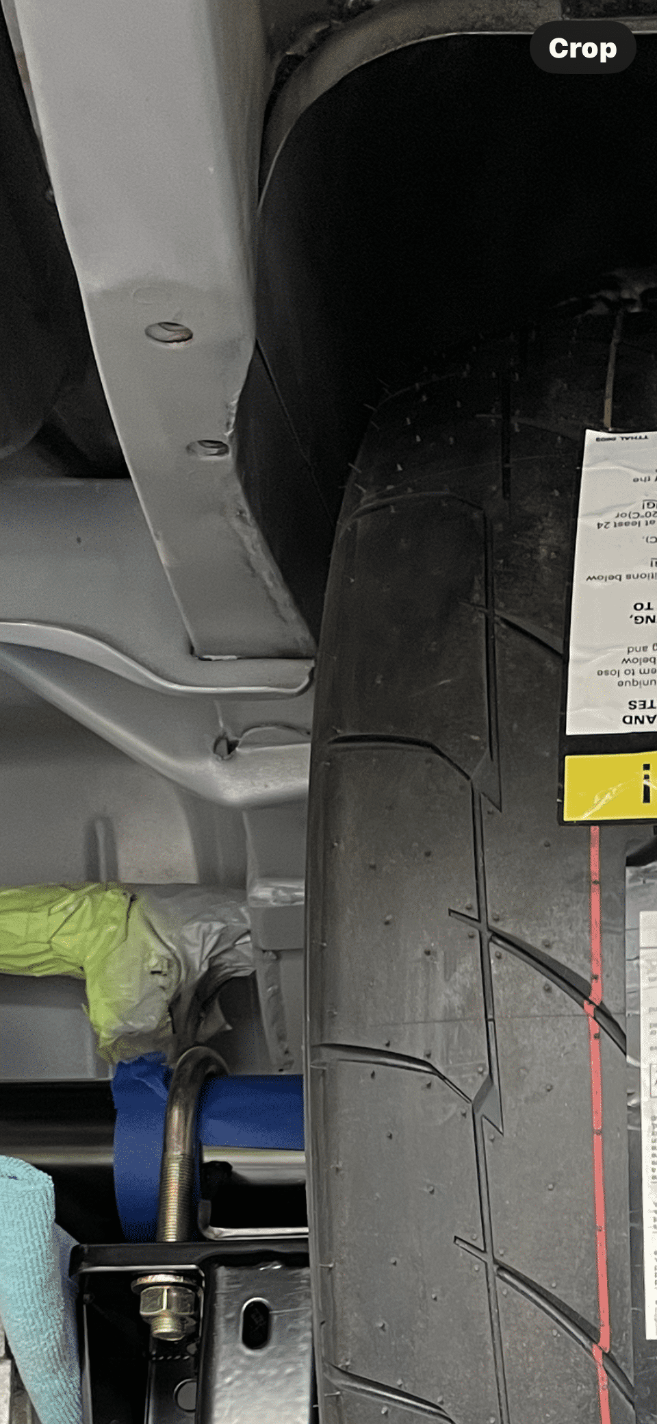

What do I do with this bracket? I need to cut it somehow when I cut the tub in half. Do I just cut it in half and weld it back on once I move the tub over.
Would you cut the tub down the middle of the flanges or just to the side? I imagine it would be hard to cut through all of the spot welds?
6PKRTSE
Feb 3, 2010
957
546
I moved mine inboard with the inner tubs. Yes, it's a pain to get out.
Pistolgrip496
Jul 30, 2018
36
13
Leave it where it is just drill out the spot welds the new inner wheel well will fit to that bracket perfectly
Pistolgrip496
Jul 30, 2018
36
13
I had to replace the trunk floor inner and outer wheel wells and both quarter panels.
After replacing the floor I cut out the inner wheel well at the factory seem with a cut off wheel
Then I cleaned up my cut leaving the inner wheel wells for a reference point to install the new wider outer wheel wells from AMD after installing the inner I went back cut out the outer wheel wells that way I never lost my alignment point and the Quarter panel fit right up

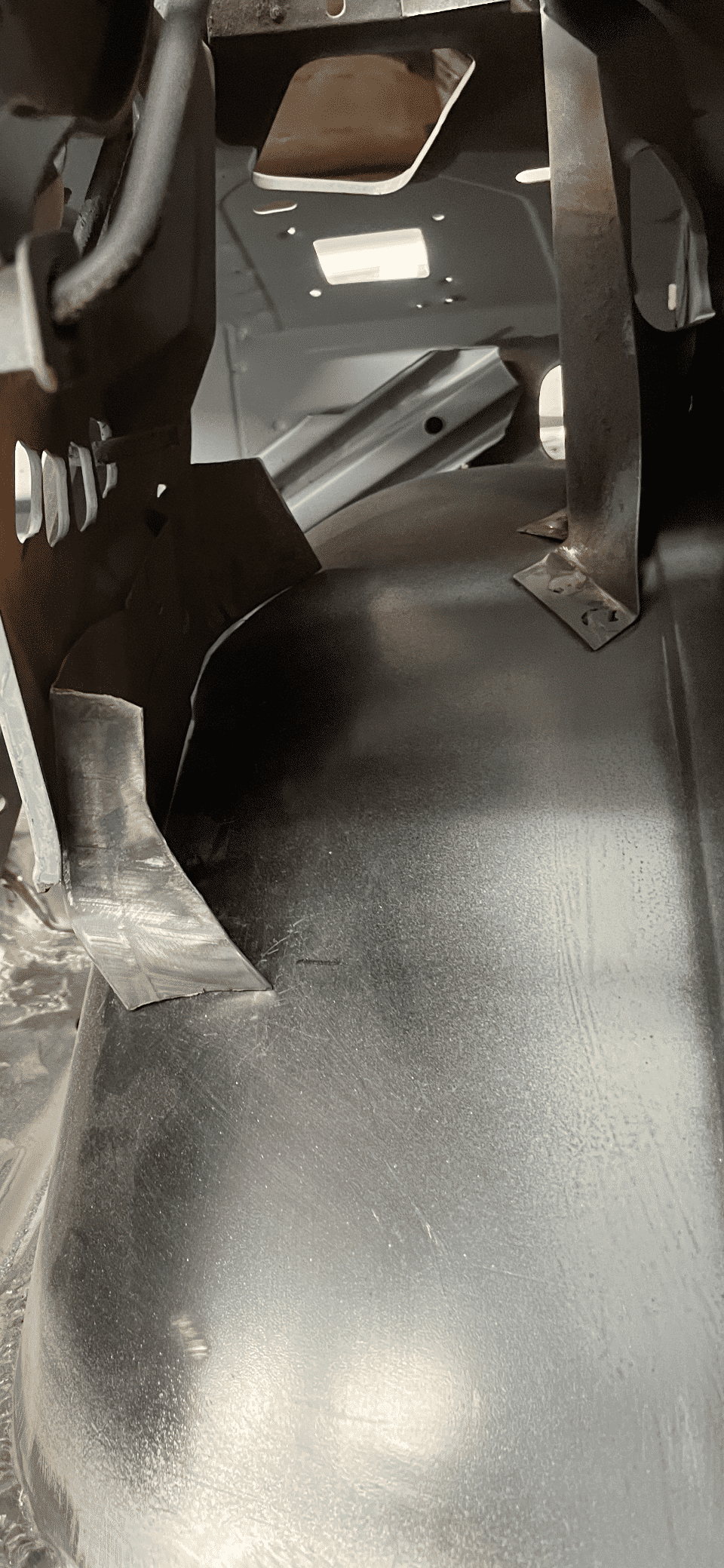

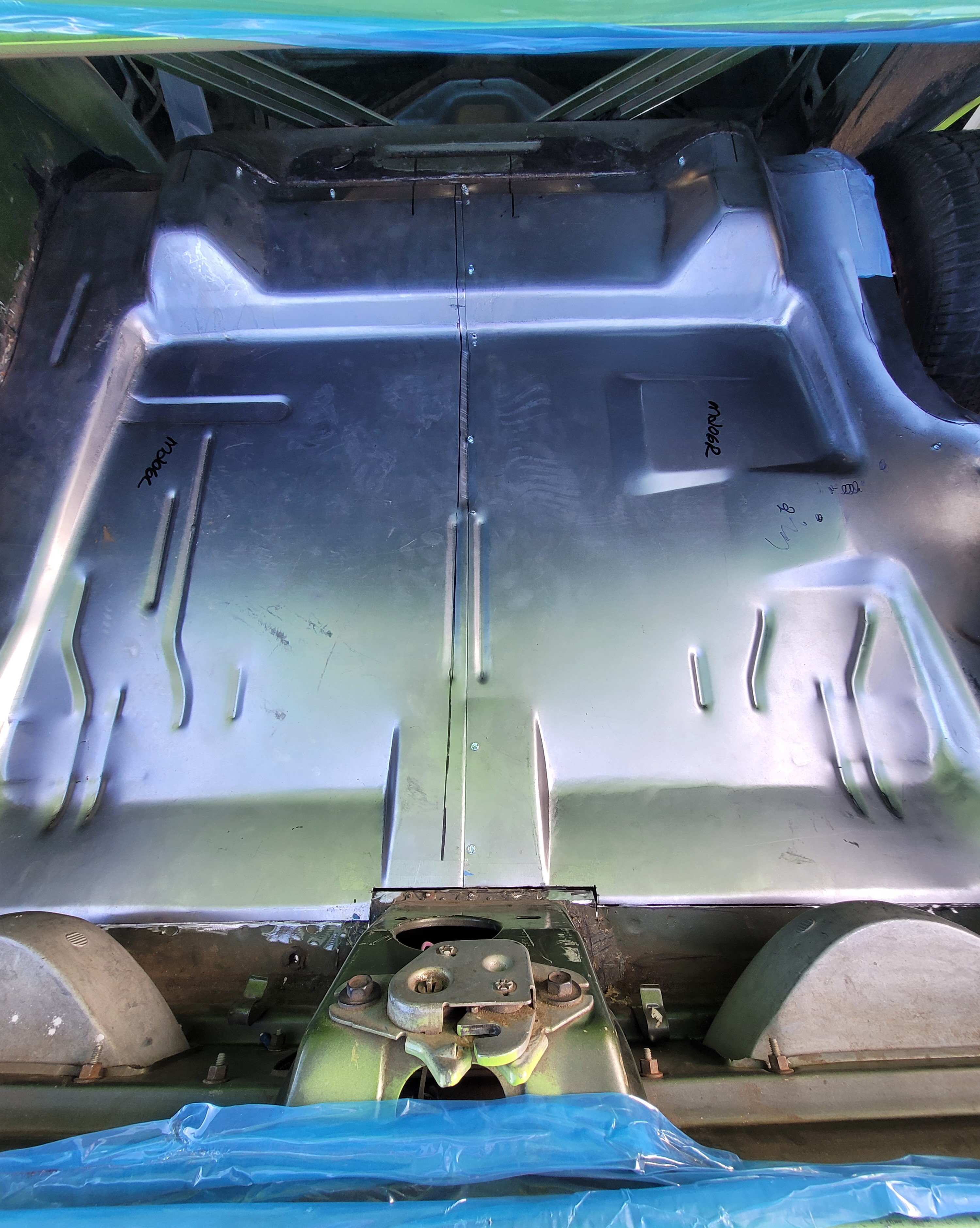

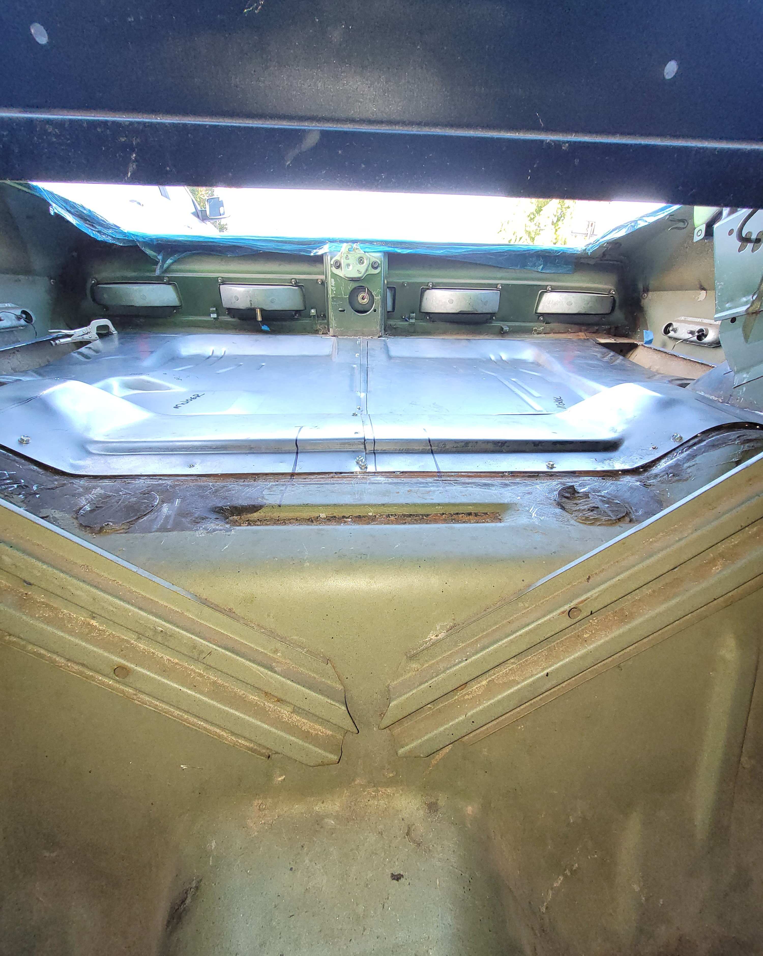

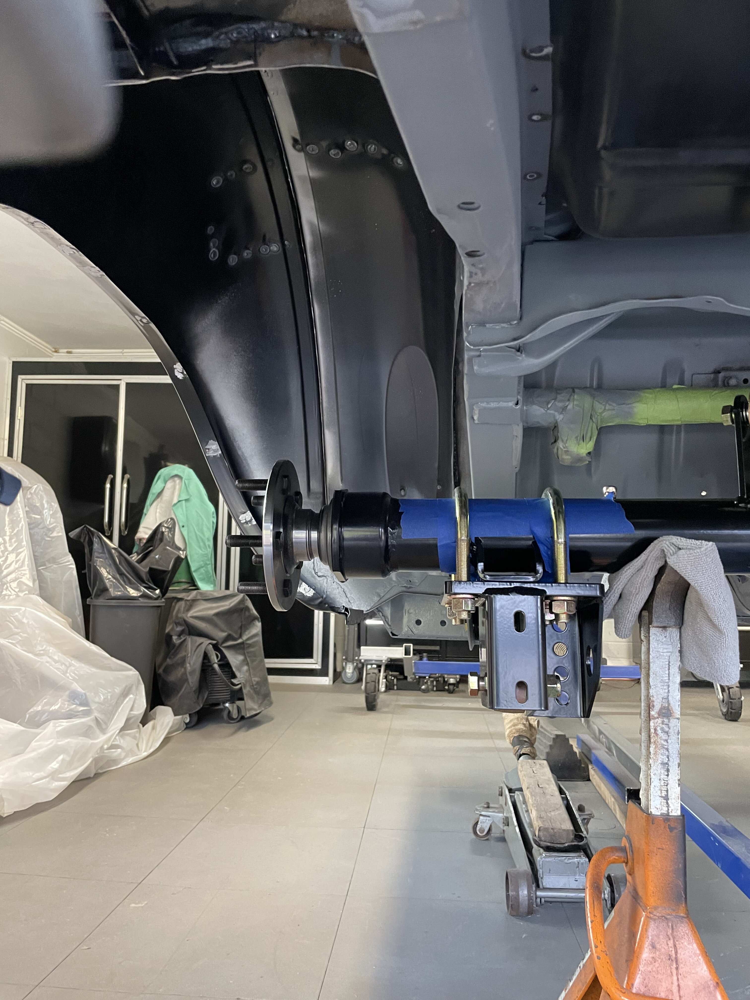

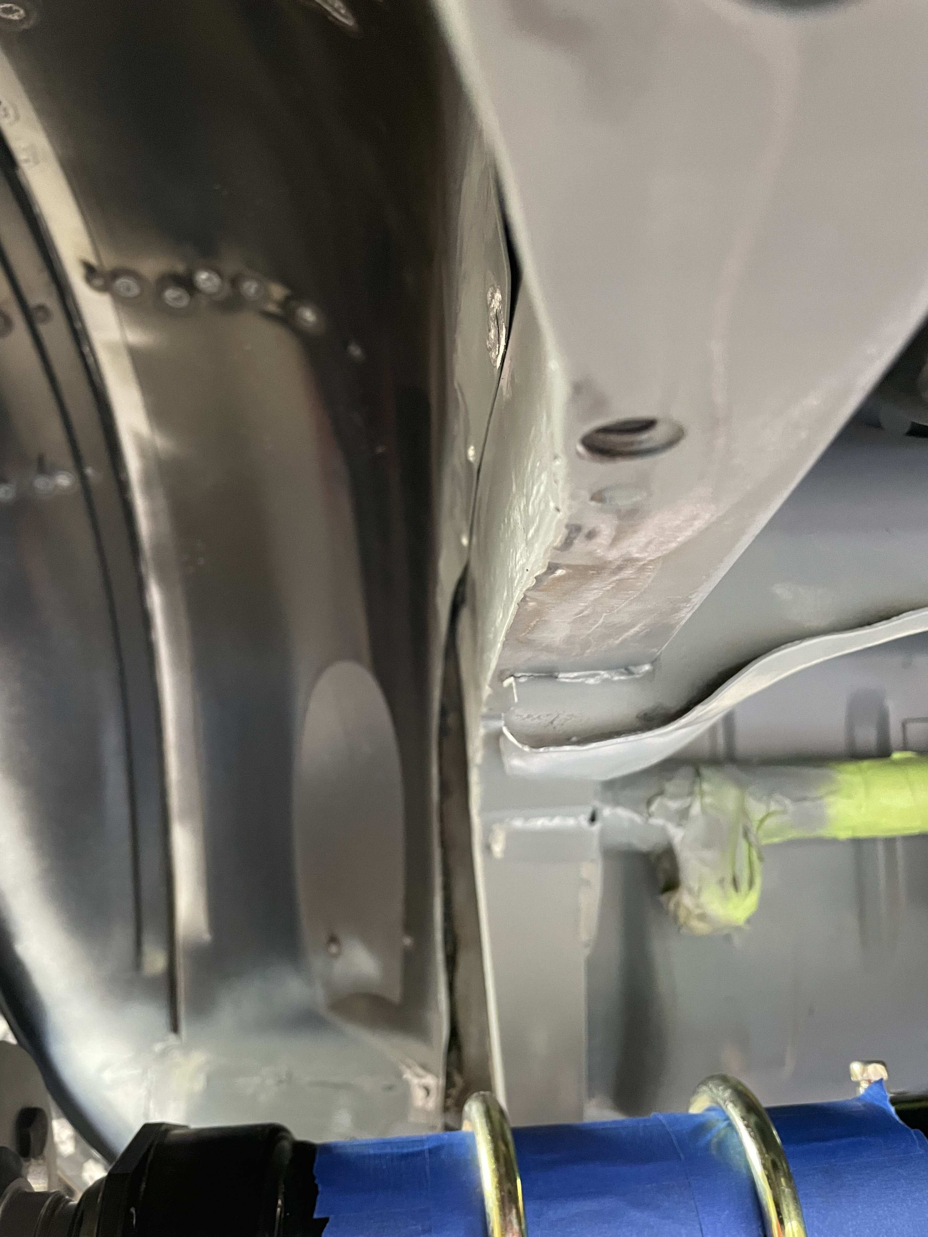

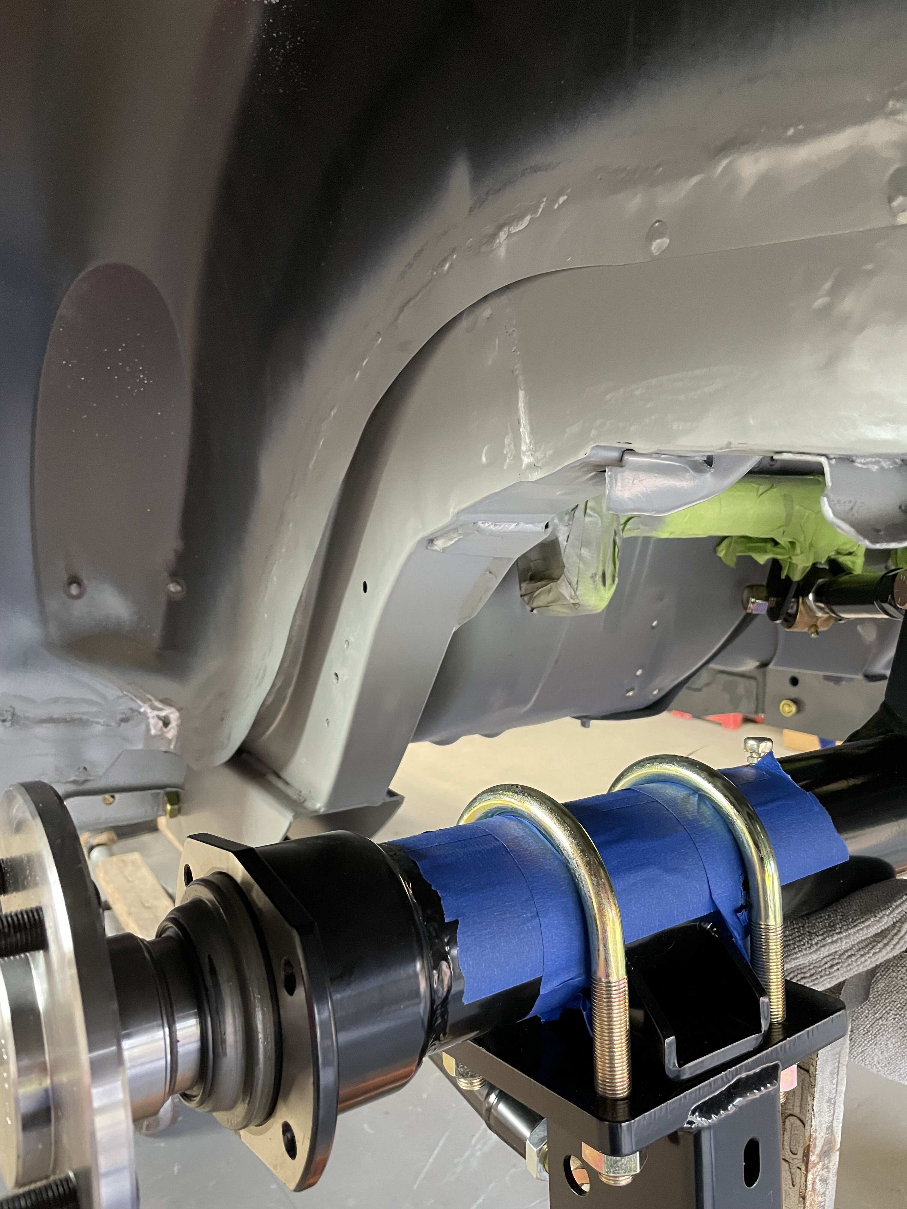

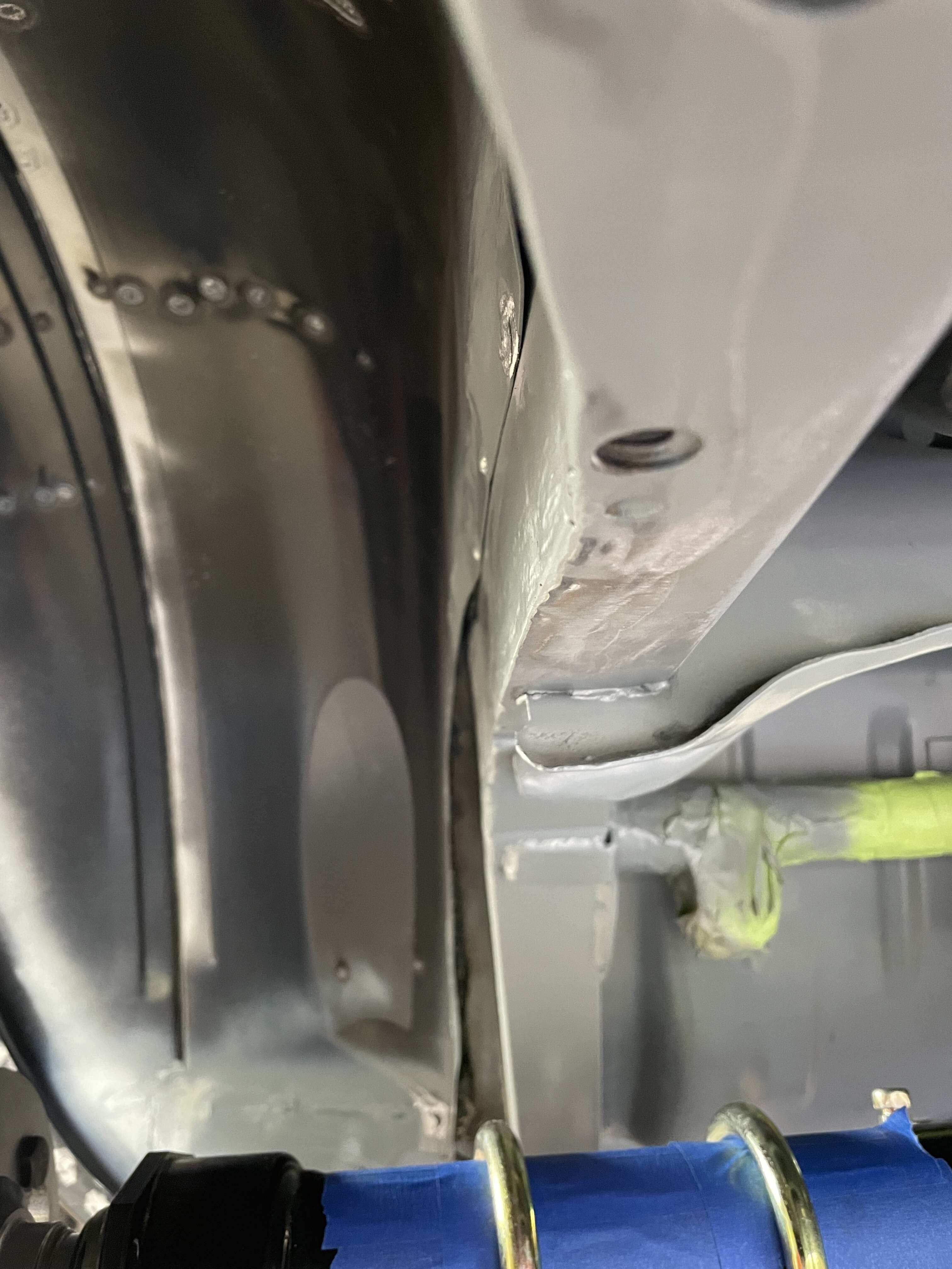

Ok, I was able to get the the pans in and fit up nicely. Next question is metal prep. I was thinking about preping the metal then using spraymax 2k epoxy. I'll probably use some type of undercoating to finish it off. Can I spray the undercoating on top of the 2k epoxy?
I also got the passenger side inner wheel tub cut out. Next I will cut the floor and install the US cartool frame notch.
Pistolgrip496
Jul 30, 2018
36
13
Your doing a very nice job
Yes you can go over the epoxy primer with undercoat

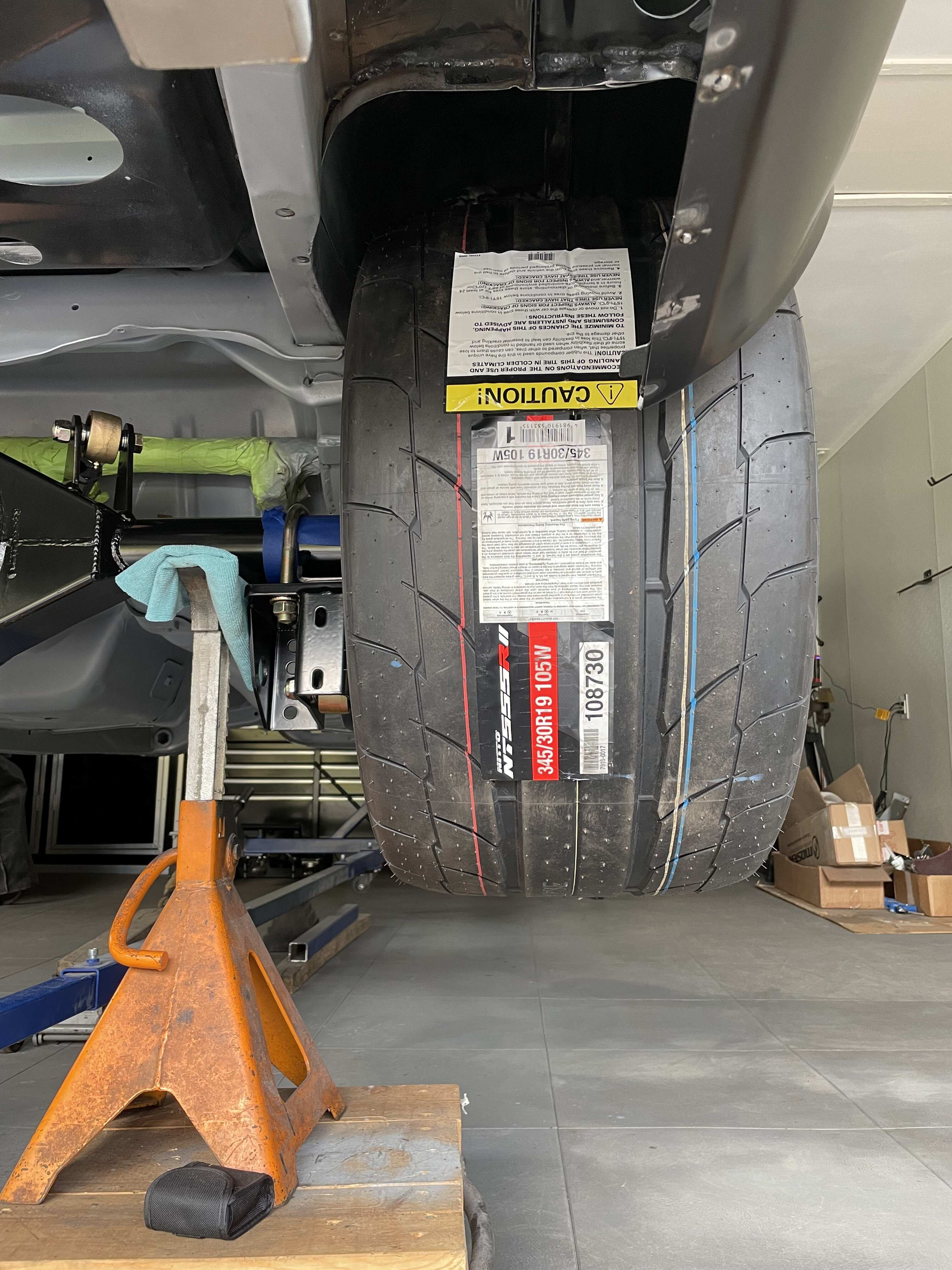

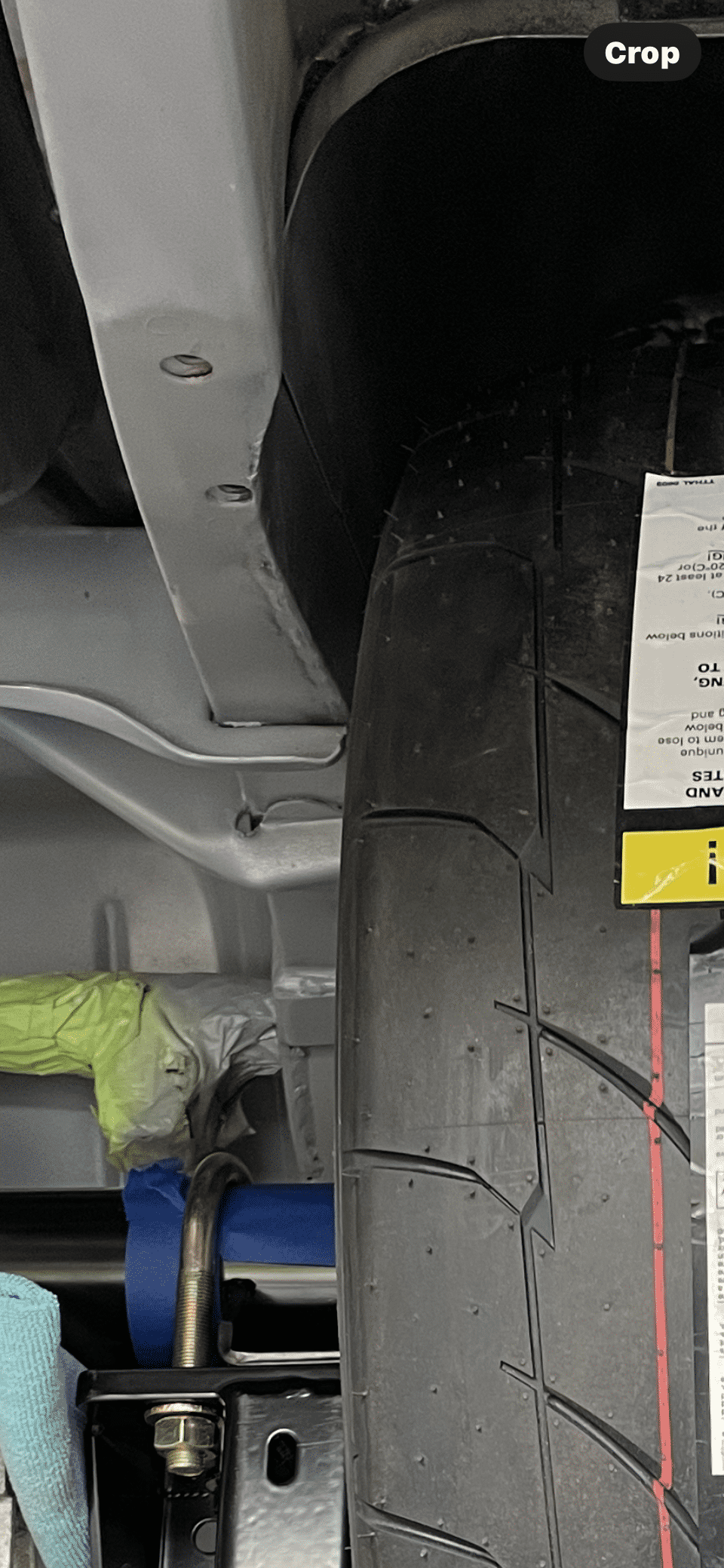

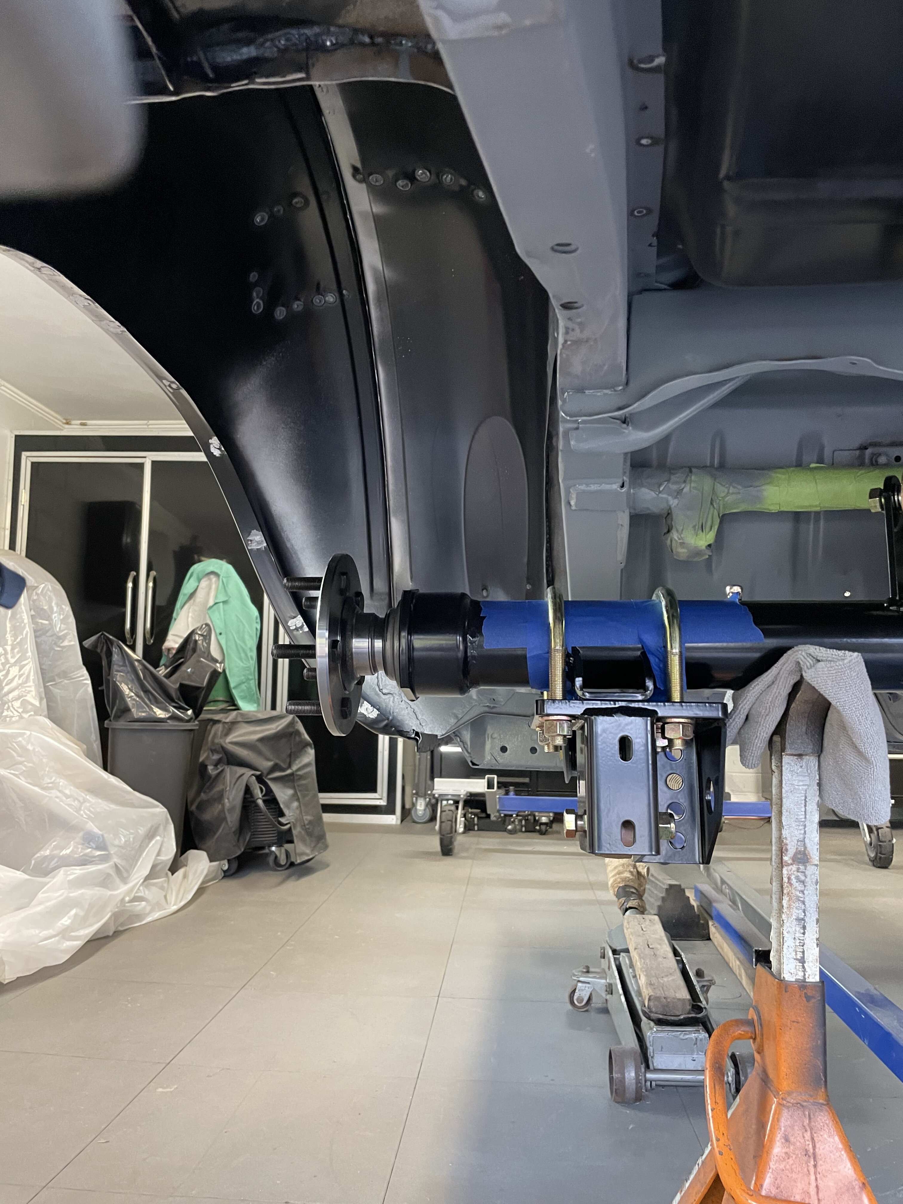

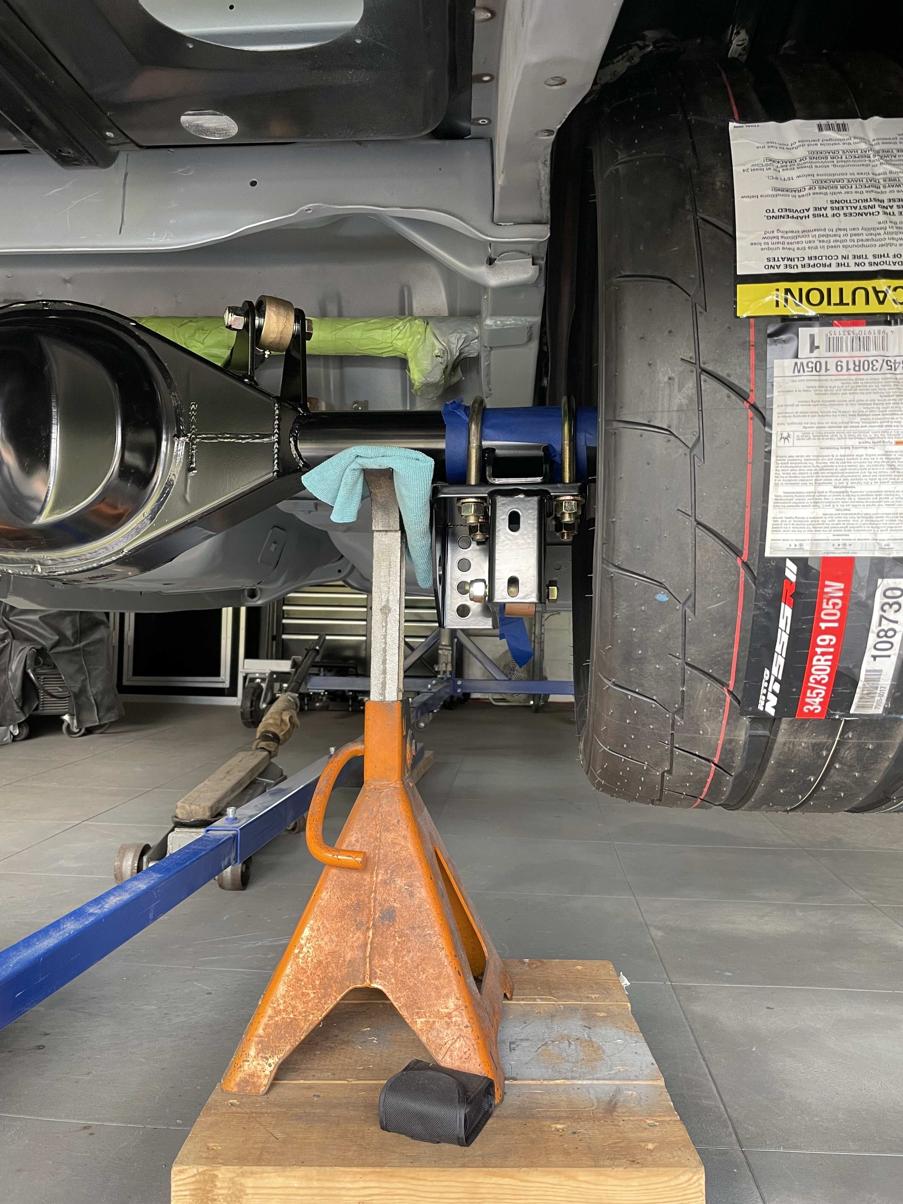

Looks familiar I just figured out my back spacing on the rear wheels I’m going to order the rims this week. 3-4 month wait.
Did you go with the 4 inch narrowed housing or stock width?

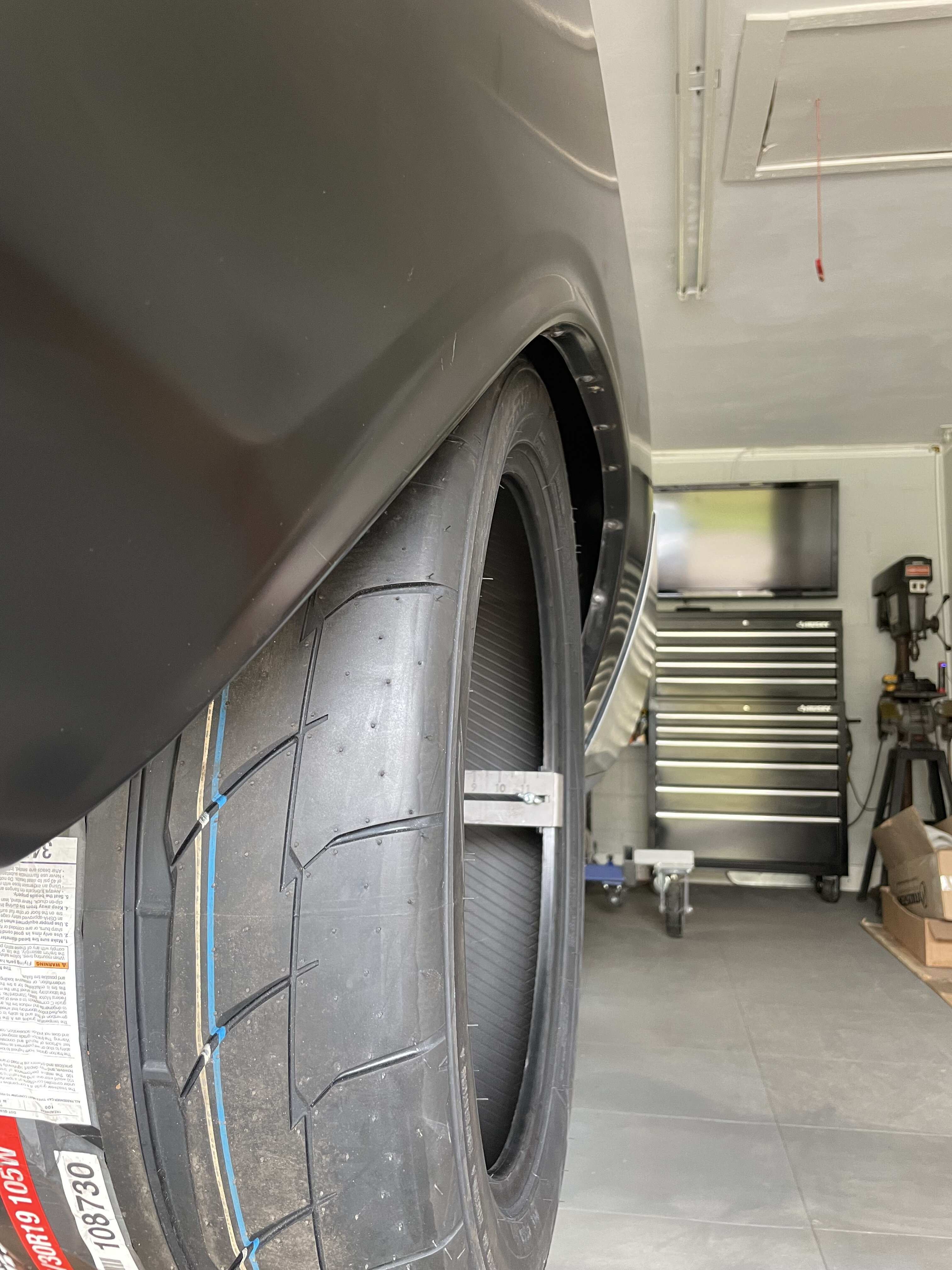

2 inches per side 4 total.
That’s what Bill recommended
I’m using a 19X12 wheel with a 6” backspacing with a 345/35 tire.
