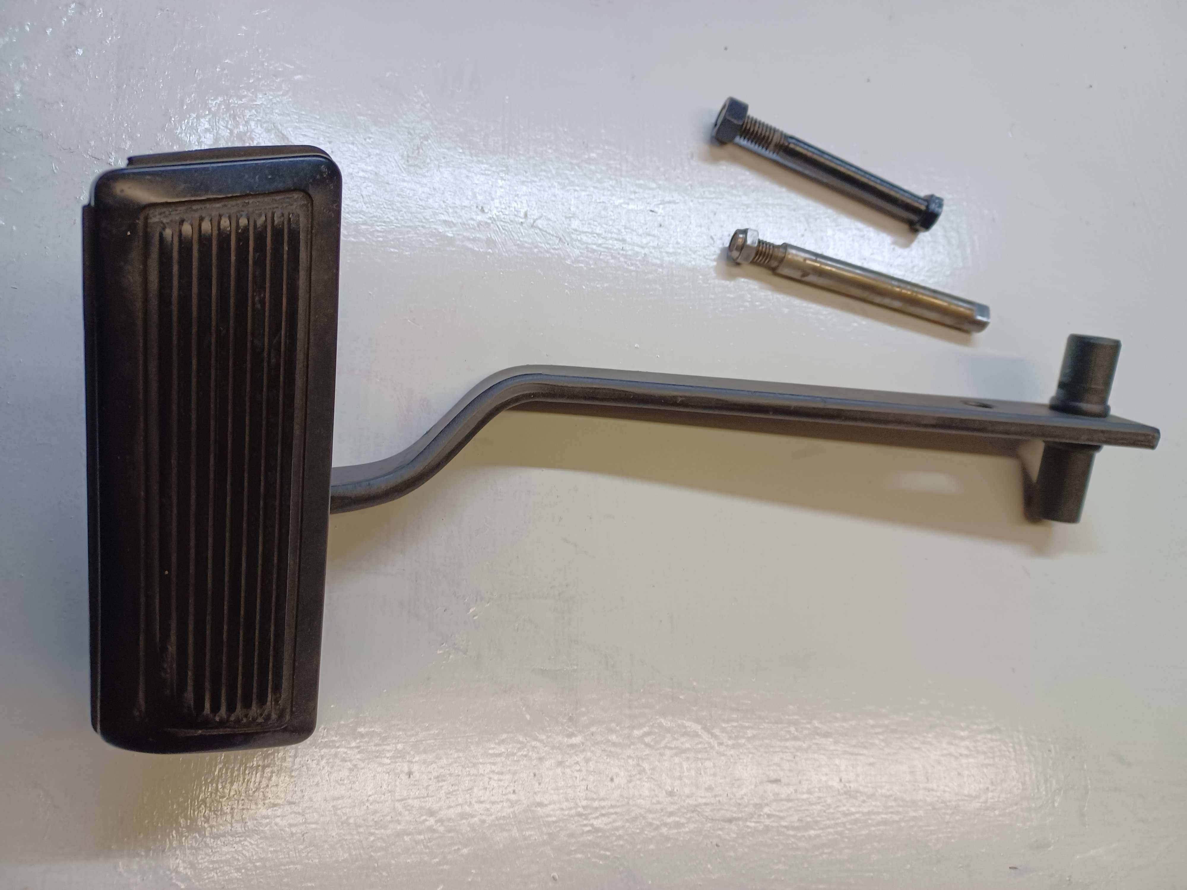

Here are some pictures of brake pedals I have. See the differences.

Thanks to brotow for getting a pair of pedals out and posting.
I was going to, but hadn't come across both styles to get pictures

Awesome! Thank you for that brotow and Mr Cuda... That was exactly what I needed to see. I appreciate the fact that you went to all the trouble to line up those pedal pics to answer the question here. 🤔👍🏻
