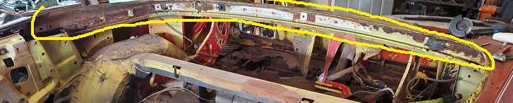

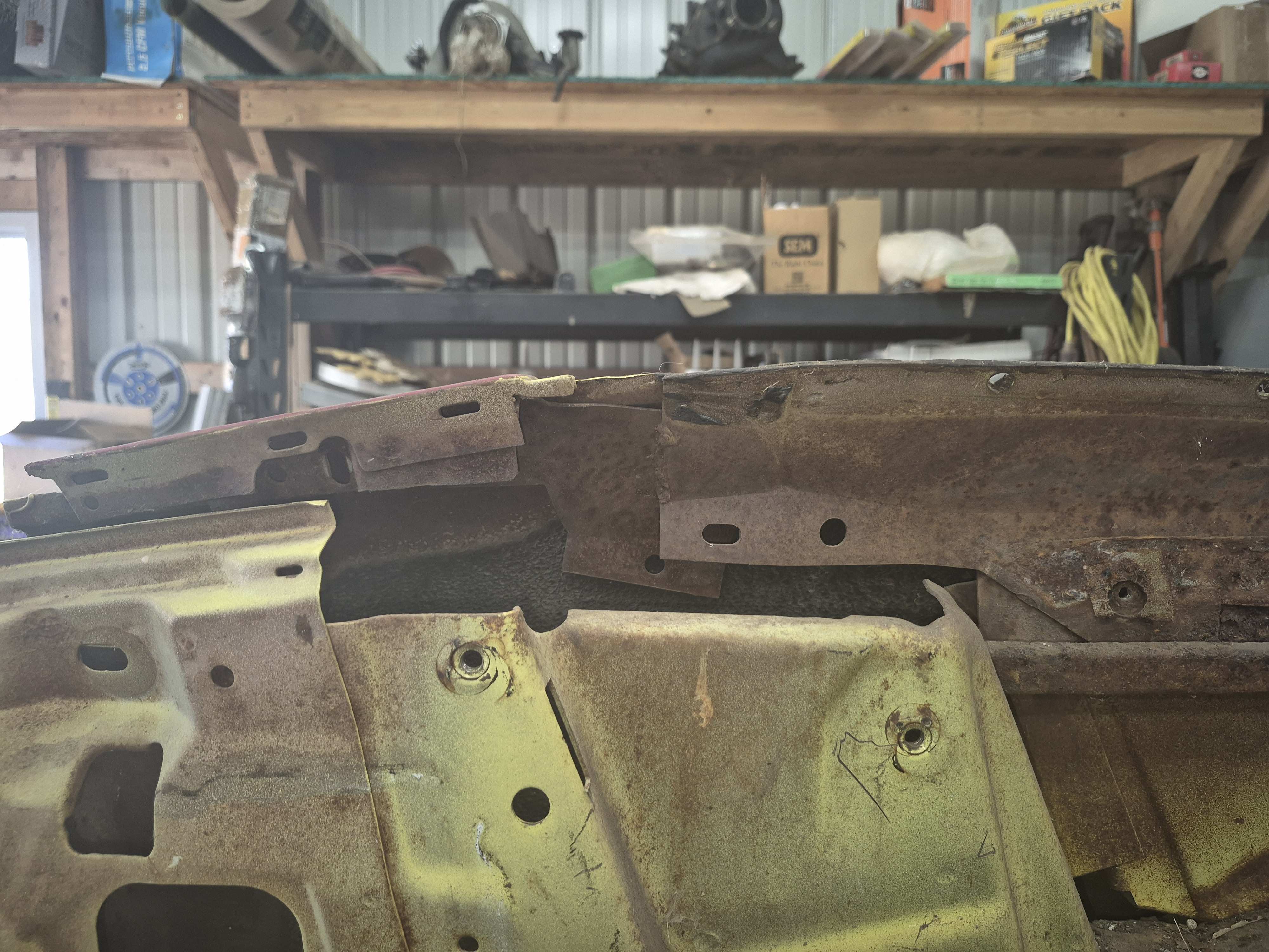

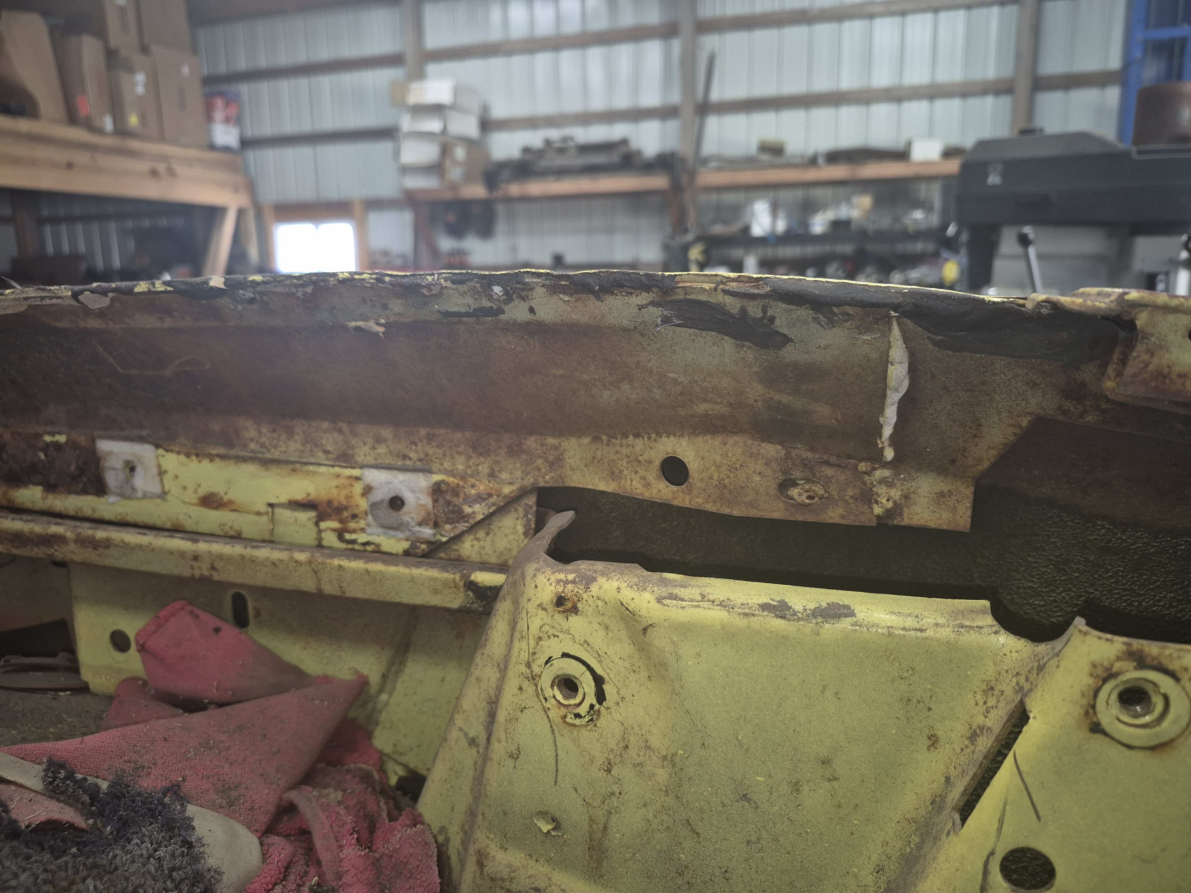

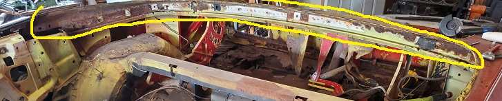

At some point I'm going to have to deal with rust in this area. I'm hoping I don't need to remove that but if that's what it takes, so be it.
If anyone has any advice I'd appreciate it.
Looks like most of it is in decent enough shape from the small picture and if it's hidden, I would just stabilize it and move on. If it is too thin or holey for comfort, I attack areas like that a little bit at a time. Try and cut out small areas at a time and fab the replacement to stitch weld back in if you can't source a full or partial replacement part. Again, if it is hidden under an interior panel get it close. The final shape isn't that important unless you are OCD or doing a high end concours rebuild. I understand wanting it to be all original but if it's a support panel or something hidden under headliner or trim, I move on to bigger fish.
Thanks, unfortunately it's a vert only part that makes up the rain well and mounting point for the convertible top base. Basically, it's where the tack strip goes. There is "gutter" attached as well. No concourse here, and it appears to be surface rust but I'm worried about what's on the other side. This car sat in a single car garage for over 30 years rotting away from ambient moisture so it's likely there is corrosion on the other side and/or between it and what it's connected to. I'll know more when I dig into it.

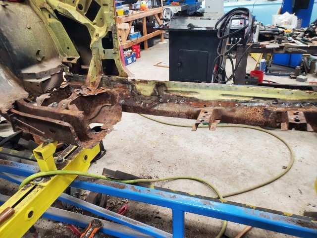

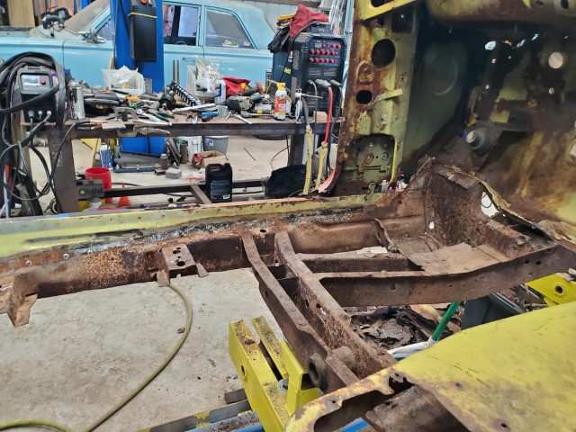

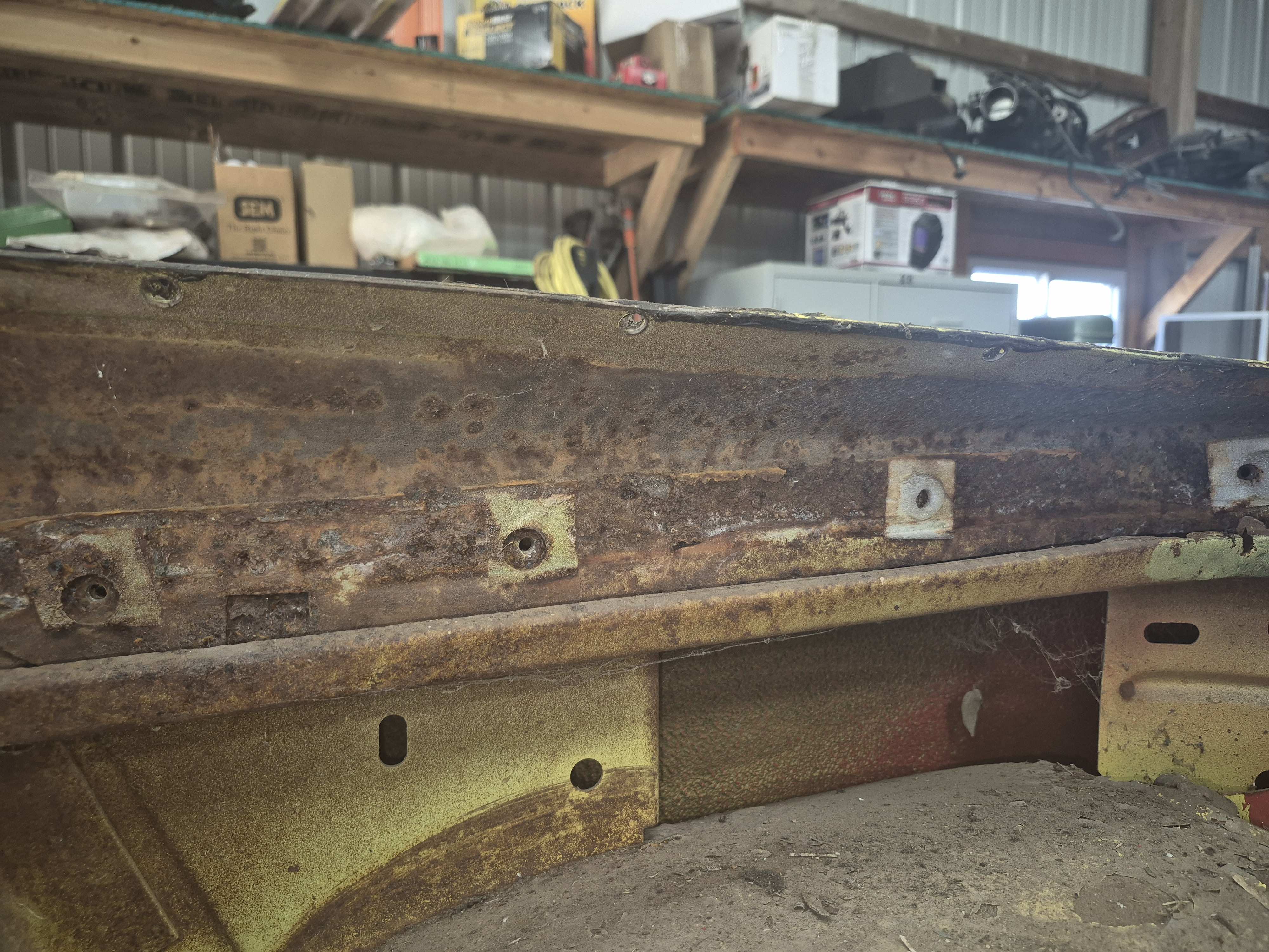

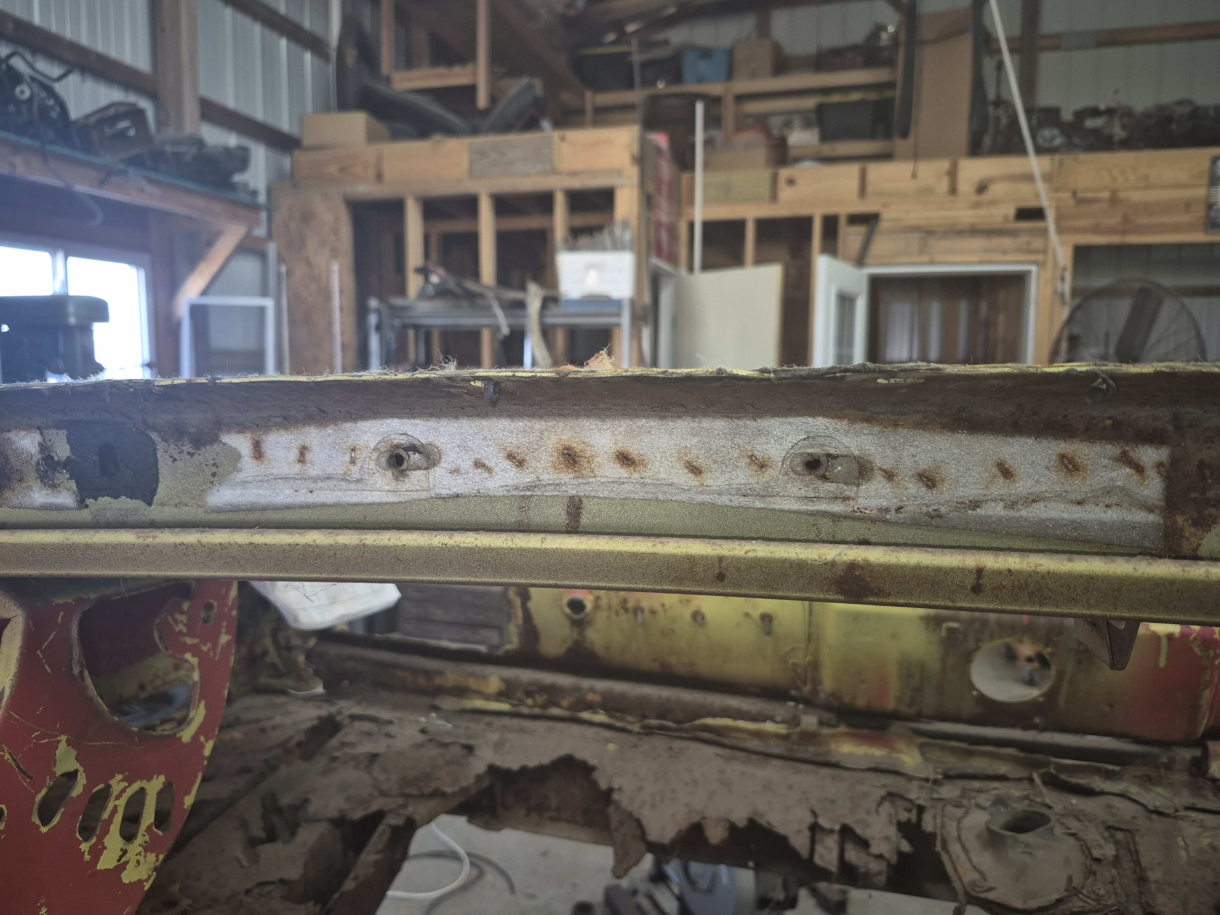

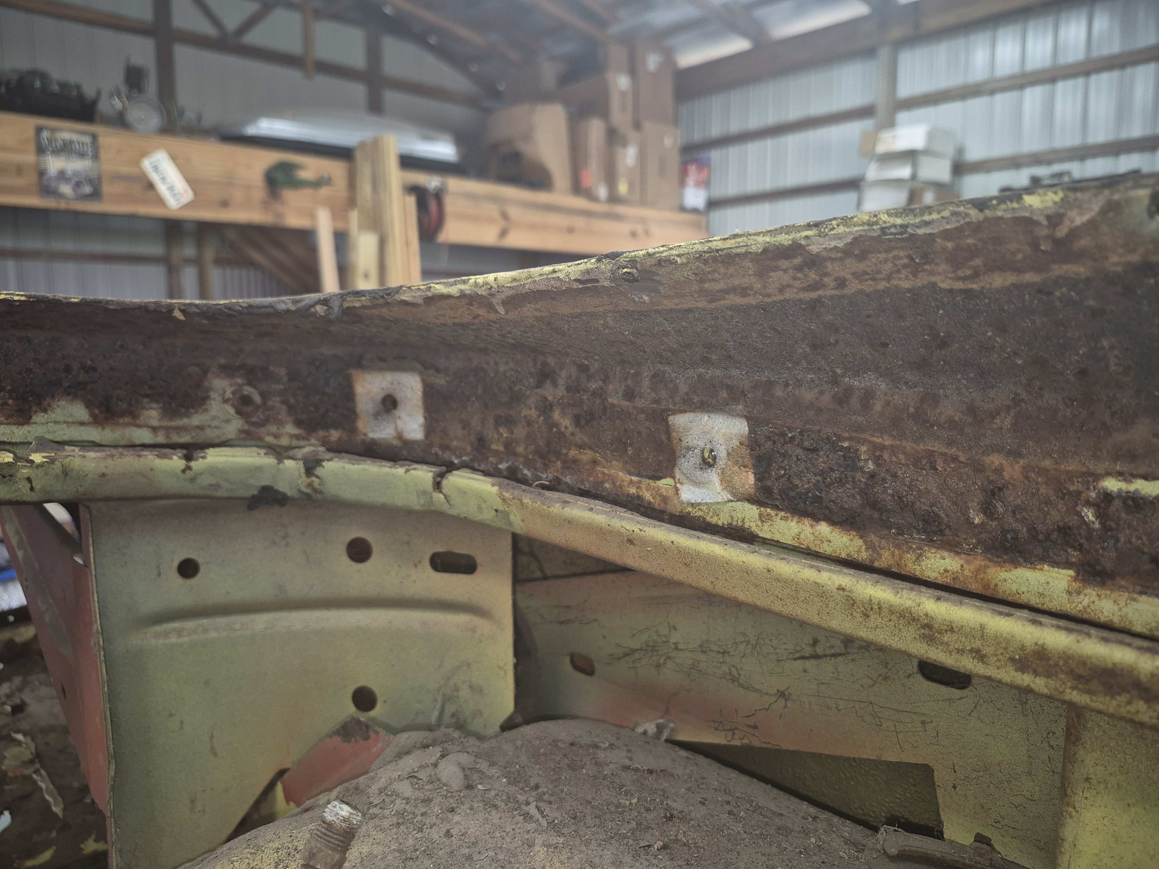

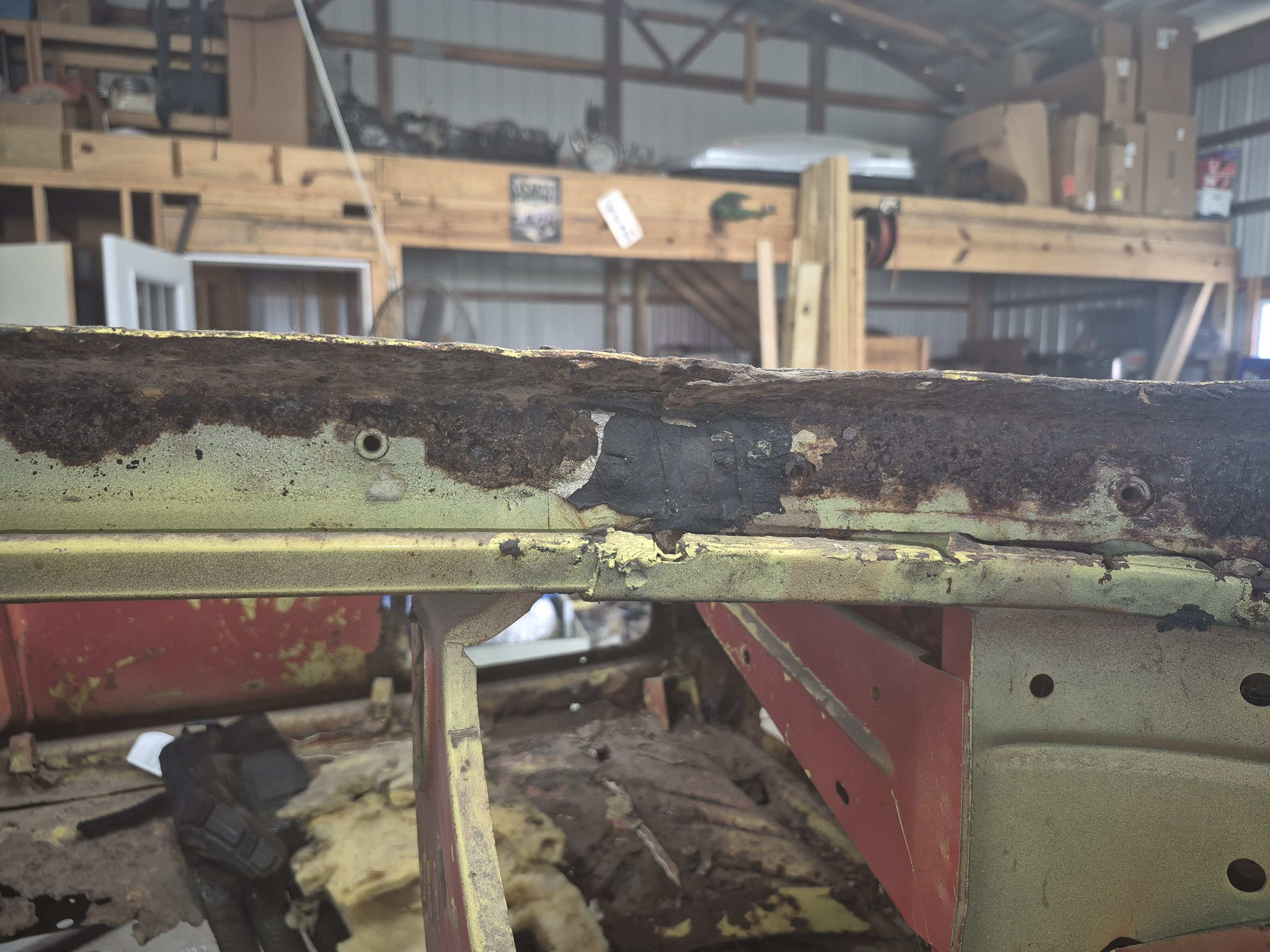

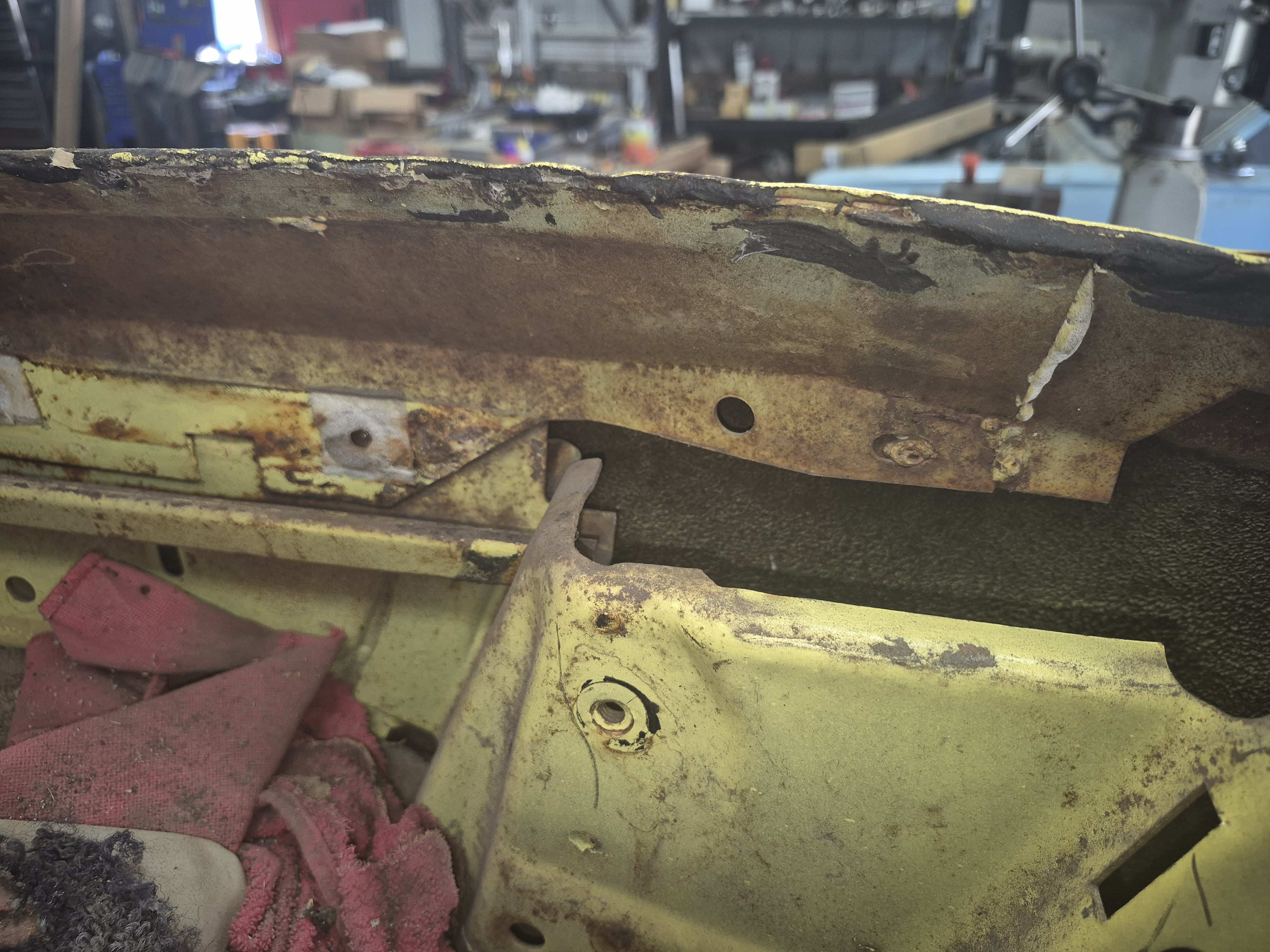

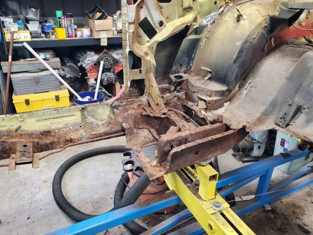

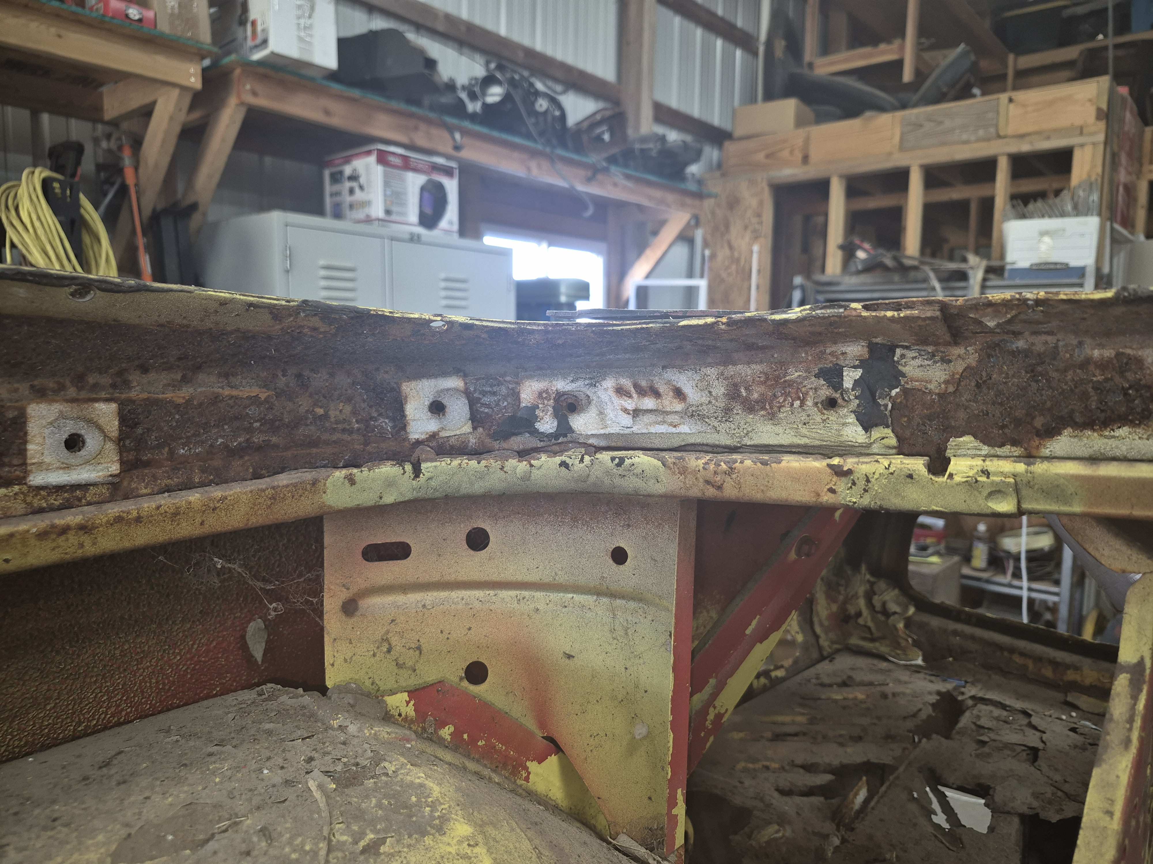

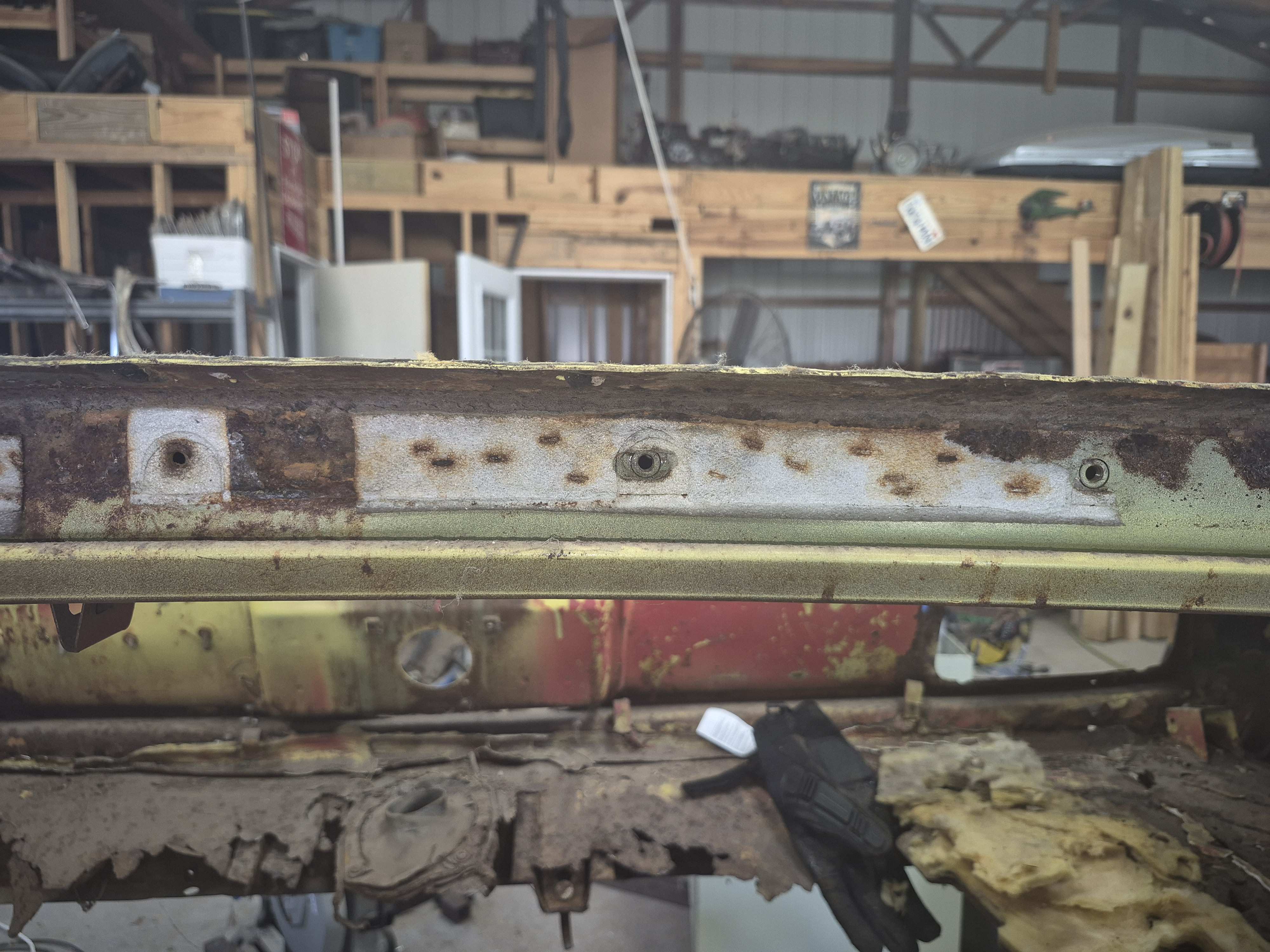

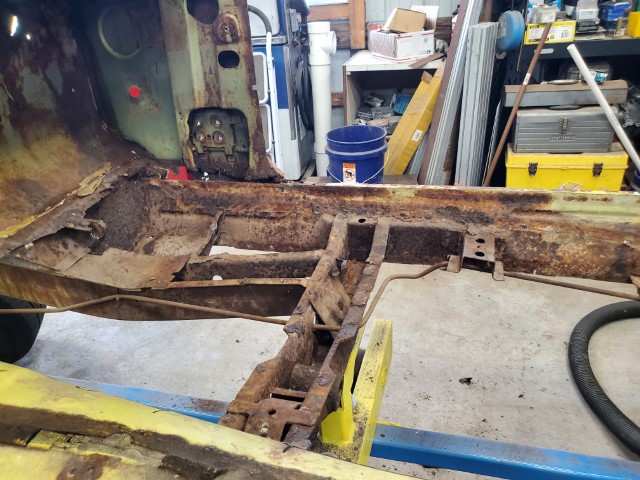

Finally making some real progress. Removed most of the floor, and trunk, left the transmission tunnel to act as a brace between the firewall and cross member. Outer rockers, like most of the car are completely shot but I'm hopeful for the inner rockers.

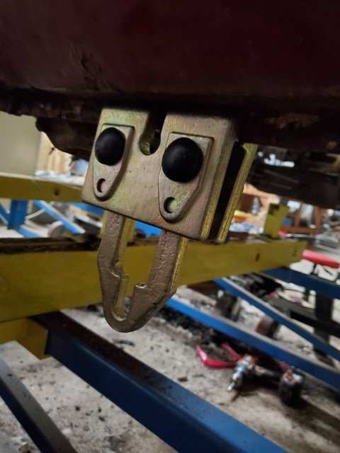

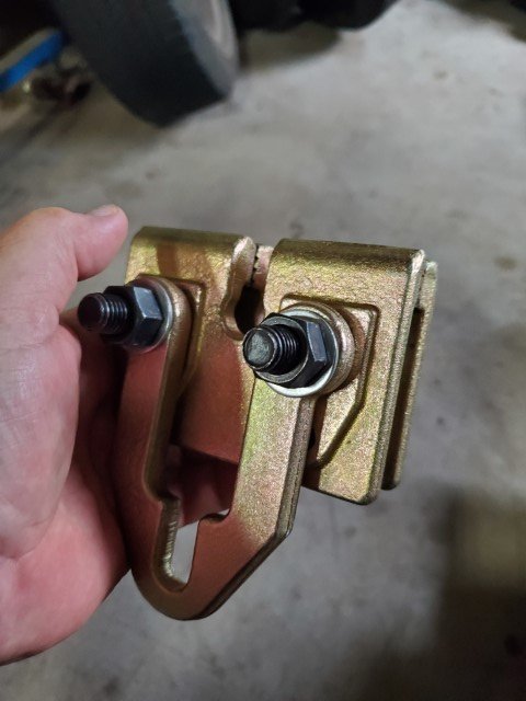

1. Pinch clamps for rockers. I'll need them for when the rear section is replaced and the car is no longer supported by the frame rails. Got this idea from another board member , then recently saw a post on a FB page doing the same thing. I was originally going to make some out of 1/2 plate cuz I didn't realize they made small pull clamps. I'd see the standard setup on a frame jig but these smaller clamps are perfect for my needs.
2. Something like what Rick does for the K-Frame but I don't think I'll be using a K-Frame. I'll likely use a k-frame as a jig to build a locator fixture. I'm thinking the same 2" .180 wall tube I used for the overall jig. I'll drill the mounting holes in the ends of some tube, bolt them to the k-frame then weld support structure. Once I add these two elements I'll post details.

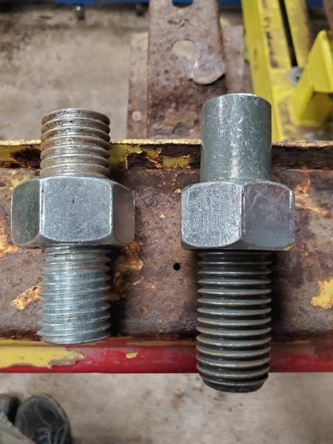

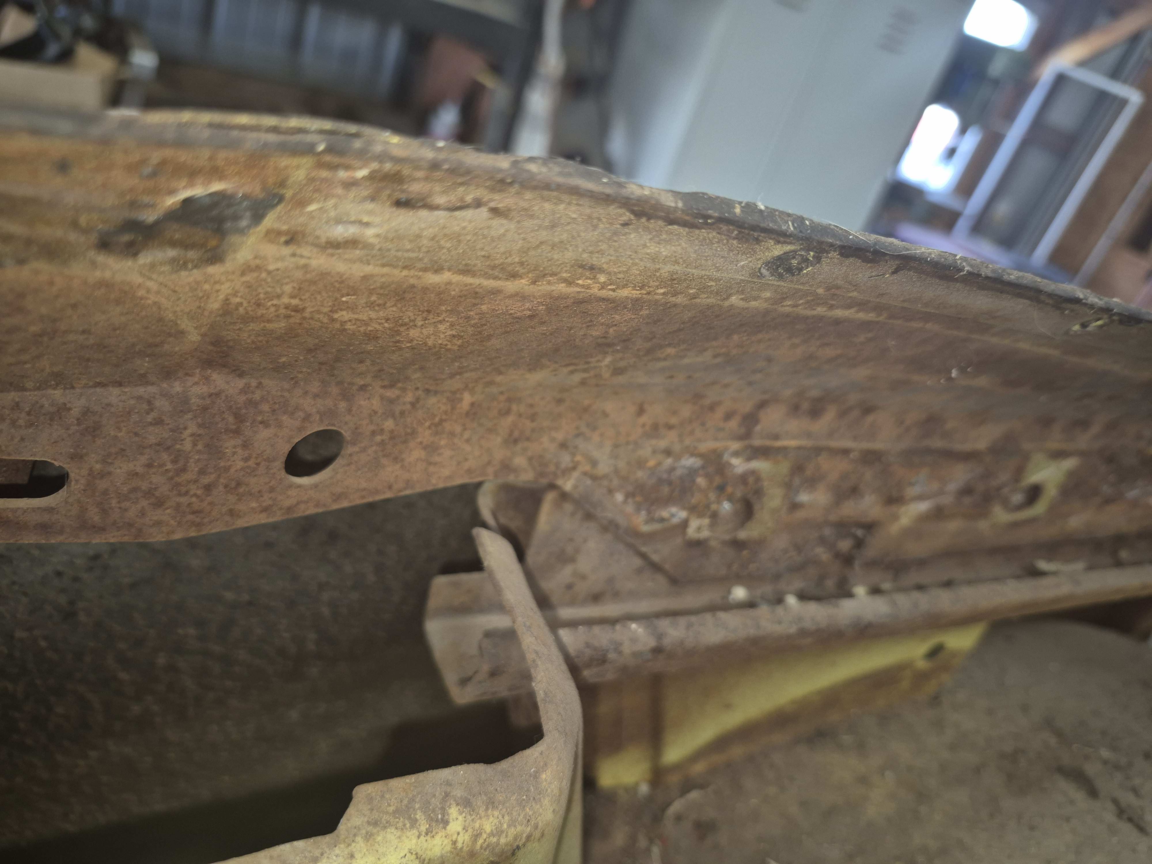

Small non-progress update.
Turns out 1" threaded rod makes a really bad locator pin. Seems obvious now, but the threads catch the sheet metal as well as allow it to move ever so slightly.
Solution was simple, 1" bolts with the heads cut off and we're back to awesome again.
Next are the pull clamps I'm going to use to hold the car up by the rocker pinch when the frame/cross-member support isn't present, or just whenever I want some extra support for this thing. There will be some sort of support for these to bolt to that spans the jig somehow.
