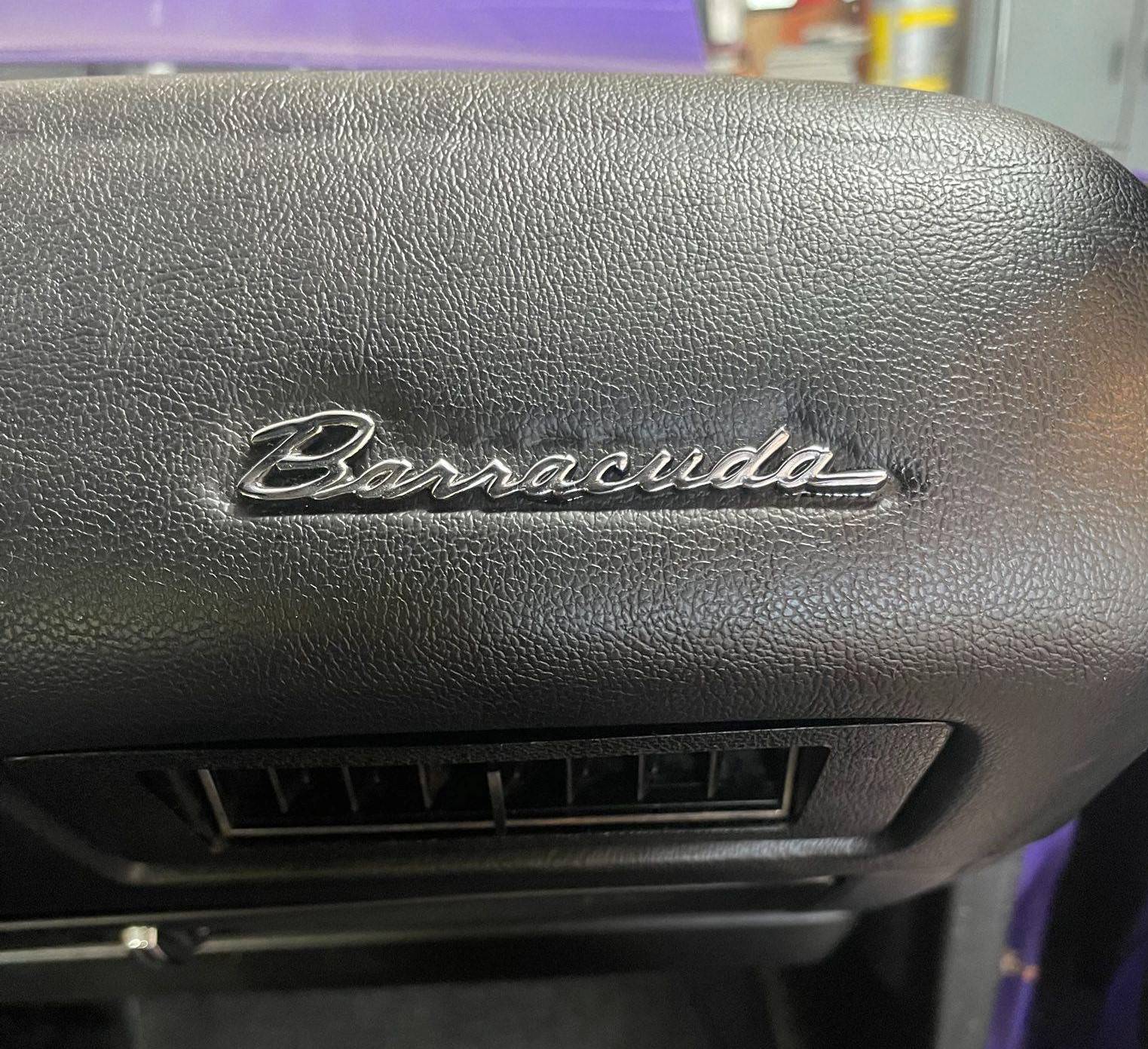

I installed my 1970 Barracuda dash emblem without the retainers on the pins. I used clear Gorilla Glue on the pins before inserting them in the pad. The 1971 style dash emblem should be even easier to remain glued in place with such a large surface area.

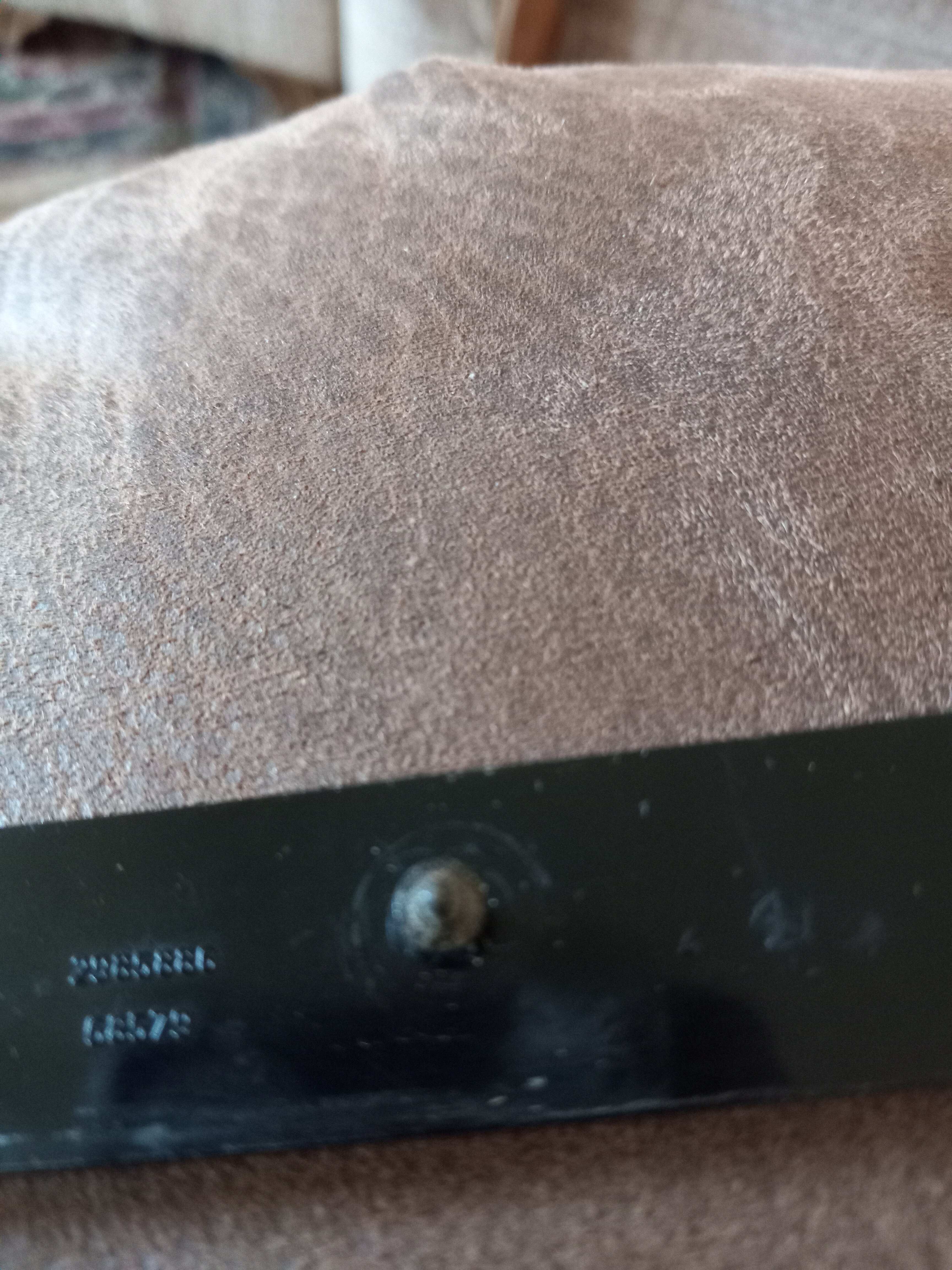

Those retainer nuts are one time use for the most part. We call them speed nuts inMy industry there is a top and bottom. The emblem should come with.. if not, any ace, Home Depot etc has them. Just get a 1/4 inch socket that will fit over the stud but not the speed nut and firmly but straight push down to install when done right it holds tight. they will most likely break the studs off when trying to remove if you ever want to remove/replace emblem
