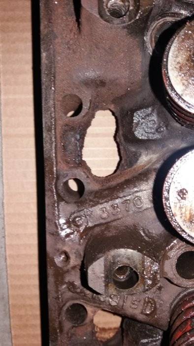

Starting to dig in my 340 4sp challenger rt and noticed it has j heads on it. I seen somewhere that they manufactured some j heads with 2.02s in them but unsure. Block matches vin #s and i wouldn't think the rt would come with 1.88s. So I figure some of you guys might know. I am gonna put a new timing chain and intake and gonna check the cam and valve train while im digging but while im that far i might change out the heads if they arent 2.02s. Dont want to change them if i dont have to tho. What do you guys think? Is there #s that tell they are original to the car? All info is appreciated.

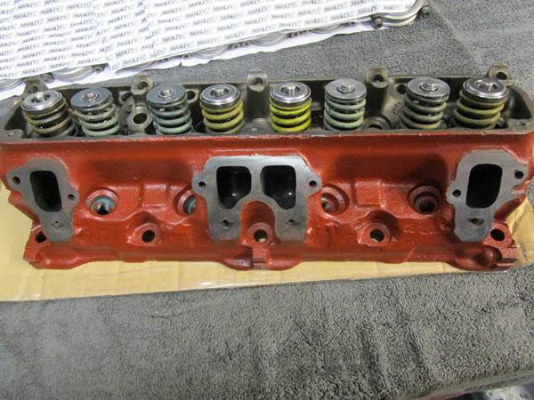

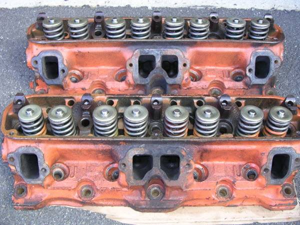

My T/A heads are J castings with 2.02s, but I have some later J heads that are 1.88. I don't know if this a reliable ID or not, but the 2.02 head looks like this:
And the 1.88 has an extended pad below the exhaust port ("smog" heads). These also have hardened exhaust seats because unleaded gas was becoming law.

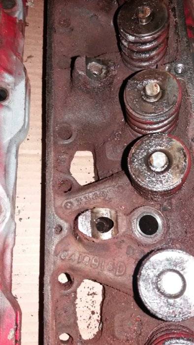

Thats good to know. I learned so much recently with this car as almost all the other mopars ive had over the years werent original and i would always just build what i wanted. Im sure its like a cold but i regret so badly how much good stuff i got ridd of or junked over the early years. Once parts became scarce I became i hoarder. Lol. These are what came off and in the machine shop now. Def 2.02s
They are U heads.
