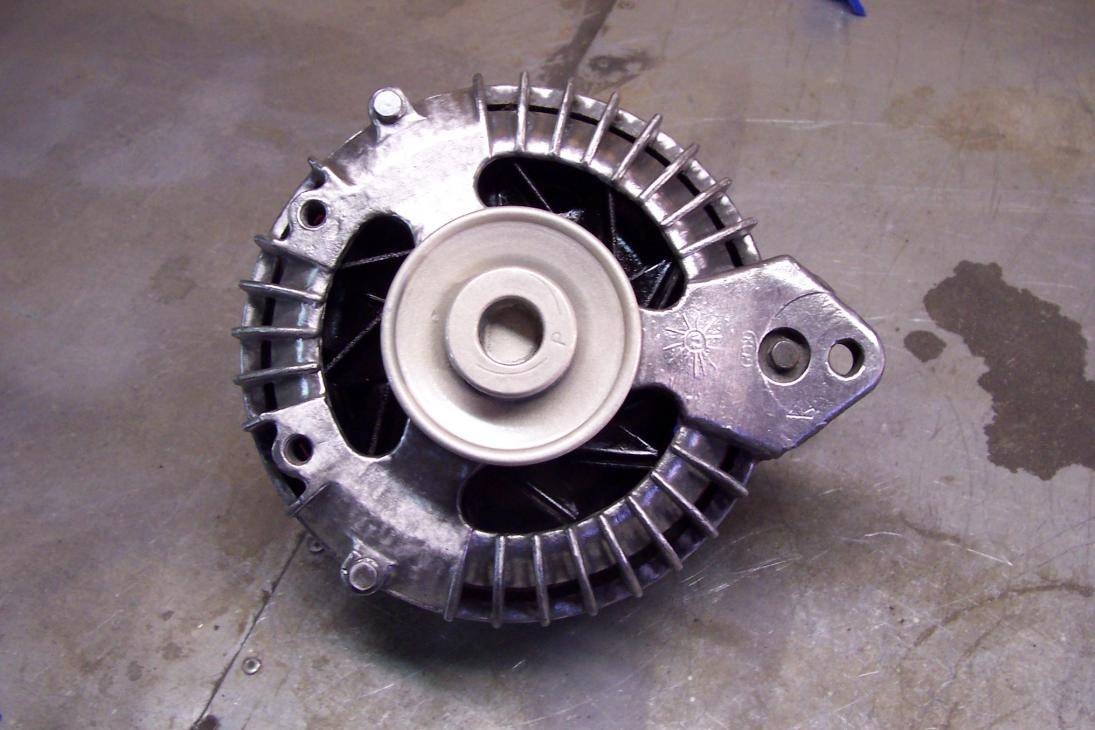

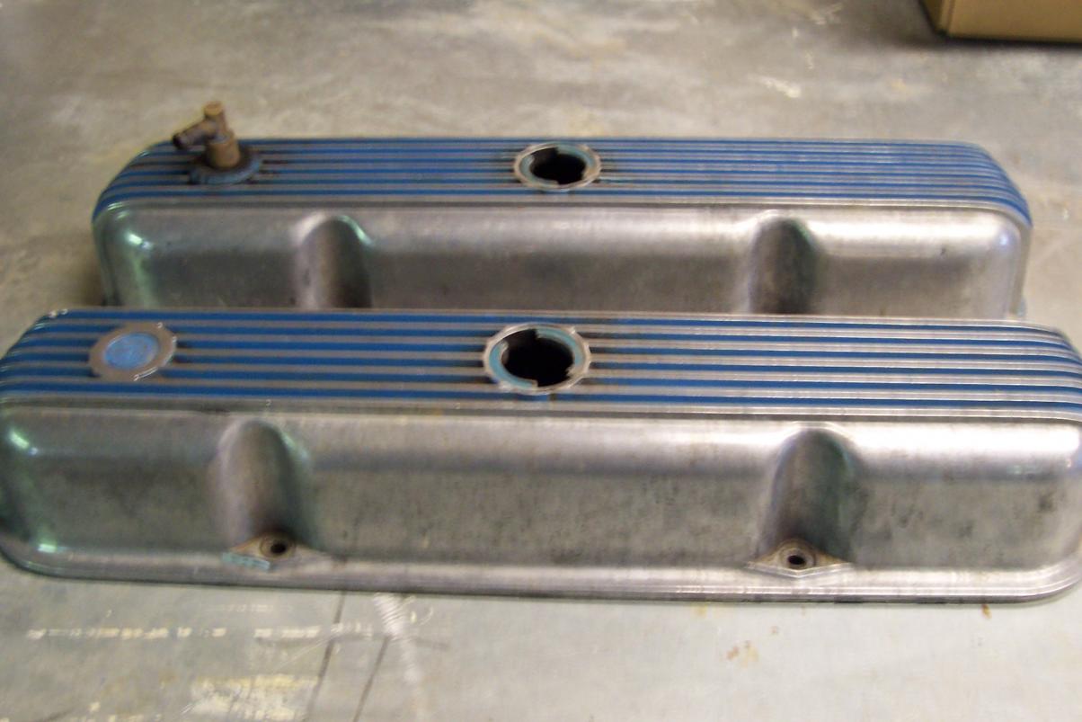

Marxfish for the valve covers all I did was go to sears and buy a couple of buffing pads and put them on my pedestal grinder.I removed all the guards for more access since it`s a cotton pad you wont tear your fingers off if they get in the way.I used the white and blue buffing rouges to polish with and a dremel tool for the tight spots.

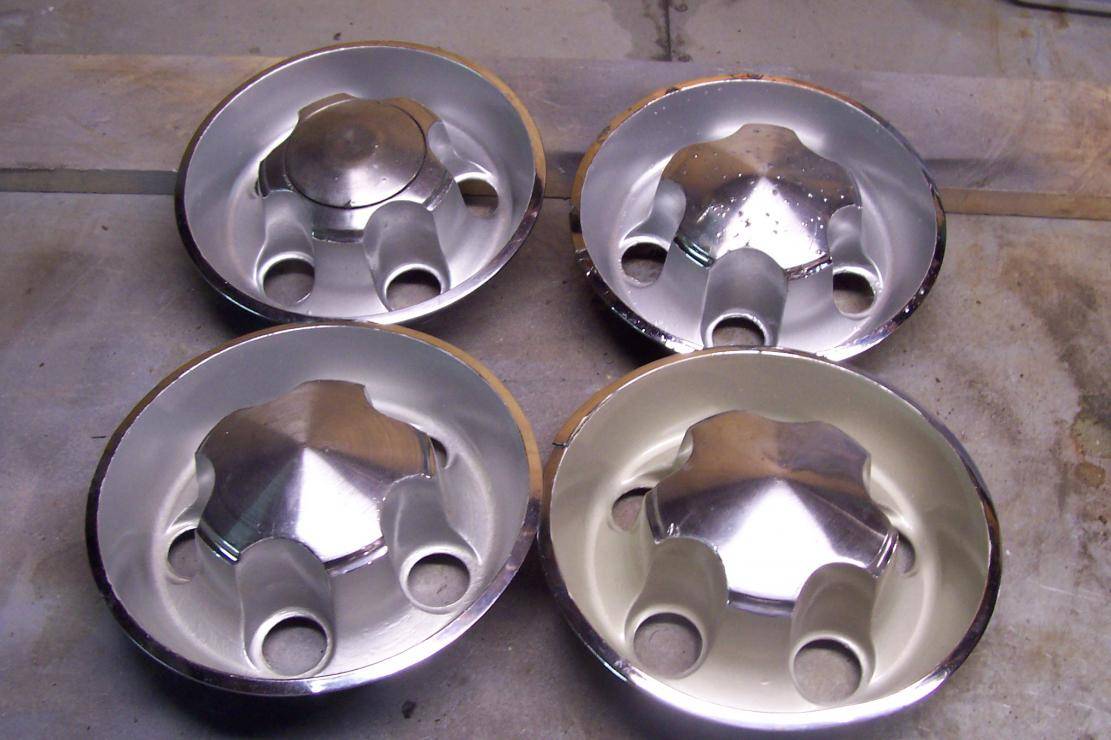

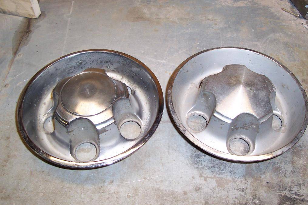

The trick with the center caps is to find some with no pitting/dings on the outside edge and center portion of cap.First I polished the outer edge and center first,then mask those areas off.Then sand all the old silver finish off I just used coarse sandpaper,small wirewheel and a drum sander on a Dremel tool it works well in the tight spots.Try to sand down any pitting as much as possible and use a finer sandpaper to smooth out any roughness from coarse sandpaper.I didn`t do this but you could probably use some filler to fill any holes from pitting for a real smooth surface.Double check the masking tape is still good,then just paint using same steps as the rims and thats it!
