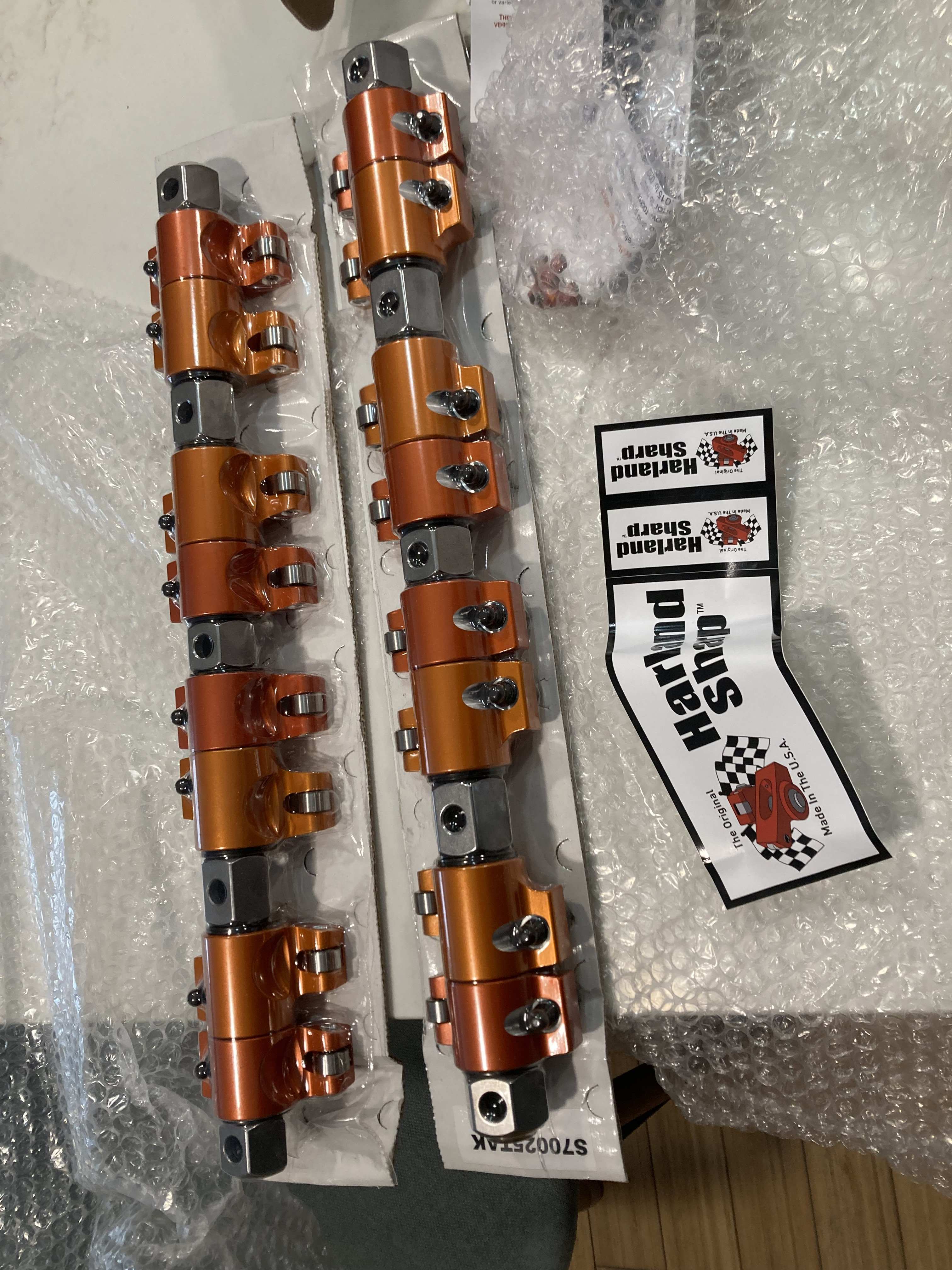

Just received the rocker arm assemblies for the T/A motor, was not included with the car. Most everything else was and these look awesome! Just what we needed to finish the motor for this beast. 😊

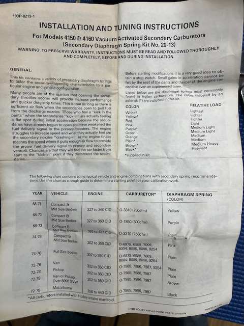

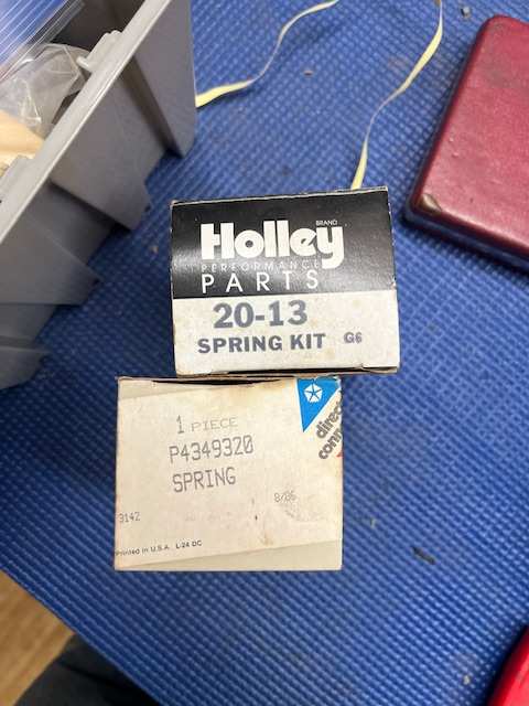

Here’s the information on the outboard springs. The springs kits are cheap. The chart is included in my old kit. I have used differ springs in the outboards sometimes to “tune” it more precisely. The white springs can be too quick and bog sometimes. I’ll pair it with a yellow in the rear and it stops the bog. The outboards are tied together and will open at the same time even if they don’t have the same spring. FYI, if you use the black spring, you only have a “ 2 pack”! Lol.
