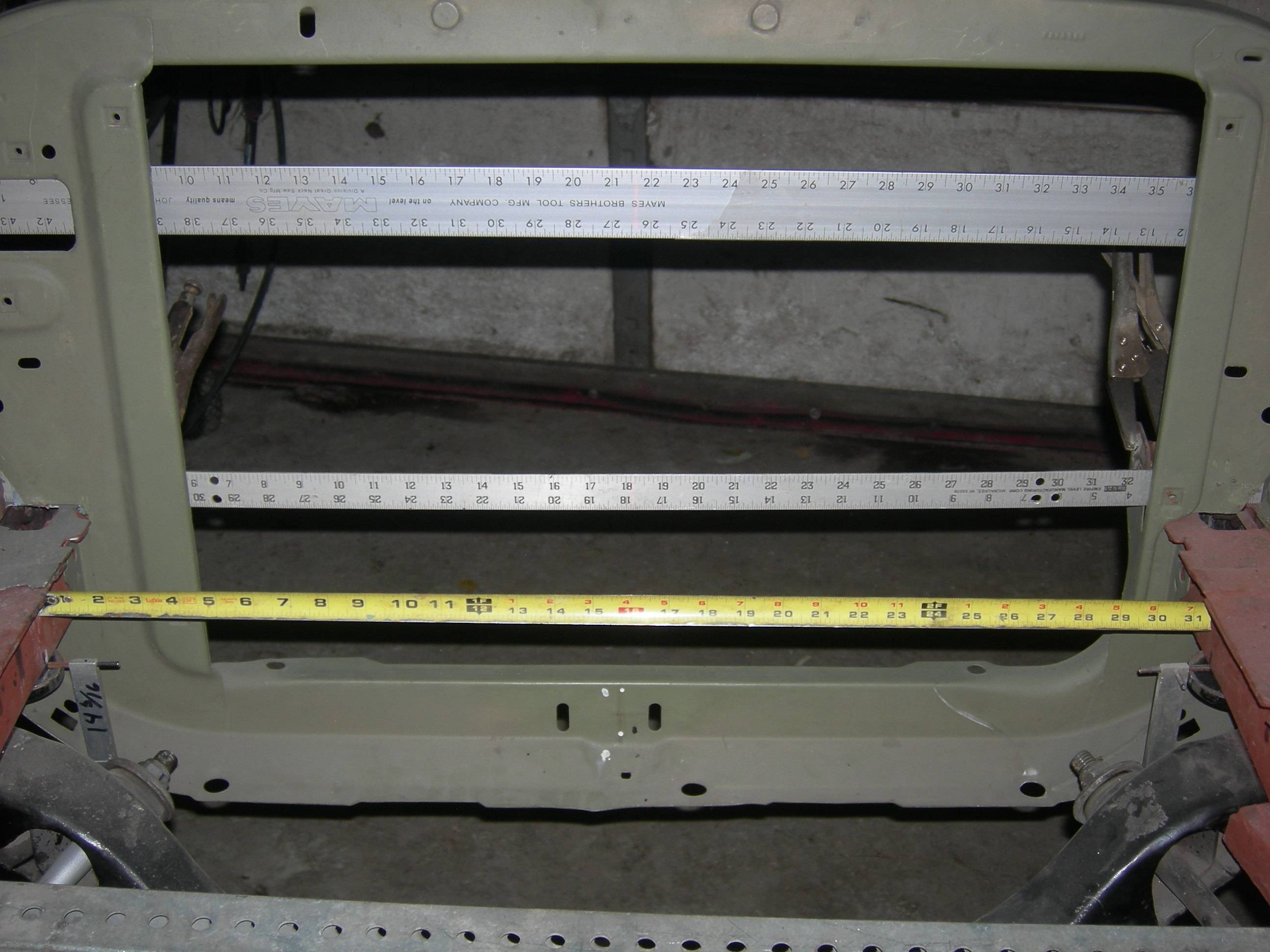

Hi all, can anyone supply the rad opening dimensions for the 26 inch rad opening. Side to side top to bottom and BC to BC. I goy carried away with my stripping and sanding and erase the measurement I had written on the cross bar.
Thanks in advance for any assistance.

Don't have the rad as yet, originally 22 inch rad in the car. The side panels were heavily rusted and I replaced them with the units I ordered and these were the panels for the 26 inch rad conversion. I believe that the side to side was 28 1/2 and the vertical was 18 1/2 but looking for verification. Notheing in any of my factory manuals.

Found one.
