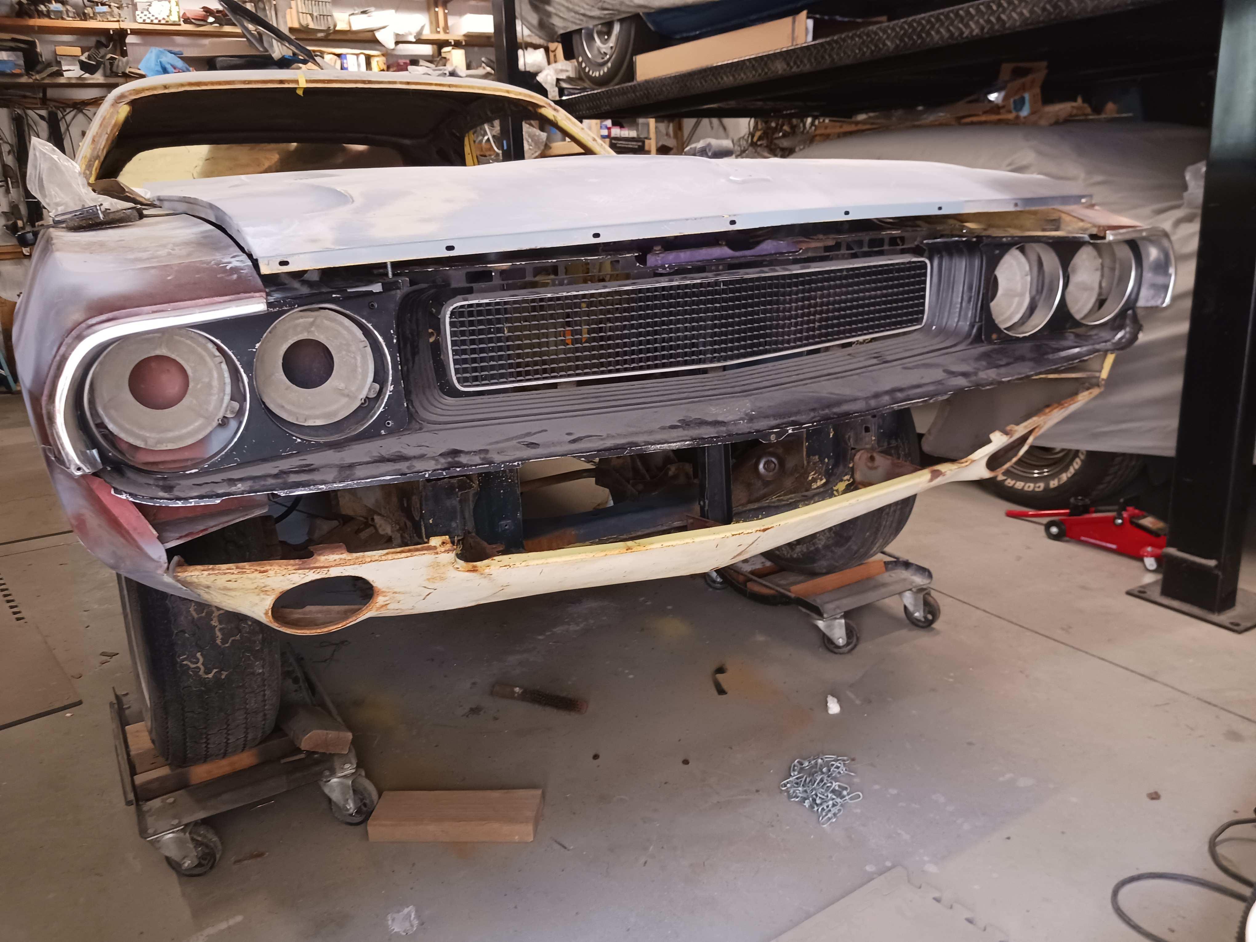

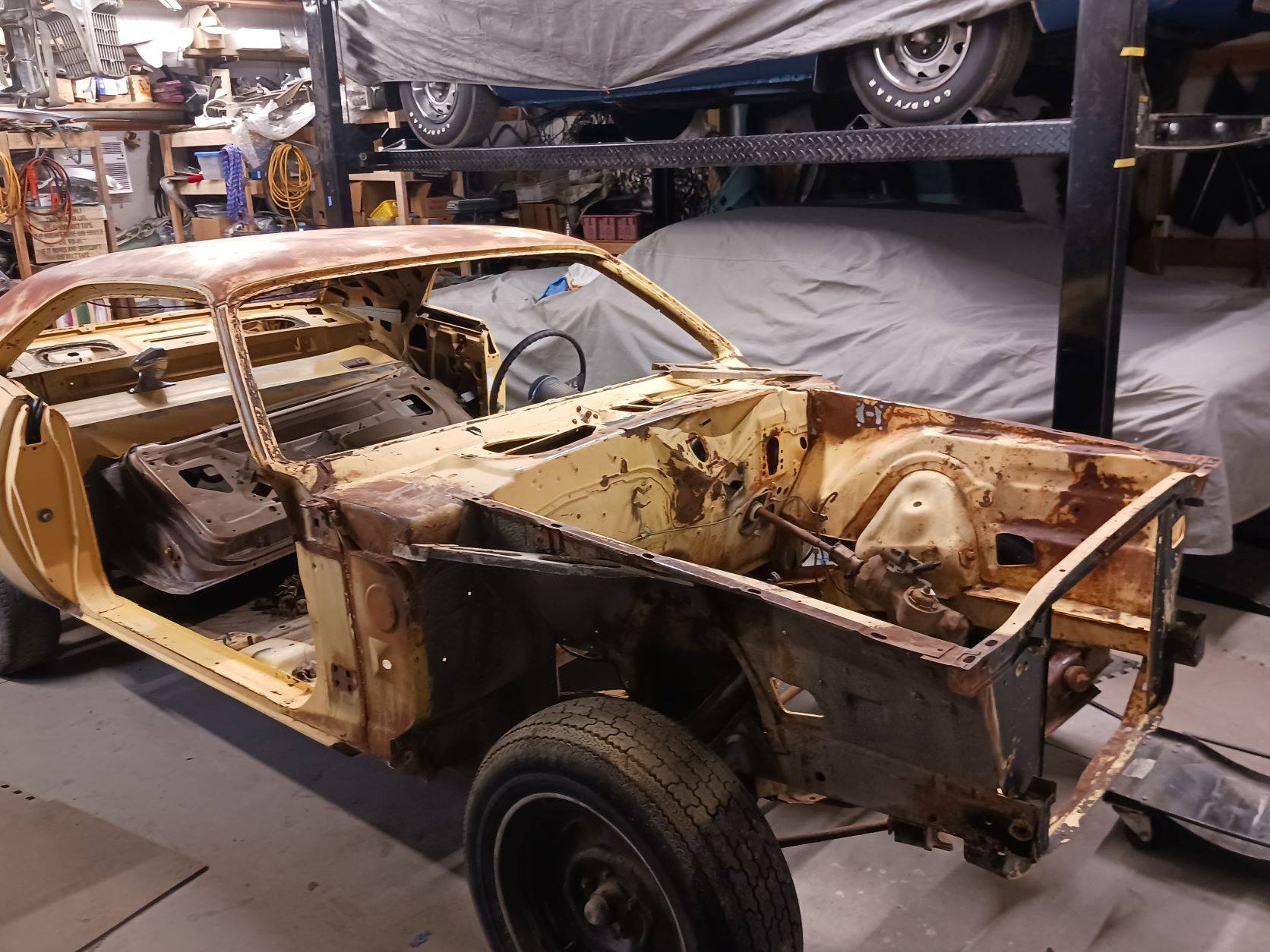

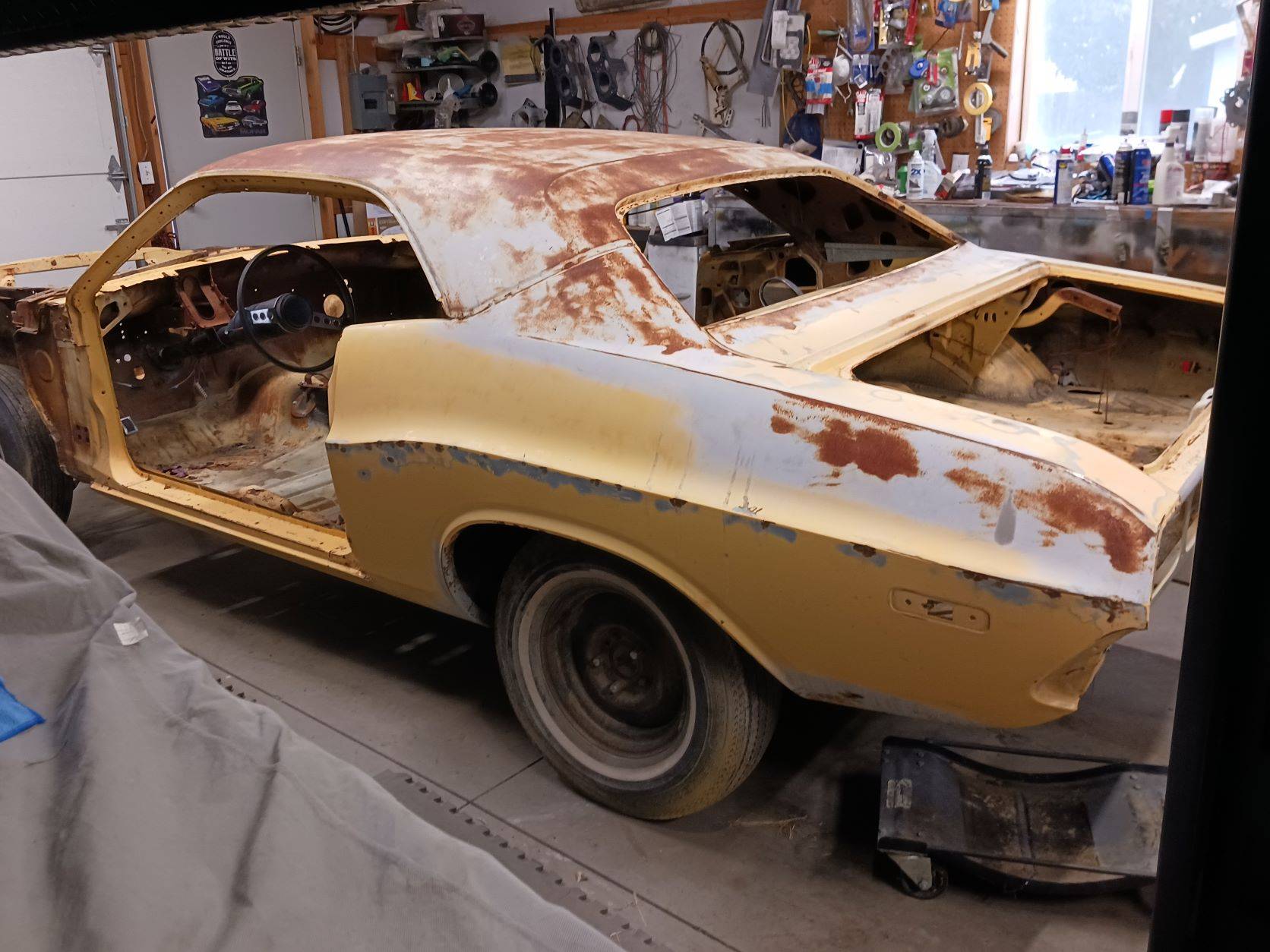

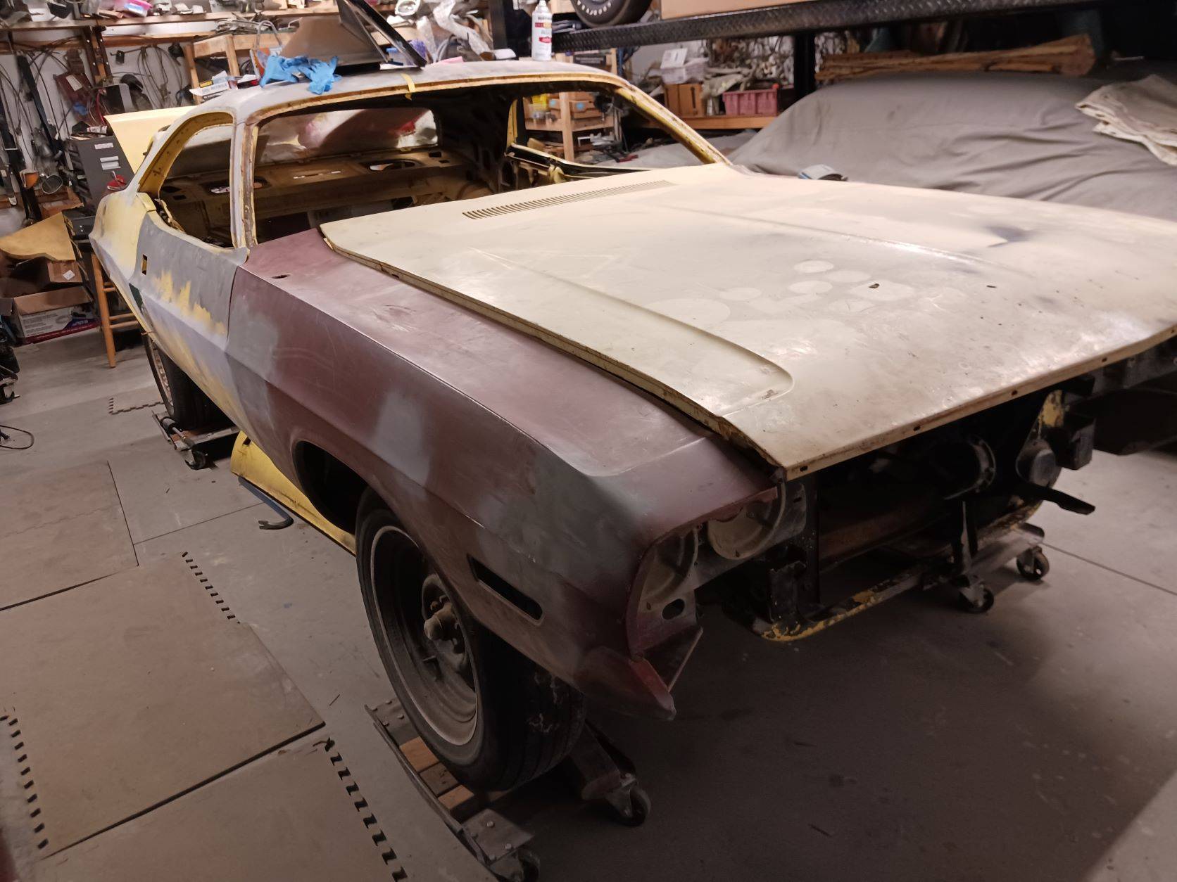

I did not realize I had not shared my latest project to rebuild. I got it from a friend who had bought a Hellcat Redeye and decided he would never rebuild this car. It was all apart except for the steering and 4 tires. He decided he would let me have it because he wanted to see it back on the road. It is originally a 318 auto car. Nothing special. I decided to rebuild it using my spare parts as much as possible. I had sold all my 72-74 Challenger parts and all I have left is 1970 and 1971 Challenger parts. It needed an entire front clip which I have from a 1970 Challenger. My grandson is helping me with this car when not doing school homework. He likes the 70 Challenger front end and the 72 tailights, so, we'll see how this goes. The only rusty areas this car has is a 1"by 2" spot behind the driver's side rear wheel and the hood hinge areas on the inner fenders. I replaced the sheet metal in both areas which took about 3 hours or so. I've rebuilt the heater box and am now working on redoing the dash and harness. My grandson want to switch it over to the pistol grip 4 speed. I have a transmission, bellhousing, complete shifter mechanism and shifter rods. I would need pedals and clutch and z-bar for the clutch. We'll see if we go that route. I have a rebuilt 360 I'm going to put in it. He wants to change it from yellow to red. So here we go. Here's some photos of it. I'm glad all floor pans are solid. The front had been hit but it's been professionally straightened on a frame rack before I got it. All good. Enjoy the photos.

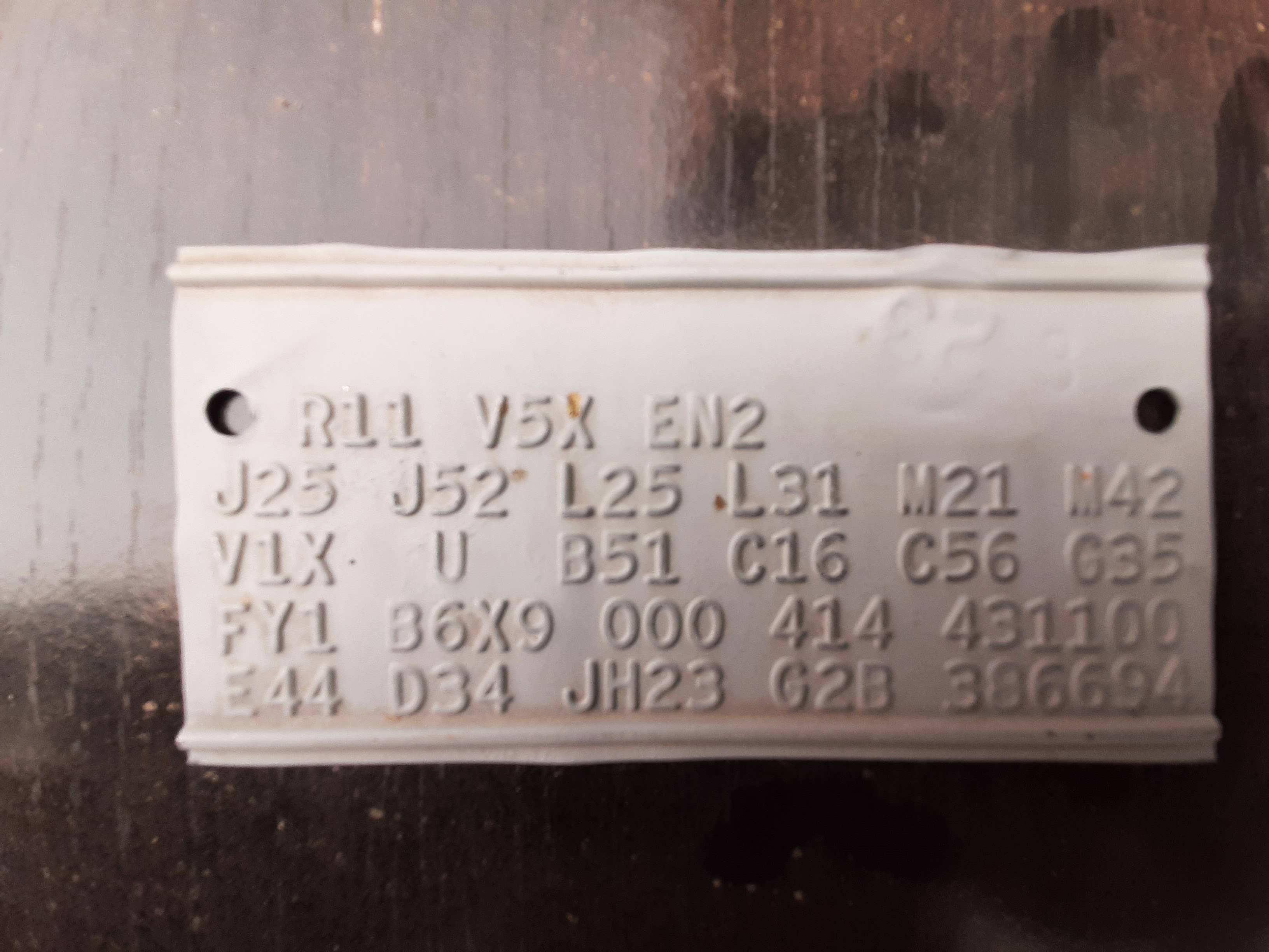

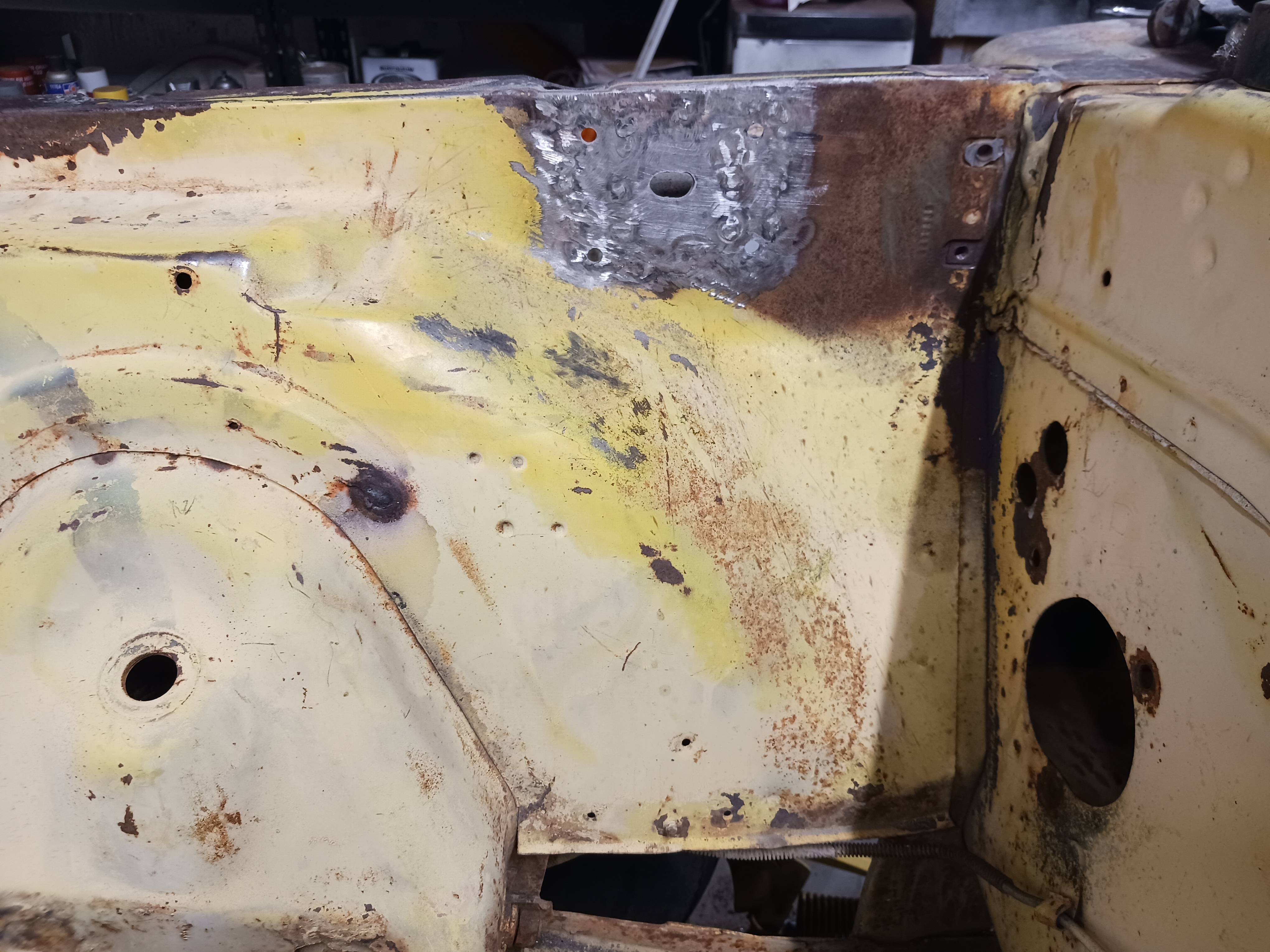

One hinge area repaired. The other side looks the same. Here's the fender tag.
TW

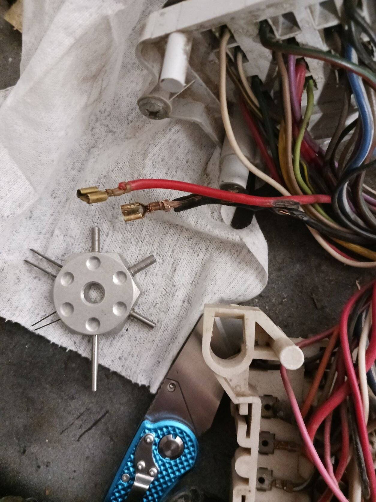

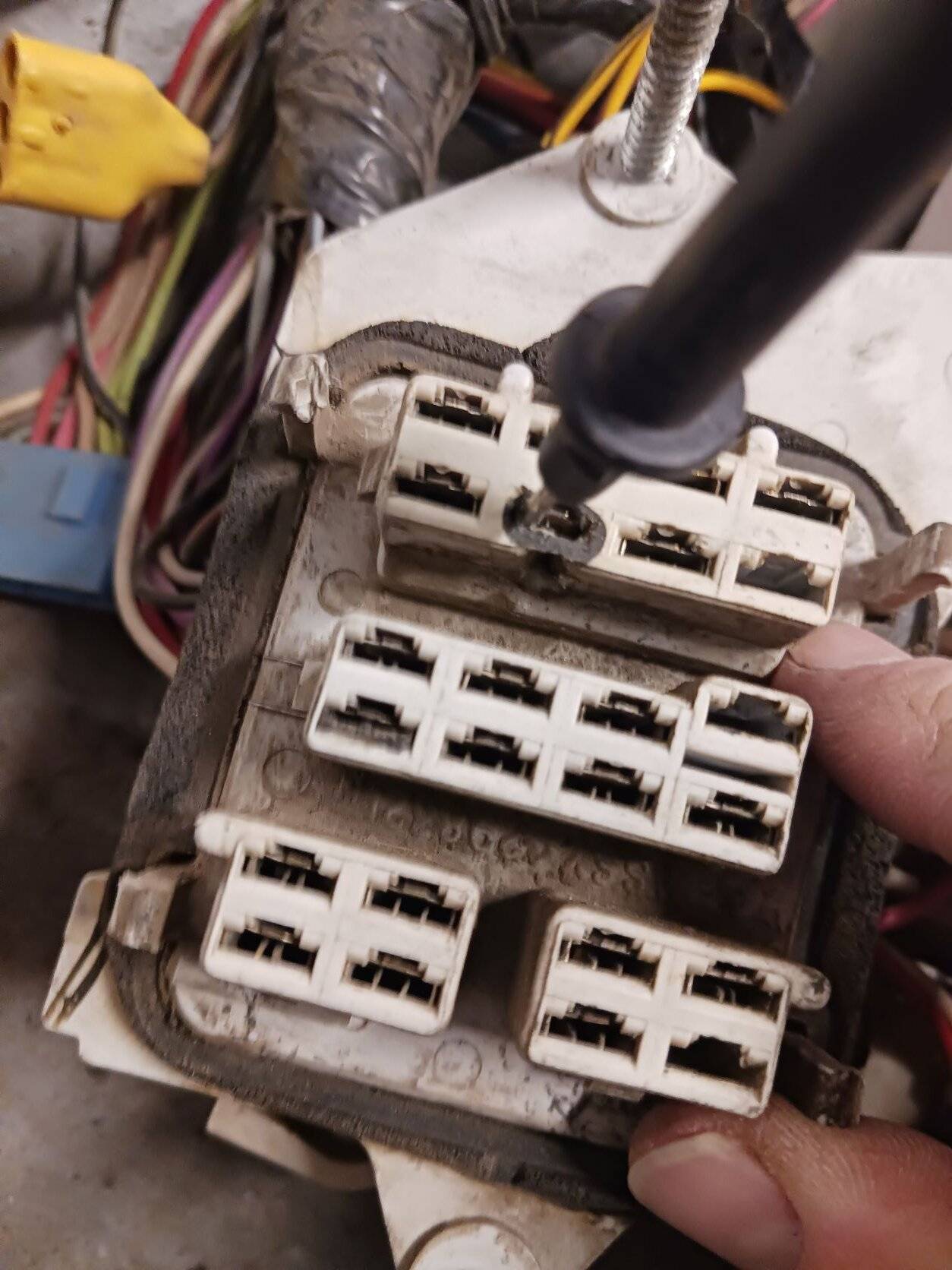

I noticed this black spot on the bulkhead connector the other day and found out it was a melted area. I split the connector and you can see what I found. I'll be doing the connector bypass on the red from the starter relay and the black to the alternator. That's where I'm at now with this car.
TW

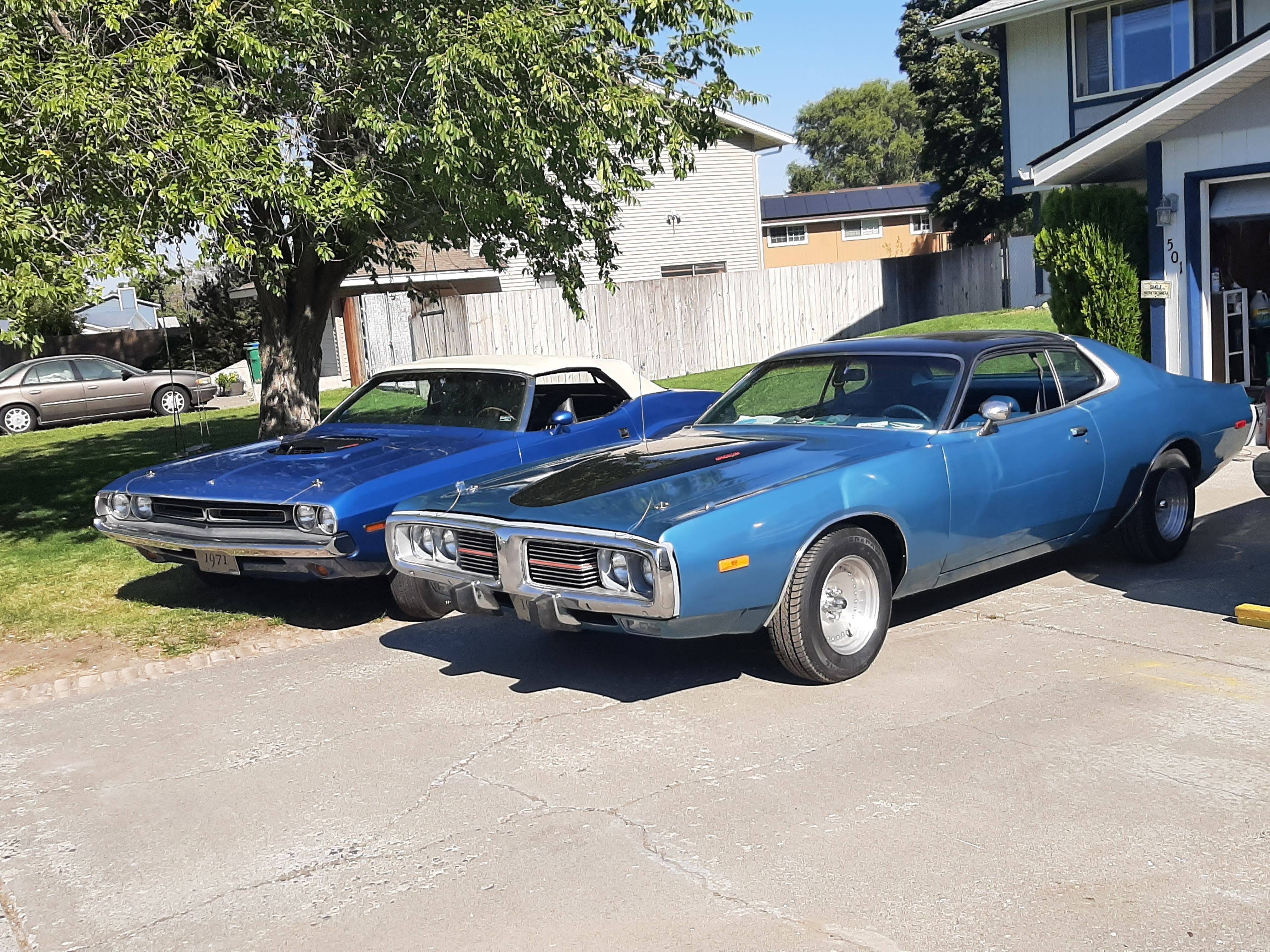

@heminut He helped me on a 74 Charger Rallye which I gave him. I have a feeling he may want to trade me the Charger for the Challenger when this is done. We'll see. Below is a photo of the Charger taken in September.

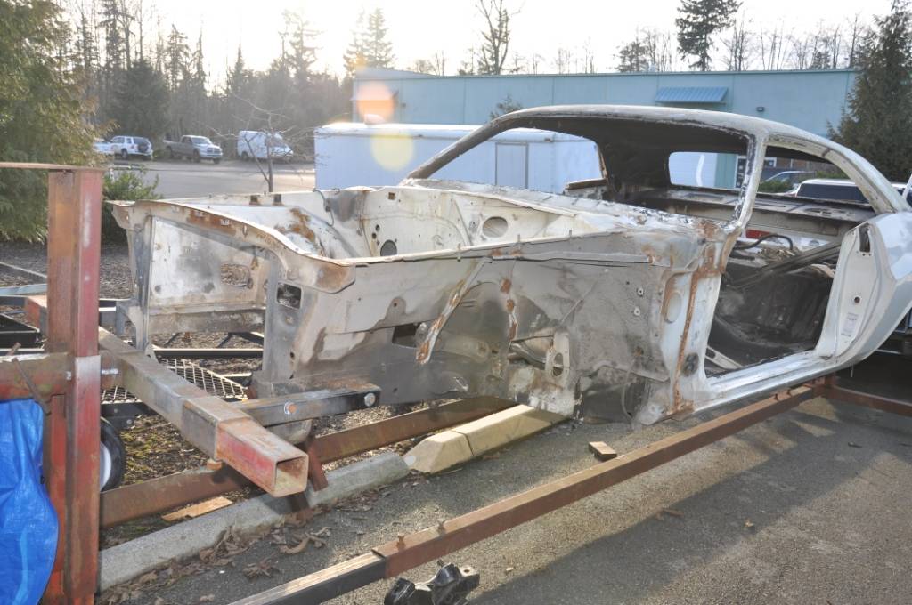

I am "Finished" with my 73 restoration. I have lots of pics and some parts that might be useful. PM me if you need anything, and I will see what I have. Only get online here every so often so be patient. Here is a few before and after pics of mine.

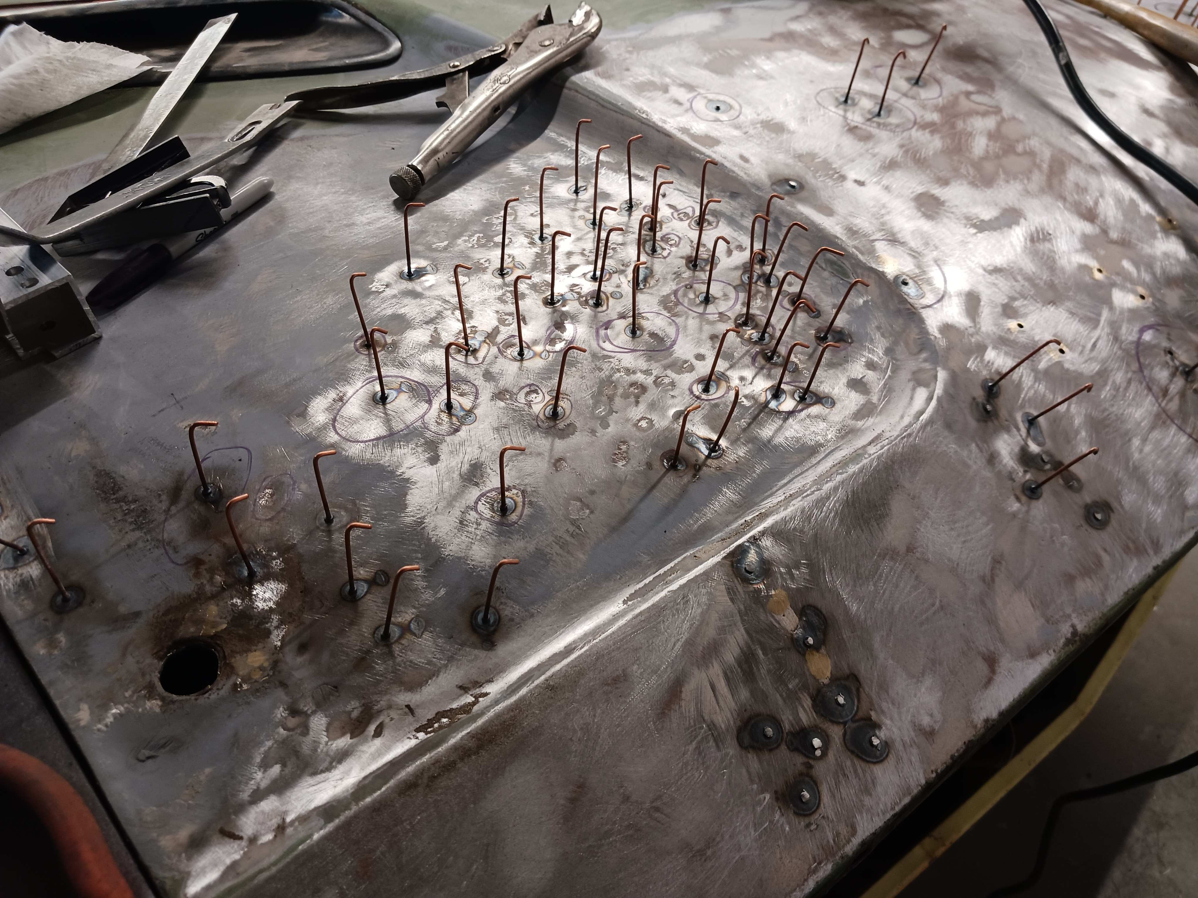

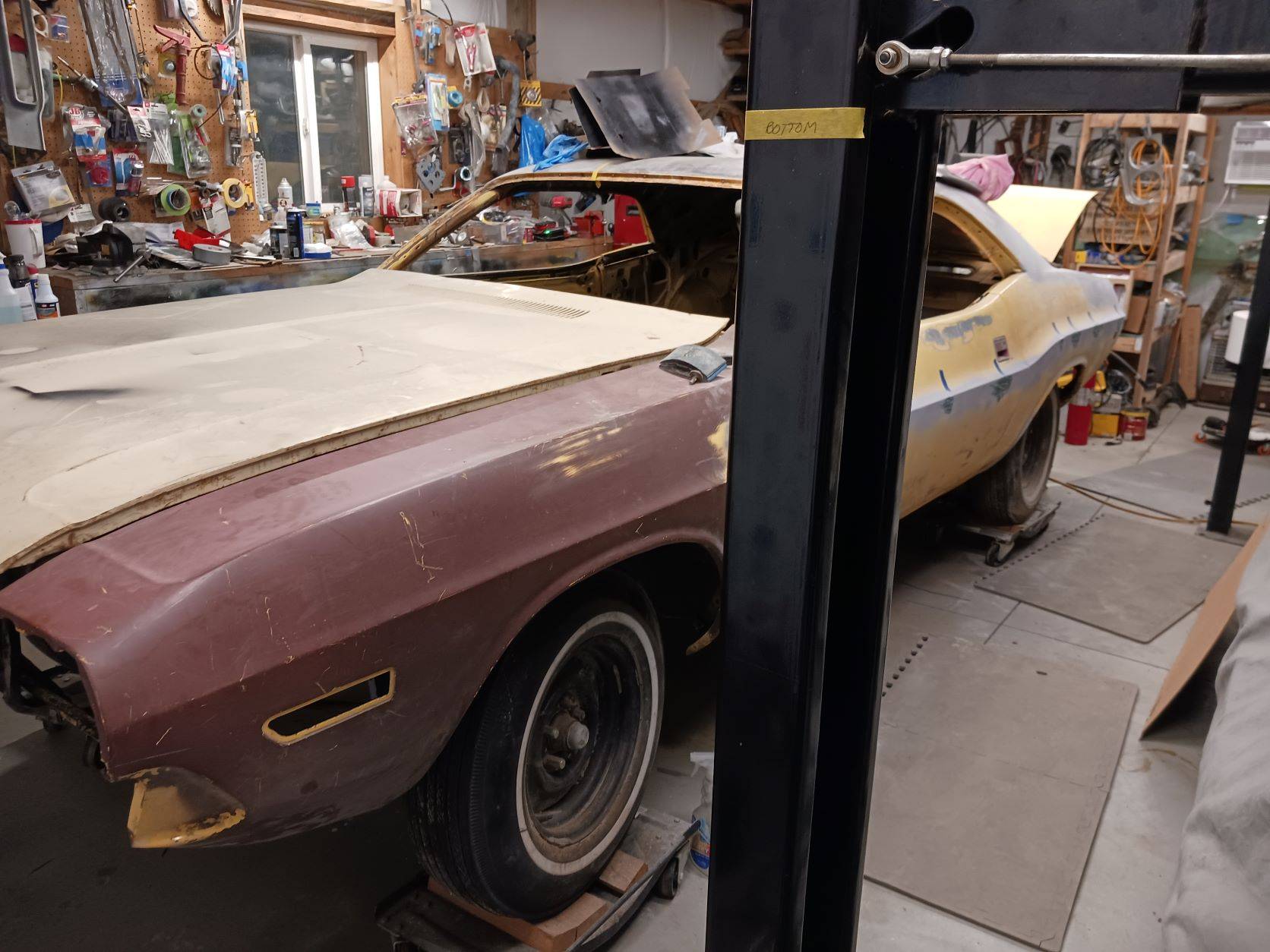

Update. I was able to get a 1970 R/T hood for next to nothing. The hood has problems. Lots of body filler in it. It looked like it had a crease in the passenger's side at one time and someone drilled a few holes to try and pull it out and brazed the holes in. They also used a piece of metal brazed in to cover each hood pin hole and the DODGE letter holes. I'm trying to save the hood. I welded over 100 pins to pull the dents. It's like someone used a ball peen hammer on it on the passenger side. The hood is worth saving. With all filler over the entire hood, moisture got under it and caused light pitting so I'm going to neutralize the rust on the entire surface and then use waterproof stranded fiberglass filler on required areas. Other body work is close to being done. Engine compartment is almost ready for color paint. Including the rebuilt engine and trans and the cost of the car, I'm into it at slightly over $5.5k. Carpet, headliner, soft body seals and gaskets along with trim has been bought. It's going well. I'm selling spare parts to help finance this project. I'm still considering switching it to a 4 speed. We'll see. I did weld the frame bracket in for the ball pivot if I go with a 4 speed.

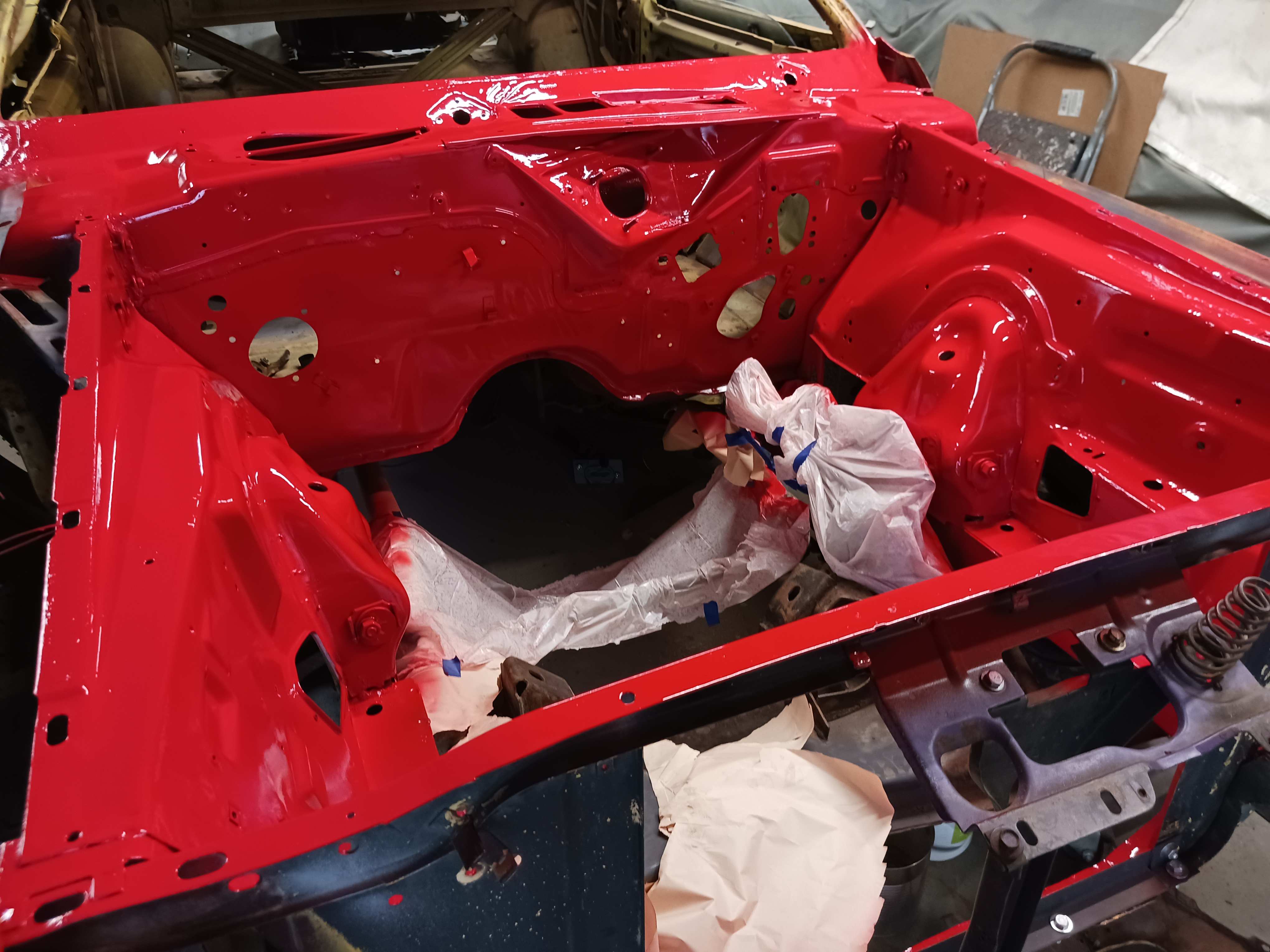

Painted the engine compartment in the red my grandson likes. I have my reservations with this color.

blubyou340
Mar 19, 2023
60
16
Danville
I personally have never beena red kinda guy oh paint looks great .for me its for fire trucks. Im more suttle
