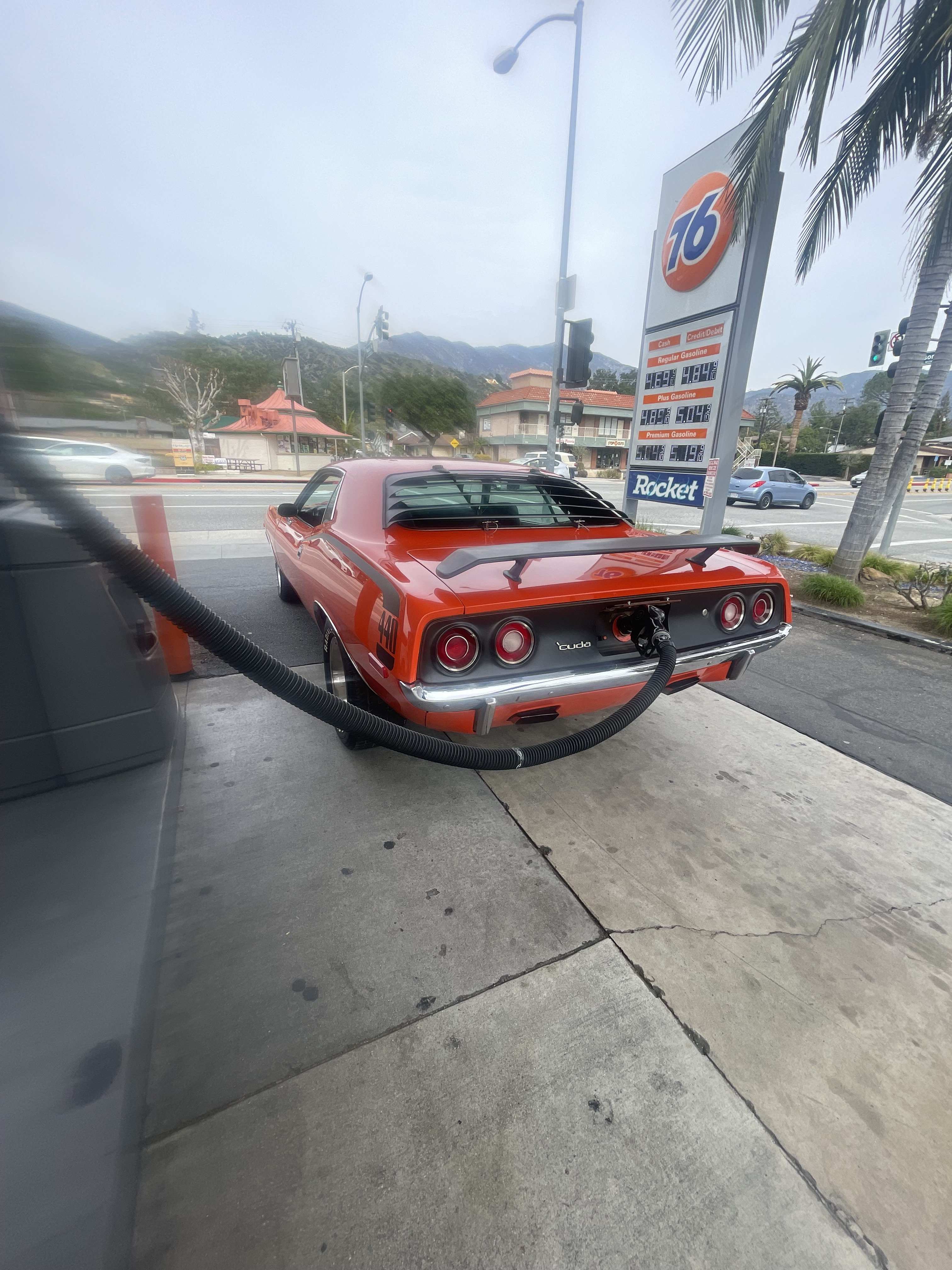

Hi guys, I have a 72 Cuda with a new fuel tank in it.
When I fill the car I get fuel leaking from the top of the tank somewhere. It stops after a few miles of driving.
Would the suspected culprit be the large rubber o ring at the filler neck.?
Thanks in Advance.
