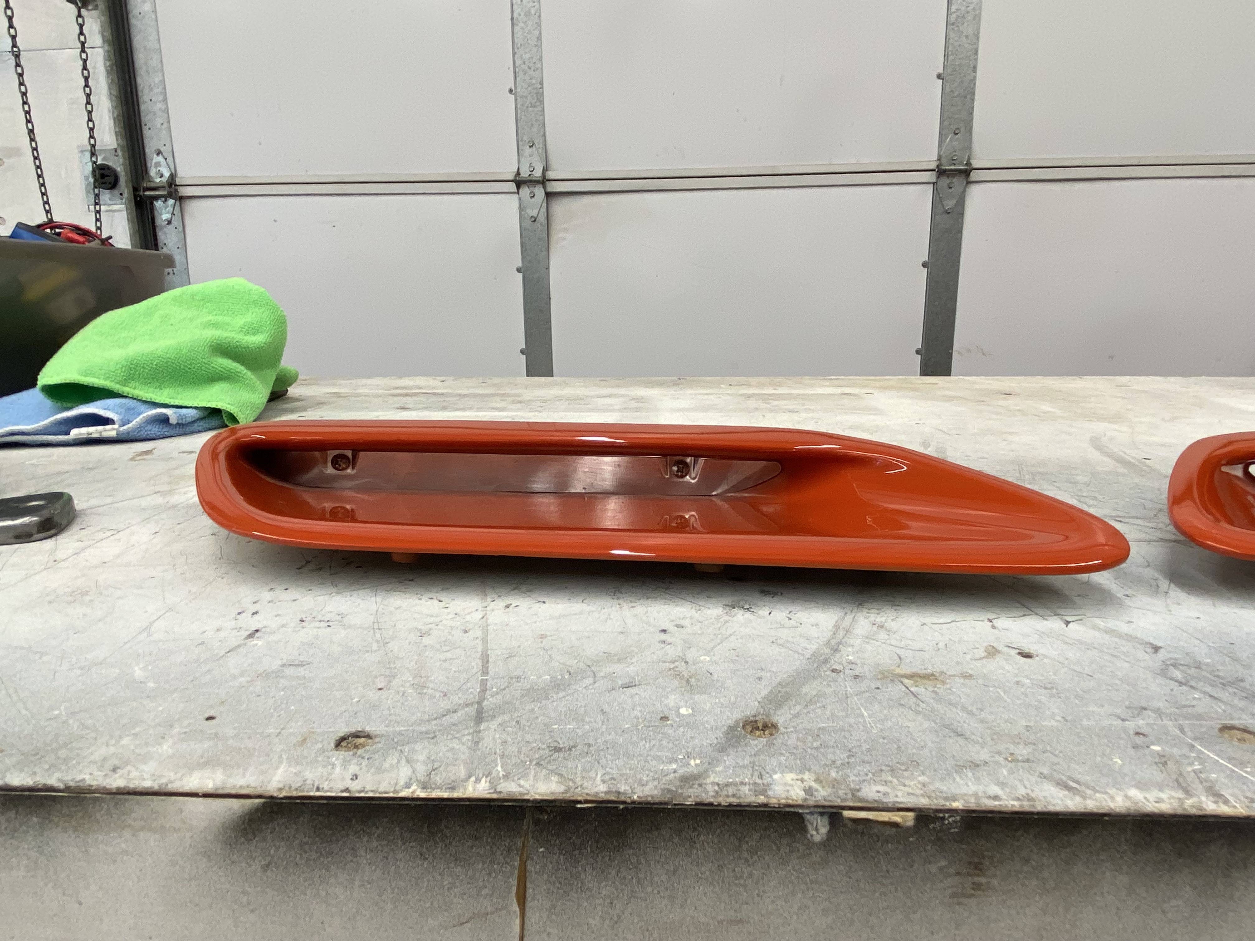

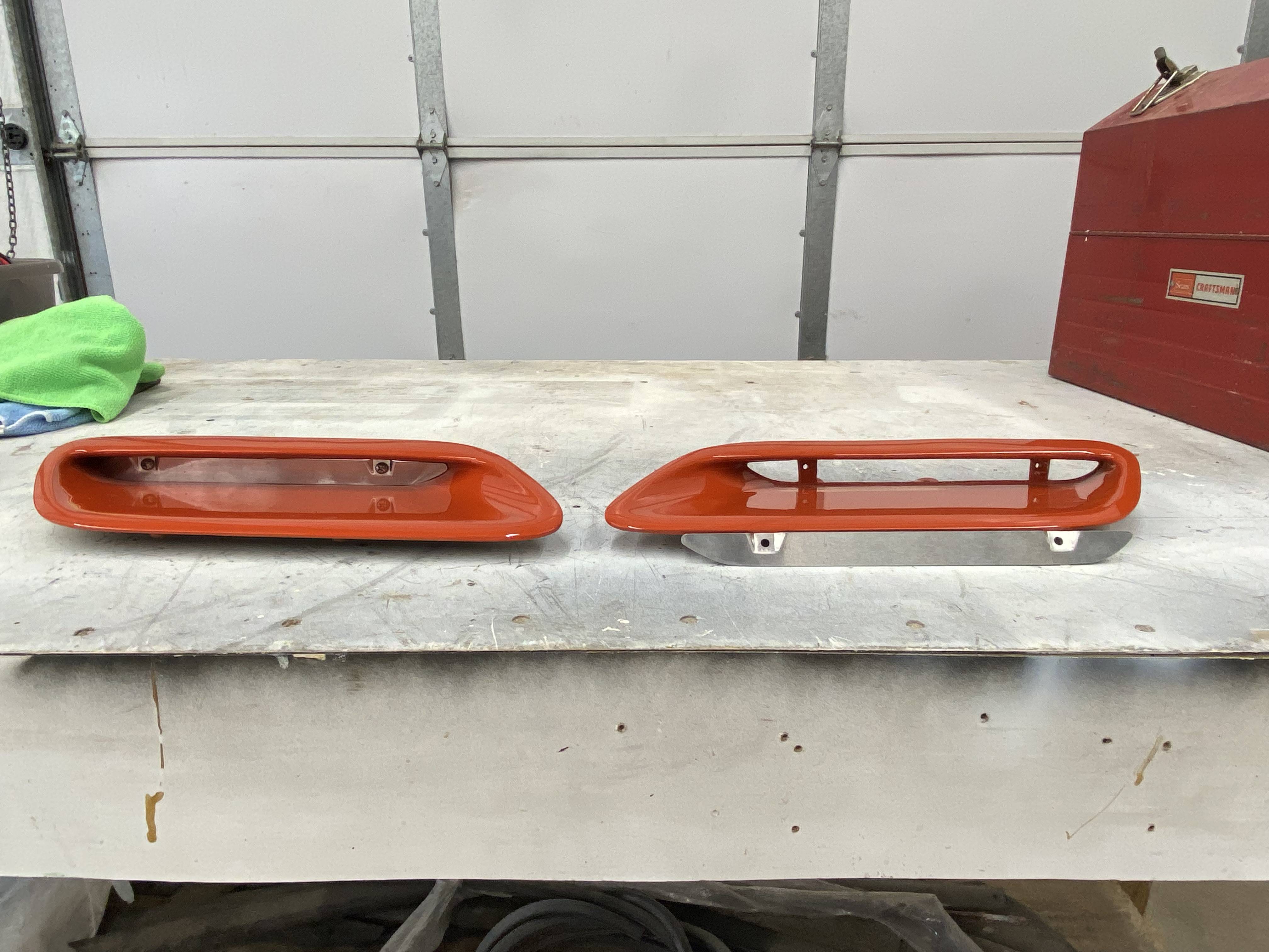

Hello folks,
I'm back cause I finally have some progress, here are some pics and part of my problem. Trying to get the hood inserts back in. The blanking plate went in fine on the left side, the right side not. The plates are identical, should there be a left and right side? Thank you for your help.
Mike

it seems possible the paint has added a few thousands to the opening. If you force the plate in there, consider protecting the paint with some masking tape. If you can't make that work, you may need to shave the top of the plate down to create more clearance. I suggest top, because any marks left on the plate will be harder to see at top, compared to the bottom edge of the plate.

Thank you for the quick response, I thought about the paint but the difference is too much and the screw holes aren't even close. That is why I was wondering if there is a left and a right? Possibly they sent me two the same?

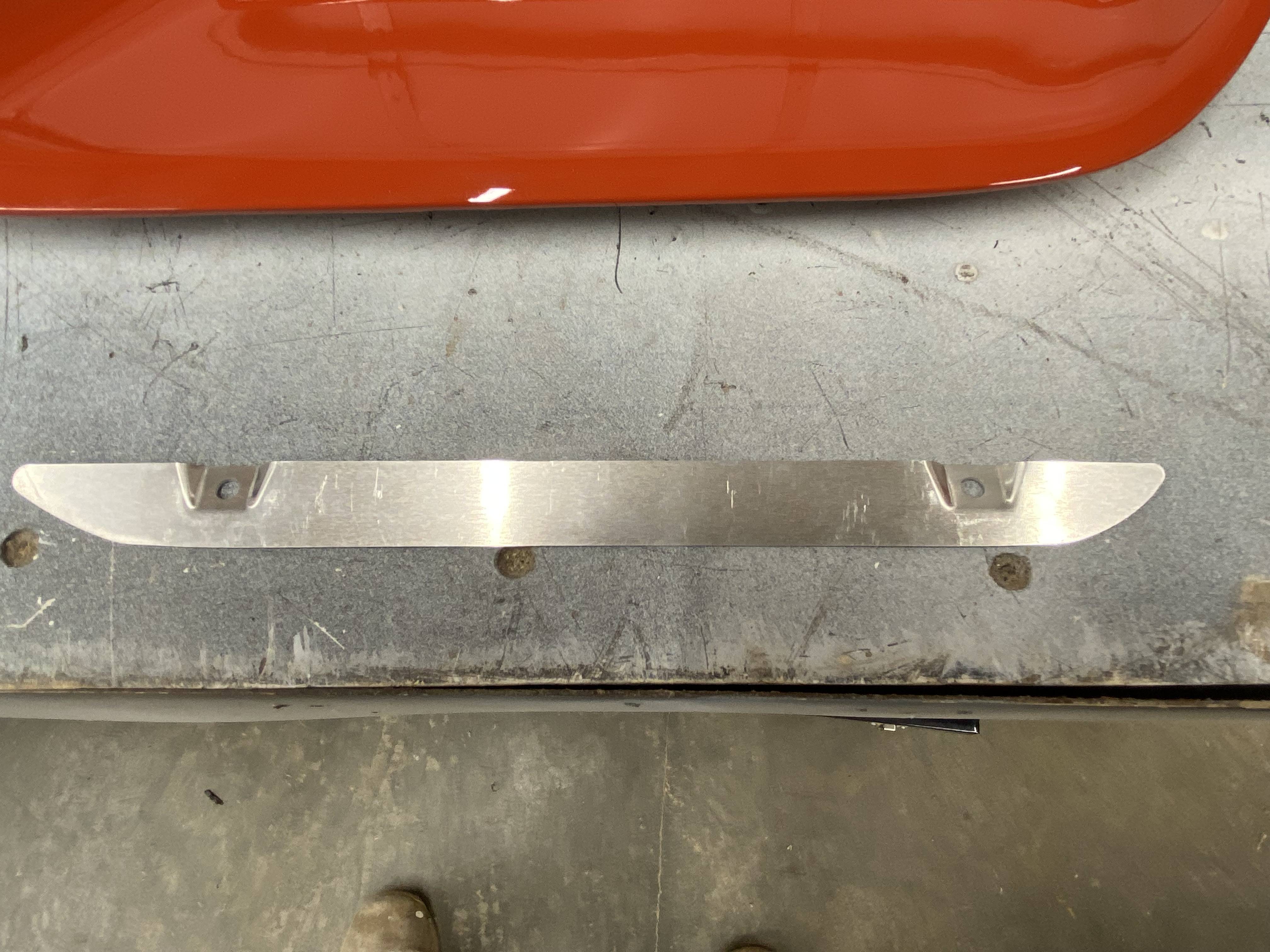

Just from your images, it looks as if the curves on the left and right sides of ONE part look different. I'm guessing there will be a right and left plate.
If they sent you two plates for the same side, does the other fit if you flip it backwards?
Can you get either plate to fit into the... left? side scoop, regardless if its flipped or not?
Who's they? I presumed these were OEM, factory original plates, that YOU removed from the scoops prior to paint. Is this not the case? Are these repops? They sure are shiny.

These plates are repros from National Moparts, I have tried them every way. Apparently another member on this forum says there is a right and left plate. This is my problem as they are identical. Thank you, I'll get back to National.
