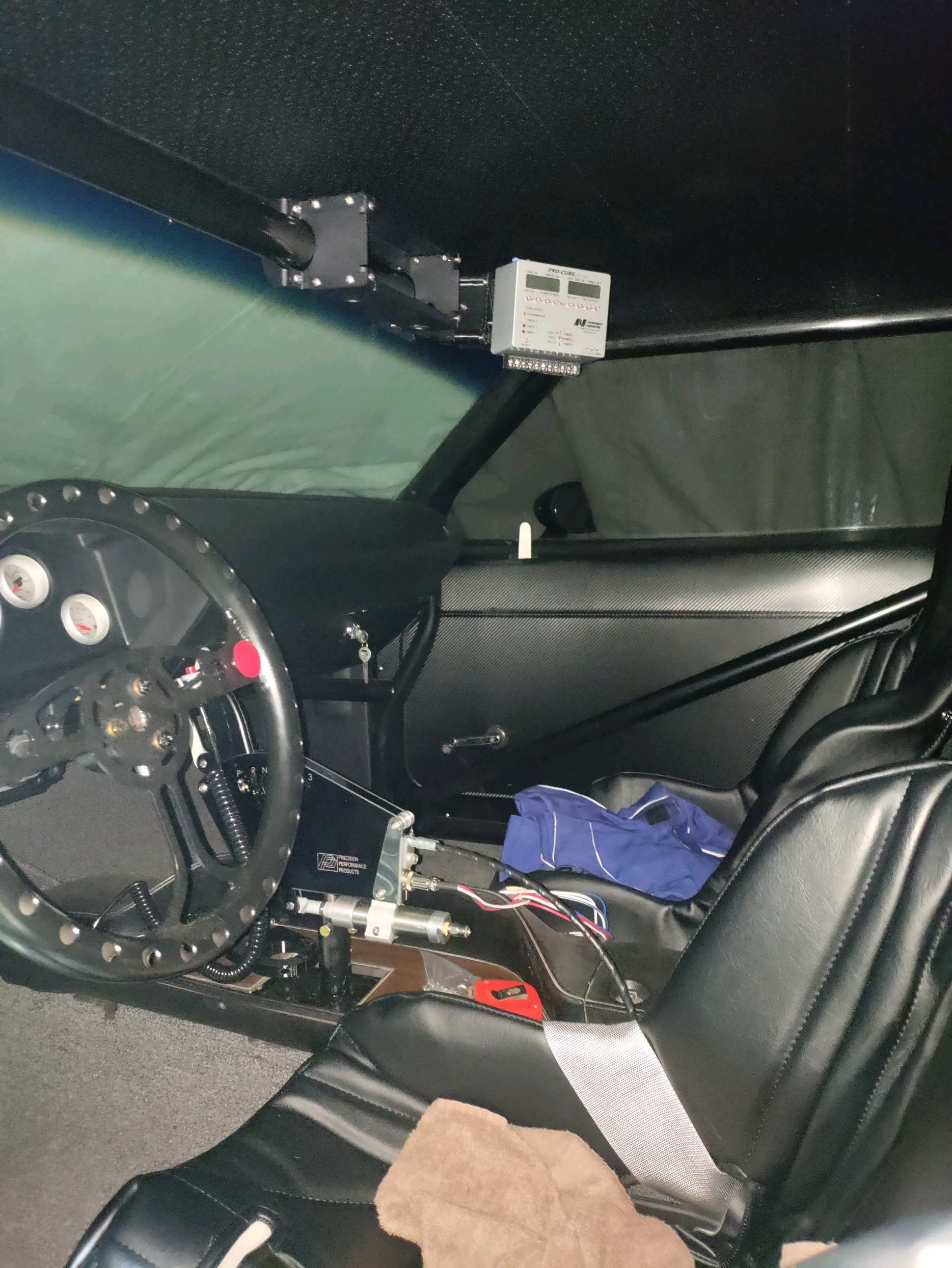

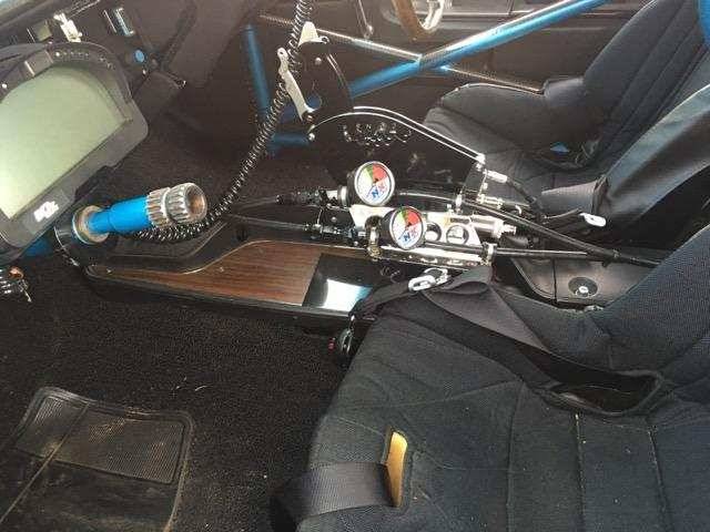

PPP shifters. Tons of racers use them. Small, light, work real well, and priced fairly. Go rear cable.

Thanks for the info. They look like a great product and I will be looking into them more before I make a purchase. BTW your car looks like a 1st class build, very nice. Any other pics to share?
I have a PPP shifter with rear exit cable in my car as well. They are nice shifters.
