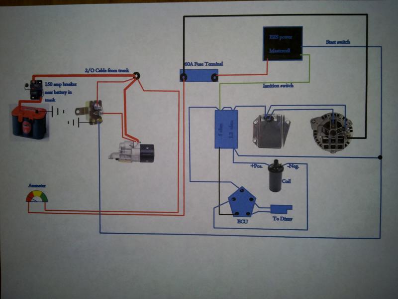

I just drew this ignition wiring up system up utilizing my ISIS power system. Was wondering if anyone can see any problems with the way this looks before I let the smoke out.View attachment 20207
I took my spark plugs out, disconnected the coil wire going to the distributor and cranked on the starter to purge gas up to the fuel filter and into a jar to get to check for leaks and get ready for my motor guy to come over to start the motor for the first time. While cranking, the #8 wires going to and from the ameter got real hot. Is there anyone good with wiring that can see anything wrong with the way I wired my engine compartment area? Any help would be greatly appreciated.

Instead of just disconnecting the coil wire, (which still runs current through the ignition system) get your self a cheap handheld remote starter switch which has alligator clips to just power up the starter only. The starter relay, which is on the fender apron right next to the battery , is labeled. Just attach the battery terminal to the starter terminal and push the button. This allows for you to do it yourself as well as being able to see what is happening under the hood while the engine cranks. No current will go through anything else. If you have wires that are getting hot when they are energized, it is usually a poor connection somewhere . Remember, safety first. Always have a fully charged fire extinguisher handy that is rated for electrical and oil.

Thanks for the great advise (again) Leo. Great idea. I will bypass the ameter and that will tell me if I have an issue with the wires or connectors heading through the firewall and back from the ameter or the ameter itself. I'm still wondering if the wiring diagram I made up looks okay. Fire extinguisher is "cocked and loaded". Hope I won't need it.

Great idea Leo. Thanks for the advise (again). I can do that with a little switch heading to the start relay coil. I think I will bypass the ammeter with another wire to see if I have an issue with the wires or connectors heading through the fire wall and back. There may be an issue with the ammeter too??. It does show total discharge while cranking then back to center when not cranking so I "assume" it works okay. Fire extinguisher is "cocked and loaded". Hope it's not needed. I would still like to see if anyone has any input on the way I wired the engine compartment up. The ignition circuit backfeeds the start circuit causing the starter relay to energize when only the ignition ckt. switch is on. I was able to fix it so it works properly.
