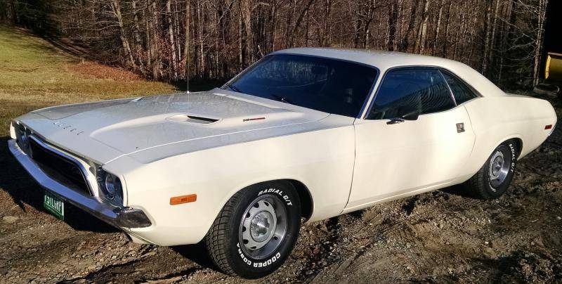

Put on new sneakers today. 225/70/14. Tried my hand at powder coating. Did not come out like I expected but they are powder coated. My mechanic that put the tires on said it was a weird flashback working with 14" wheels again.

First wheel I hung vertical, put powder on it then turned it horizontal to put into the oven. When I did that a lot of the powder fell off. I should of started over at that point but did not. The 2nd wheel I hung horizontally then "gingerly" put it into the oven. I don't think I put enough powder on that wheel. The 3rd wheel I think I put too much powder on it. The 4th wheel I think I may of cooked it too long. Summery, there seems to still be an art to doing this just like there is an art to painting. It is not as easy as it looks on TV or Youtube. You need to do a lot of practice or have someone teach you in order to get it right the first time. I did a couple of small metal parts before I tackled the wheels with success. The wheels were larger and I think pre heating them may of been key????? I also think that although the wheel is centered in the oven from a little stand I made up, I think the burner may be too close to the wheel??? Not sure. Anyway, it works awesome and is easy for small parts. The wheels do look good. The parts of the wheel that you see came out alright.

I only have about $100 into it with the "Argent" silver powder. You can usually find a free working electric oven somewhere. I will be powder coating all small parts from now on because it is quick, easy, more durable and looks nice.

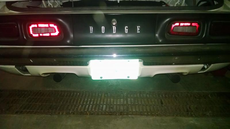

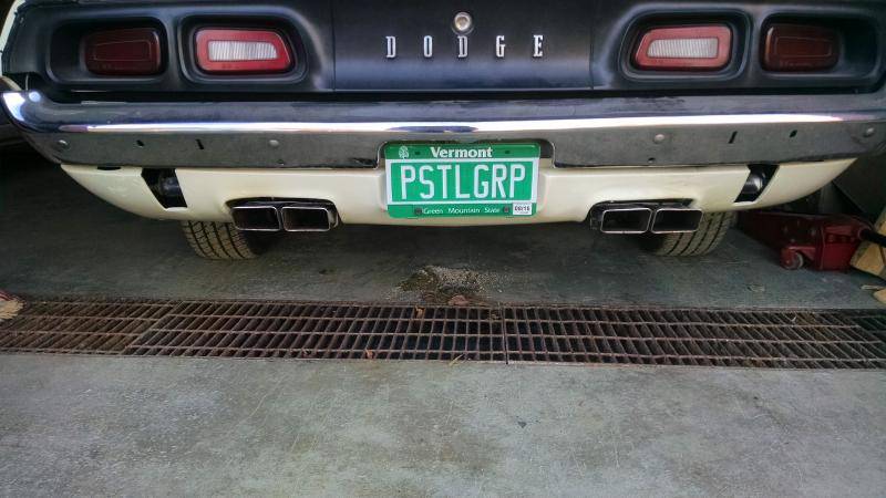

What carb are you using ? Do the exhaust pipes exit out the rear of the car through the valence panel ?
Quick Fuel Technology Slayer series #SL-600 CFM Vac. Secondary. I'm just trying to educate myself a little on the best way to understand how to get it adjusted properly.
I have not got around to modifying my exhaust tips to fit on my 2-1/2" tail pipe yet. I thought about what you are getting at. It needs to snow so i can stop driving it and get to working on it again (lol).

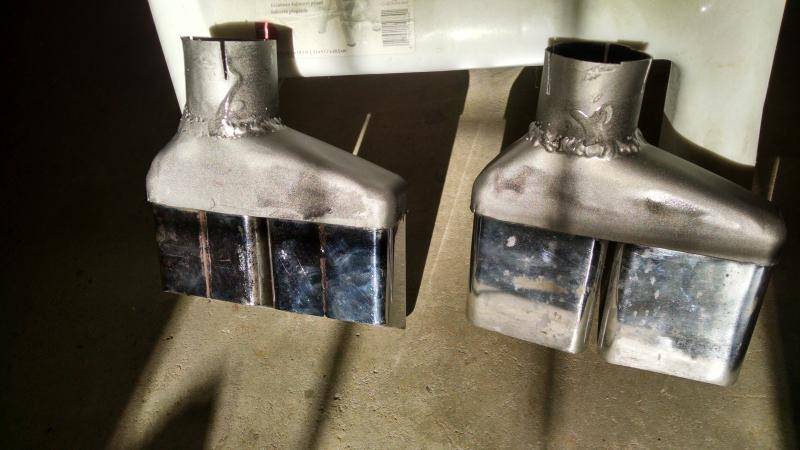

Welds are a little "bubblegummy" but besides that they came out pretty good.015.jpg016.jpg017.jpg
