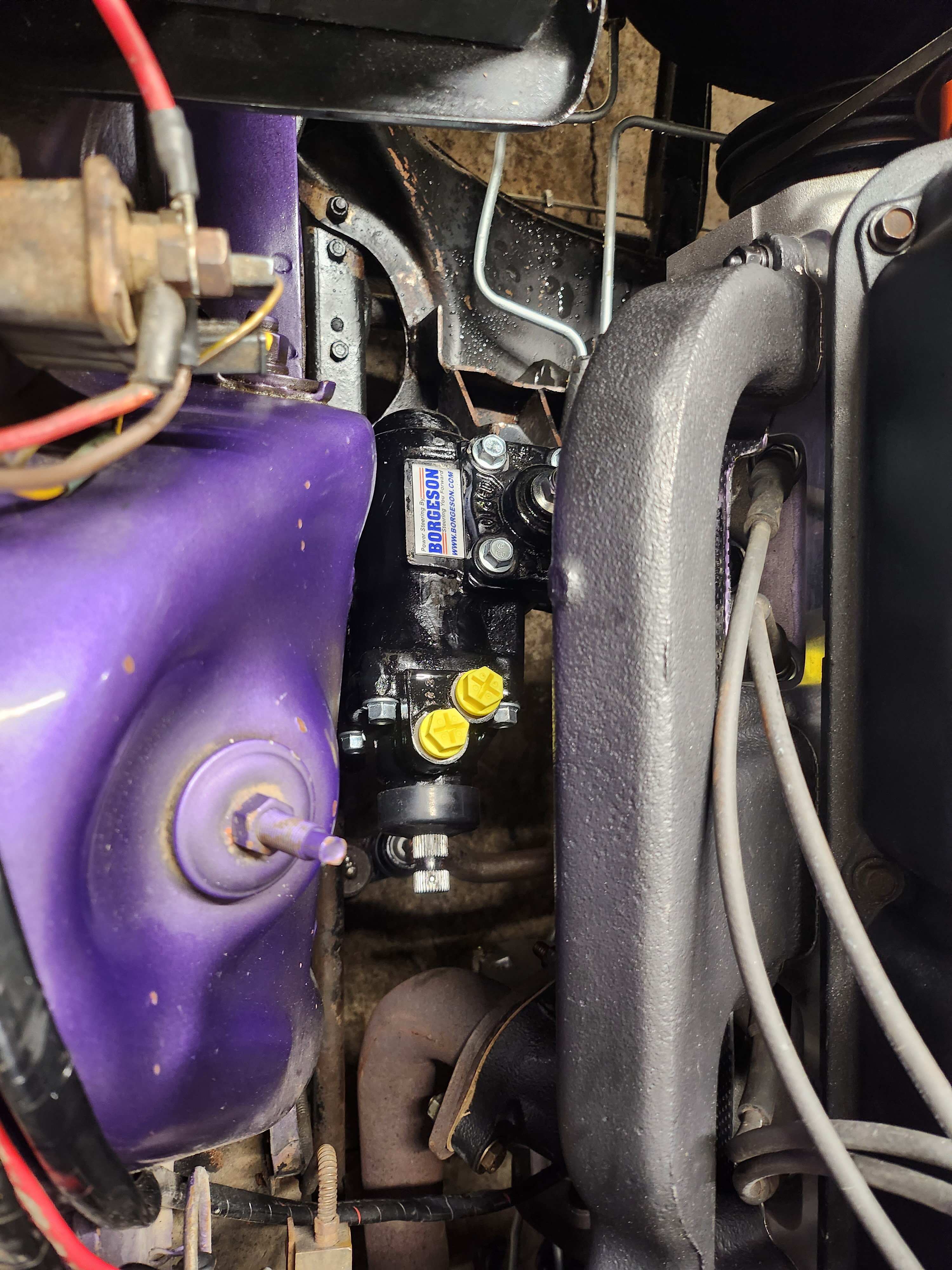

don selleck
Dec 8, 2022
125
91
michigan usa
swapped a borgeson steering kit in my aar just a few days ago waiting on the no cut coupler for it now. Put the system in my 68 charger big improvement from stock.
