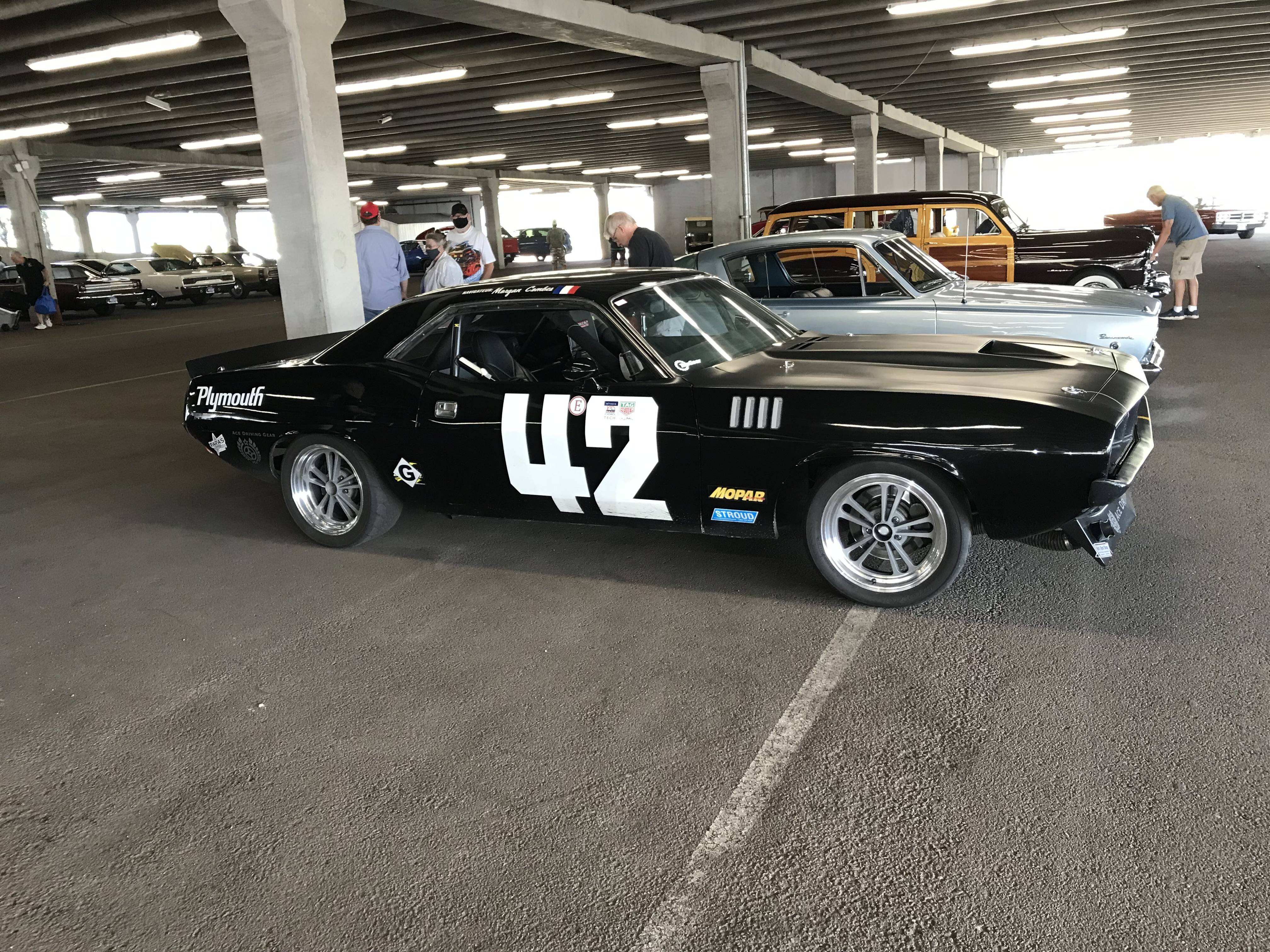

I spoke with the owner of this N code Cuda. This car has raced up the Pikes Peak hill climb and it is bad ass. Nice guy to talk to.

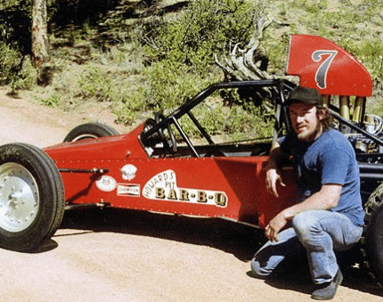

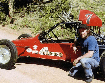

My dad had his 26 turtle deck "T" frame made by John Wells, famous for the Well's Coyote sprint cars. I have been to his shop which was in Woodland Park in the 80's. Here is an interesting article of him smashing his trophy in 2000 in complaint of the ridiculously low prize amounts. https://apnews.com/article/3475c0bf97d8d2eba4a56c9b46a187e8
Just noticed the Howard's BBQ sponsor on the side. My grandmother worked at Howard's BBQ for years. My family also new Larry Carnes and Clint Vahsholtz, both who raced for many years up the peak. Oh yeah, multi-year winner Ralph Bruning, a police officer, gave me my first ticket when I crashed my car.
Very cool car. Looks to be Chev powered with those angled injector stacks and mag at the back of the block.
Funny how large and yet how small the PPIHC community is. I have traveled a little and people always comment or have a Pikes Peak story to tell.

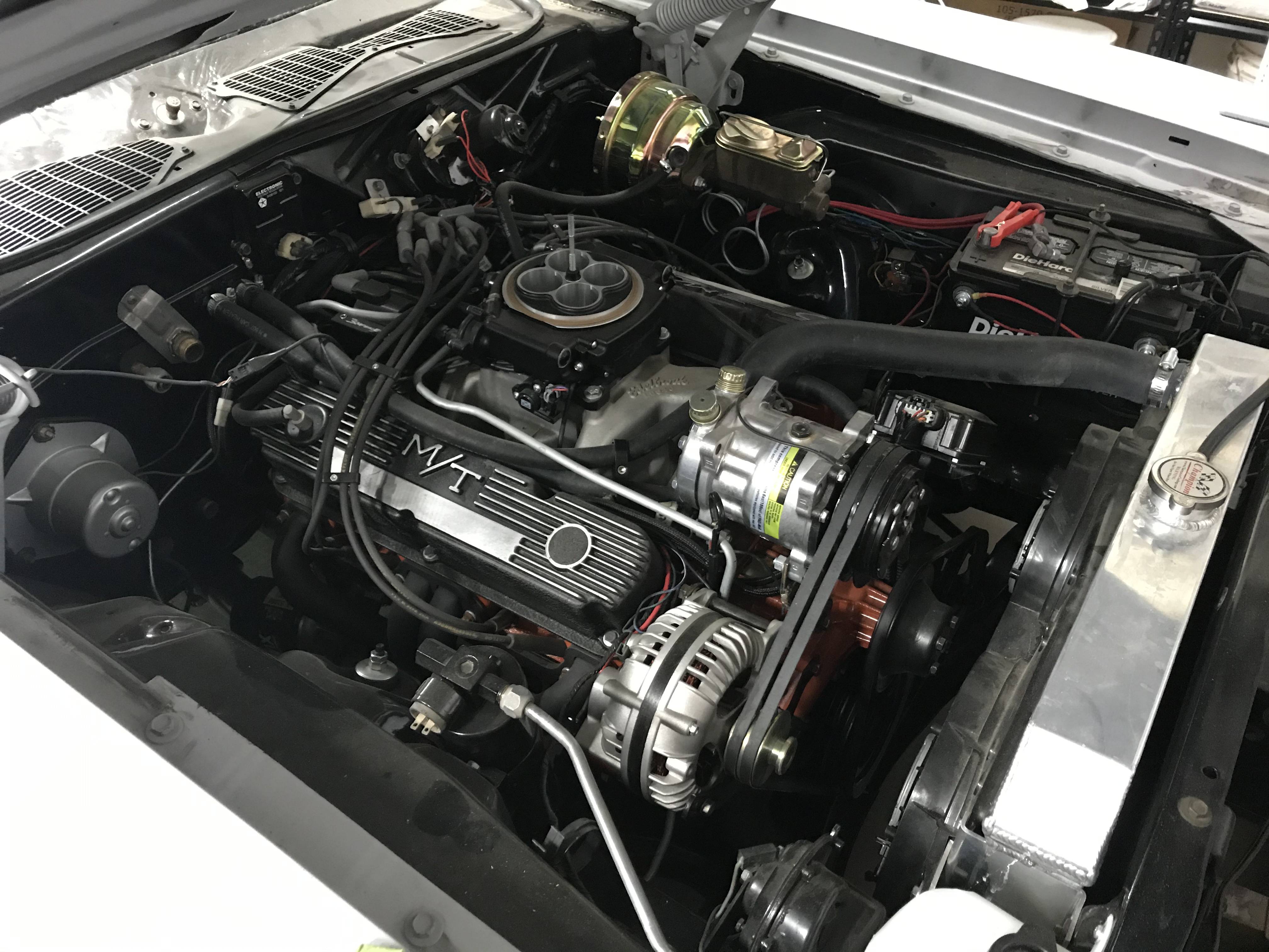

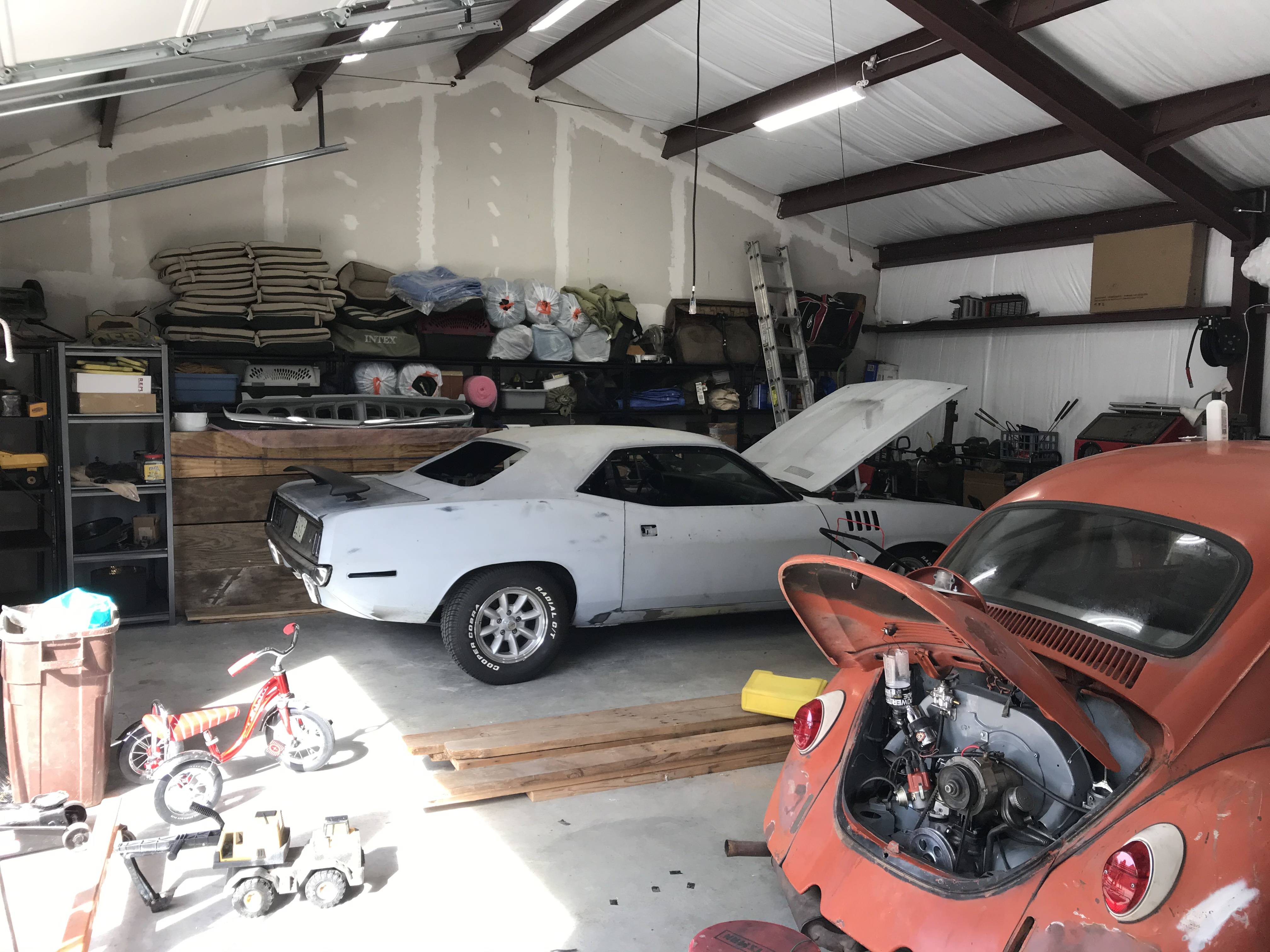

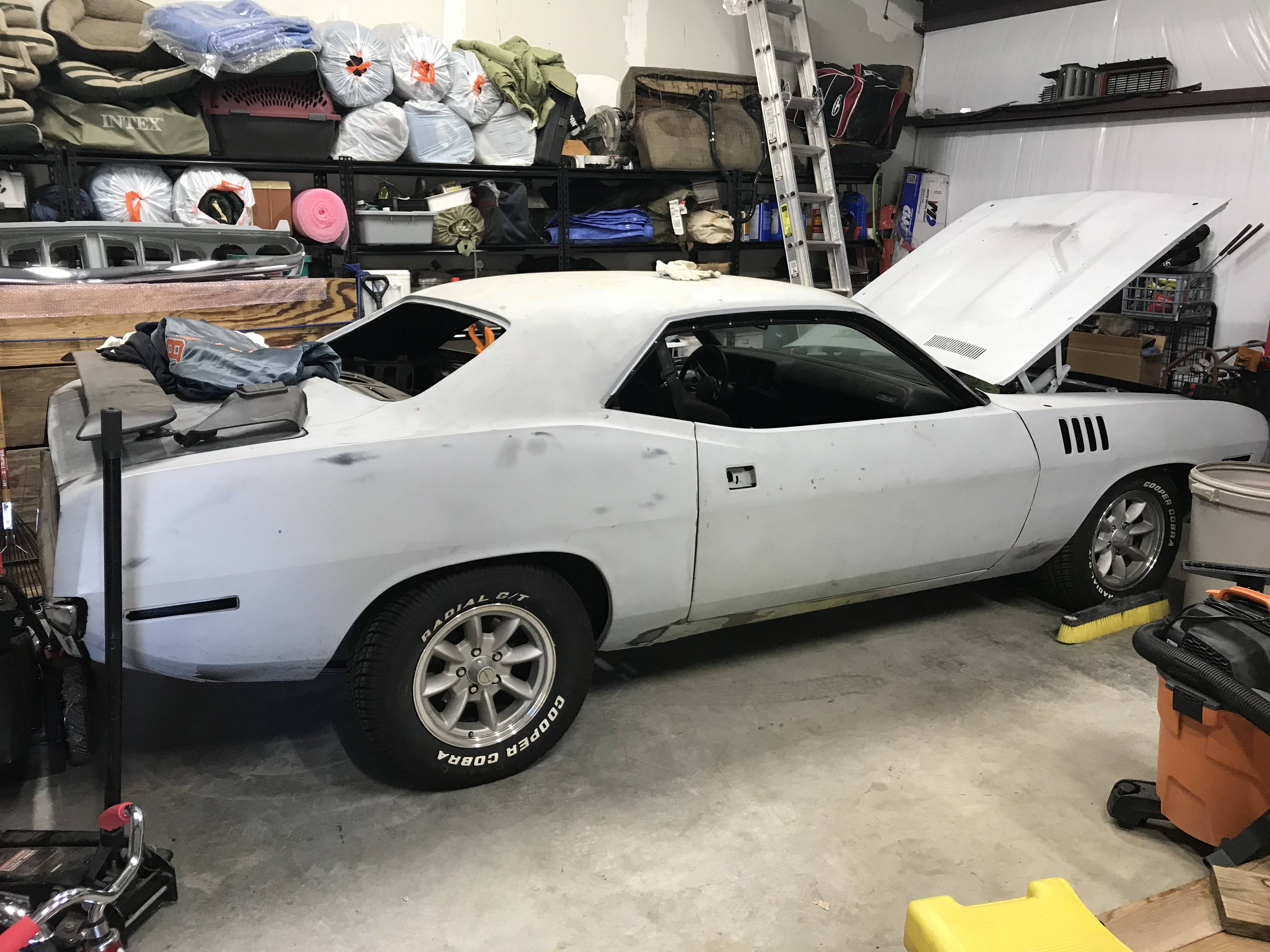

Here below is an article of my build now two years ago. Currently a driver in primer with a four speed, 408 magnum based with EQ cylinder heads, and Sniper EFI with Hyperspark ignition. It has 1.08 t-bars, f & r sway bars, boxed lower control arms, c-body tie rods, tubular upper control arms , a US Car Tools chassis stiffening kit, and discs front and rear. What Are You Working On?

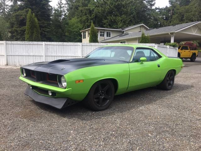

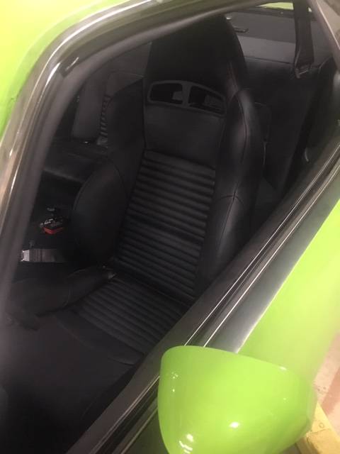

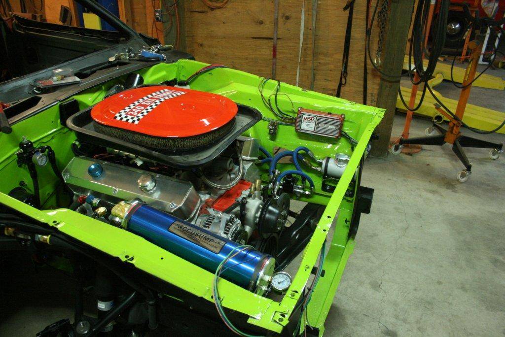

Here is my 73, it has a 416 stroker, EFI 6 pack, Edelbrock heads, roller cam, TTI headers, A833 4spd, braced 8 3/4 with 3.23 gears, 4 link with Strange coil over shocks, boxed LCAs, Firm Feel tubular UCAs, large front sway bar (don't remember the size), 1.14" T bars. The car has USCT SFC and my own design of inner fender braces and lower radiator brace.

I did not use the oil accumulator by the time I was done, it just took up too much room, but I still have it "just in case".
