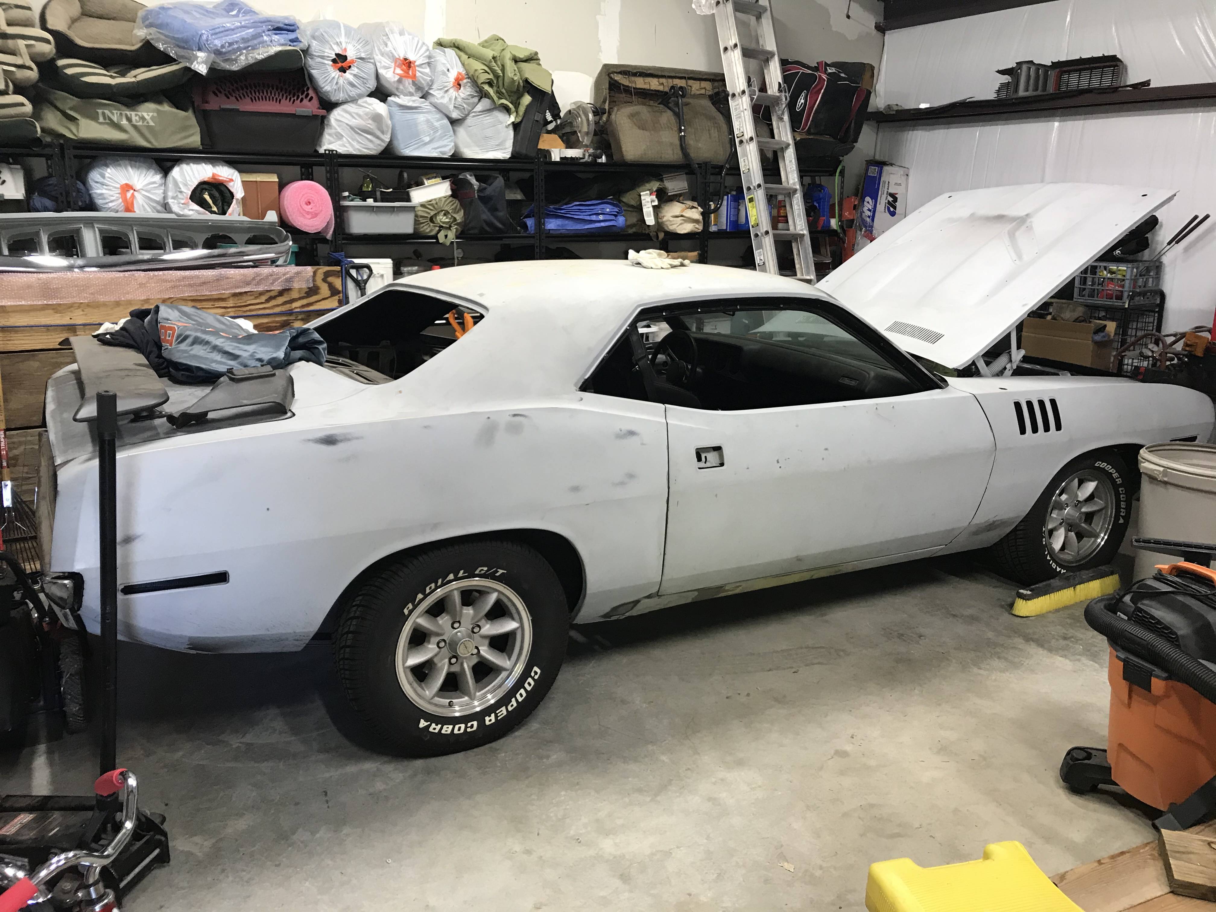

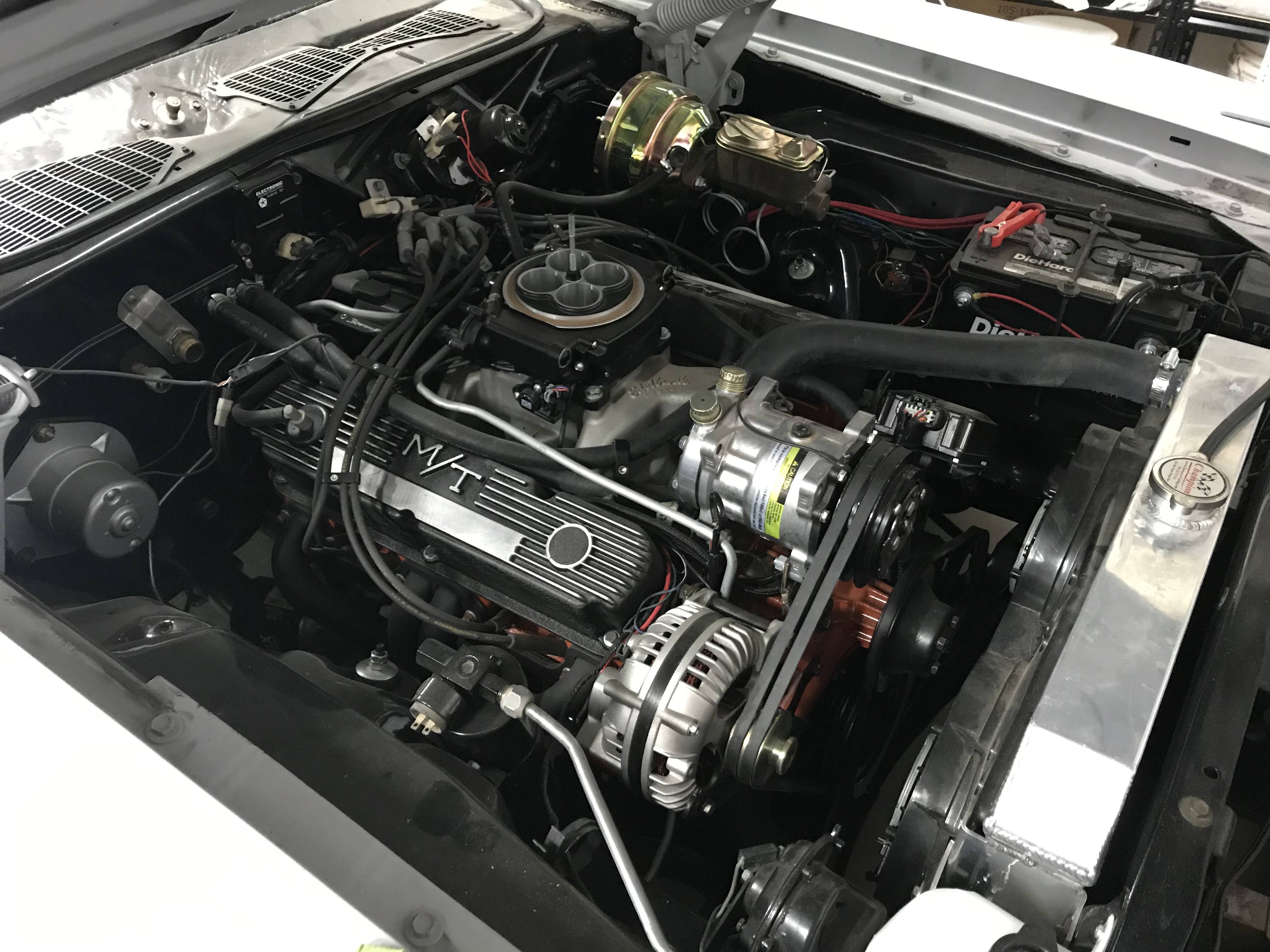

Here below is an article of my build now two years ago. Currently a driver in primer with a four speed, 408 magnum based with EQ cylinder heads, and Sniper EFI with Hyperspark ignition. It has 1.08 t-bars, f & r sway bars, boxed lower control arms, c-body tie rods, tubular upper control arms , a US Car Tools chassis stiffening kit, and discs front and rear. What Are You Working On?
Cool car. What brand are the mini-lite style wheels? The reason I ask is I have a set for the Cuda which are 15x8 Superlites from Australia. I couldn't afford the real-deal minilites. They look great on cars like yours and mine, period T/A correct. Wow, you have done a lot of work on your car which should make it really fun to drive. You are lucky to have a 26 radiator car. Both my e-bodies have 22 and they don't cool as good as I would like.

I did not use the oil accumulator by the time I was done, it just took up too much room, but I still have it "just in case".
I forgot to mention I use an accusump for insurance. The bottle is mounted to the old console brackets. The car has a custom oil pan which has gates which provide the sump with half the pan's capacity under any g load. I have pulled rod/main bearings from an engine that was ran without the accusump and they were perfect.
Wow, you also have done a lot of work/mods to your car. I haven't boxed the lowers yet nor stiffened the rad support. The car has sub frame connectors but they are not attached to the floor pan over their length so their benefit is not as good as it could be.

They are Superlites. 15x7 all around.
